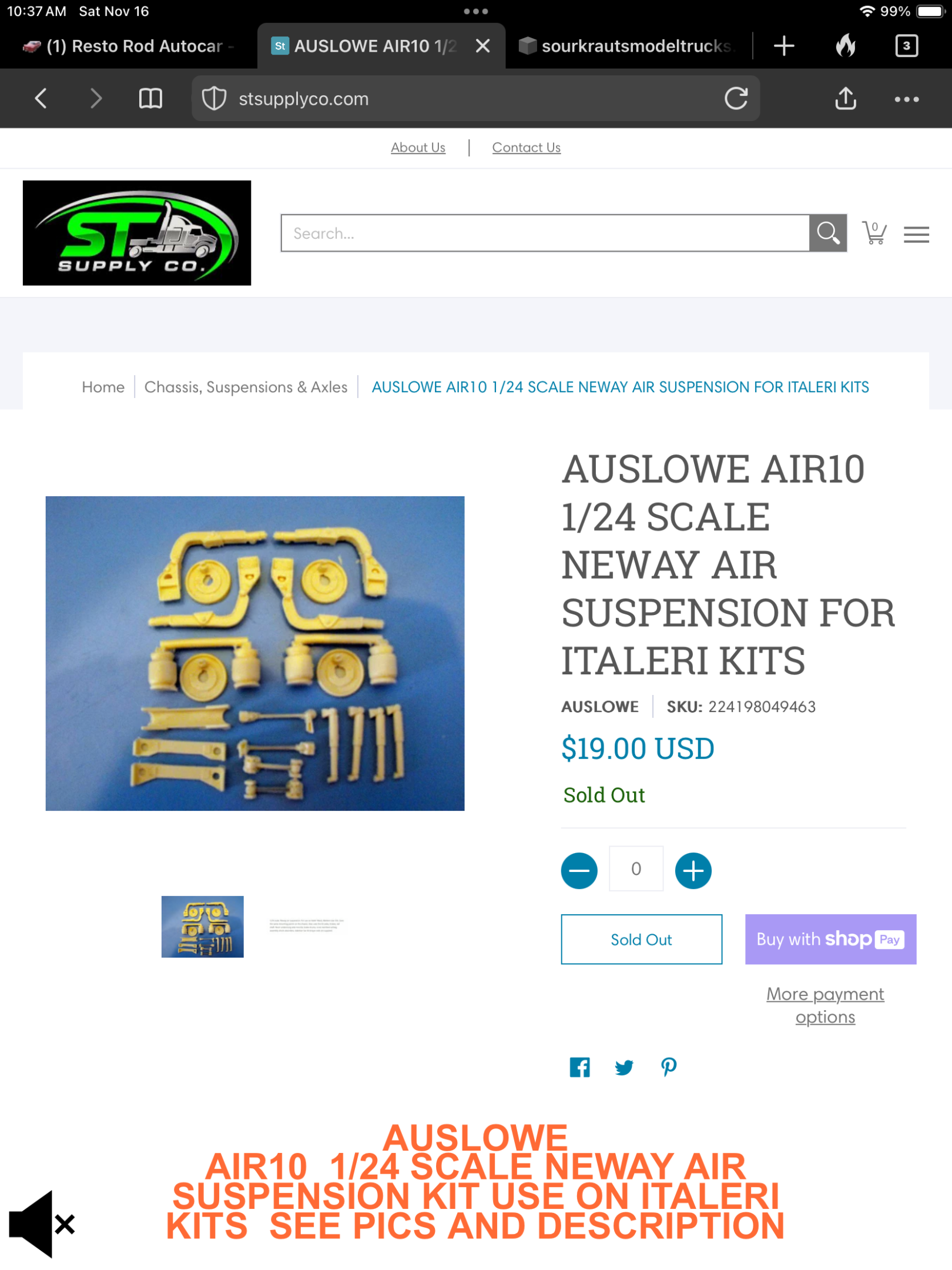

Gary Chastain Posted November 16, 2024 Author Posted November 16, 2024 Checked again at ST , only in 1:24 scale ( although May work as I have mixed these scales before) but sold out. Checked a couple other sites and no go, looks like an opportunity for a printer person. 2
Biggu Posted November 16, 2024 Posted November 16, 2024 The difference between 1/24 and 1/25 in this case I would think would be minimal and there would be few if any issues , that’s my 7 cents worth ( 2 cents Canadian plus exchange )!! ??

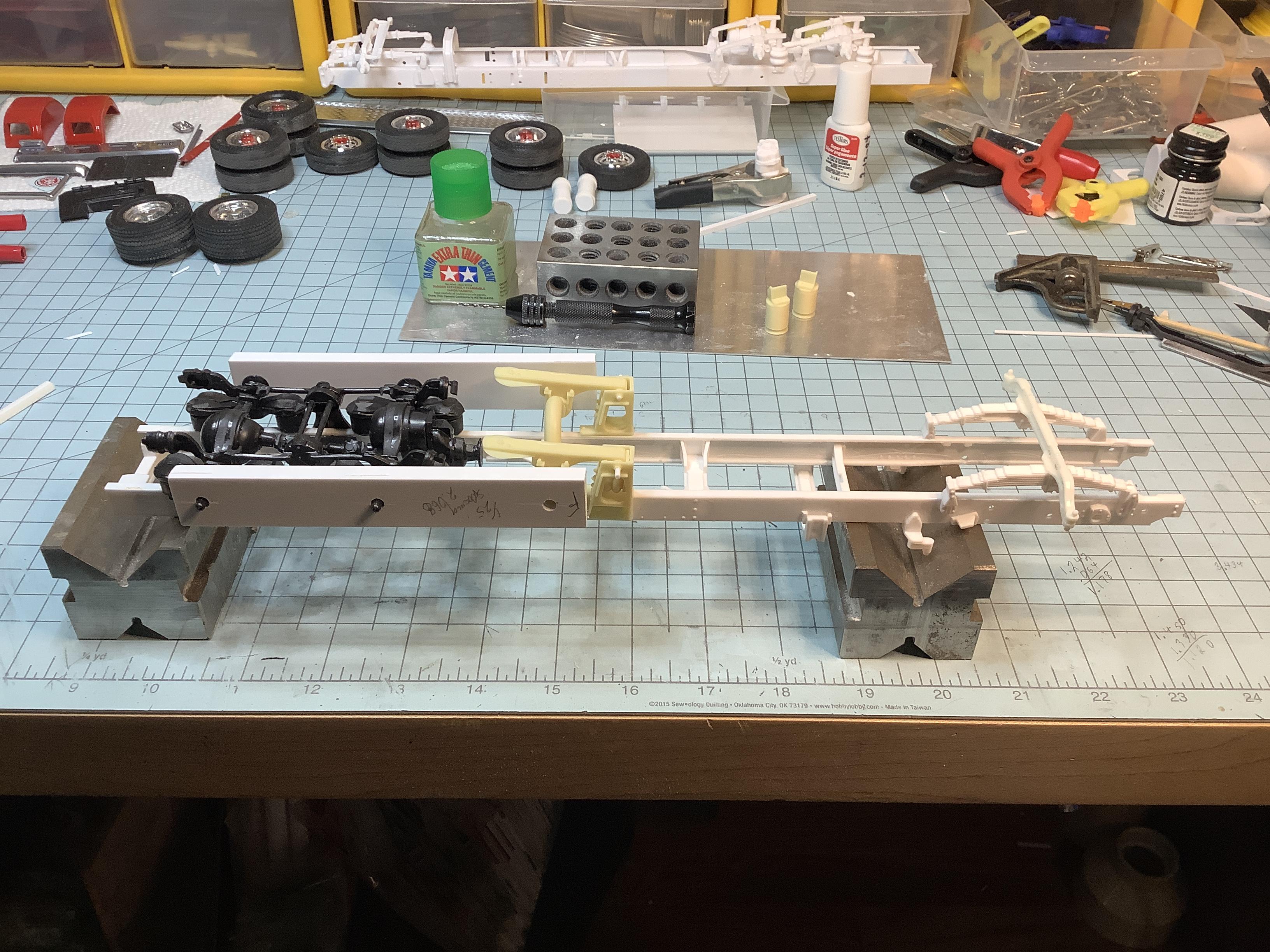

Gary Chastain Posted November 16, 2024 Author Posted November 16, 2024 The KW eight bag air suspension is on with a few details to finish. Installing this suspension without all the locating tabs from the original frame creates some concerns, is it square and are the axles spaced correctly. Couple years ago I made a fixture to help overcome those issues. I can use the fixture for a two axle or three axle setup. found a steerable front axle in my parts, that will built next, then third air lift axle. 3
BK9300 Posted November 16, 2024 Posted November 16, 2024 (edited) 17 minutes ago, Gary Chastain said: The KW eight bag air suspension is on with a few details to finish. Installing this suspension without all the locating tabs from the original frame creates some concerns, is it square and are the axles spaced correctly. Couple years ago I made a fixture to help overcome those issues. I can use the fixture for a two axle or three axle setup. I remember the fixture solution from your International Paystar build - great idea! (sent you a PM about the Tyrone engine) Edited November 16, 2024 by BK9300 2
Biggu Posted November 16, 2024 Posted November 16, 2024 Genius ! I never would have thought of that ! 1

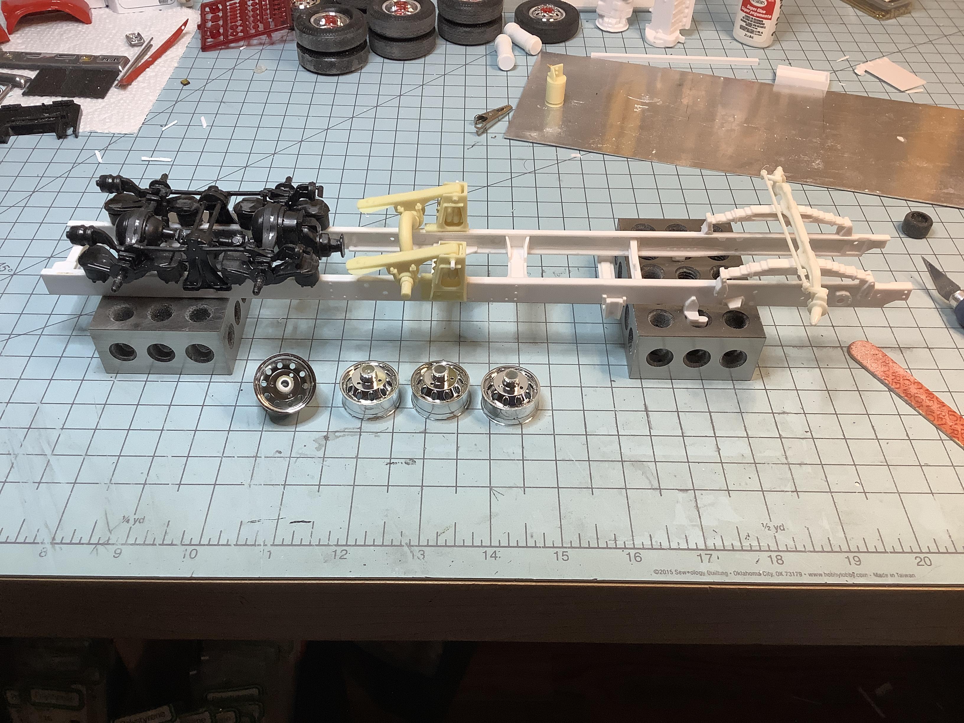

Gary Chastain Posted November 16, 2024 Author Posted November 16, 2024 Adding third lift axle with locating fixture. Will use slow dry epoxy to attach frame stands so I dial in the location. I drilled and pinned the arms so I can rotate the axle , may build this with axle posed in the up position 3

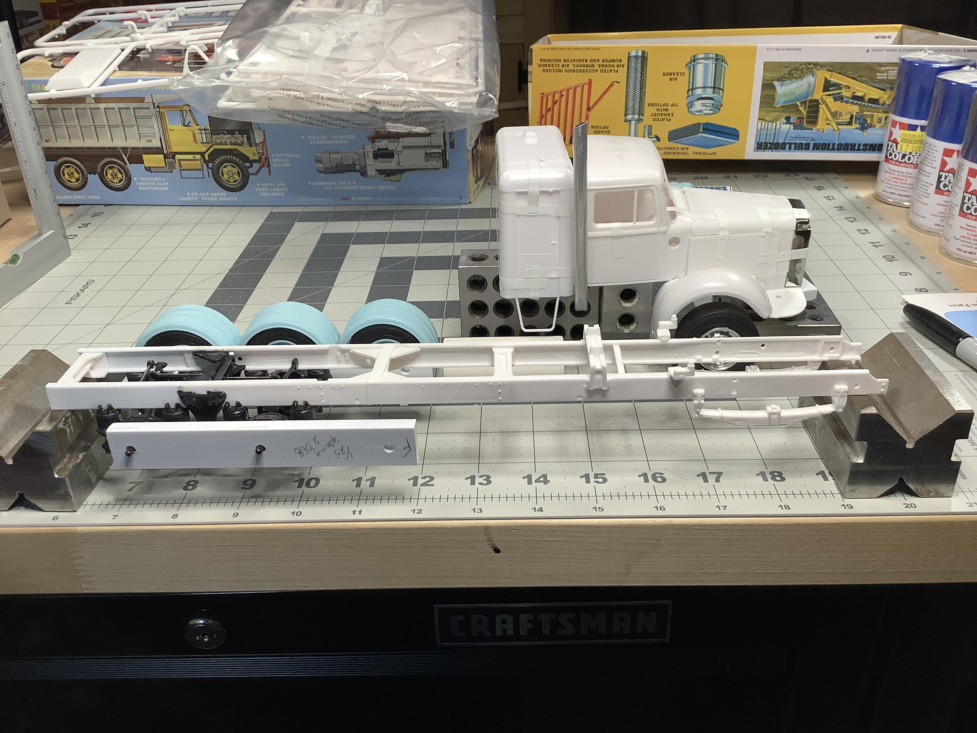

Gary Chastain Posted November 17, 2024 Author Posted November 17, 2024 Quick mock-up after suspension dries. 3

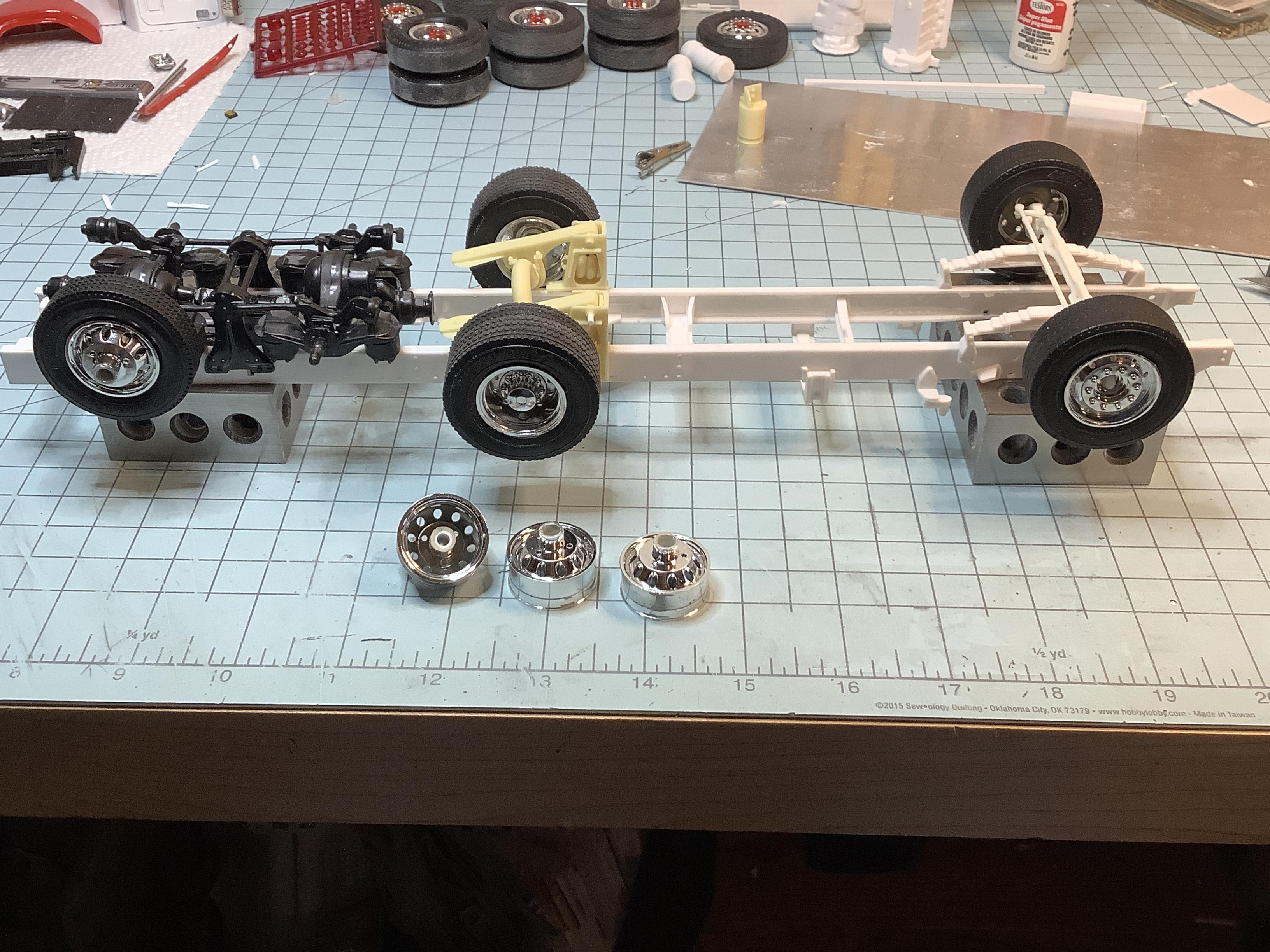

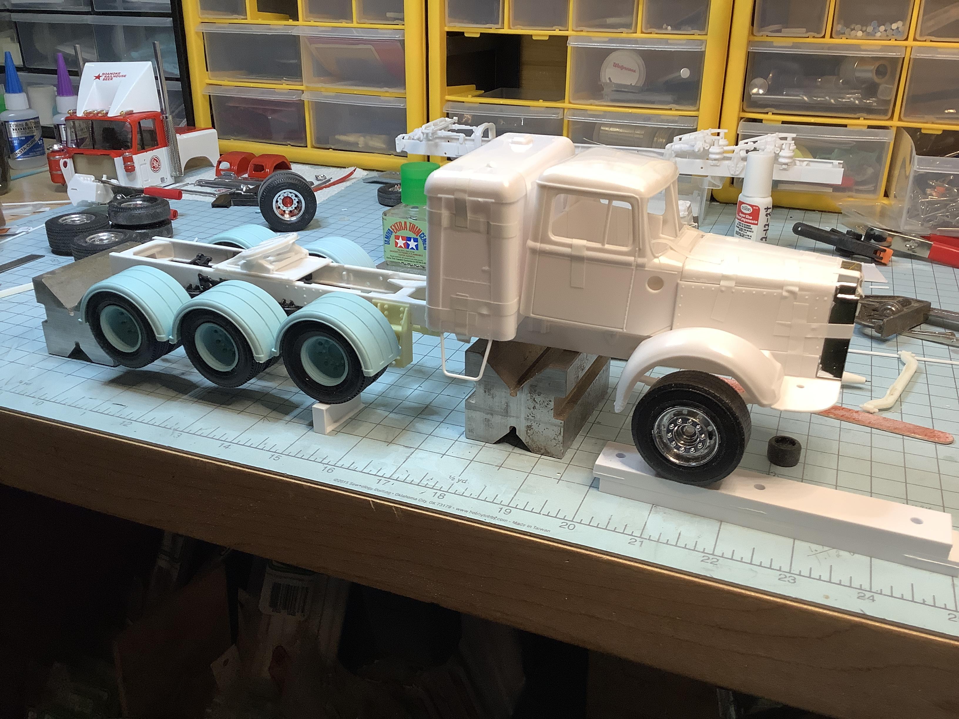

Gary Chastain Posted November 18, 2024 Author Posted November 18, 2024 After a day with my wife Christmas shopping, I really…….i mean really needed to get back to bench. All axles mounted, parts from everywhere. Had to add a bushing to the wheel inners then drill to match the rear axle diameters. Running floats on the front, wide singles on air lift and duals on the drive axles. I will able to tuck the wide singles into the rear fenders nicely as they will be affixed in the up position when completed. 4
BK9300 Posted November 18, 2024 Posted November 18, 2024 Coming along nicely, Gary - those super singles are quite the tires! 2

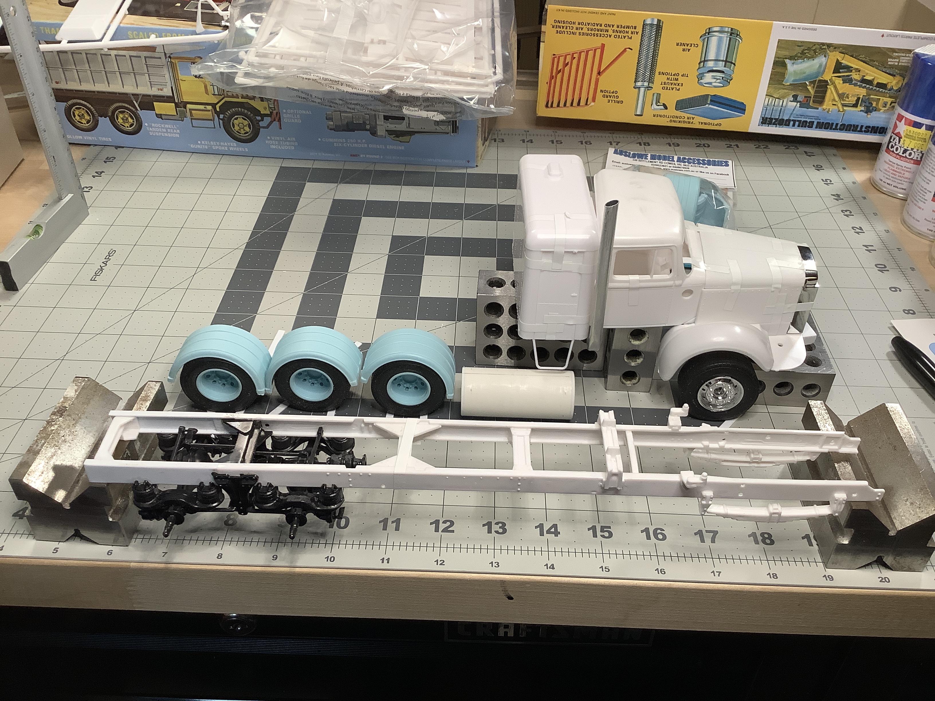

Gary Chastain Posted November 18, 2024 Author Posted November 18, 2024 Quick mock-up to get the lift air bag measurement and fuel tank length. 3
Gary Chastain Posted November 18, 2024 Author Posted November 18, 2024 34 minutes ago, BK9300 said: Coming along nicely, Gary - those super singles are quite the tires! I have used the super singles front tires many times and do a good job of filling up those fenders. I have not built with any rear super singles on a lift axle. We will see how this works out. Just did a mock-up to get a visual. Everything on this build is subject to change with no rules. 2

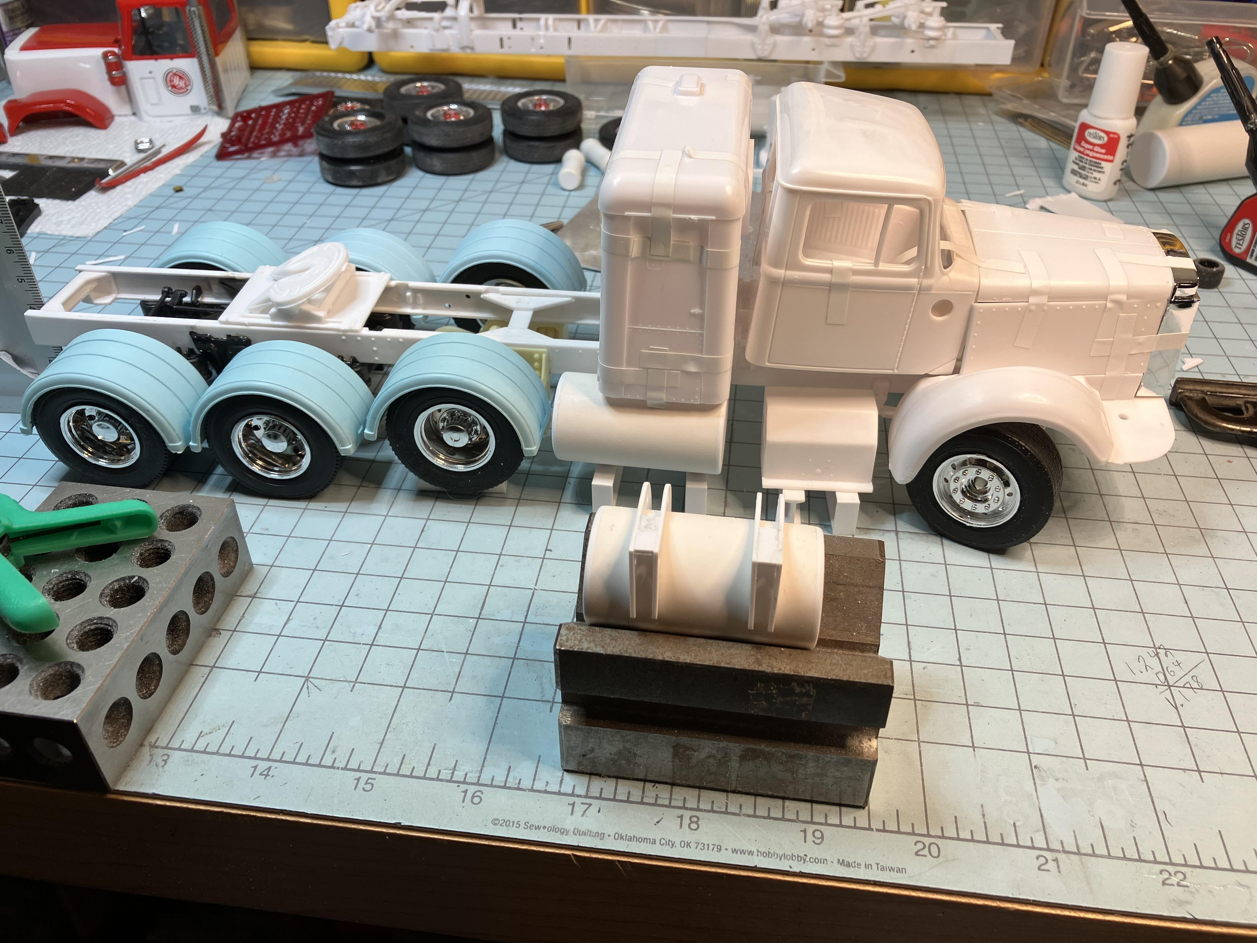

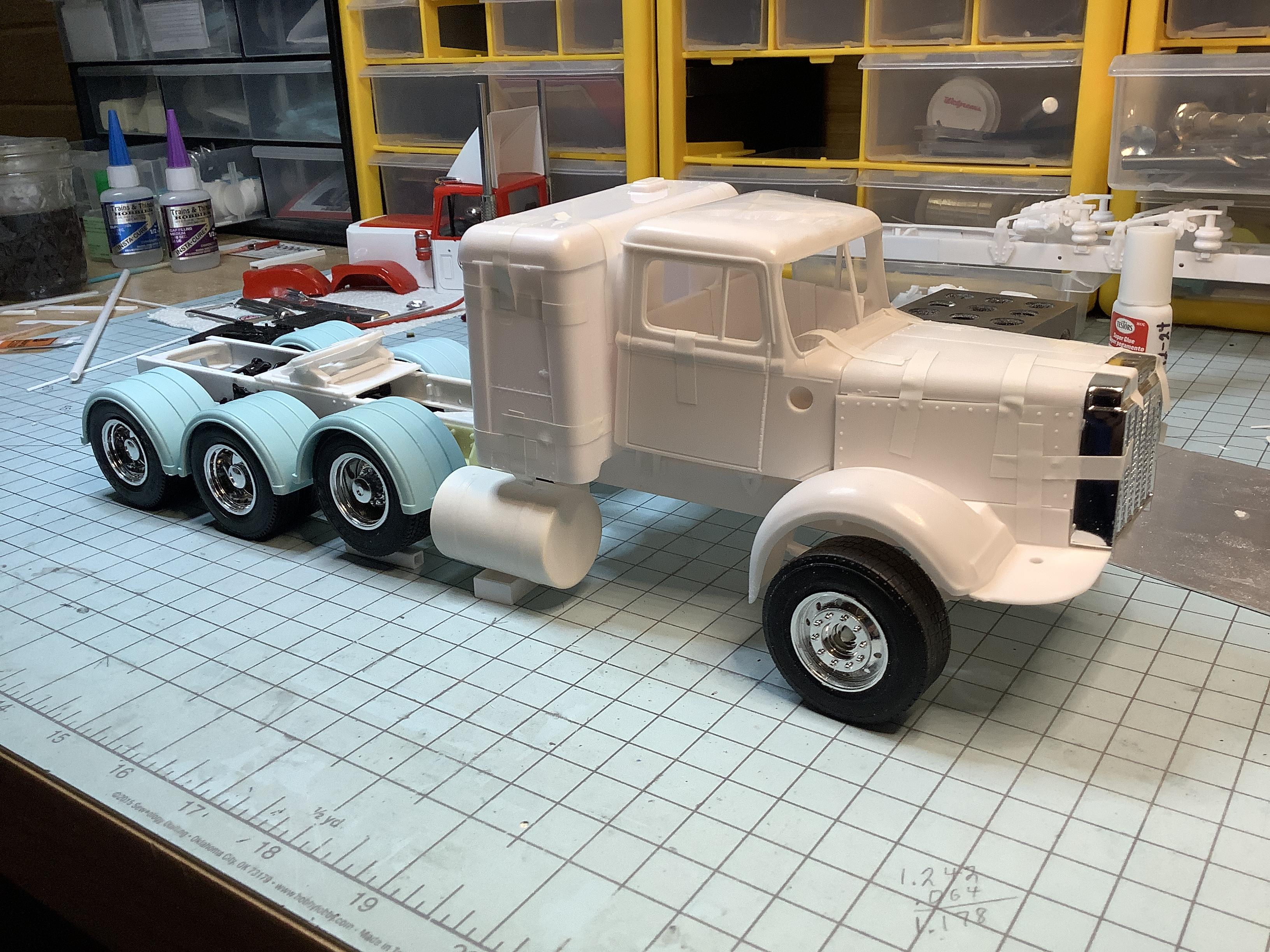

Gary Chastain Posted November 19, 2024 Author Posted November 19, 2024 Got the correct length fuel tanks made, working on all the brackets/straps. Also started messing around with battery boxes. Not a lot of progress but some. 4
