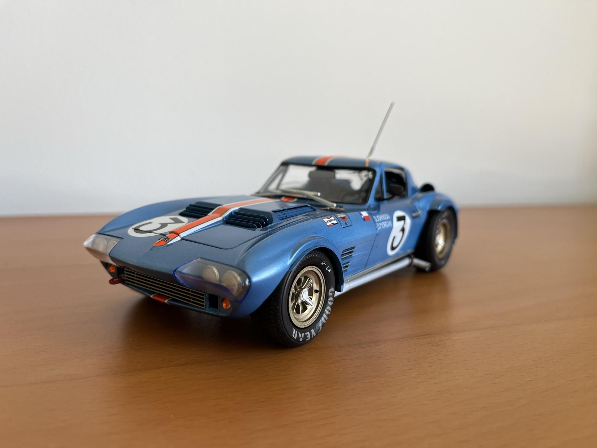

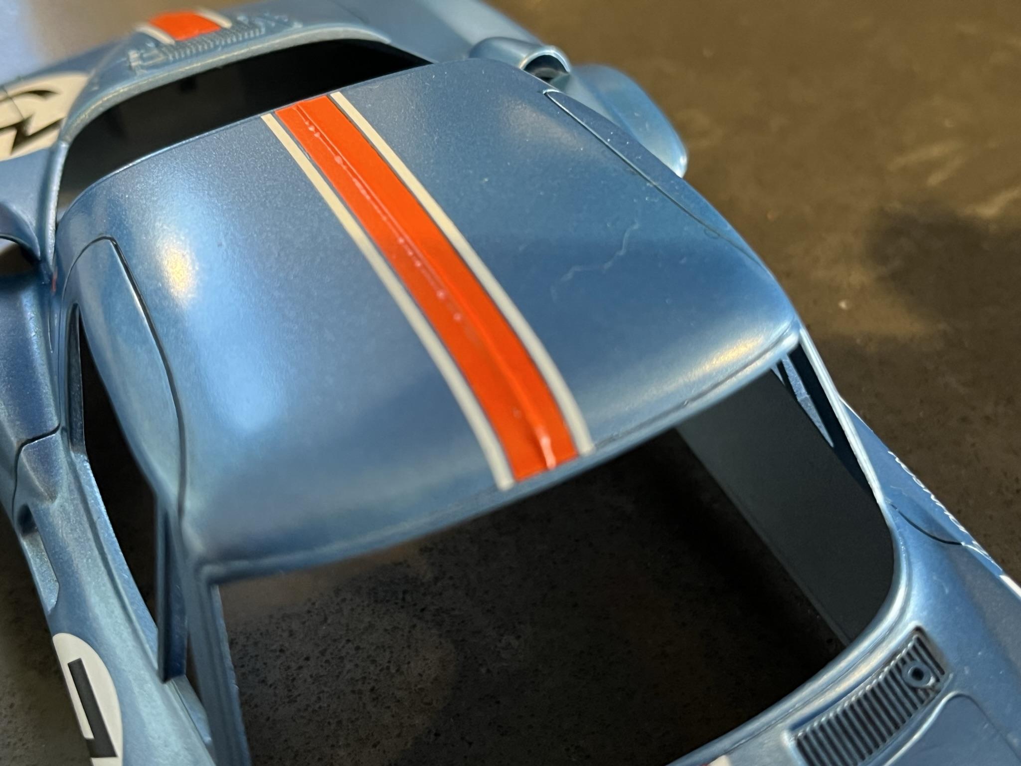

Well, Mark, here it is. With poor decals from VRM and paint too dark, to my point of view from MCW (Pelham blue). I think that this build is cursed ans I'm thinking about dipping the thing in holy water before applying the clear coat😂.
I don’t know Yves, it looks pretty good in the pictures. Think it over a bit before dipping.
I really hate to move backward in a build. It’s mighty pretty the way it sets.
I can’t comment on the blue, hard to tell if it’s a bit dark. It will lighten some when you do the window trim in black and maybe use some panel liner in the seams.
The decals are the real problem, I tried 3 different setting solutions and none worked. Like I said, I had the glue some of them on in places with Future acrylic. I see the problem on the roof stripe. The number on the hood of mine looks like BLAH_BLAH_BLAH_BLAH where I cut it. Trouble is VRM is the only game in town.

Hi Richard, The problem is not the orange that looks actually really good, it's the quality of the decals, (see the bubbles on that tiny trim on the roof?).
I tried Microsol, it didn't do anything to the decal, I used Solvaset to get them to soften, but as they dried, they tried to go back flat, that's why it developed pockets of air.
As for the color, I'll leave it as is, it's not perfect but to be honest, I want to be done with it, the fun is gone. Next one will be better...perhaps. Thank you and good continuation👋
Edited by yves 95128
Yves, for the bubbles, in the past I have stuck them with a straight pin and put some decal setting solution on them.
  • Like 3
Thank you Todd, I will try that on a small area, perhaps with a wet and hot Q-tip to soften.

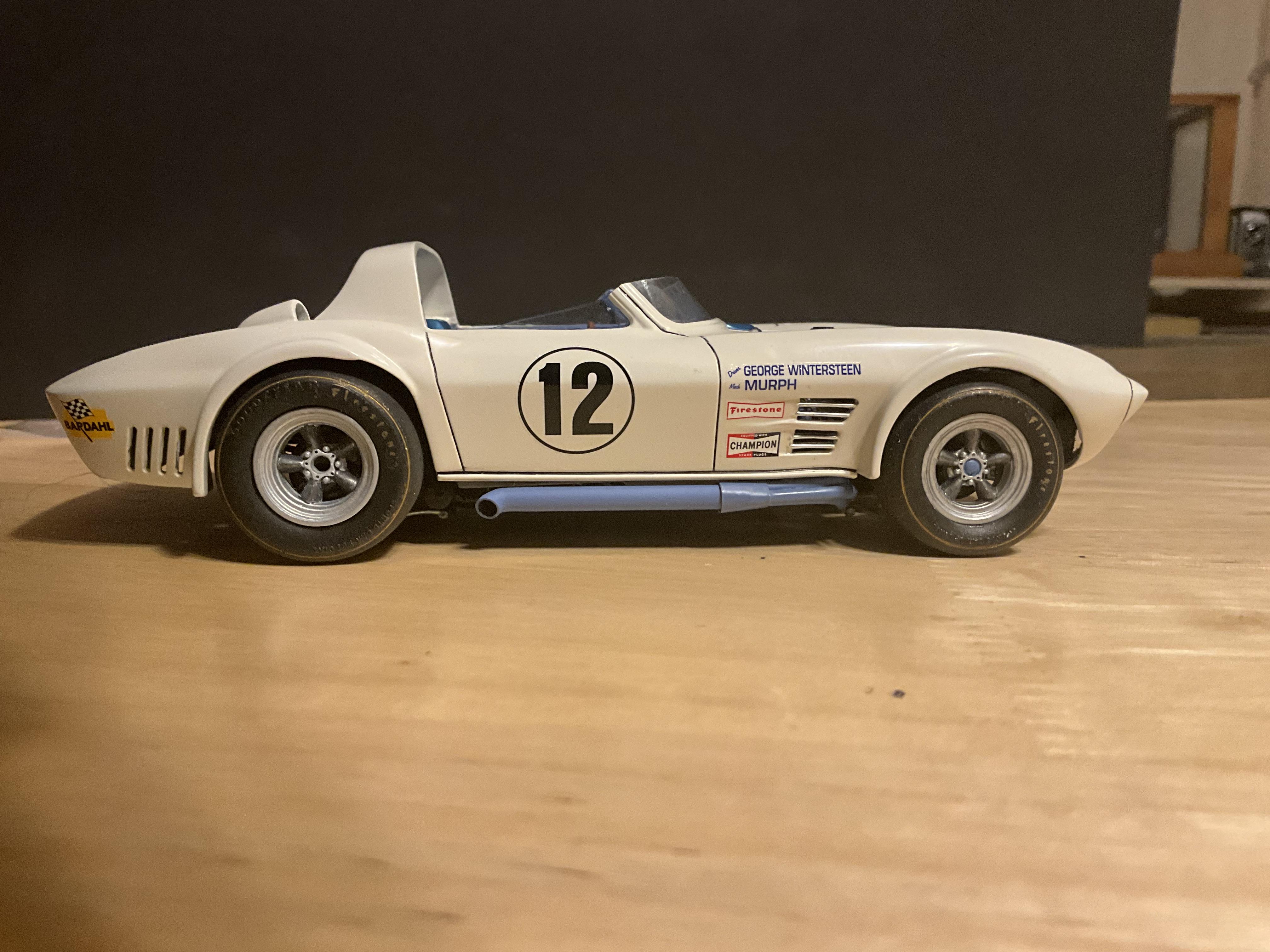

I wanted to share this update.
Got the side pipes and side windows on. Pipes are made from heat bent plastic tubing.
  • Like 1
It's looking great, Mark👍

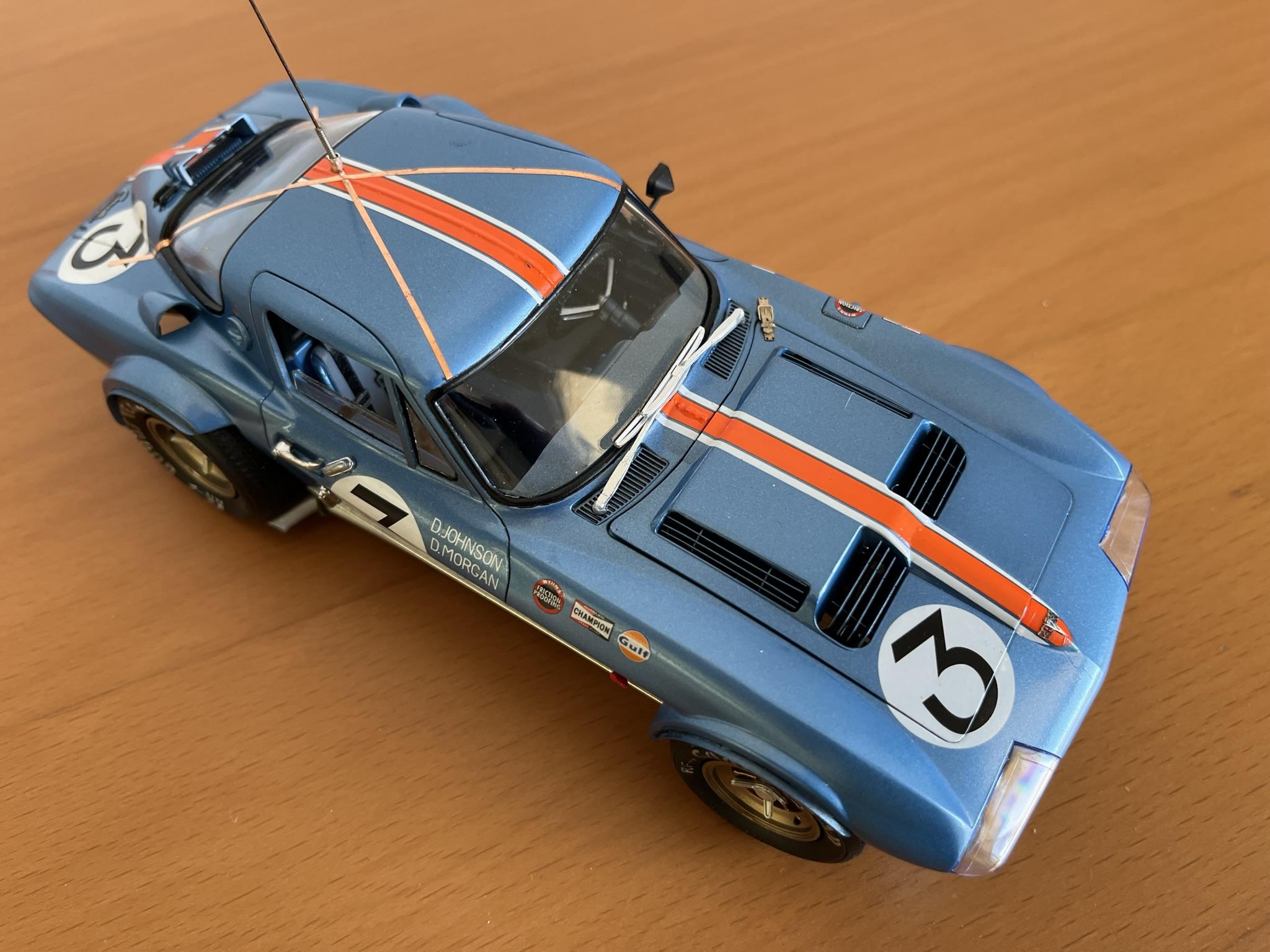

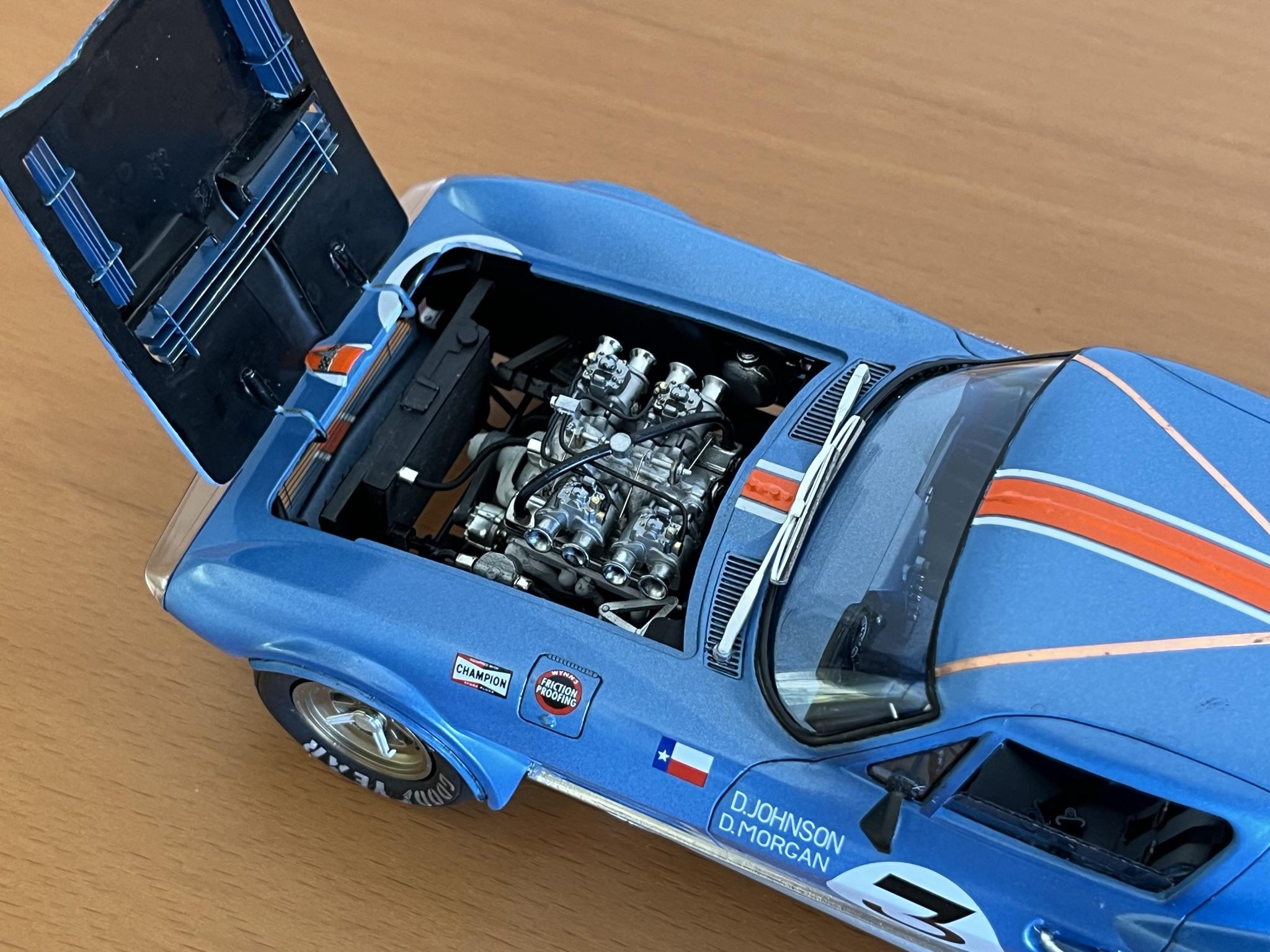

My Corvette Chassis 004 is finished, finally ! It is what it is. I have an other one, now that I know, I might give it an other try, one day. Congratulations again Mark on your beautiful build👍
  • Like 1
You’re too hard on yourself Yves. It turned out great!
I see many details you spent a lot of time on. The stance is good and the hood closes on the engine, a major feat on this kit.
I’m working on my third AM kit, familiarity helps.
Hi Mark, Thank you, it's alright, I guess, I just see the defects from having my nose sticking to it for so long😄. I hope that you'll share your next build. I'll wait a little and now that I know.., I might (one day) build the Grand Sport 1965 Sebring (top white, bottom Mecom blue), but for now, my next big project is the Porsche 910 driven by Niki Lauda (kit Tamiya 1/18, that should be easier😊) but I need to order custom decals, probably from Indycals. I might make my own post on modelcarmag's forum on this one. Until next time, good continuation👋
