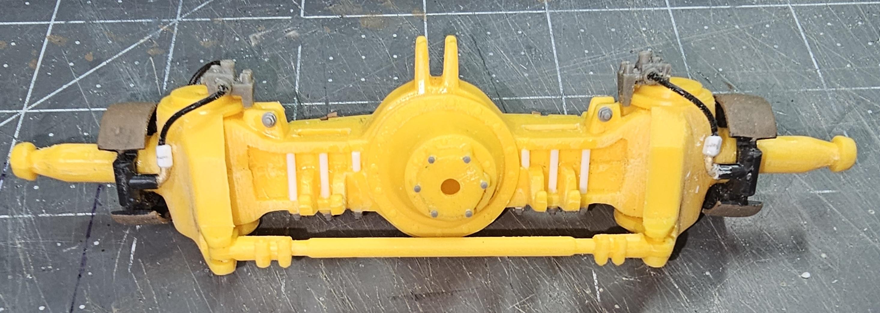

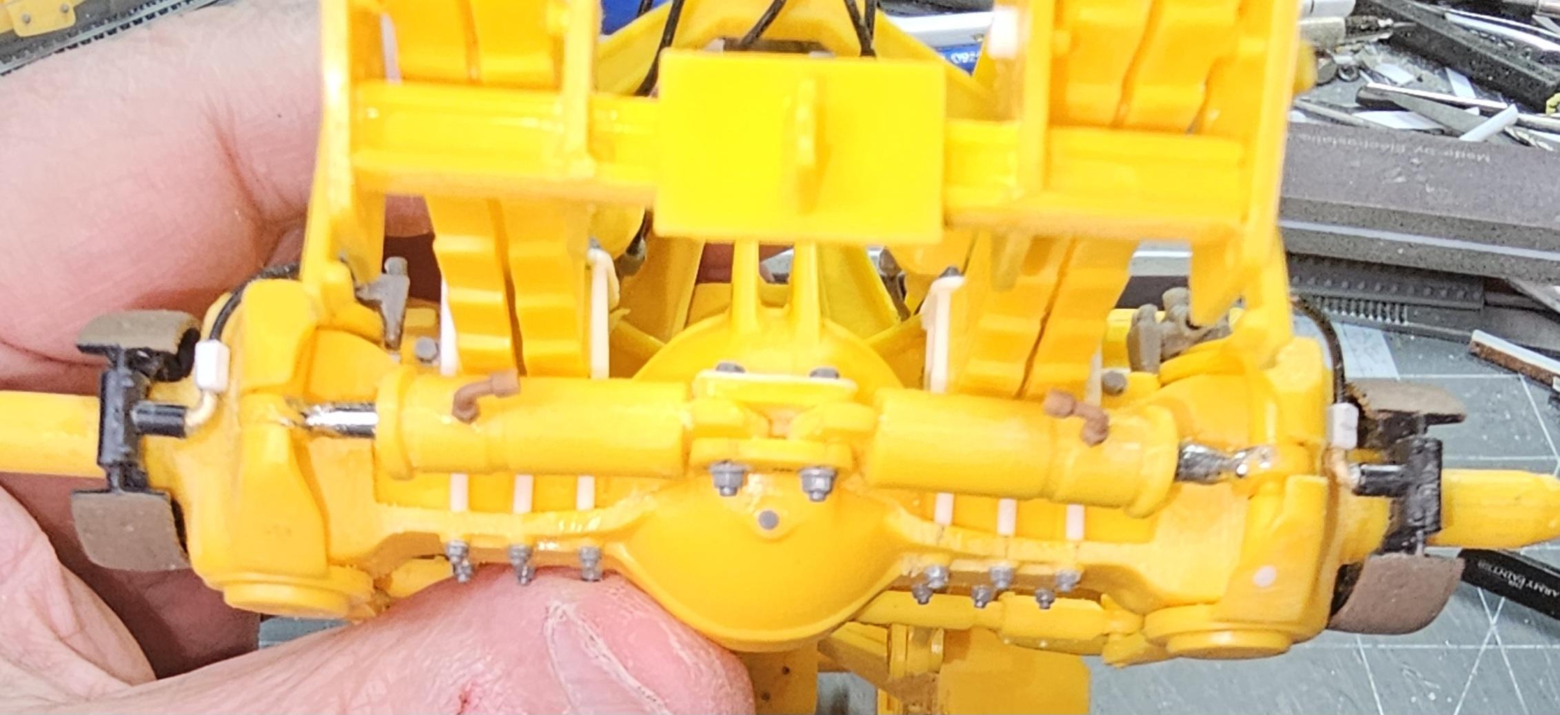

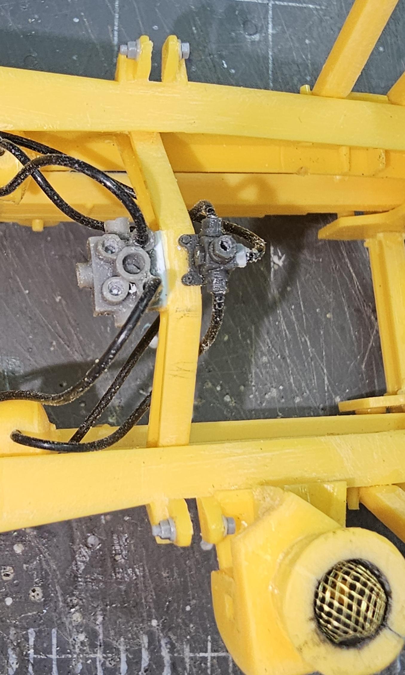

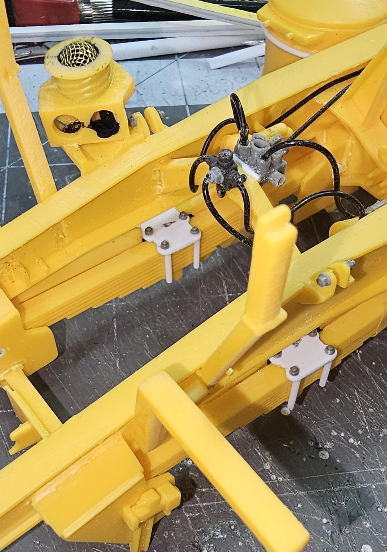

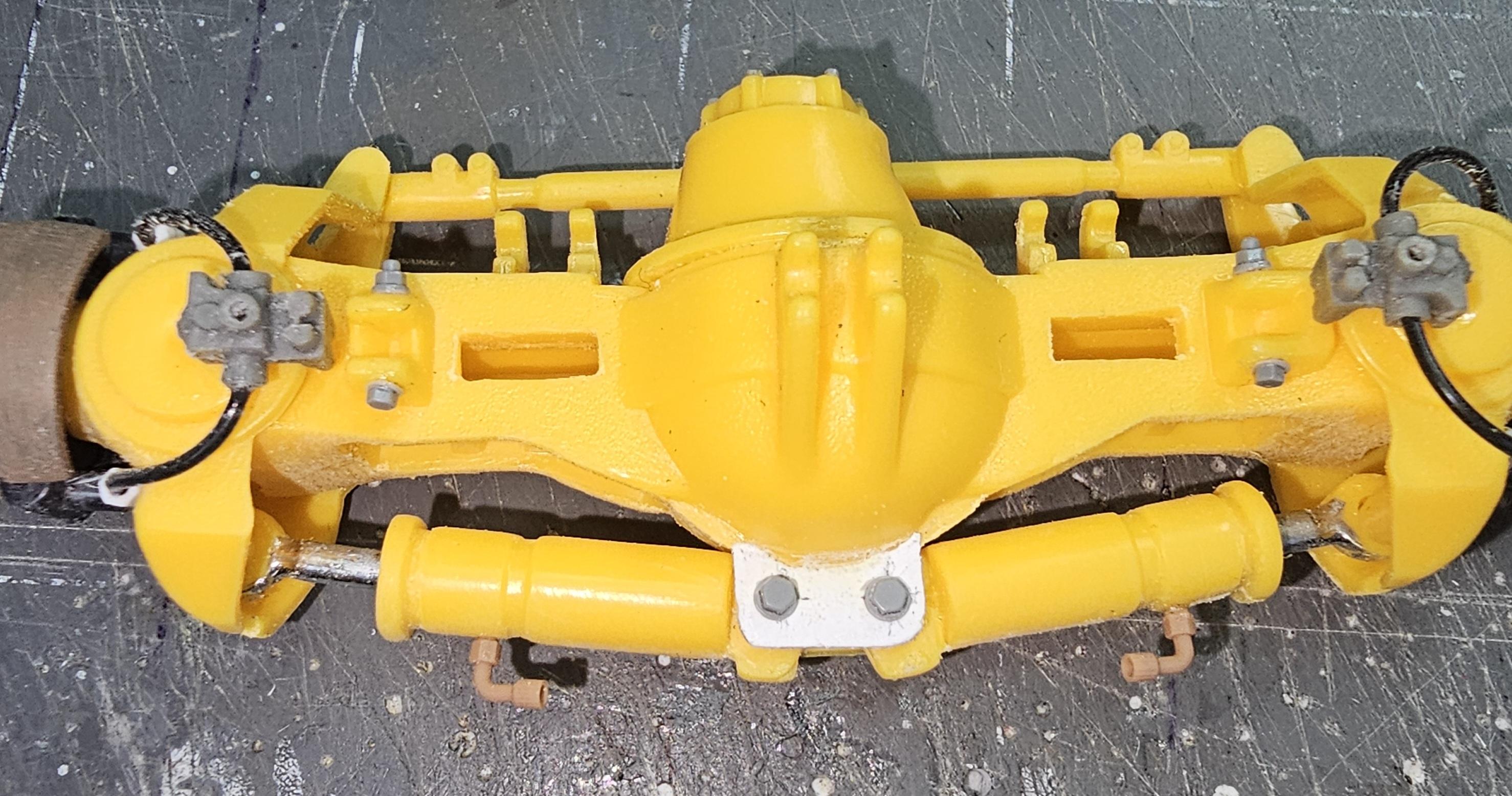

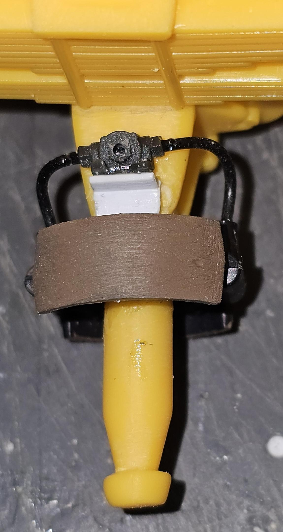

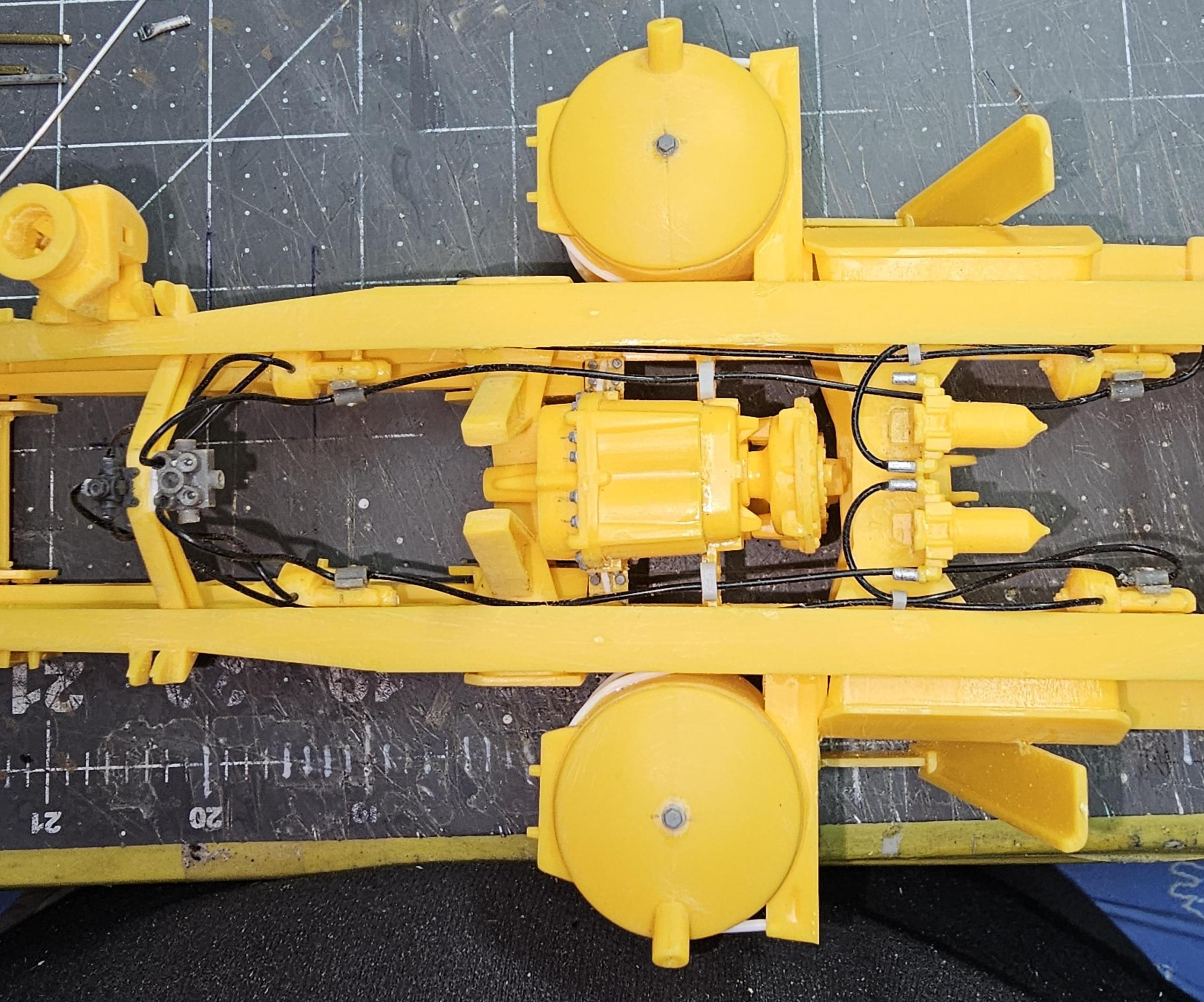

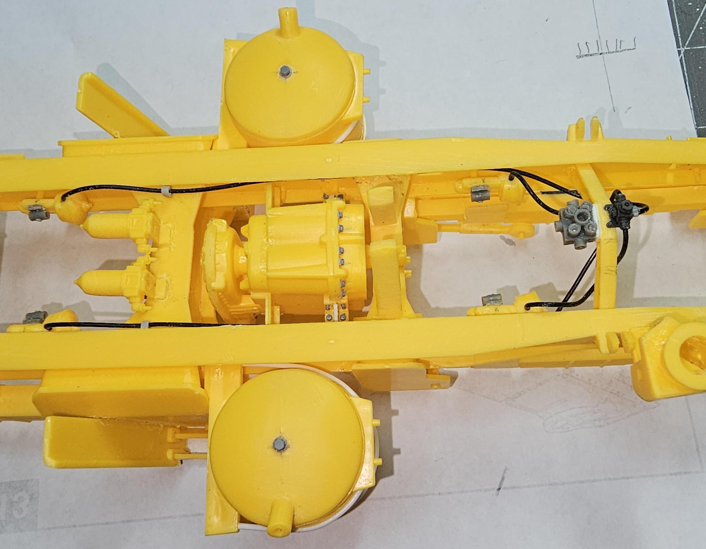

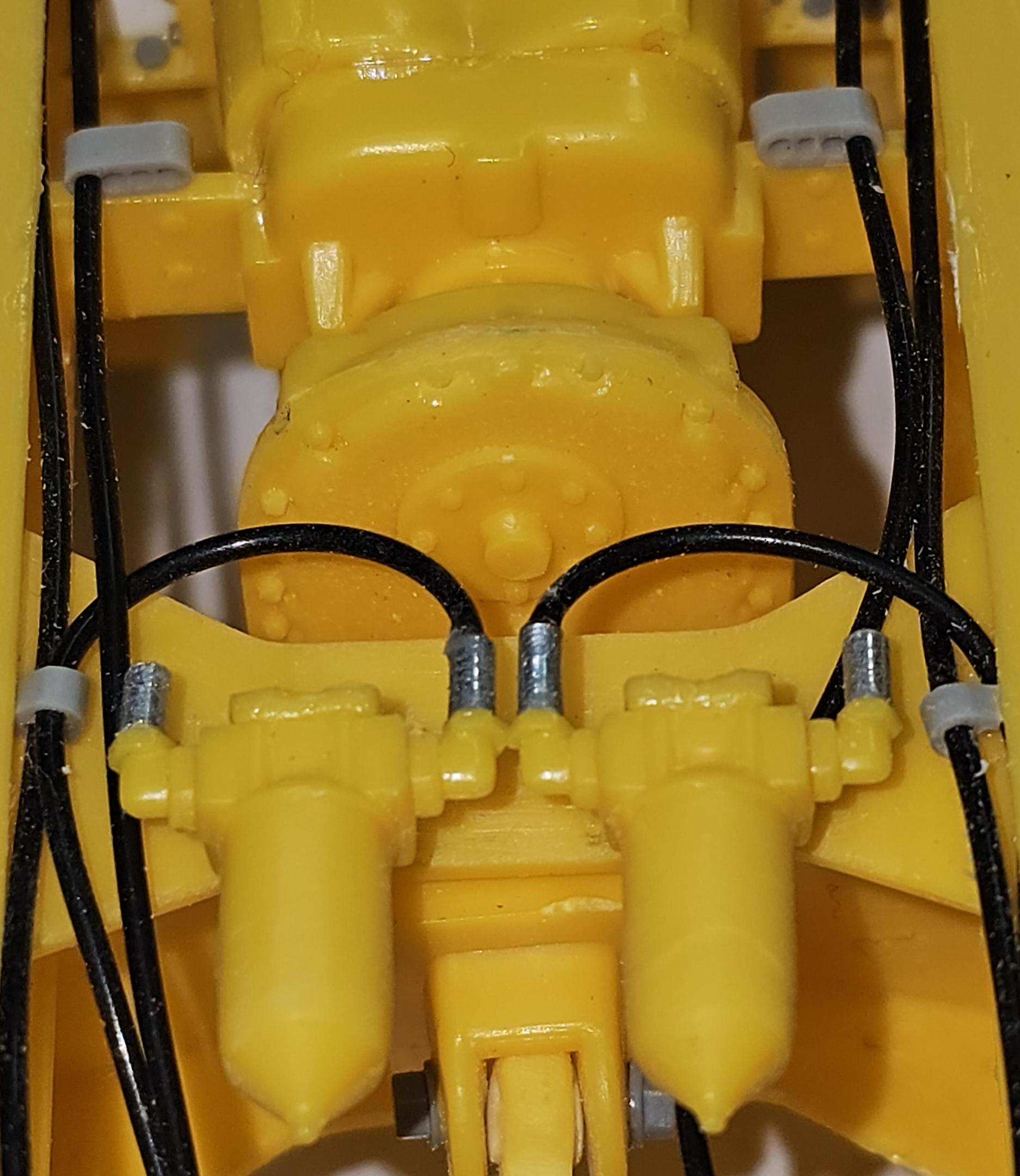

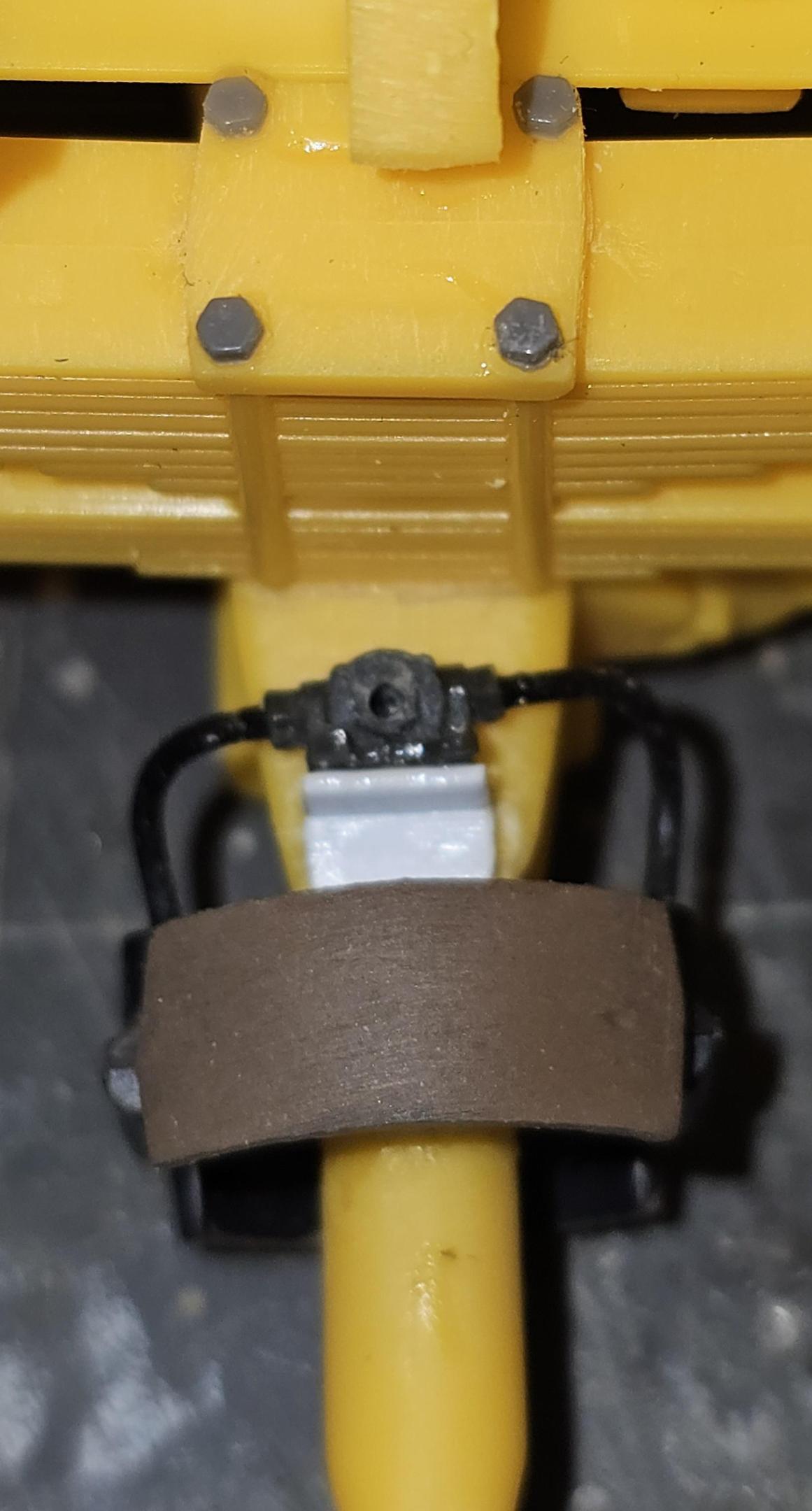

ShakyCraftsman Posted December 18, 2024 Author Posted December 18, 2024 (edited) Hello fellow modelers I'm back with more updates. I started doing some of the plumbing. So here are some pictures for yous all. This view shows the new air valve I added in front of the hydraulic valve. I also started adding the air lines to the brake chambers. This view shows the hydraulic lines I added to the brake chambers abd to the fittings. This view shows the hydraulic fittings I added to the rear axle for the rear brake cylinders. Close up view of the hydraulic fitting for the rear brake cylinders. This view shows the air/hydraulic looms I added for routing the air and hydraulic lines. This is what I made the looms from. It's a peice of old phone cord with the wires removed. I then slice it into various lengths to create the looms. You hold them on with CA glue. This view shows the bolt heads I added to the rear axle. The other side of the rear axle and the bolt heads. Well I'm out of pictures so I guess that's it for now. Ron G Edited December 18, 2024 by ShakyCraftsman 4

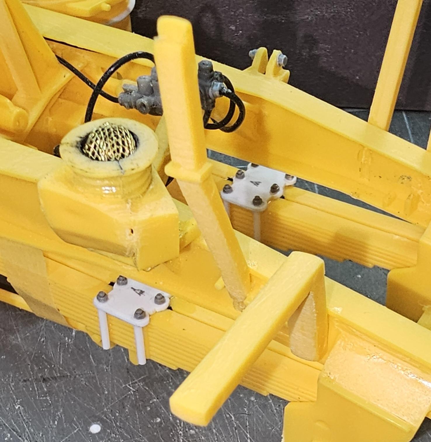

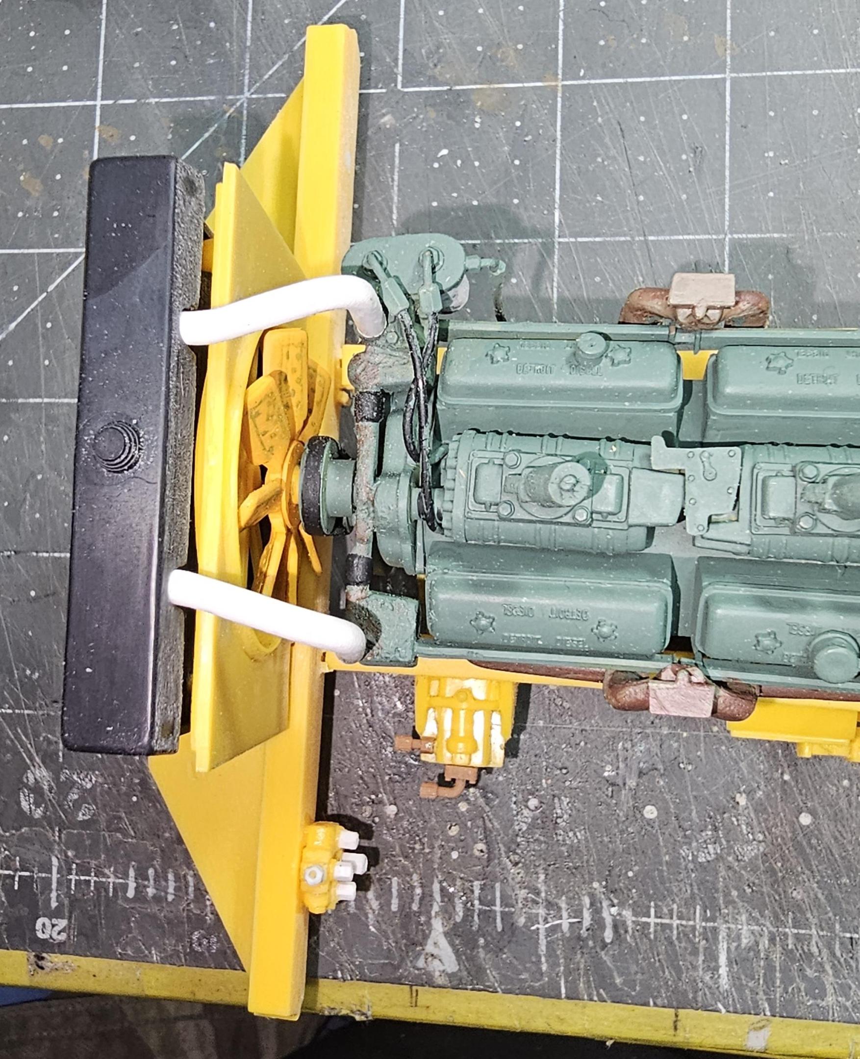

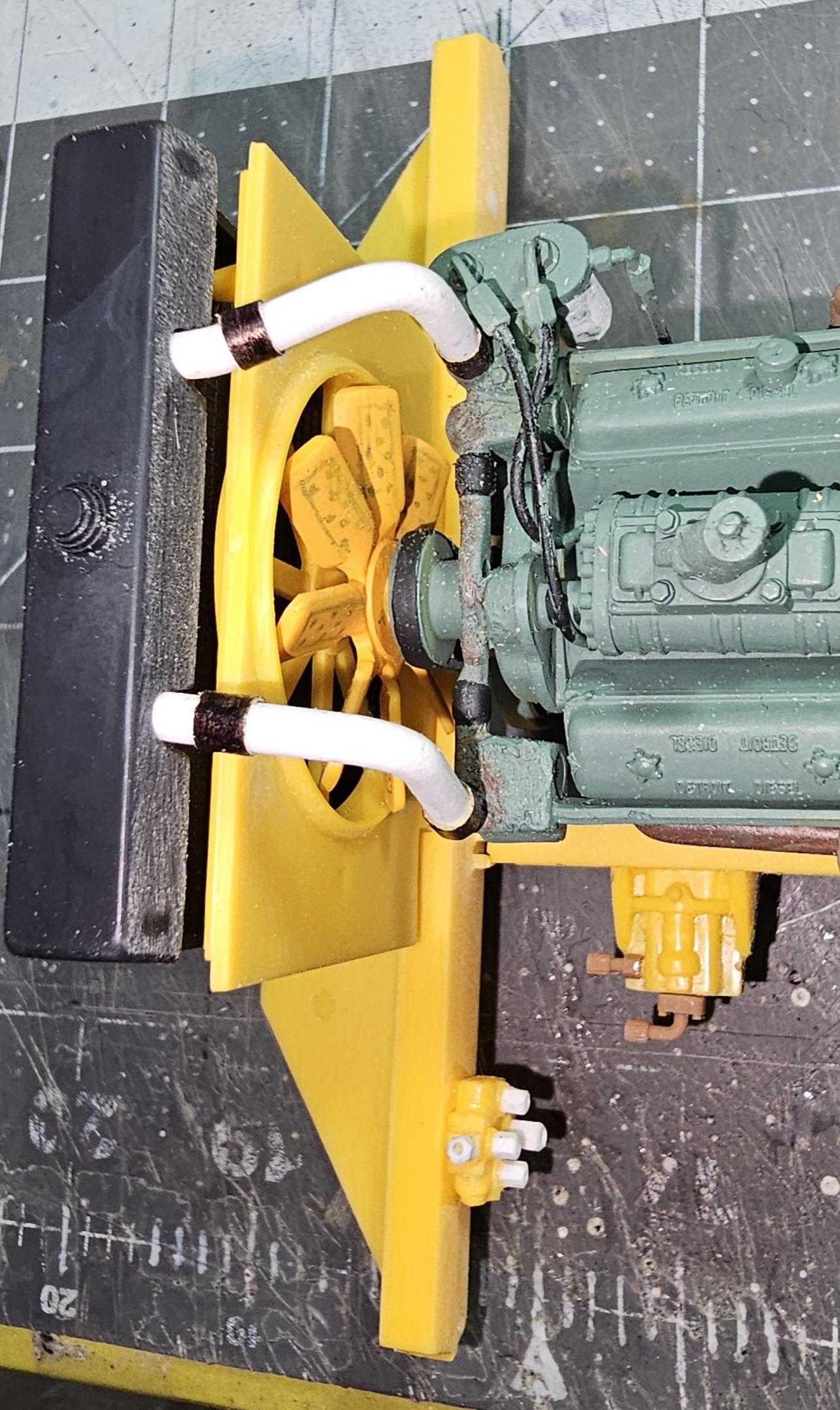

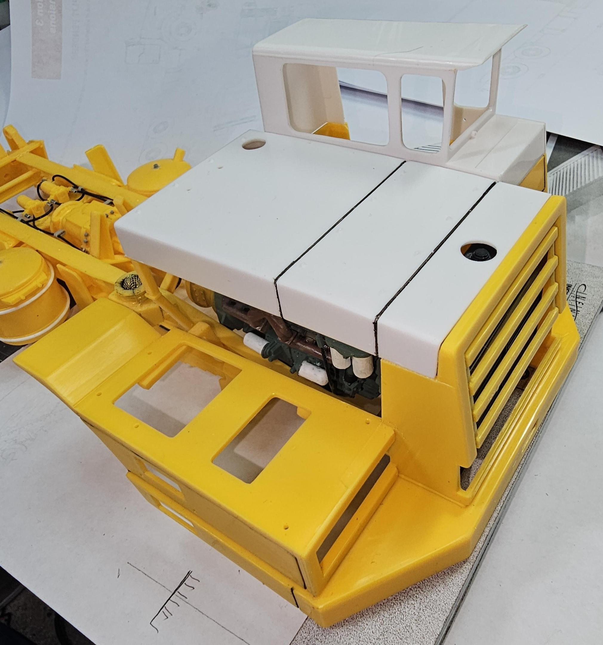

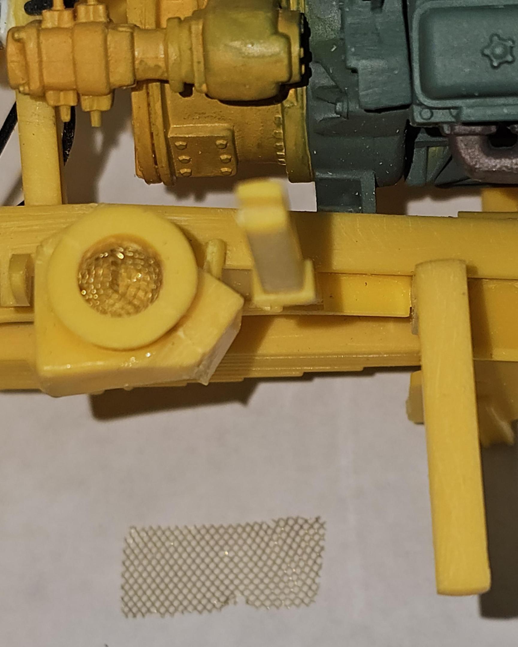

ShakyCraftsman Posted December 19, 2024 Author Posted December 19, 2024 (edited) Hey all Small update today. Got a little more done. It is really amazing to me how all those Small details can take so long to do. I had to replace the kit radiator hoses because they were to short. 🤔 so I made new ones out of some 1/8" (3mm) plastic rod. You can also see the white plastic fittings on the front bumper hydraulic valve. I made them out of some Plastsruct hexagonal rods. I drilled them out for the lines then cut them to size. This took forever. The redish color fittings on the hydraulic valve on the frame are from CTM's hydraulic hose and fittings kit. This view shows the radiator pipes with the hoses added. I made them from rapping some Tamiya masking tape, cut to size then colored them with a black sharpie. This mock up picture shows the radiator pipes in place. This view shows the brass screen that I made and added to the exhaust box on the frame. This view shows it after I painted the inside flat black. This is a mock-up picture for you guys to look at. Well that's it for now be back soon with more updates. Ron G Edited December 19, 2024 by ShakyCraftsman 3

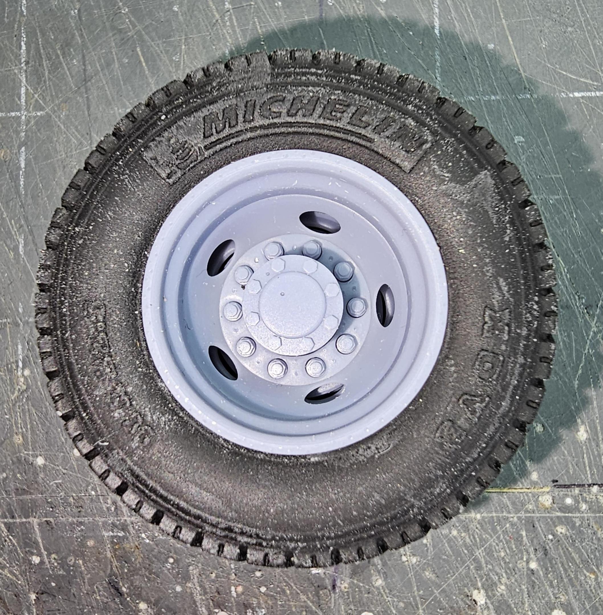

ShakyCraftsman Posted December 20, 2024 Author Posted December 20, 2024 (edited) Hey all Not an update really. I got some stuff in the mail today from Jamie at Mo'luminum. It's items for the "BS" Peterbilt 359. These are Bridgestone 425/65 R22.5 floats. These are some of his drive tires. Michelon 11R 22.5's. This is his Detroit Diesel 12V71N. This will be the engine for the "BS" Peterbilt 359. Ron G Edited December 20, 2024 by ShakyCraftsman 3

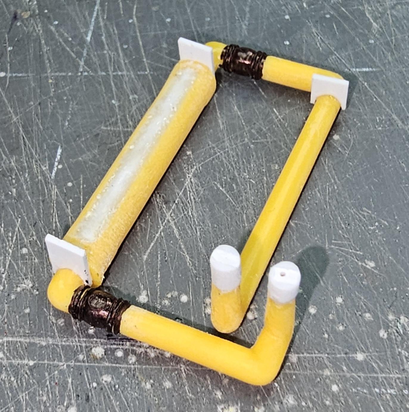

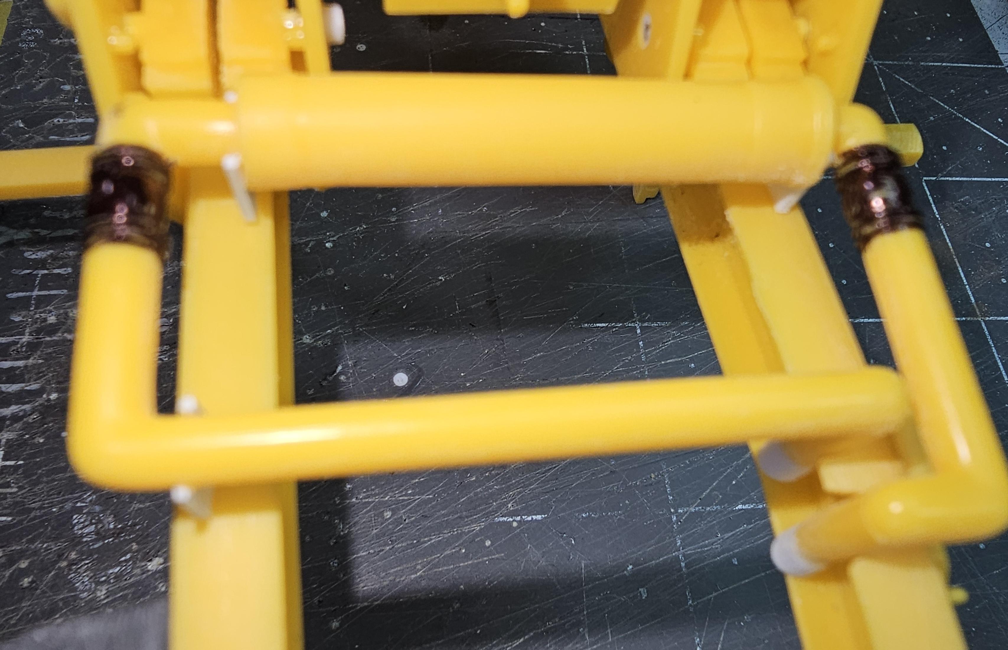

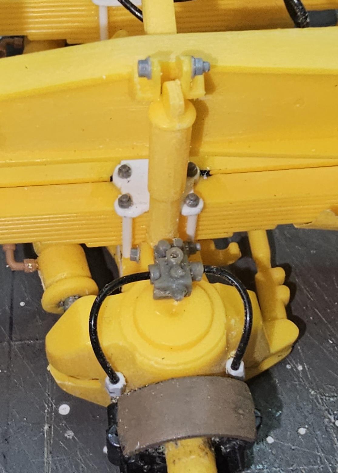

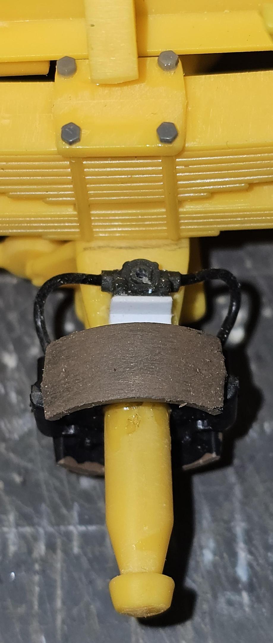

ShakyCraftsman Posted December 22, 2024 Author Posted December 22, 2024 (edited) Hello fellow modelers I'm back with more updates and some pictures for yous all to look at. I really appreciate all the comments, good or bad. So far they have been very positive and are giving me the will to keep trucking on this build. So here we go. This view shows the part #263Y, I'm not sure what this is, sitting in place on the frame. This view shows the part modified so you can actually mount it to the frame with supports. Another view showing the pipe and the supports that I added. I filled in the void also. This view shows it in place with the supports. This view shows the nut & bolts I added to the shock mounts on the rear axle. View from the rear. I had to add some material to the shock mounts on the rear axle so I had a place to fix the nuts and bolts to. This view shows the nuts and bolts I added to the rear shock mounts on the frame. This view shows the nuts and bolts I added to the front axles shock mounts. This view shows the nuts and bolts I added to the front shock mounts on the front of the frame. This view shows the bolt plates and bolt shafts I added to the front springs. Another view of the bolt plates and bolt shafts. This view shows the bolt shafts I added to the front axle. The other side of the front axle. They don't line up perfectly, but they give the proper illusion. At least that's my opinion. Another view of the same thing. This view shows the front shock in place, kinda. It's not fixed yet. And this view shows Jeff and me. I'm the good looking one on the right...lol 😆😅🤣😂 well that's it for now be back with more updates soon, I hope. Ron G Edited December 22, 2024 by ShakyCraftsman 2
