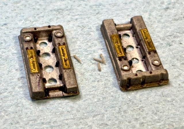

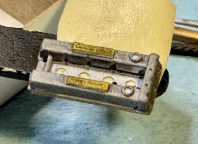

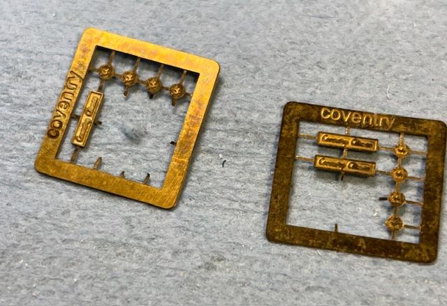

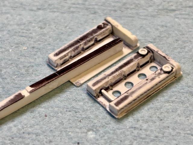

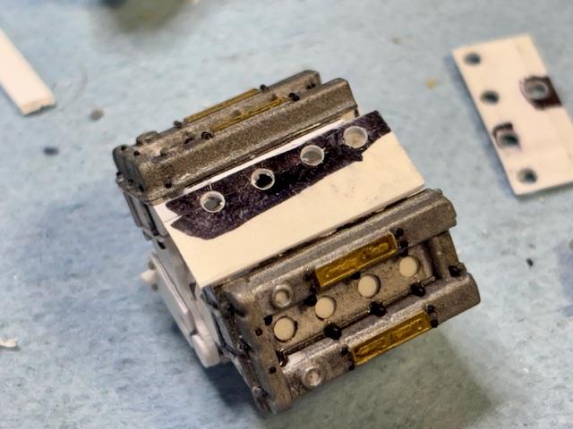

absmiami Posted March 2 Author Posted March 2 Some more Master Club bolts for the cam covers - these are the .020 s - the smallest ones that they made … 1

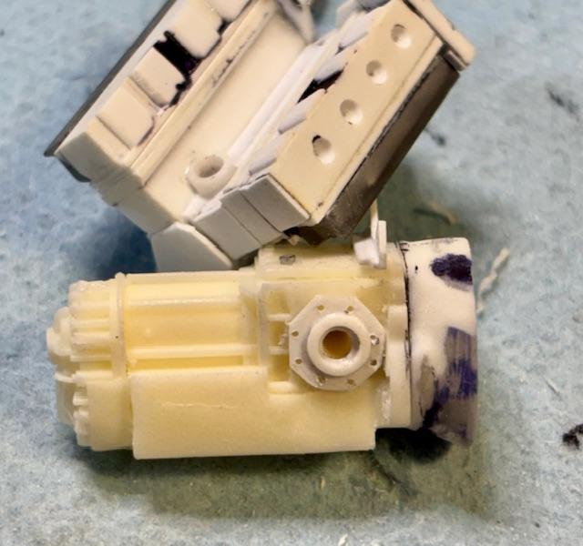

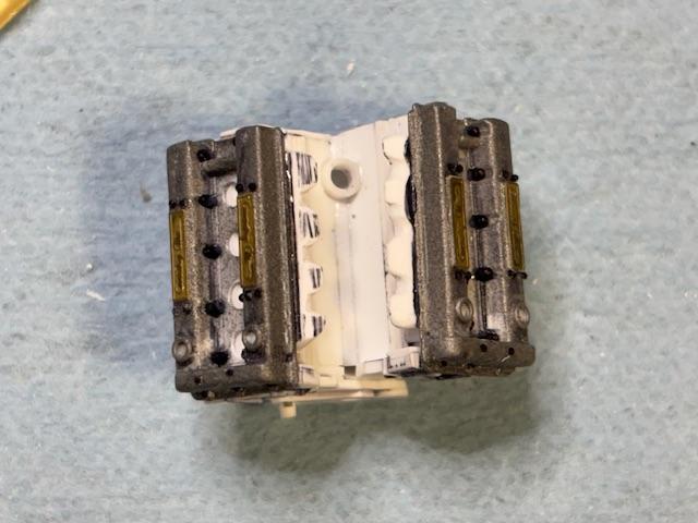

absmiami Posted March 3 Author Posted March 3 This engine was run by Lotus, Brabham and Lola in ‘62 with four Weber carbs - the survivors - restored cars - all have fuel injection - the Climax engines were coverted to fuel injection in ‘63 - so i next need to make the manifolds that will support both …

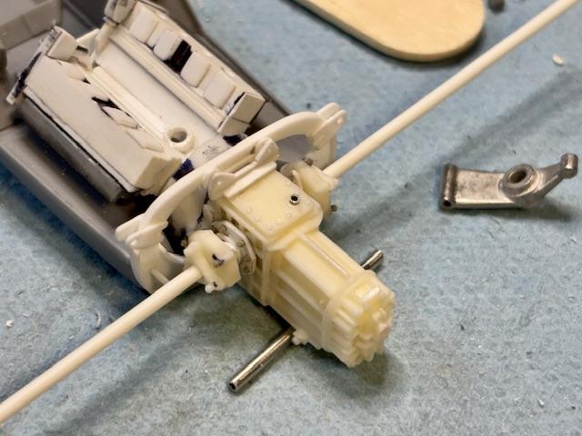

absmiami Posted March 5 Author Posted March 5 Scale compromise - these are 24th scale Webers - 3D printed - the good stuff - but they won’t quite fit under the bonnet …
absmiami Posted March 5 Author Posted March 5 So back they go into the stash - this is a set of 25th scale Webers - just a little smaller - these will fit …

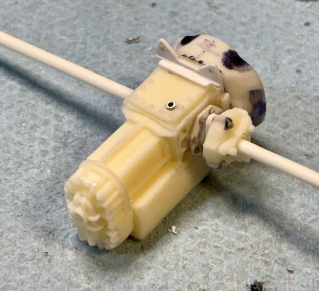

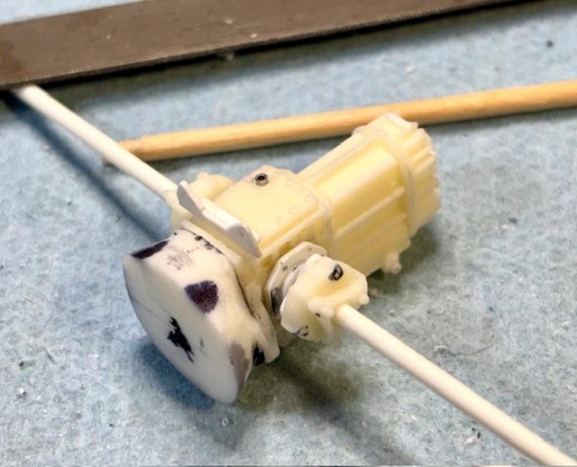

absmiami Posted July 21 Author Posted July 21 Making mine by modifying a GT 40 transaxle casting that models a later ZF box - including making the side plates …

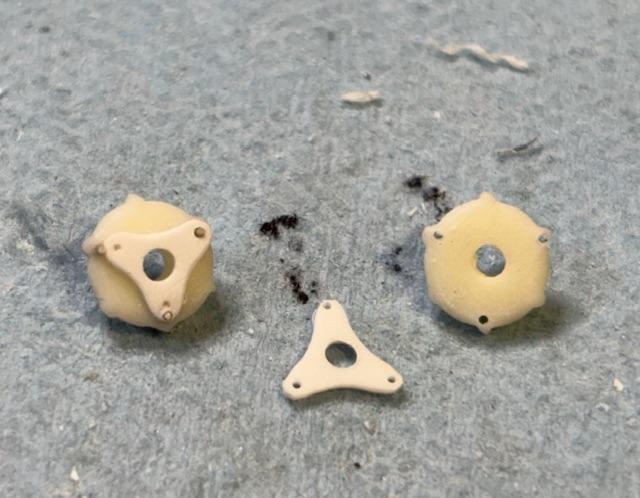

absmiami Posted July 21 Author Posted July 21 And adding some detail to the half shaft couplings - which were rubber donuts during the 62 season …
