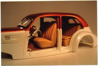

E St. Kruiser50 Posted April 23, 2009 Posted April 23, 2009 (edited) I think useing real leather would be too thick for models, particularly smaller 1/24 scale models. Might be suitable for 1/18's and 1/16's. But I doubt it'll work for 1/24. I'll have a look at SMS's web site and see if they have anything of wood-style. However, I dont' think wood is as popular as CF is. Well my friend you sound like quite an expert on the subject of scale leather interiors. That's pretty cool. Maybe you'd have a suggestion on how I could have done a better job on this scratch-built all leather interior in this 1/25 scale Hollywood Graham that won a first at the GSL in 2005. I could use any help I can get on this - dave Edited April 23, 2009 by Treehugger Dave

jbwelda Posted April 24, 2009 Posted April 24, 2009 well thats a pretty sharp interior there dave, no arguing that. but more to the point, when i have attempted real leather, which has been rarely. its usually seemed too thick to really look right. then i read an article in a magazine much like our hosts, and the author was demonstrating how to thin the leather by slicing it and another trick or two to make it thinner. so i tried that and it turned out very nice. unfortunately its stuck inside a chopped top and you cant even hardly see it! probably shoulda opened the doors. doh.
lonewolf01 Posted April 24, 2009 Posted April 24, 2009 hey dave love the leather seats , but can you explain how you made the tucks and rolls and with your leather do you have to thin it down?
FujimiLover Posted April 24, 2009 Author Posted April 24, 2009 Well my friend you sound like quite an expert on the subject of scale leather interiors. That's pretty cool. Maybe you'd have a suggestion on how I could have done a better job on this scratch-built all leather interior in this 1/25 scale Hollywood Graham that won a first at the GSL in 2005. I could use any help I can get on this - dave I am certainly no expert at all thus my reasoning for starting such a thread. Appearently, your the expert and I would've never guessed that was real leather? I just assumed the fabric itselfe would be too thick. Will have to have a look at Hobby Lobby and see what they have for materials and maybe find something suitable and try it out! Are there any sticky-backed leather kit's?
E St. Kruiser50 Posted April 24, 2009 Posted April 24, 2009 I am certainly no expert at all thus my reasoning for starting such a thread. Appearently, your the expert and I would've never guessed that was real leather? I just assumed the fabric itselfe would be too thick. Will have to have a look at Hobby Lobby and see what they have for materials and maybe find something suitable and try it out! Are there any sticky-backed leather kit's? In this hobby of ours, you have to think "WAY BEYOND" hobby shops to reach a level of building anywhere beyond "BASIC", which is fine if that'd where you want to stay. There is so much out there available to make this interest of our's so much more fun and enjoyable. The leather I use is not much thicker than a cigaette wrapper, and comes in "FULL SKINS". It comes from the country of DENMARK , and is tanned in SWEDEN, and is very soft and stretches wonderfully around compound curves. The wood??....We'll I buy mine from a rare wood importer and hand carve everything to shape - dashes, door panel moldings, etc. Zebra wood, Lignum vitae, cochabola, or I buy or make my own veneers. Go to places that sell leather and wood as a business, and you'll discover a whole new world waiting for you - dave
