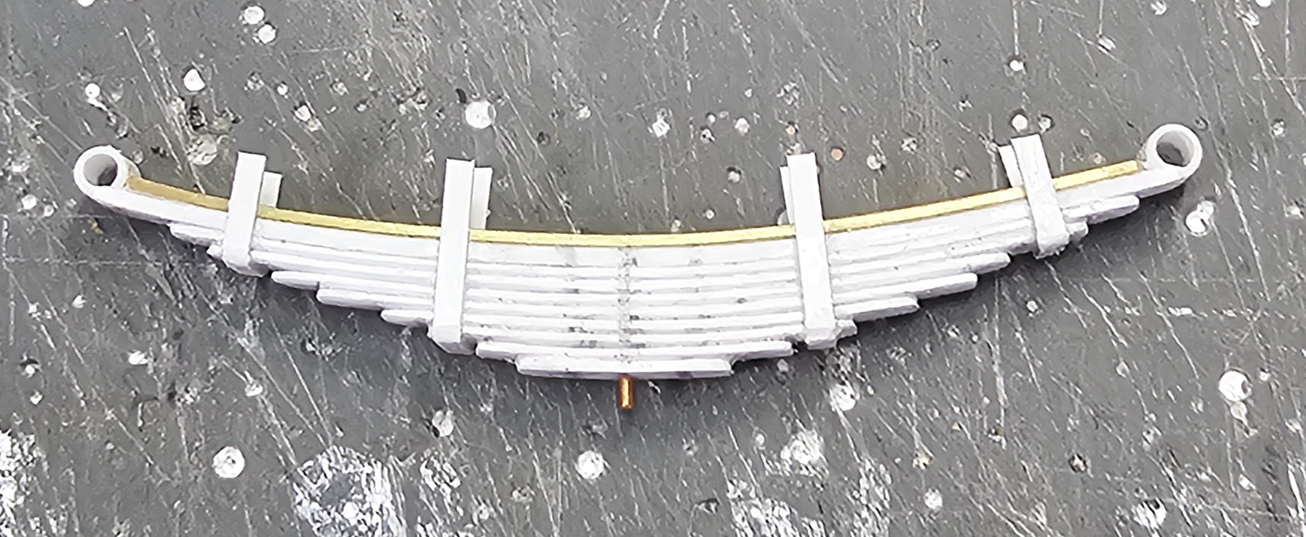

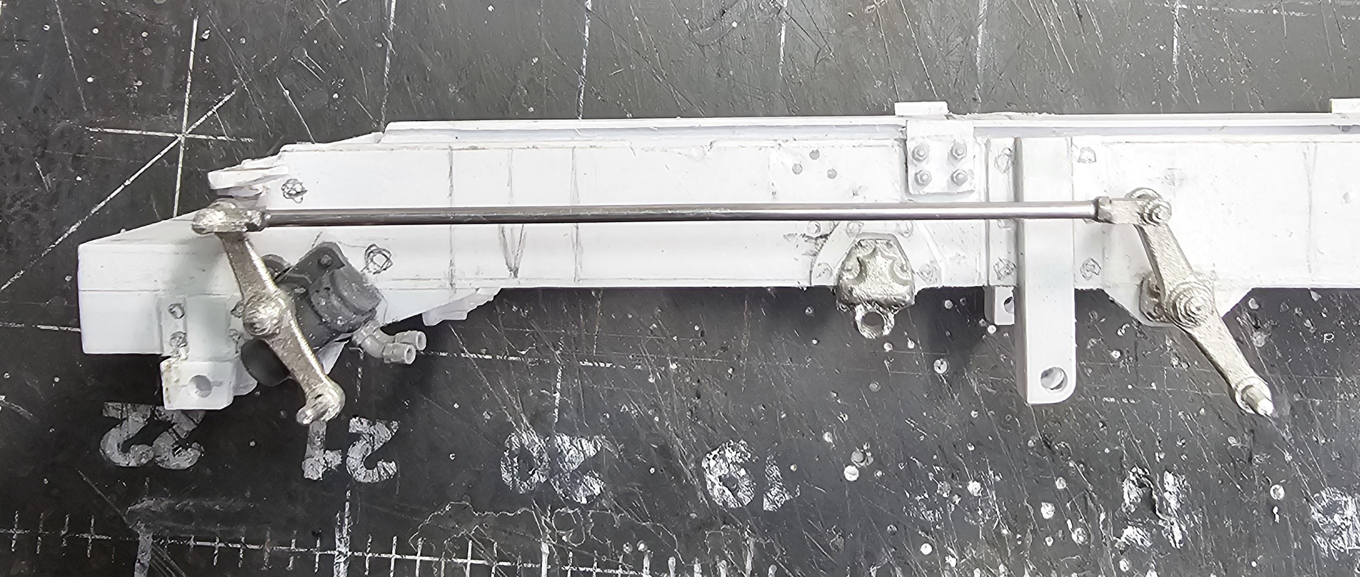

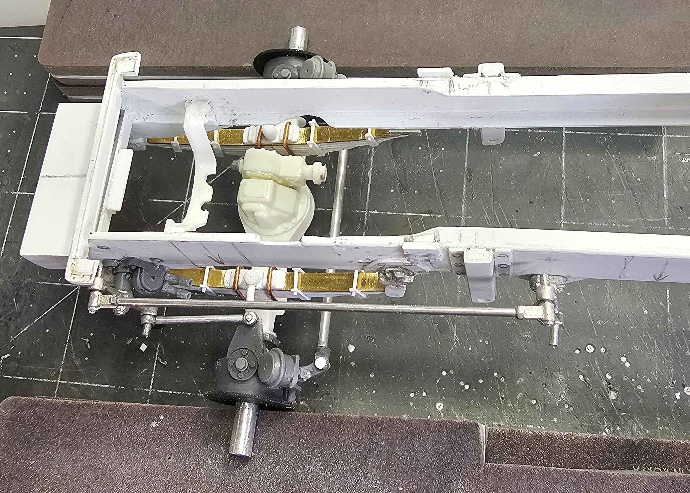

Hey all
Got some more done on this build. I've been working on the front springs and steering system.
20250407_122305.jpgThis view shows the spring "U" bolt & shock mounts.
20250407_125739.jpgThis view shows the spring with the start of the spring clamps.
20250407_135436.jpgThis view shows one of the completed front springs.
20250407_135447.jpgThe other side of the front spring.
20250407_162050.jpgThis view shows the steering box and linkage in the neutral position.
20250407_162100.jpgThis view shows the steering turning left.
20250407_162109.jpgThis view shows the steering turning right.
20250407_163839.jpgThis view shows the springs on the first front axle along with a shock.
20250407_173525.jpgThis view shows the front axle and springs mounted with the tires.
20250407_173649.jpgThis view shows the front suspension from the side.
20250407_173657.jpgThis view shows the front from the top.
20250407_173754.jpgCloser view of the front springs, "U" bolts, shock mount and steering linkages. Well that's all for now be back soon with more updates.

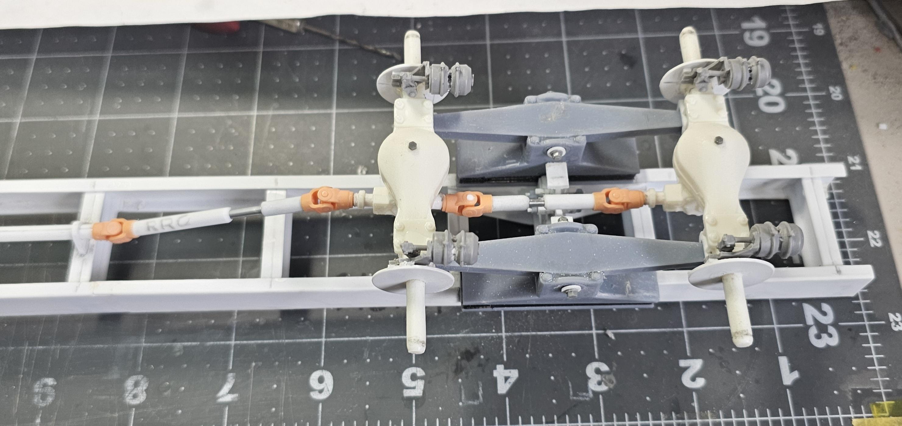

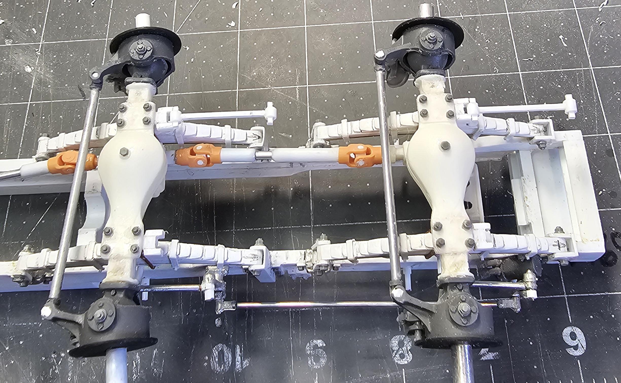

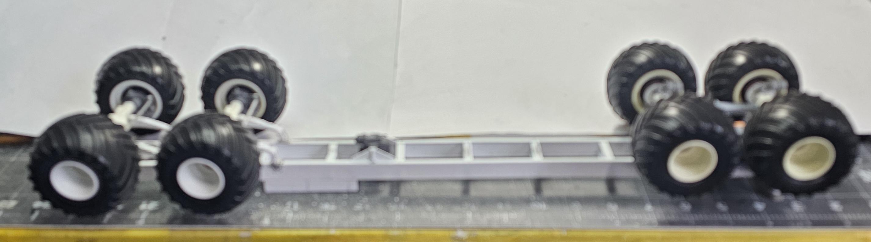

Hey all
Got some more work done on this build. I now have all of the front suspension, rear suspension and "U"joints installed permanently and ready for paint. Because this is Sooo big. I'm going to paint the rear first, then the front. It won't fit in my paint booth. It will all be semi gloss Tamiya black.
20250408_142348.jpgThought I would start with a little mock-up.
20250408_142509.jpgThis view shows the engine, radiator and trans drive shaft.
20250408_142514.jpgThis view shows the center drive shafts from the top.
20250408_142543.jpgThis view shows the rear drive shafts and rear suspension.
20250408_142826.jpgThis view is looking down through the engine compartment.
20250408_142835.jpgThis view shows the center drive shafts from the top.
20250408_142832.jpgThis view shows the rear drive shafts from the top.
20250408_142902.jpgThis view shows the front drive axles, drive shafts transfer case.
20250408_142905.jpgView of the drive shafts from the bottom.
20250408_142907.jpgView of the rear suspension and drive shafts from the bottom.
20250408_150946.jpgThis view shows the nuts/bolts/washers I added to the front differentials. I did the rear ones also, but didn't get any pictures.
20250408_152923.jpgThis view shows the left side of the frame and the bolt heads I added to the front suspension mounting brackets.
20250408_161330.jpgThis is a view of the other side bolt heads I added. Well that's it for today I'll be back soon with more updates.
Ron G
Edited by ShakyCraftsman
  • Like 2

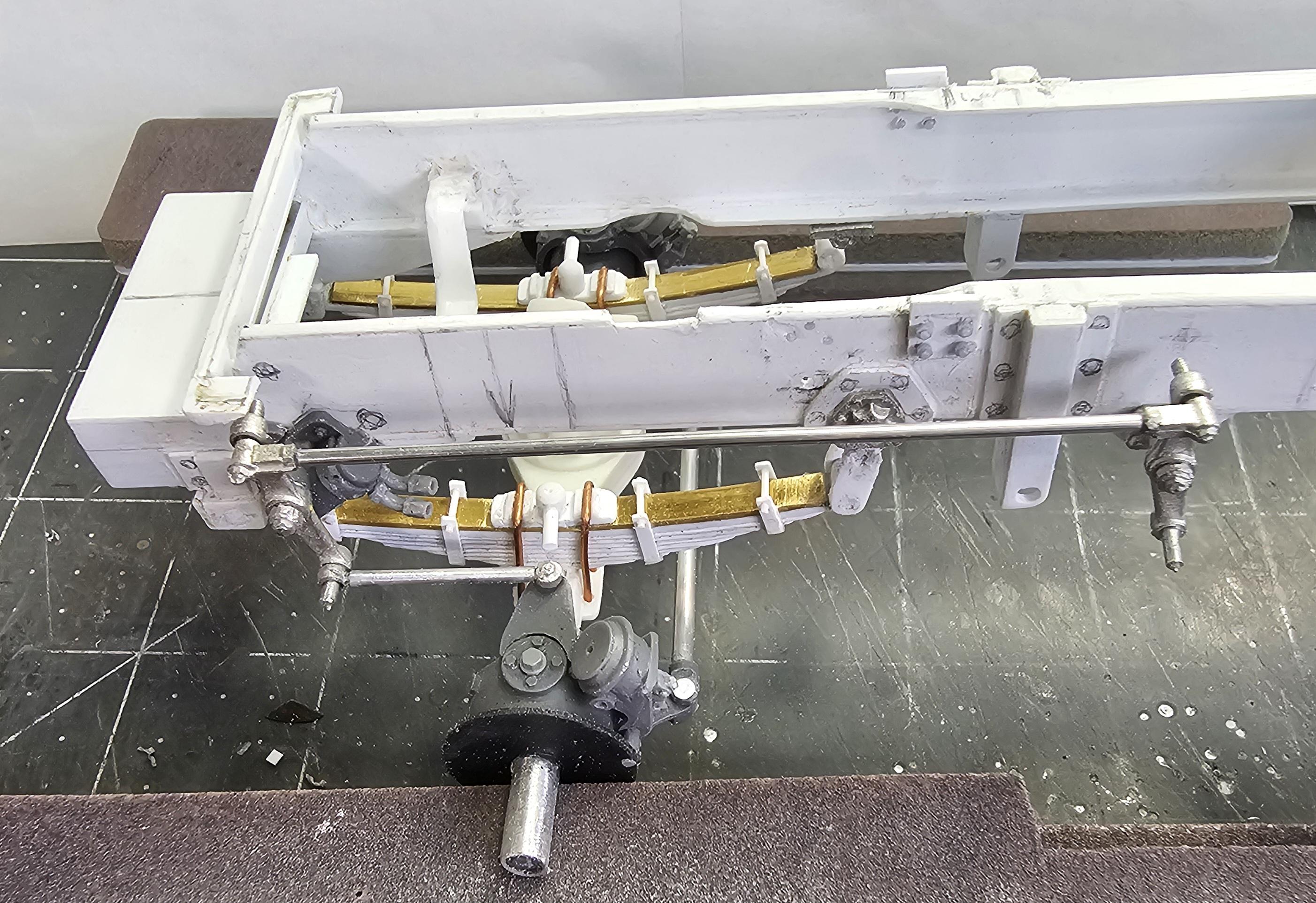

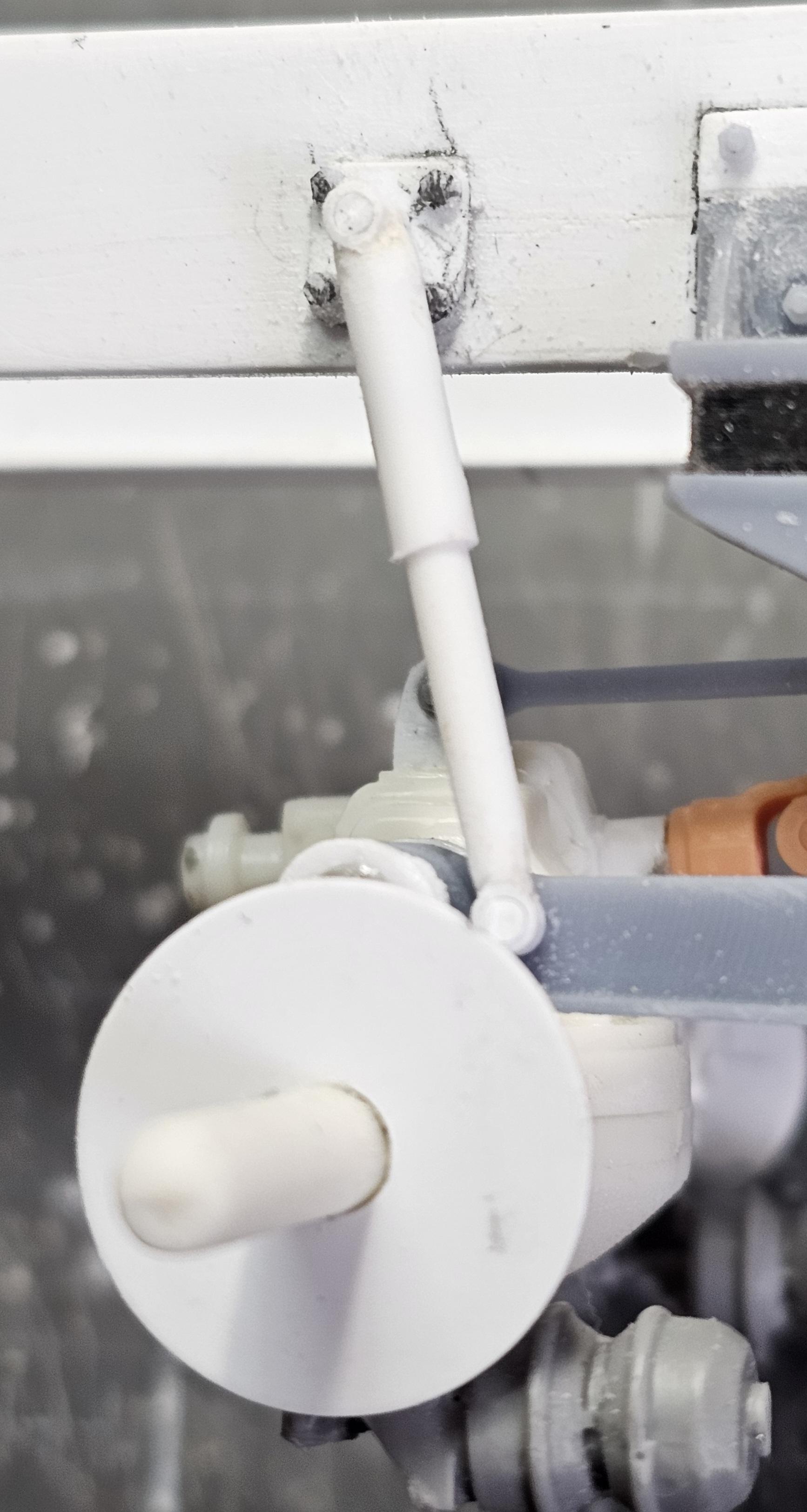

Hey all
 I got a start on the front equalizer rods (torsion rods).
20250411_154358.jpgThis view shows the equalizer rods on the passenger side sitting in place. I still have to make the other side plus the mounting brackets.
 I my get this painted...eventually...lol
Ron G
  • Like 4
