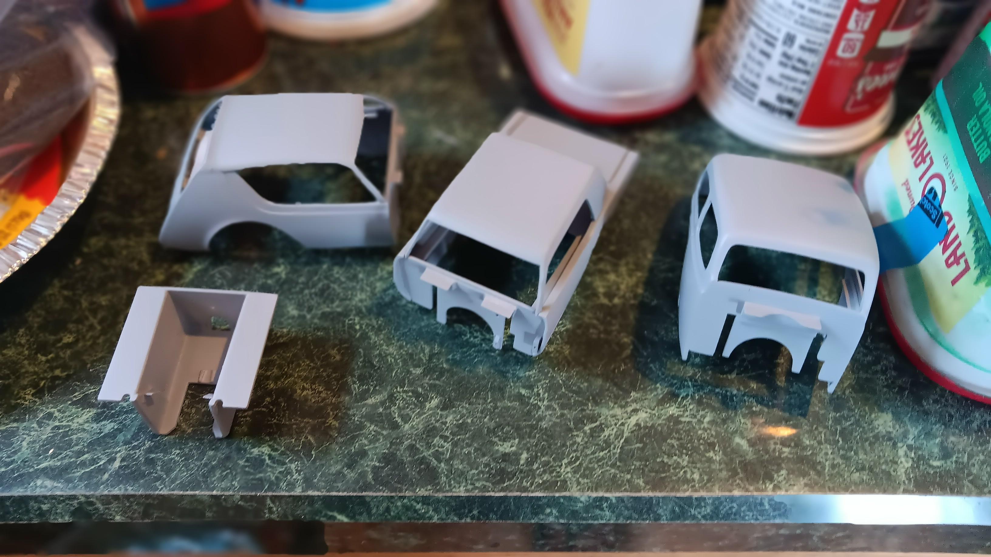

My kitchen counter looks like a modified junkyard. All 3 bodies are in final or final-ish primer.
The chassis on the counter goes with the Gremlin, where it started.

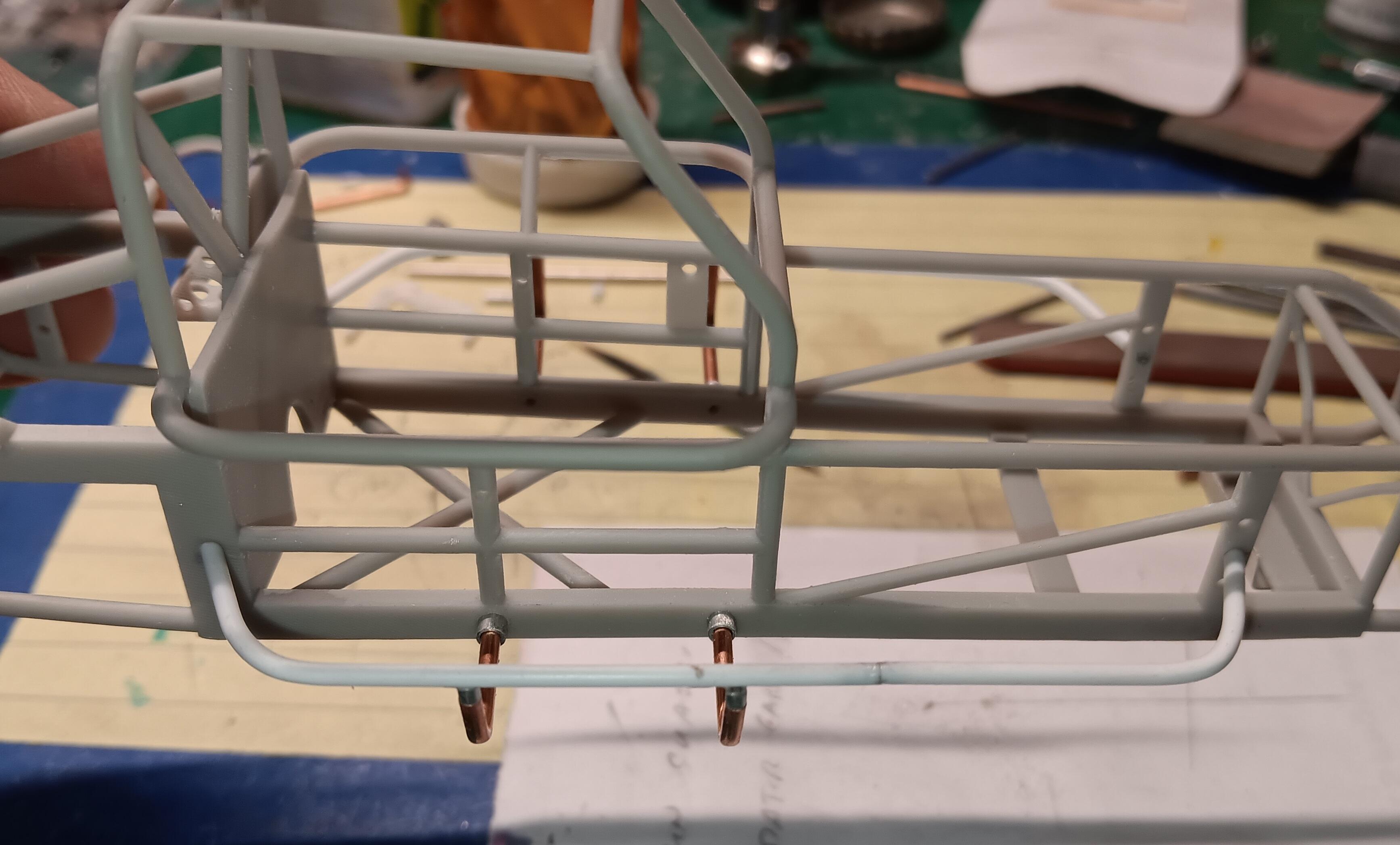

The 3D chassis is kind of complete. I need to pick a convenient place to lop the cage off, so the tub will go in. The uprights are .080" and the horizontal bars are .060".
The chassis was printed with a wall behind where the tub goes in. So I may have to cut up the tub.
I'm happy with the side rails. I was sweating that out.

I made a major oopsie with the bars on the printed chassis... see if any of you can spot it.
Good thing I got that new razor saw.

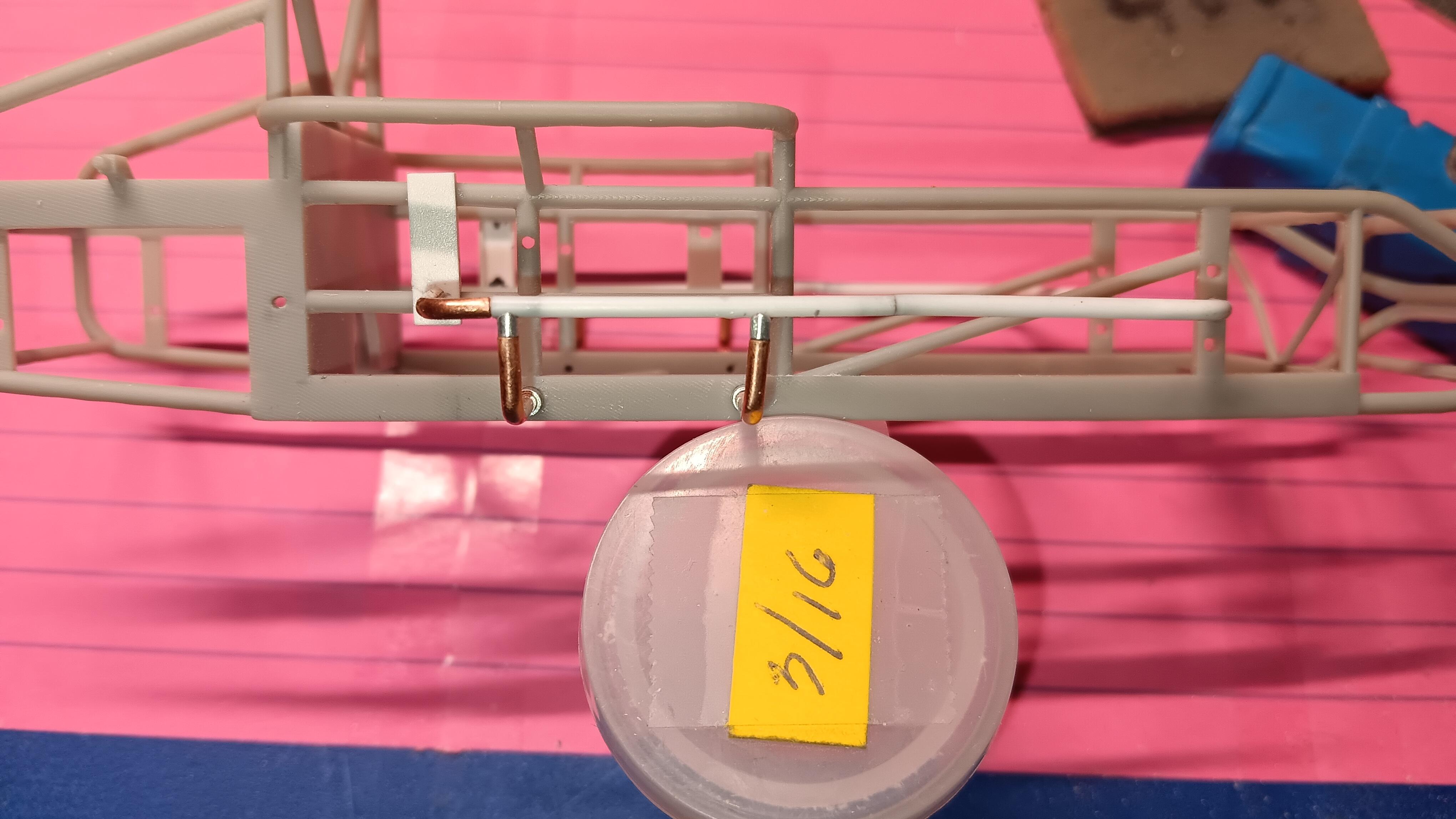

For the rear horizontal attachment, I chose something really convenient without thinking of the rear axle location. AND... I only have 2 other completed examples to look at. It was only about 14 mm off.
Copper is really cool to work with over aluminum. I can hold it tighter in the vise without crushing it. Also it cleans up nicely. It is a bit harder to bend and file.
I had a couple of copper tubes in my OOPS! inventory already bent up. The next 2 hours was devoted to making them fit what I had going on.
A couple of 1/32" pins and some CA glue, I'm back in business.
Not pictured, but with the body I took about 5 mm off the rockers and cut the bar slot deeper.

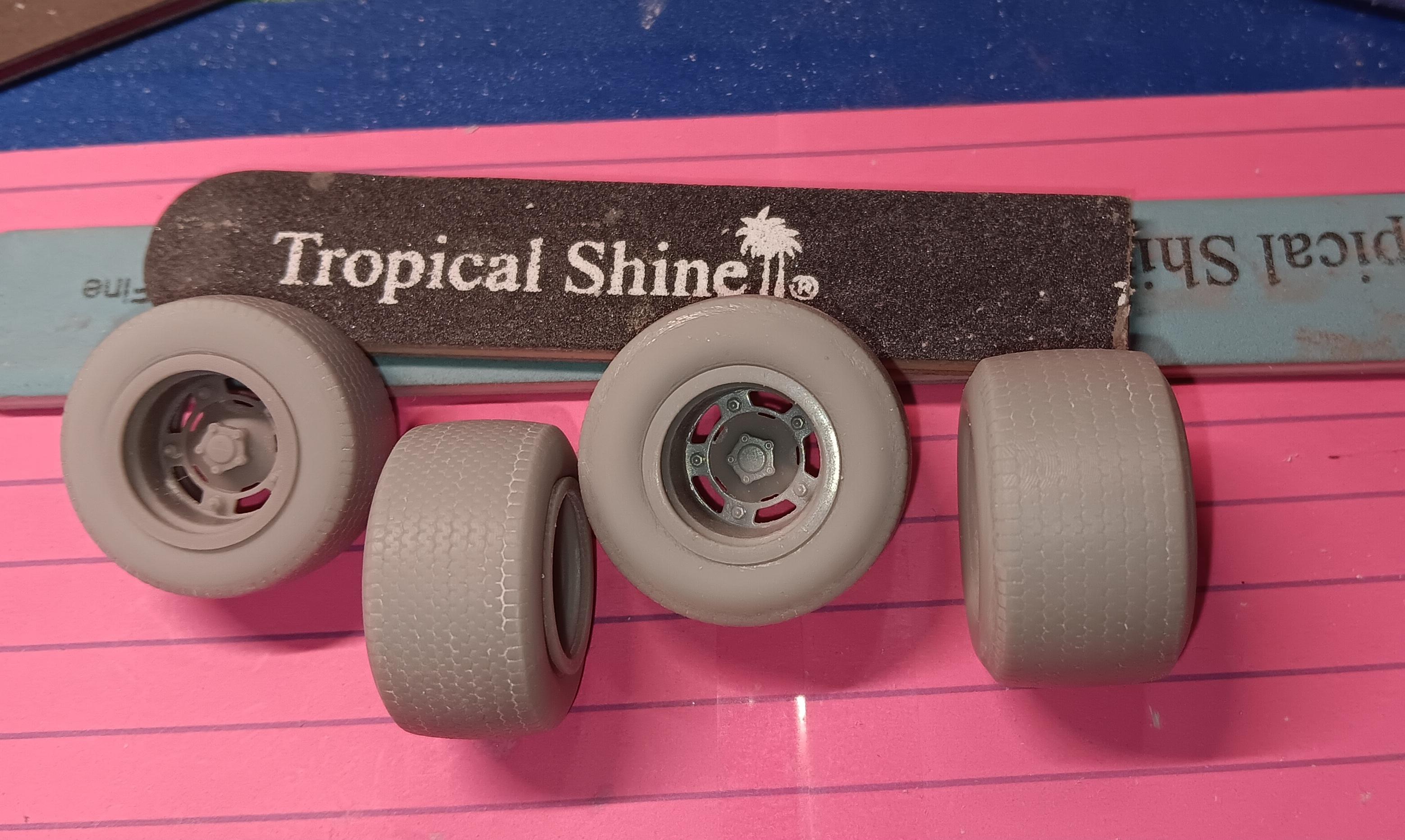

I got another Ron Coon Resins order, finally picked wheels and tires for the Mustang.
He has nice wheel backs with good drum brakes detail.
Wheels are painted. I used a Model Master metallizer and an acrylic Vallejo Bronze for the centers.
That thinned nicely with a few drops of water added to it

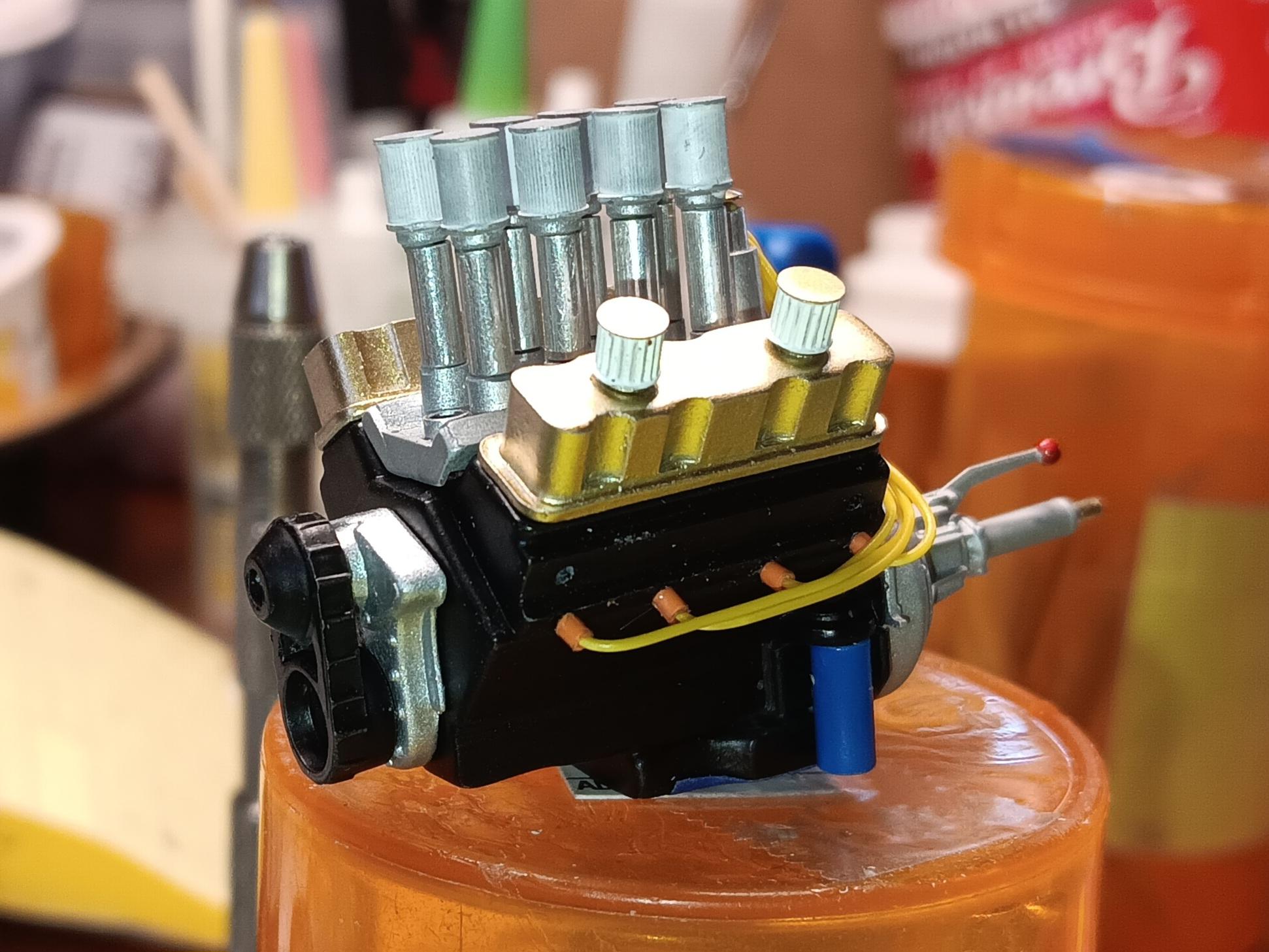

I had dissected the Ron Coon injectors and replaced the tubes with aluminum tuning.
I was going to go all in with a credible throttle detail. But the injector tubes are quite close to the firewall.
Then the oil line to the cooler plumbing, it gets real tight as well by the firewall.
Magneto is in, injectors too.
The aluminum tubing was worth the effort.
The filter elements I gave a thin wash of craft store acrylic paint thinned with water
Wired. The headers are on for a test fit. They go on AFTER the engine is in, so they have to go on very easily.
