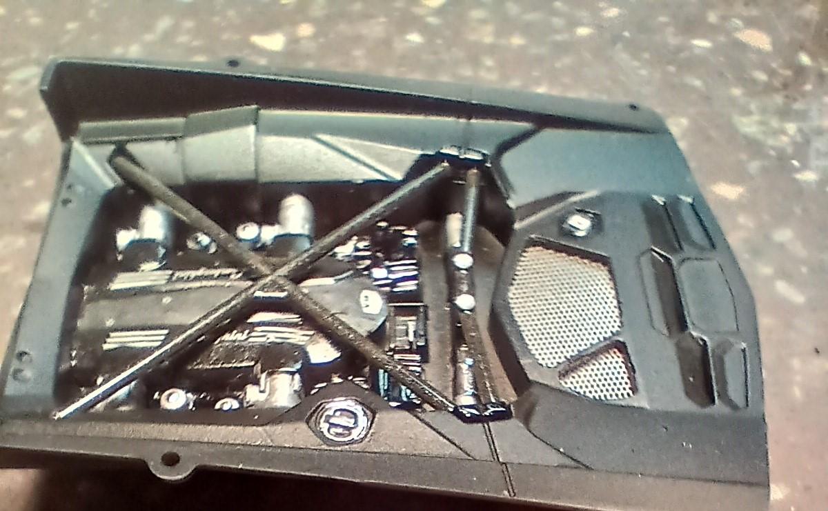

dino246gt Posted April 10 Posted April 10 The overly simplified engine bay can be cut open to look a lot better, quite easily. 4

carl63_99 Posted April 11 Author Posted April 11 Engine bay is finished. I used gloss black, flat black, metallic black, graphite metallic, silver, flat aluminum, and Moltow chrome to detail it. 3
beeRS Posted April 15 Posted April 15 The interior door handles and engine detail are much improved. A lot of work, but it’s paid off nicely. 1

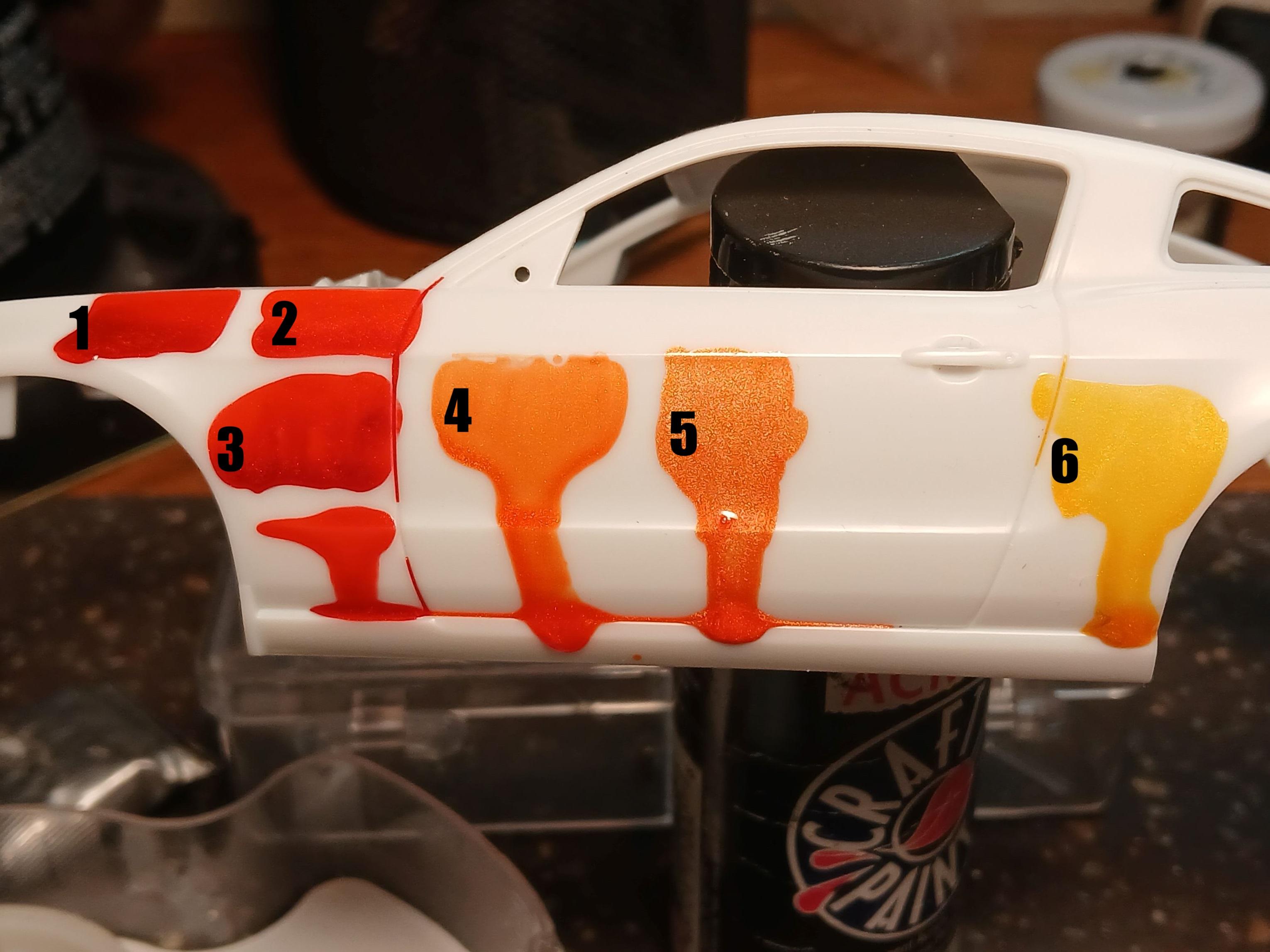

carl63_99 Posted April 17 Author Posted April 17 Paint test time! Exterior is going to be a bright sparkly orange color. I know, I already have a Countach and Diablo in orange, but I really like the color on Lamborghinis. Moving on, attached is a paint test I conducted. I have learned that mixing light and dark colors, ALWAYS start from the light color and add dark. 1) Pearl orange with additional white pearl. Rejected for being too red. 2) Pearl orange with just a touch of turn signal amber and white pearl. Still too red 3) Original Boyd pearl orange. (Countach and Diablo were done with this over grey primer.) 4) Turn signal amber with pearl orange. Just about where I want to be. 5) Number 4 with the white pearl powder added. Looks too milky white. 6) Turn signal amber, straight from the bottle.

carl63_99 Posted April 20 Author Posted April 20 Oh what a nice sunny afternoon in Austin, TX! I painted the color on my Aventador a little while ago, and before sticking it in the food dryer, I stepped out on the patio to take a couple pics. Attached are the results. I did decided to add just a pinch of white pearl, proportionally a lot less than my test the other day. I am glad I did. It just makes it sparkle a little more. I will let this sit for a week after an overnight run in the dryer, then a coat of clear, another week, then polishing. Interior cream color is drying and in a couple days I'll feel comfy masking and doing the Royal Blue. 5
