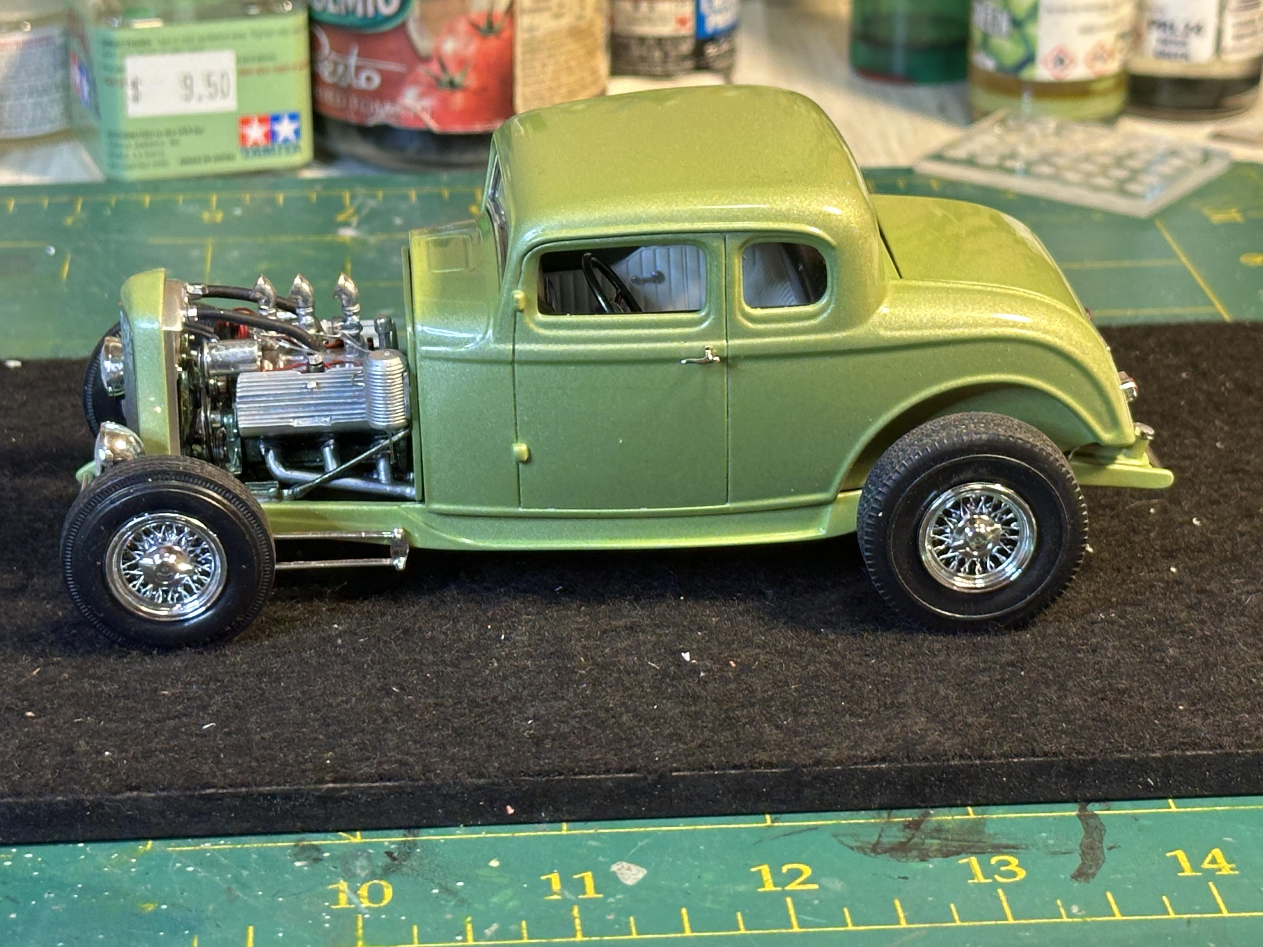

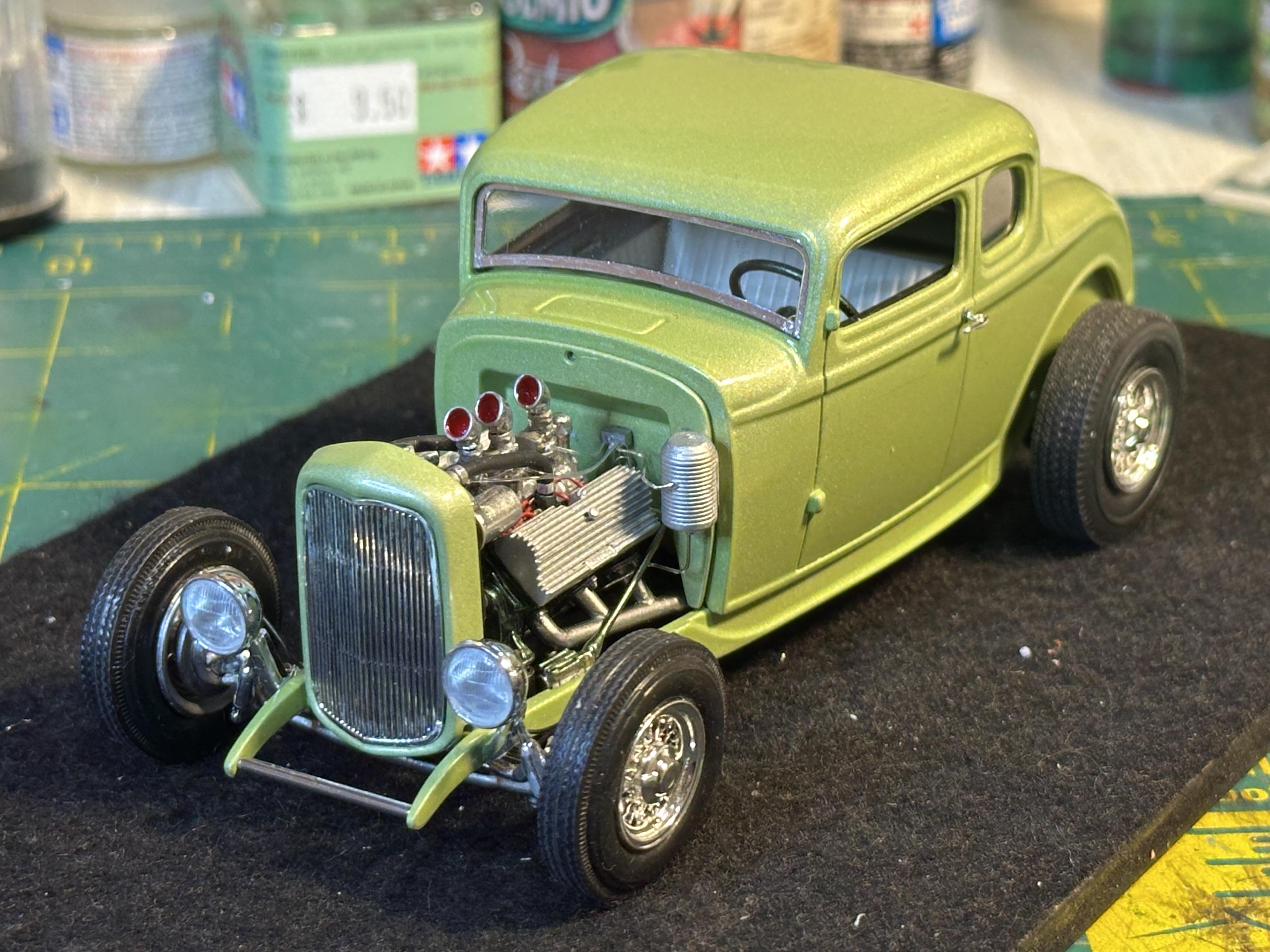

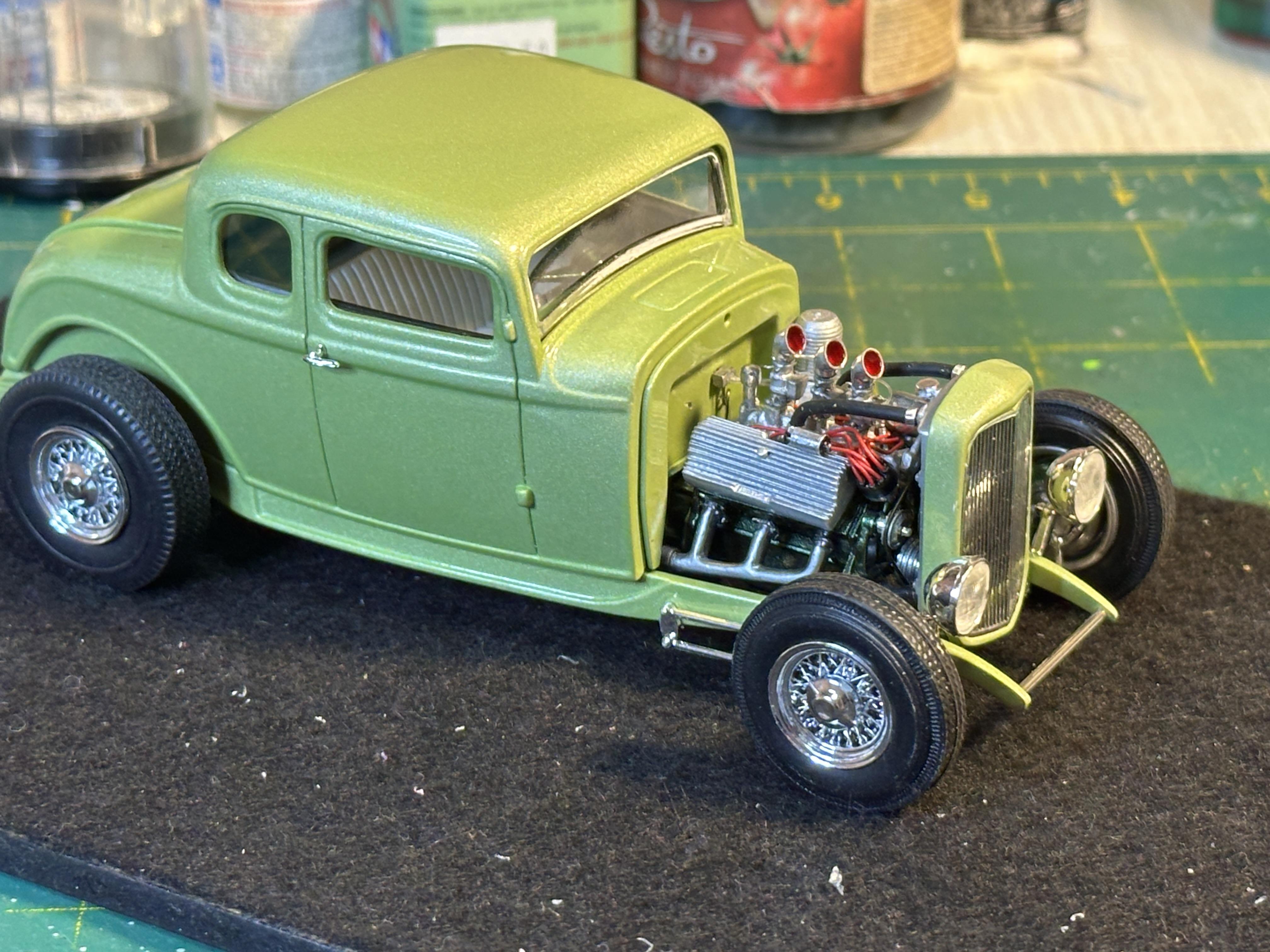

bill-e-boy Posted September 17 Author Posted September 17 Had some issues getting the grill and radiator assembly to fit properly. Had to monkey around with the lower hoses and radiator stubs where it meets the chassis. An adjustment here, a tweak there and a little time with the lower hoses and it now fits Nextup wheel fitment. Rears sat nicely but had to chock up the fronts to get camber and a little toe in. The Tamiya square bottles are perfect for this. I have a little side project on the go - a display base that nicely shows off the kit - although not quite finished yet Thanks for looking 7

bill-e-boy Posted Sunday at 06:49 PM Author Posted Sunday at 06:49 PM On 9/21/2025 at 3:30 AM, customline said: Looks like you're down to those little PITA details now, Bill. Indeed. Got those pesky little details done over the weekend. Headlights, tail lights, plate, radiator cap, door handles and gas cap all done. I could not get the radiator brace in as it clashed with the frog mouths - oh darn! It is now in the cabinet and I will get around to posting in Under Glass -sometime Thanks for bearing with me through this build but I must say I have enjoyed it and I did it in record time - for me anyway 2
customline Posted Monday at 12:00 AM Posted Monday at 12:00 AM 4 hours ago, bill-e-boy said: Indeed. Got those pesky little details done over the weekend. Headlights, tail lights, plate, radiator cap, door handles and gas cap all done. I could not get the radiator brace in as it clashed with the frog mouths - oh darn! hey It is now in the cabinet and I will get around to posting in Under Glass -sometime Thanks for bearing with me through this build but I must say I have enjoyed it and I did it in record time - for me anyway Congrats! Hey, you might be able, at this point, to drill holes on each side of the firewall at the top and also on the grille shell. Drill the firewall through so you can insert pins or stiff wire that are longer than they need to be and then pull them back to the holes in the shell. Maybe make some realistic looking brackets for the firewall end. 1
bill-e-boy Posted Monday at 07:12 PM Author Posted Monday at 07:12 PM Thanks Jim - I thought about it but not sure yet. I might make a sling shot style one where it uses the centre hole on the radiator and two new holes at the firewall. And make a filler for the original hole at the fire wall. It can stay in the cabinet for now as I need to get some movement on another (group build) project. And I do like your gungy old hot rod 1
