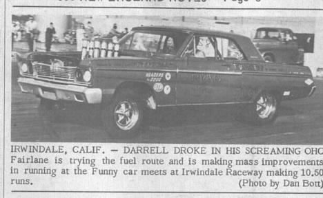

Going out on a limb to say that anything Falcon- or Fairlane-based in '64-5 with an SOHC would have had either a straight axle or the single-leaf, quarter-elliptic spring,  if only to make room for the headers which were critical to getting all the power out of the engine.
('64 Thunderbolts had 1 5/8" primaries as delivered, which would be marginal on a 289 and are the achilles heel of the Revell kit!

Second pick is likely the final iteration with injectors, moon tank, etc. Guessing by the time it got this far, it was pretty beat up and would make sense to crush out.

Agreed the headers in the tbolt kit look woefully undersized. These pics are a big help. I’m still trying to find decent ( or any at this point) front suspension pics on the internet. I’ve got a pretty good old magazine library that I still need to search through but if anyone knows of a specific mag let me know. I noticed the last pic the car is running in B/FX , is it possible the car was run with a small block at one point?
@GoodbuildNY Doubt the Droke car ran with a small block, but there is a recently restored D/SA that did - with the 289 HP and Cruiseo.  B/FX may refer to the weight break, the Fairlane even with all the lightening (fiberglass from the quarters forward) was still pretty heavy for the class. Someplace I have an Elapsed Times story on the C/FX cars that ran small blocks but delivered surprising performances... a few 289 "Cobra Kit" Galaxies were notables. Had to be driven like they were stolen, but were nipping at the heels of the B/FX entries with much larger engines.

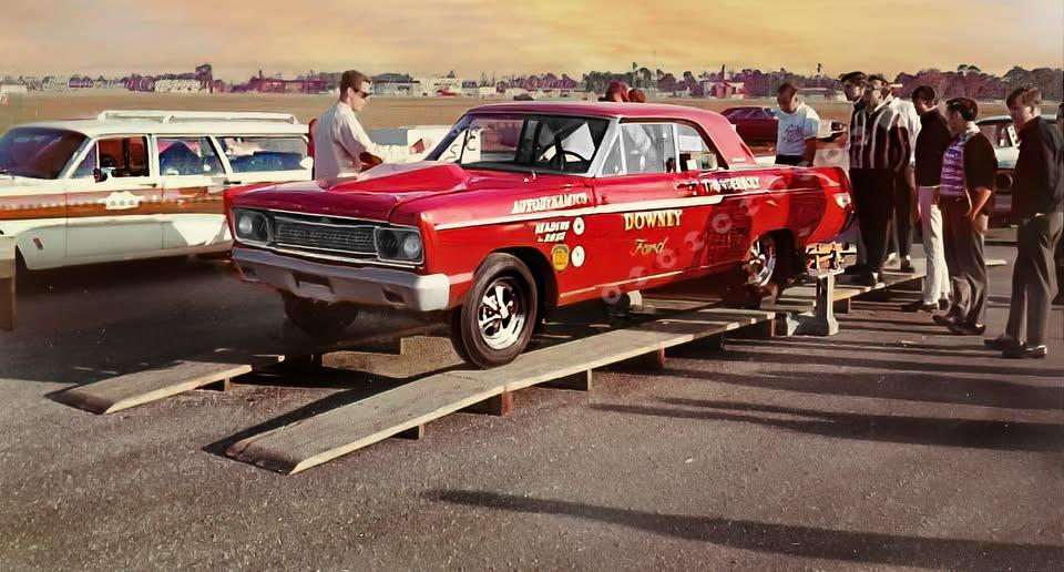

Is this the car you were talking about?
Yep - that's the one.
Super easy one to build assuming decals and a donor could be located. Damn, it looks good on those Cragars!
FWIW, out of box promos that look a little scruffy are a very good way to source a '65 - and they bash 100% with the '65 Mod Stocker. Pro tip: Surf Woody has the best ever (maybe only!) Cruiseomatic in scale. My LHS in DTW had stacks of them.
I would imagine a Thunderbolt would be a drop fit underneath, too, or a Moby Cyclone.
If you are good with an olde skool platform style chassis, the common '69 Torino has the exhaust and sales copy wiped away... and includes a credible shock tower style engine compartment, too.
