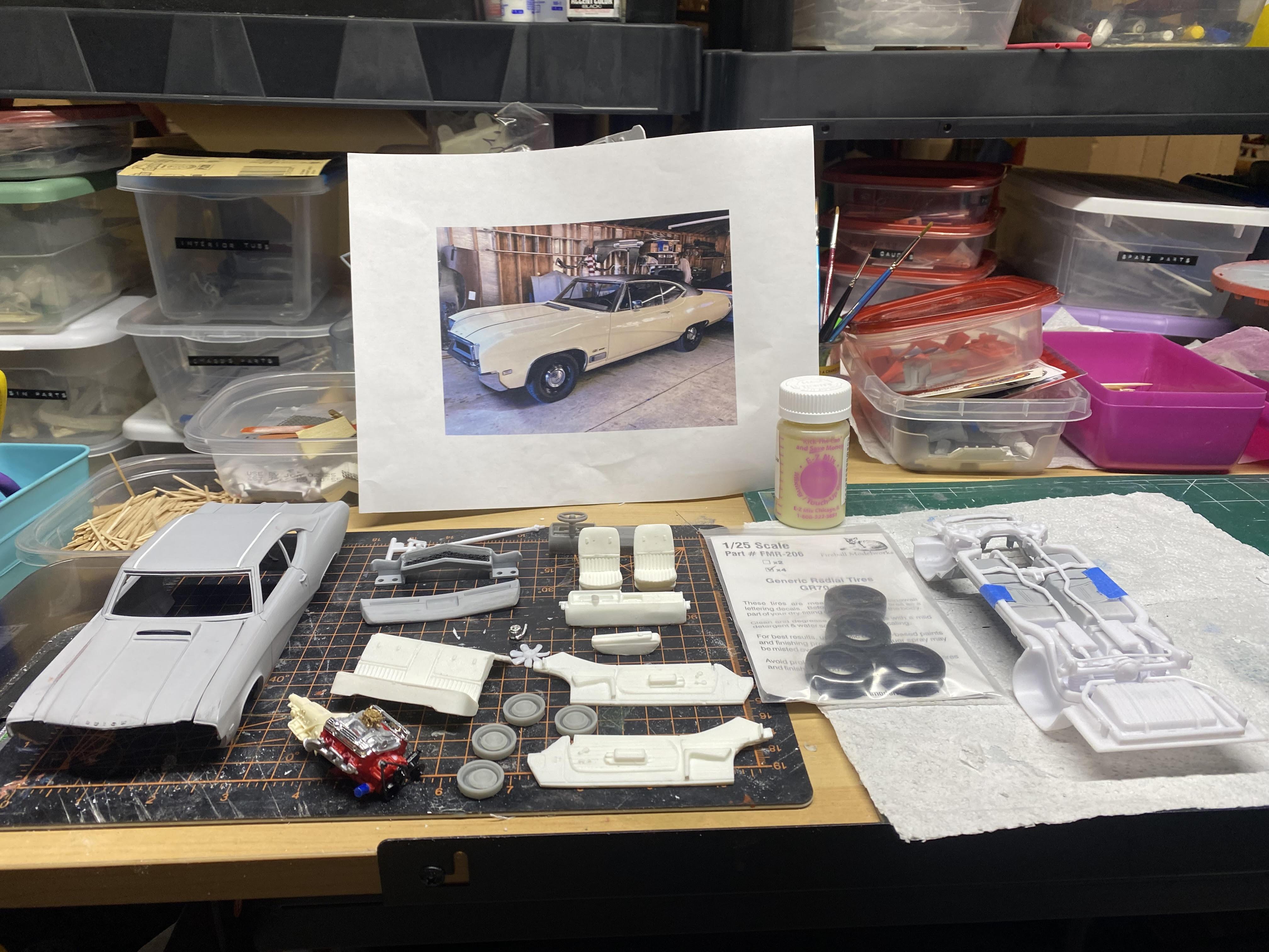

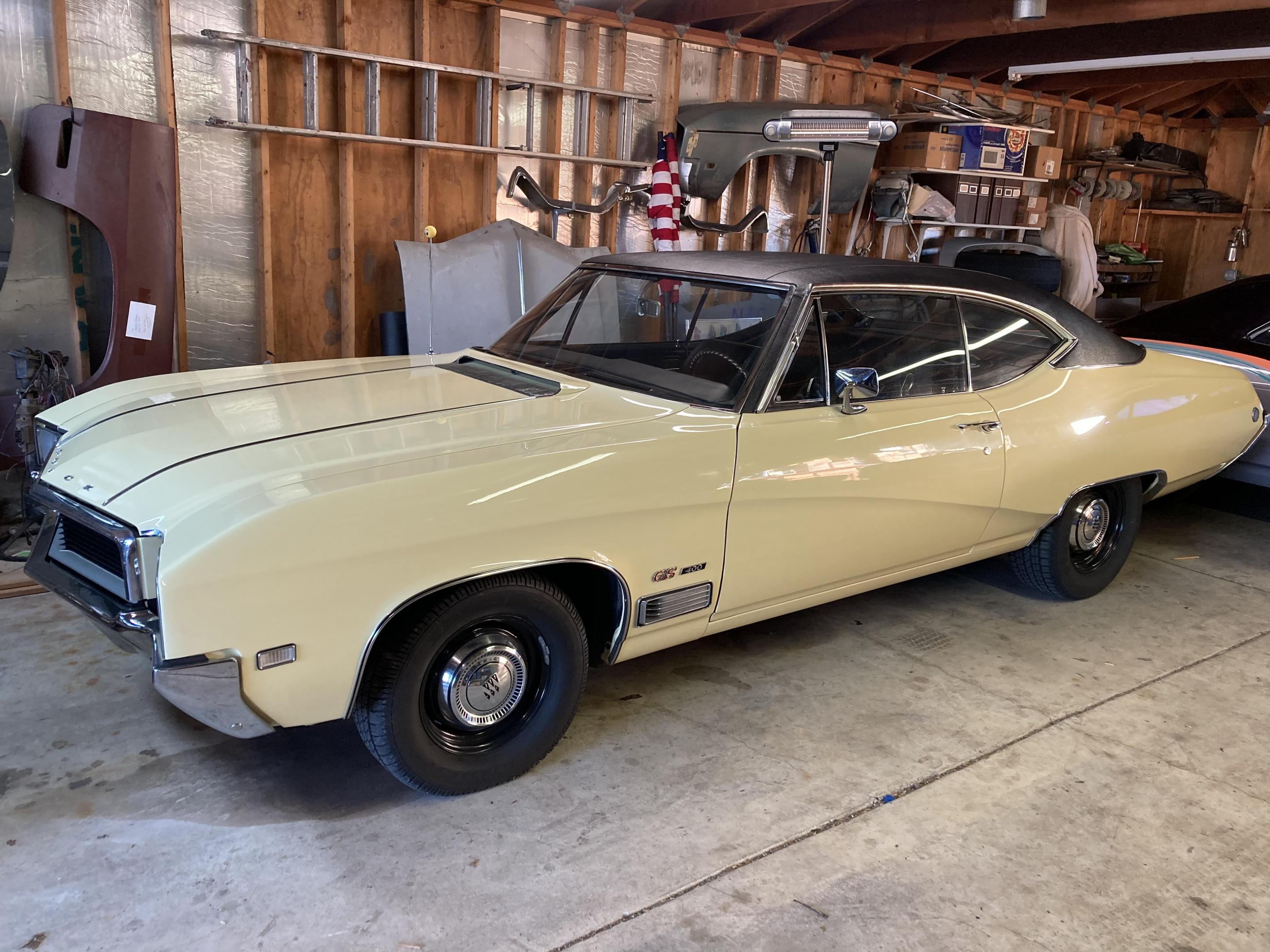

After repeated tries to find a 68 Skylark GS from Perry's Resins, I had to change strategy. There are several 3D prints of 69 Skylarks now so I bought two.  One I used for my Motion-prepped 69 Skylark. The other I decided to convert to a 68. The biggest problem with the 69 kits is the interior. They are all wrong for 69 Custom and definitely all wrong for 68. So I created my own for both cars from a Revell 68 Chevelle. I used the frame and pan from the car as well because the chassis on the resin kits has little detail. Engine from a Monogram GS, resin turbo 400, Fireball tires, resin poverty caps and wheels from Missing Link and scratchbuilt hood and console. Model Car Garage photo etch emblems from Monogram the GS. Tim Stevens is my go-to NASCAR build guru and builds killer cars. He also has a couple of neat real cars, including a 68 GS. I decided to do a loose replica of his real car. Cameo Cream PPG acrylic enamel. I created molds of the interior and can reproduce it all in resin.

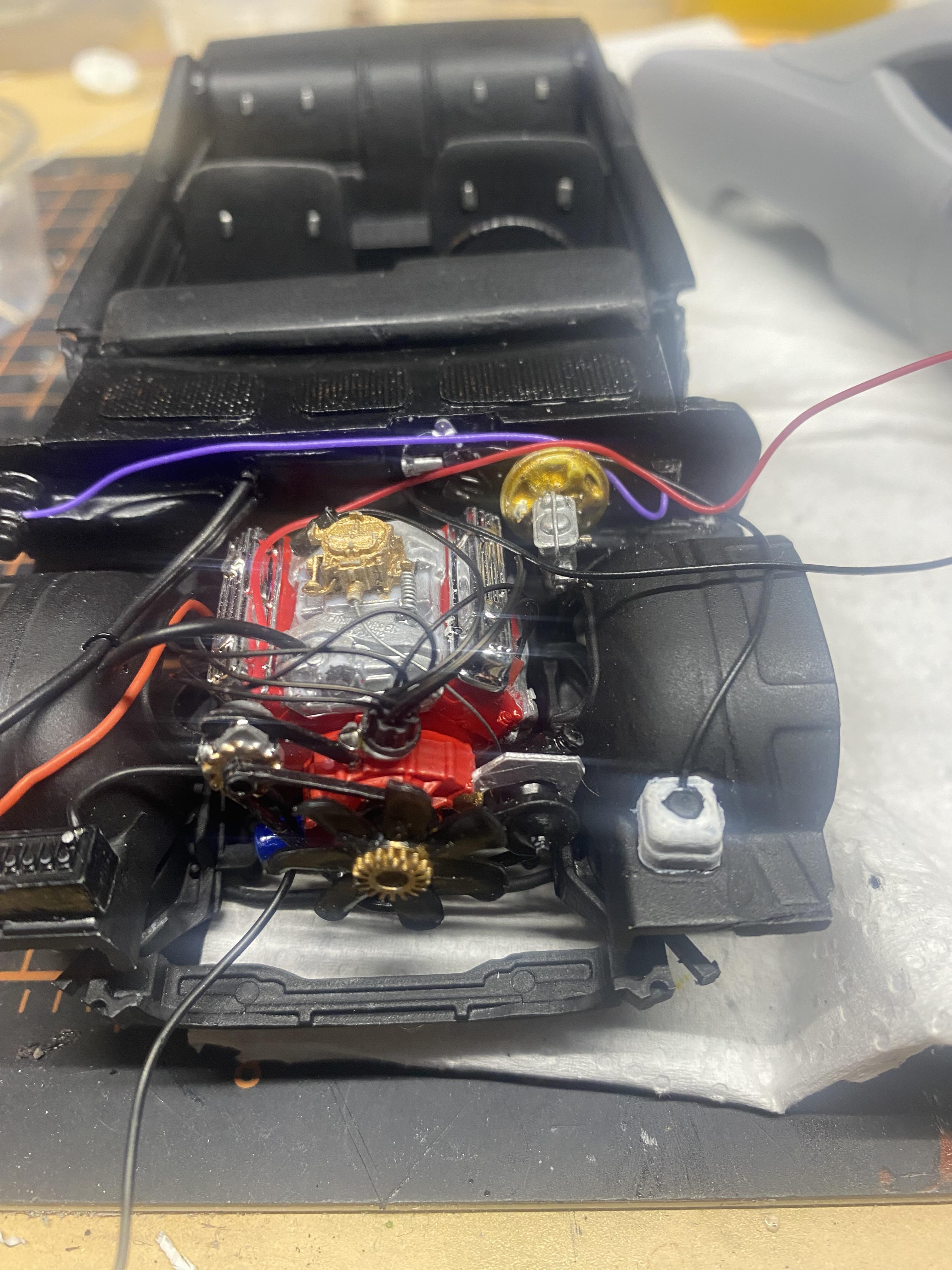

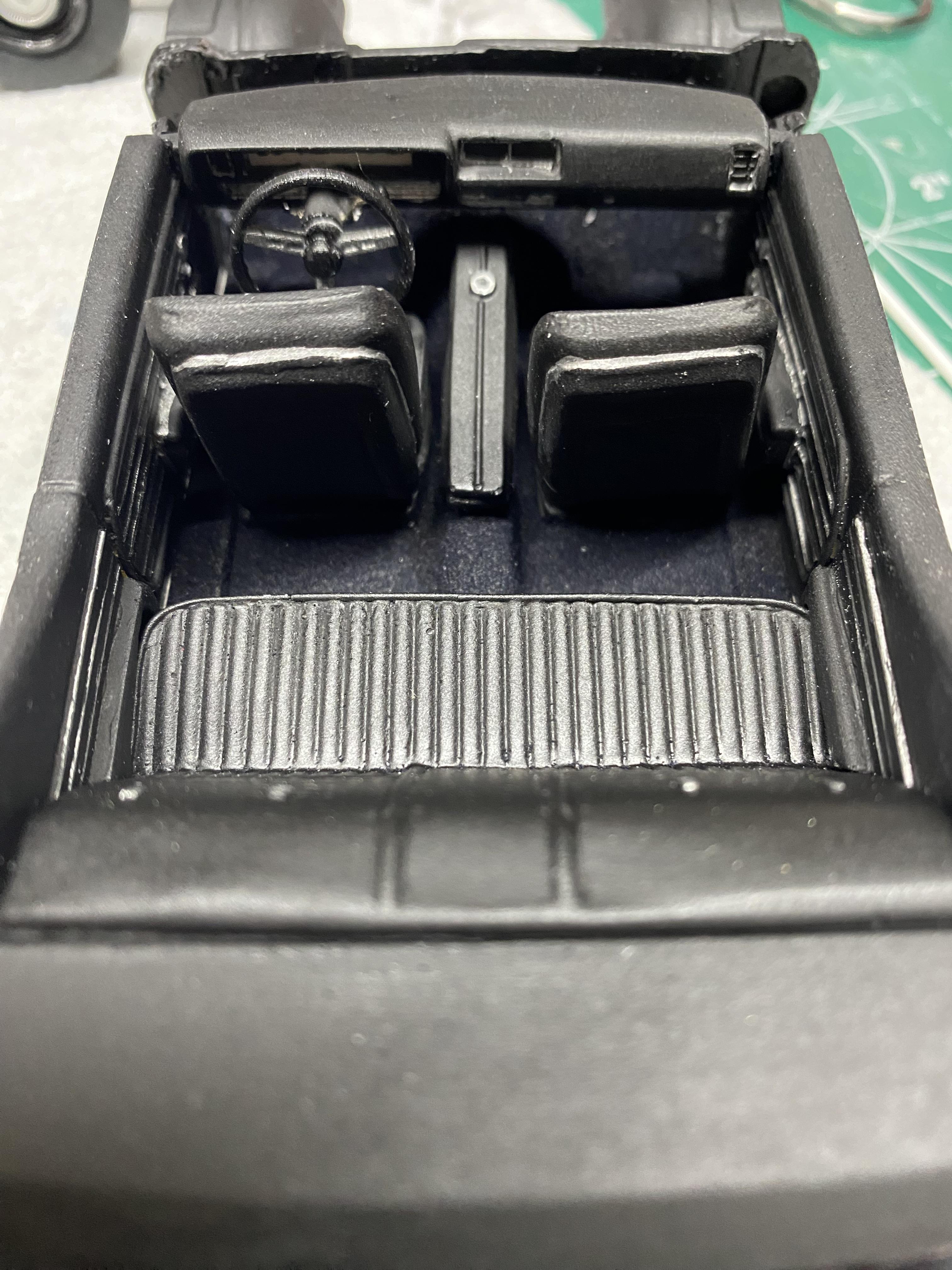

Slow progress on this one. I cast the interior and fitted it all together. Painted it a matte black with black embossing powder for carpet (still not a fan). Detail painted with Molotow ink. Still need to do seat belts. Detailed the engine and fitted it to the frame then glued the tub to the frame Now finish the wiring, detail the brakes, put valve stems in the wheels then paint the body. Revell chrome on the bumpers and bare metal foil trim.
