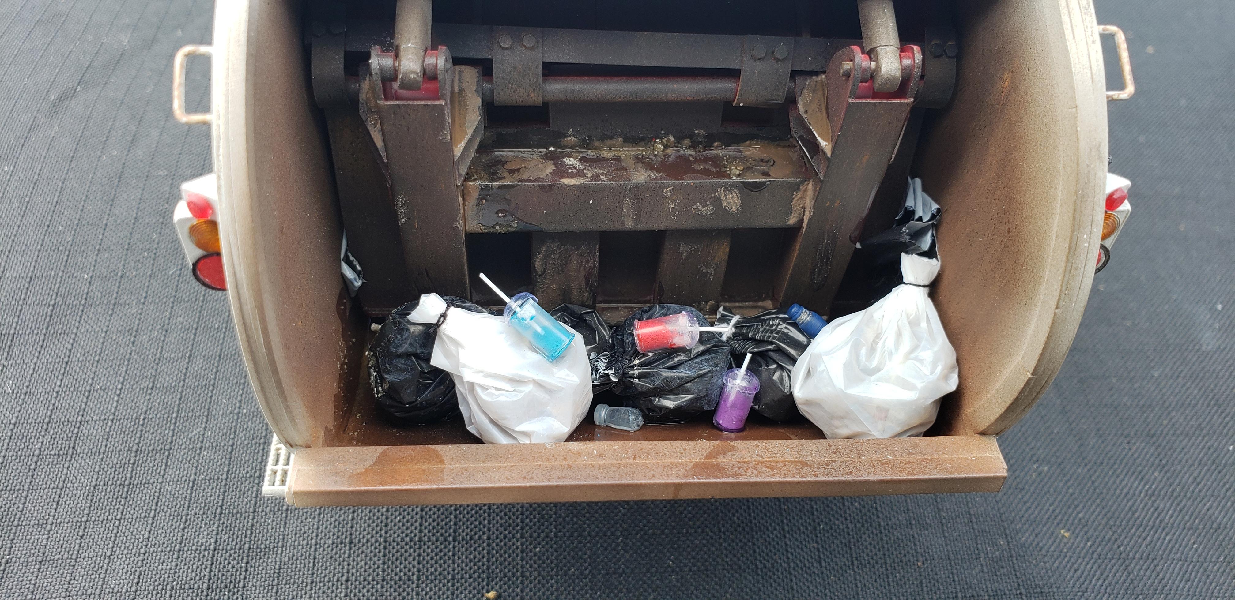

gotnitro? Posted July 22 Posted July 22 Don't forget the trash in the packer !! Daughters idea for drink cups..not shabby for 6yrs old lol 4
Scott Eriksen Posted July 22 Author Posted July 22 4 hours ago, gotnitro? said: Don't forget the trash in the packer !! Daughters idea for drink cups..not shabby for 6yrs old lol You did a great job on that Jeff ,put the link to that build thread on here ,I tried to find it last night 2

gotnitro? Posted July 23 Posted July 23 https://www.modelcarsmag.com/forums/topic/176074-r-model-mack-w-scratchbuilt-leach-packer/ Closest I could find in the archives was the Under Glass post, wow it was a couple yrs ago..how time flies. 1

gotnitro? Posted July 24 Posted July 24 Thanks, yup the Leach placard was just a decal. I was originally planning to use a Keystone body,, but ended up building my own as a personal challenge. Cant wait to see your progress 1

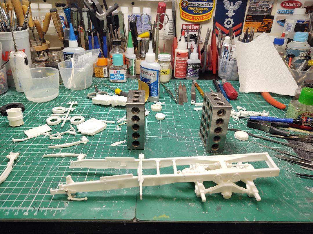

Scott Eriksen Posted July 26 Author Posted July 26 A little chassis and sub-assembly work,, I'll make my frame cut right after the middle crossmembers 4
Scott Eriksen Posted August 1 Author Posted August 1 A little more progress........... Karl's body required the addition of some sheet styrene for floor plates ,,did that so I can determine the fit on the chassis , started some cab work,fitted the pass side hood fender extension and threw some putty at it. Probably cut the frame and get the stretch done this weekend . The engine is assembled and primed ,,just have to spray it Mack engine gold 3
