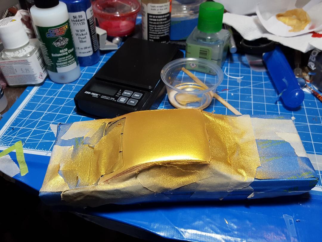

MarkJ Posted September 13 Author Posted September 13 The fine sanding pads worked so now I will mask them and shoot the gold on the roof and if that turns out okay, I will then mask that and shoot the rest of the body blue. I have started the chassis, and it should not be too much trouble getting it done.

MarkJ Posted September 18 Author Posted September 18 Got the gold shot today and learned some things while doing it. When I shot the red, I mixed the 4011 thinner which Createx calls reducer at 2 grams of reducer to 5 grams of paint. and it did okay. I decided to go with 4021 reducer this time instead of 4011 with the gold and when I shot it, it was way too watery coming out of the airbrush. I made another batch at 1 gram of 4021 to 5 grams of paint, and it was just fine. The 4021 is advertised as a more free flowing reducer that eliminates air brush tip dry out and also gives a smooth finish instead of a gravely one which happens when the paint dries when it hits the body and doesn't flow out. I will be using the 4021 when I paint the blue parts of the model. This is the same gold I used on the Bobby Allison Monte Carlo and it still has the iridescence I liked so much on that model. I'm being really frugal with my photo posting so I can make it to the 22nd. 1

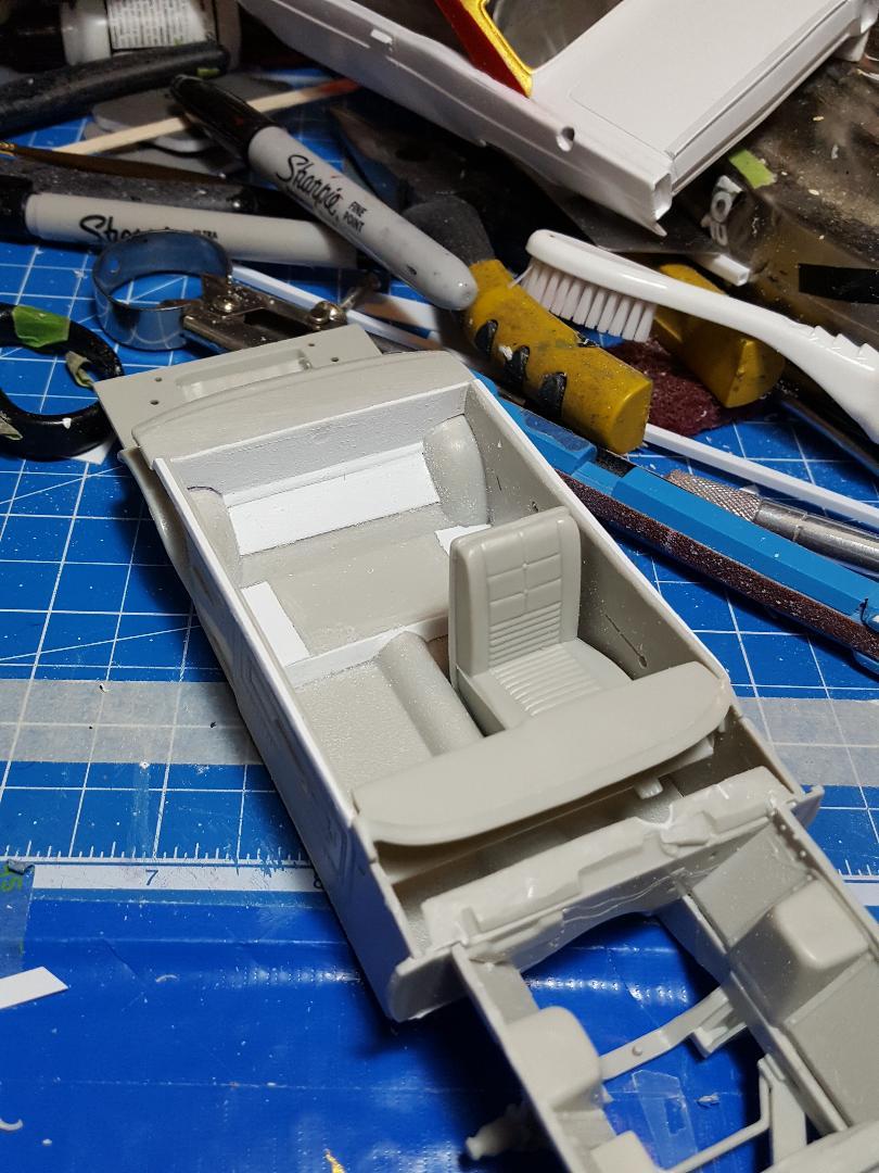

MarkJ Posted September 22 Author Posted September 22 Getting into the chassis now. To remove the rear seat, you have to add a new rear bulkhead and reattach the package shelf to it but it's very flimsy, so you have to add a center support. I flipped the door trim from left to right so I don't have to remove all the armrest and trim panel garnish. you just need to drill holes where the handles poke through. You also have to remove the top of the door trim and add a new one to fill in between the door trim and the door and quarter panel at the top. I will eventually remove that excess plastic at the top of the new rear bulkhead and also fill in the stuff in the rear seat floor area. I was careful to let the rear fenders show through inside the rear of the car like the real car had it. 1

MarkJ Posted September 24 Author Posted September 24 Got some more done on the chassis. Added more filler panels to the interior tub and trimmed up the package shelf so it looks like it should. I can go ahead and mask the body and get it ready for the blue after I figure out a recipe for it that I can duplicate the same every time I need to mix some up. 1

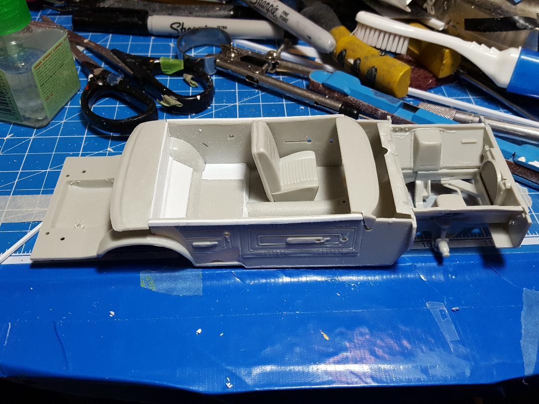

MarkJ Posted September 25 Author Posted September 25 14 hours ago, Volzfan59 said: Looking great Mark! Thanks, Steve. I finally got the body to fit the chassis yesterday after a lot of surgery under the hood that thankfully won't show because I glued the hood shut. Typical AMT kit that doesn't go together that well and you have to do a lot of things to make it fit. Now I can go ahead and finish the tub and get this baby painted and built.

MarkJ Posted September 25 Author Posted September 25 Some more done. If anybody has a photo of the dash and seat on a 1967 Holman and Moody Ford Fairlane from the Daytona 500, if you could post it here it would be much appreciated. I found some before but since then, they have been locked away where I can't get to them anymore. I guess I can start on the cage for now till I can decide on whether to use the 66 Comet dash and seat that I did on that model a couple of years ago and hope it is close. 1
