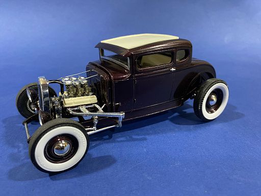

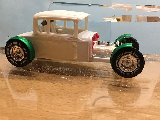

Fat Brian Posted August 24 Posted August 24 Unchopping it shouldn't be too bad, the roof section is a separate piece so its easy to work with. Since they're great kits and you will probably build more than 1 anyway use the top section from the second kit to make one standard height roof and one super chopped one. I chopped mine an additional 3 or 4 inches, that is about enough to bring one back to stock if you put the long sides together. Cut one roof close to the bottom of the pillars and the other close to the roof and switch the tops to the other bottom. Here's a picture of mine, you can see the seam where the roof meets the body through the window. The hardest cut is on the back, the rear window is kind of high so the cuts have to angle down to meet the side cuts. 2 1
Mr. Metallic Posted Thursday at 09:29 PM Posted Thursday at 09:29 PM On 8/24/2025 at 7:22 AM, Fat Brian said: Unchopping it shouldn't be too bad, the roof section is a separate piece so its easy to work with. Since they're great kits and you will probably build more than 1 anyway use the top section from the second kit to make one standard height roof and one super chopped one. I chopped mine an additional 3 or 4 inches, that is about enough to bring one back to stock if you put the long sides together. Cut one roof close to the bottom of the pillars and the other close to the roof and switch the tops to the other bottom. Here's a picture of mine, you can see the seam where the roof meets the body through the window. The hardest cut is on the back, the rear window is kind of high so the cuts have to angle down to meet the side cuts. This is exactly how I did the master for both a stock height and "more" chopped roof sections for Altered States back when the Revell kit came out. Sadly he no longer produces the resin roofs, but you can make your own by creative cutting and splicing like Brian describes. Here are a couple builds I did using the resin copies. 3
