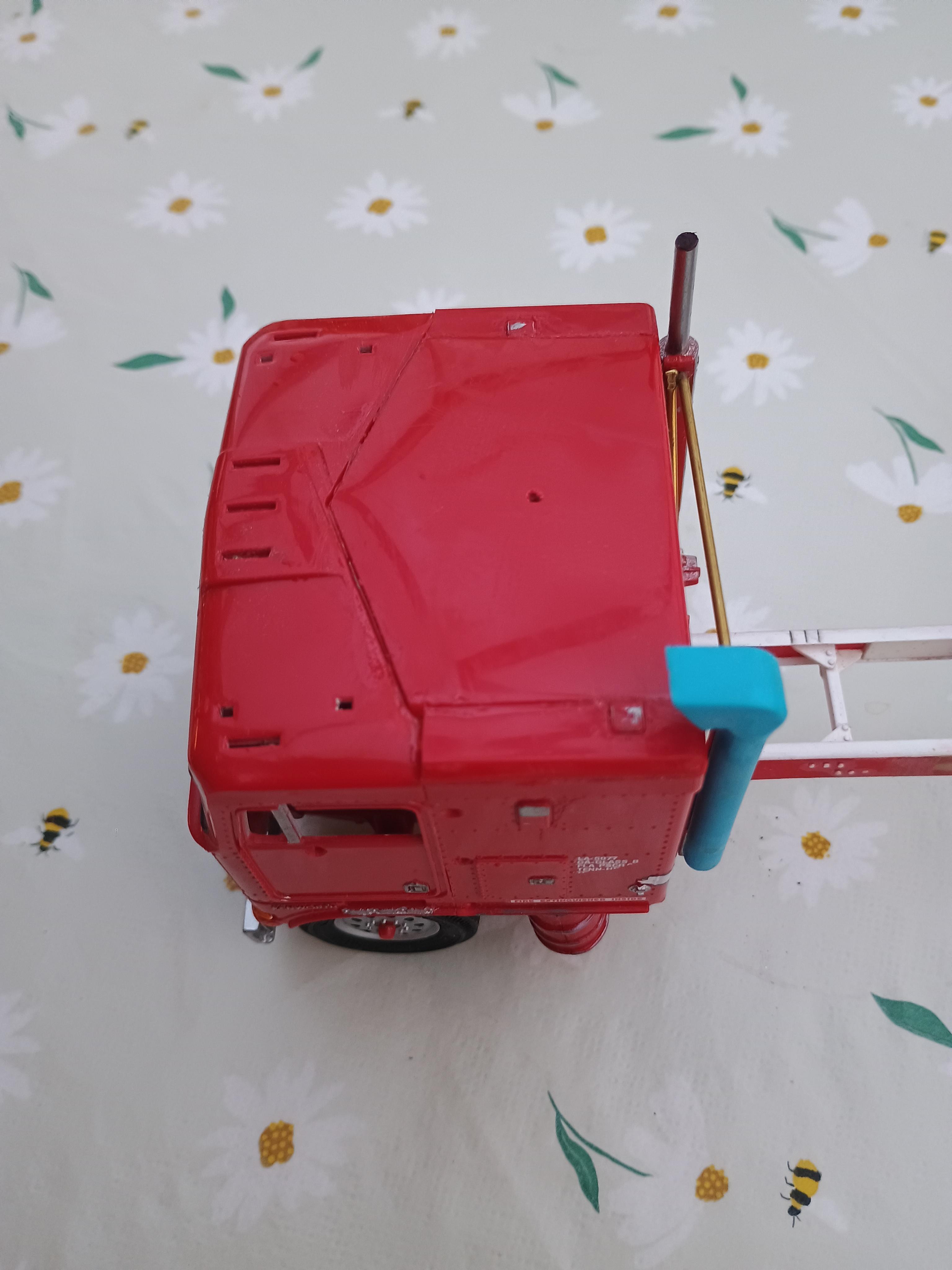

Rockford Posted September 7 Author Posted September 7 (edited) Got sick of looking at the missing roof so used the offcuts of the Aerodyne cap to fill the void. Once it's hardened up I'll get filling and sanding, filling and sanding, filling and sanding. At least it looks whole now. Edited September 7 by Rockford Grammar 5

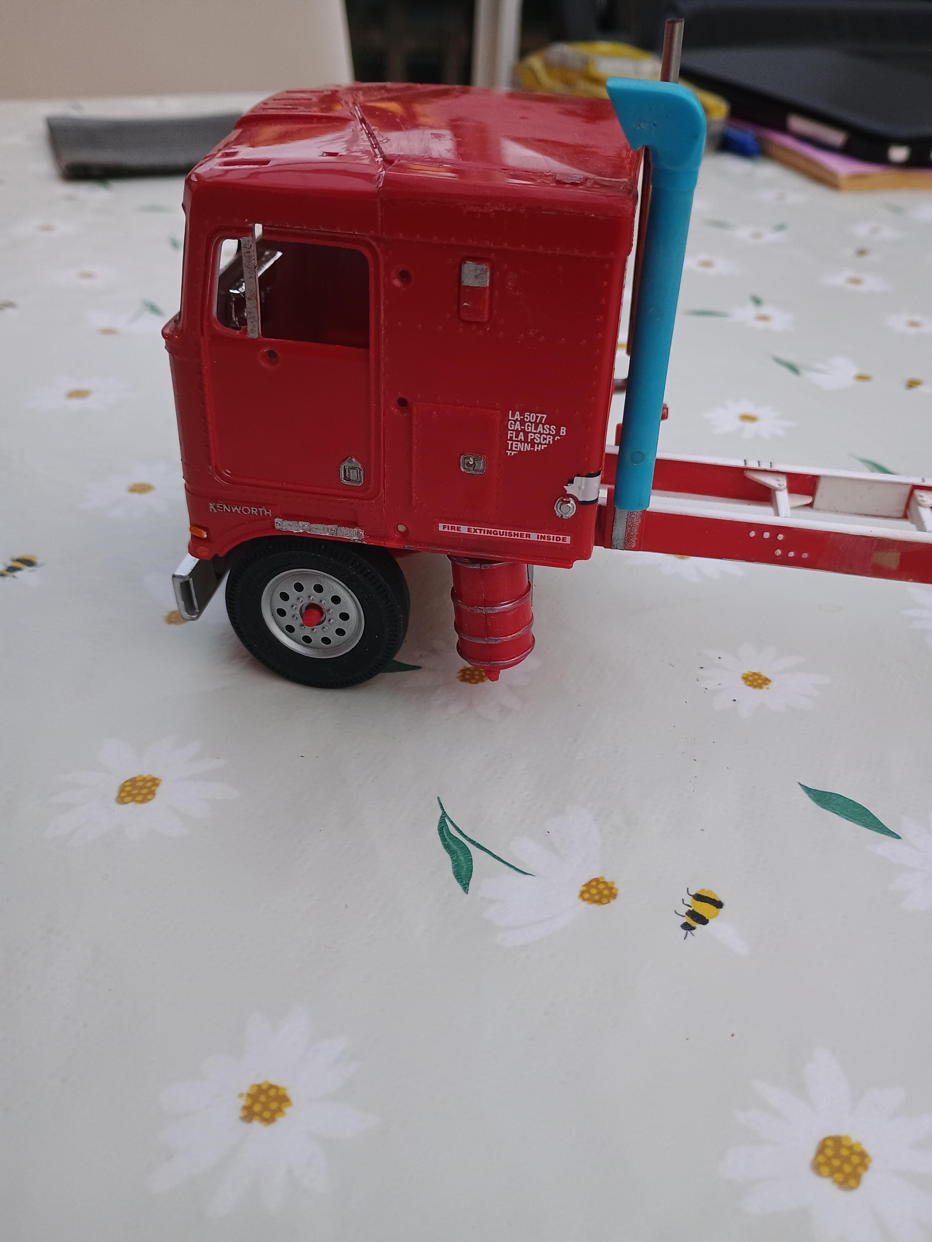

Rockford Posted September 21 Author Posted September 21 (edited) Been snatching the odd few minutes here and there to do the fill and sand ritual. I think I'm on the third run. Filled the various holes that I'm not going to be utilising for the exhaust frame and grab handles. Opened the step well under the doors, I'll back that with a little box section. If it's warm enough today I might get primer on it. Still lots to do. Edited September 21 by Rockford 5

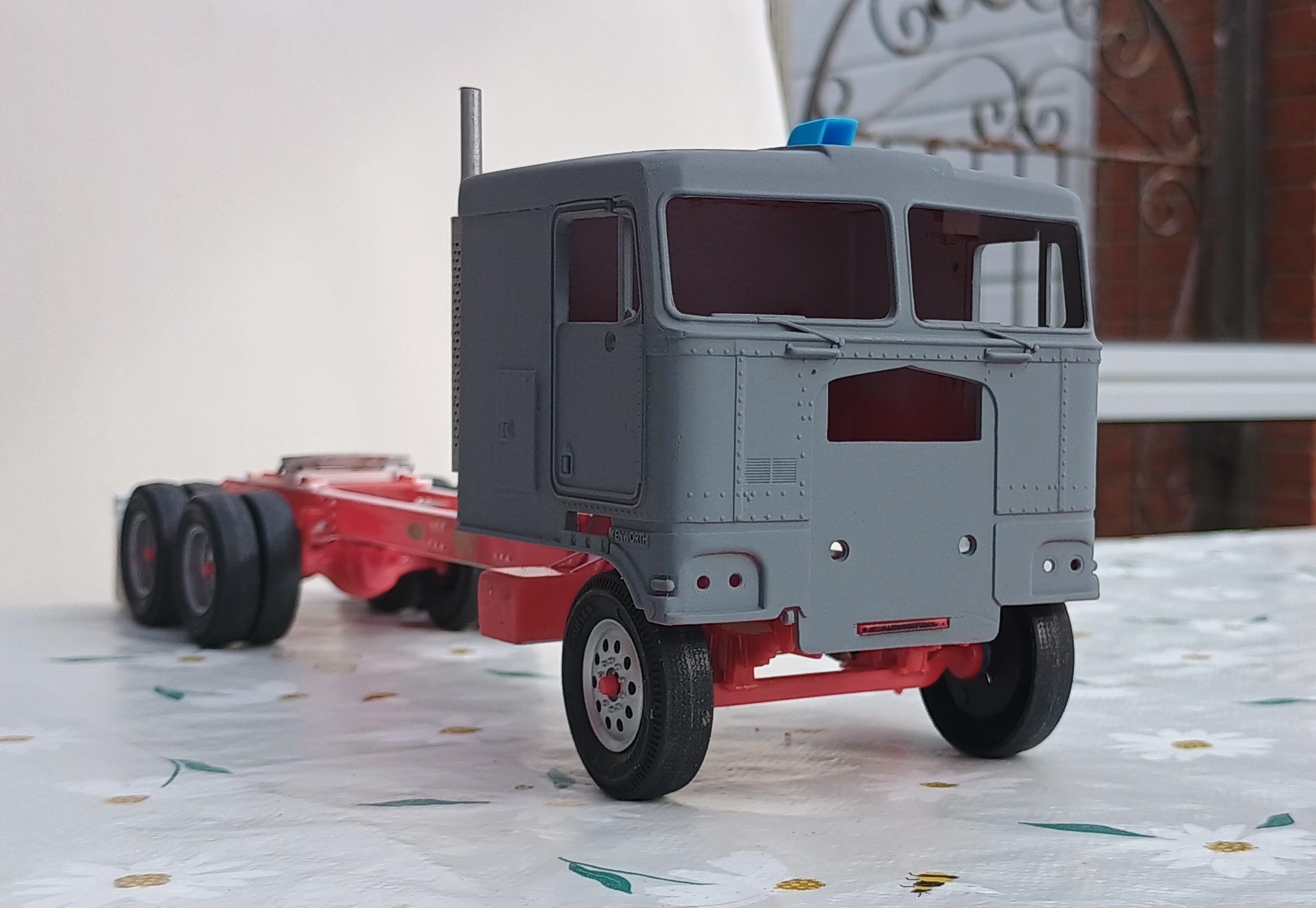

Rockford Posted September 29 Author Posted September 29 (edited) Once you think it's finished it's time to coat the cab with primer, boy does that deflate you when you think you've done a good job, holes and high spots, scratches and seams, terrible. I reskimmed the surfaces then used a metal rule with 1000 grit wrapped around it and plenty of soapy water. Mini block-sanding really. Turned out ok when you consider it started life as a double width Aerodyne. I'm going to see about moving the front axle forward a little, looks a bit too much like a K100E Edited October 7 by Rockford 3

Rockford Posted September 29 Author Posted September 29 4 hours ago, Jürgen M. said: Looks perfect! Good idea with the ruler! I in the meantime discovered steel wool in different grains as quite effective, especially for getting rid of printing lines. You can sand edges without destroying the radius! You have to be careful though. It's not without risk. I like where this is going. I'll stay tuned! Steel wool does have its uses, I've got some OO grade on my bench. It's good for getting into uneven shapes without causing damage because you can ball it up. We're a resourceful lot! 1

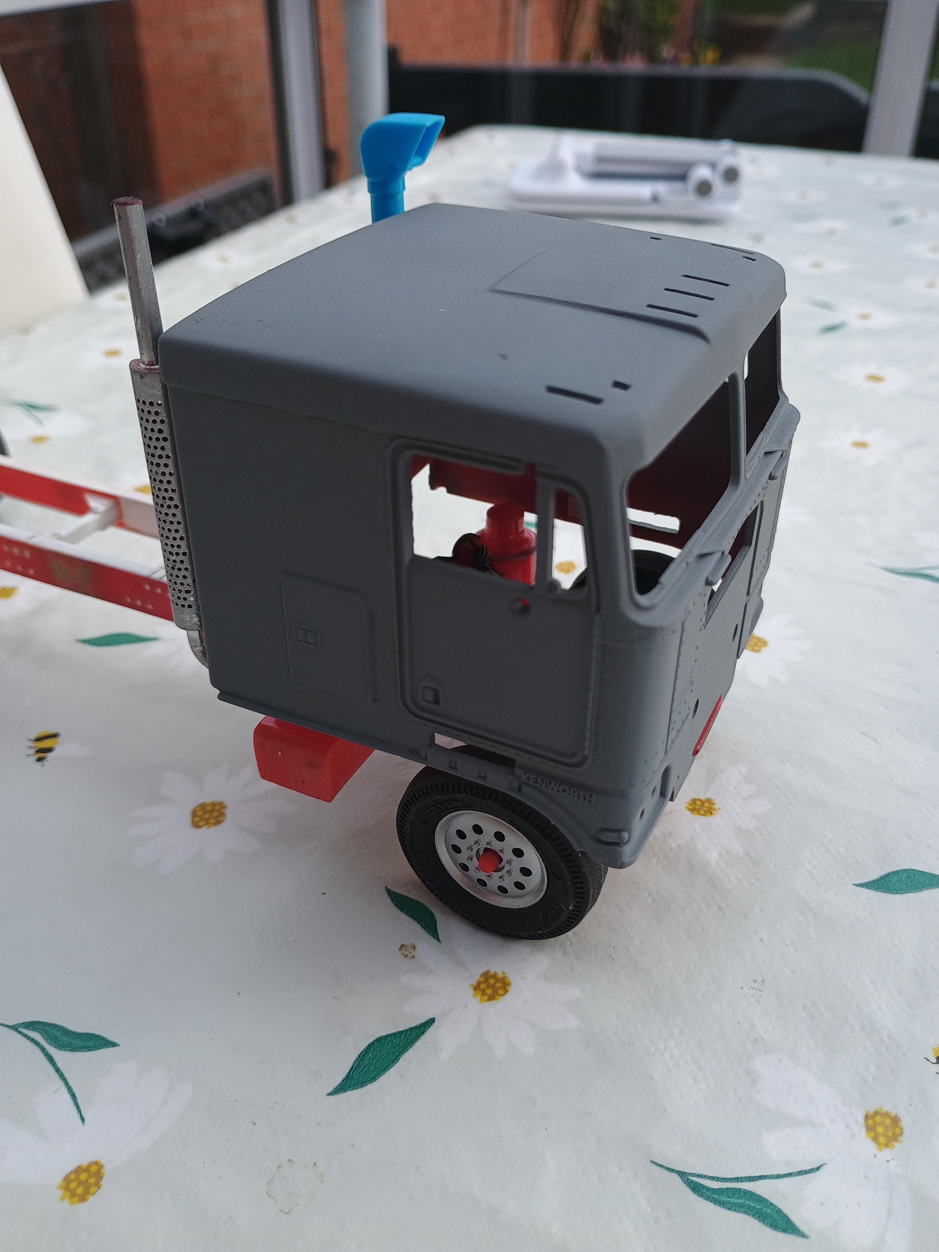

Rockford Posted October 6 Author Posted October 6 Fitted my transmission, looks ok. Fitted the exhaust frame behind the cab. Made the cross member that forms the rear cab mounting. Dug out two spare GMC General fuel tanks and removed all the strap and filler neck detail. I wanted KW style tank brackets which go below the tank, not over it like a Pete or Freightliner. I tried several scratch build methods but nothing worked so I cut the ones off a GMC General chassis and used them. 3

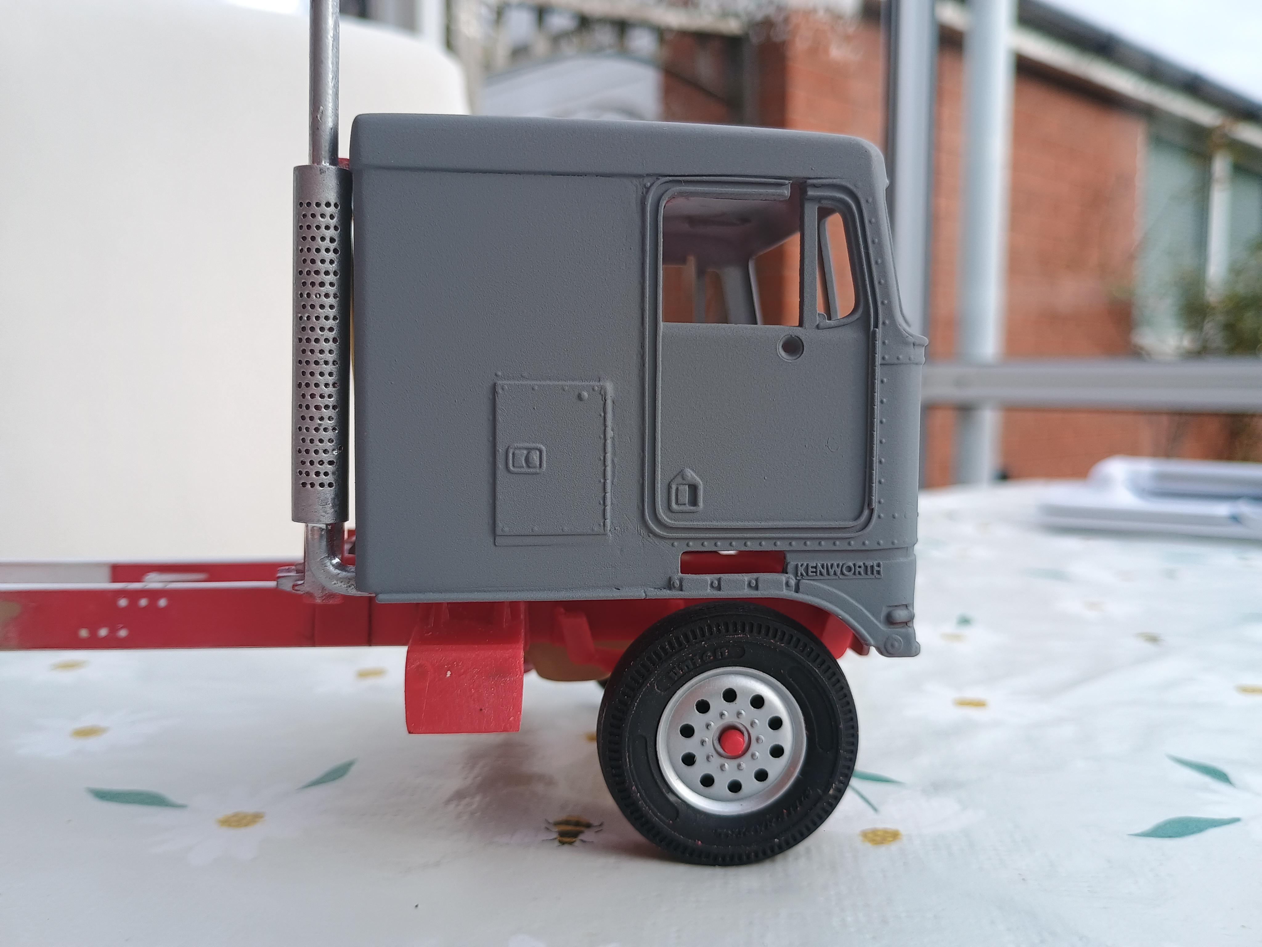

Rockford Posted October 11 Author Posted October 11 Late start this afternoon so didn't get much done. Made a driveshaft from some spare ones I had lying around. Added a centre bearing while I was at it. Moved the front axle forward about 4mm, and machined some little collars that go on the stub axle outside the wheel dish. This is a "no front brakes" truck and often the wheel flange appears to be a little further inboard on the hub with the outer wheel bearing housing jutting out from the wheel. I wanted to mimic that look. Otherwise it's just fuel filler caps repositioning the air cleaner. 3

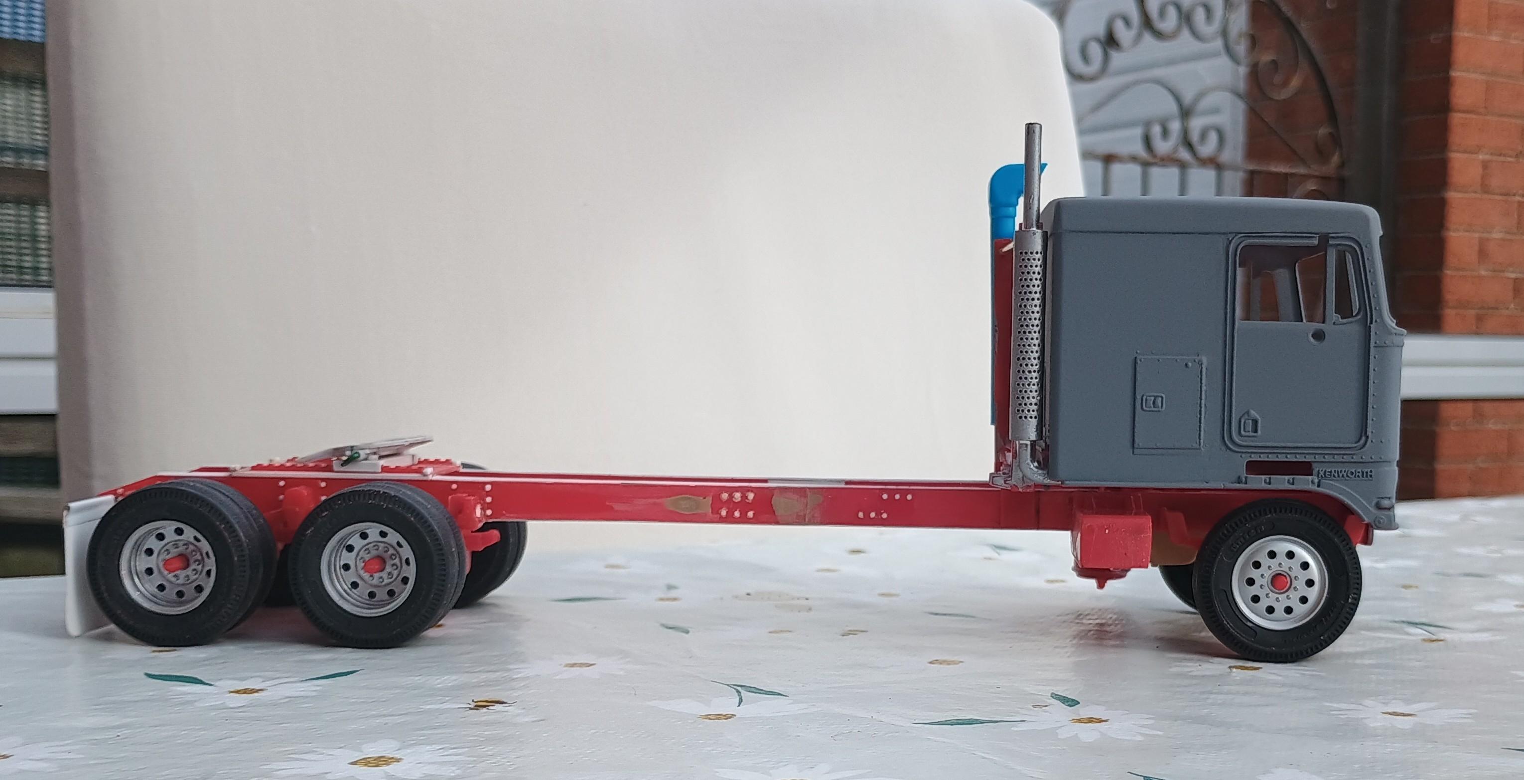

Rockford Posted October 12 Author Posted October 12 Had some bench time this afternoon. Modified the Aerodyne interior to suit the new cab size. I sectioned the tub behind the seats (arrow) and then had a small amount to trim off the back of the upper bunk. I used the trimmed piece as a filler panel to ensure a tight fit. It practically touches the cab roof so I'll just put a valence in front at the top and hide it. Looks ok in situ, needs a repaint. Changed the air intake stack for a more mundane top hat style. Looks more in keeping. It actually comes from the AMT Aerodyne K100, I just added a flange to the cap and some straps. Tank straps! I added 90 degree angle pieces to the tank brackets and used 3mm strips of electrical tape to form the straps. They look ok I think. 3

Pete68 Posted October 14 Posted October 14 (edited) On 10/11/2025 at 1:30 PM, Rockford said: Steve this is called center point steering where the front wheel is centered with the rear duals. I’m sorry but “no front brakes” has nothing to do with the positioning of the wheel or the Hub Oiler. The theory behind this to make the handling and steering better on curves and high crowned roads. I’ve drove several trucks and my Autocar I had with no front brakes and they were not Center point steering. This was a special order from the factory. Looks good and I like all the extra effort you give these 1/32 models. Edited October 14 by Pete68 1
Rockford Posted October 14 Author Posted October 14 14 hours ago, Pete68 said: Steve this is called center point steering where the front wheel is centered with the rear duals. I’m sorry but “no front brakes” has nothing to do with the positioning of the wheel or the Hub Oiler. The theory behind this to make the handling and steering better on curves and high crowned roads. I’ve drove several trucks and my Autocar I had with no front brakes and they were not Center point steering. This was a special order from the factory. Looks good and I like all the extra effort you give these 1/32 models. Understood Lee, thanks for the information. 2
