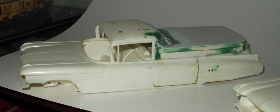

Found an AMT Ecto-1A kit for cheap and decided to chop it into a "coupe de fleurs", aka funeral flower car. Ended up incorporating lots of Polar Lights and Monogram parts in.

Current progress. This is a design I created to approximate a Miller Meteor or S&S or Hess & Eisenhardt "coupe de fleurs", but it is a replica of nothing as far as its design goes.
The roofline is slightly chopped at the B-posts/raked back with Polar Lights glass up front/cutdown and recut kit supplied windshield in back & the window glass apertures recurved, the "stainless steel" rear deck is a Polar Lights Ecto-1 top cut/filed/filled to suit, with the "dutchman panel" between the rear window ledge/where the rear deck sits on made from part of the hood/cowl of the PL Ecto kit I cut up for parts and the raised portion made from a parts bin "parade boot". The dash is AMT in a Polar Lights interior tub, with Monogram Caddy parts used throughout where originals are unsuitable to my eyes.
Paint color will be close to factory Gloucester Grey Metallic with a black or lighter grey vinyl top and detailed Gloucester Grey dash with Andros Blue interior.
