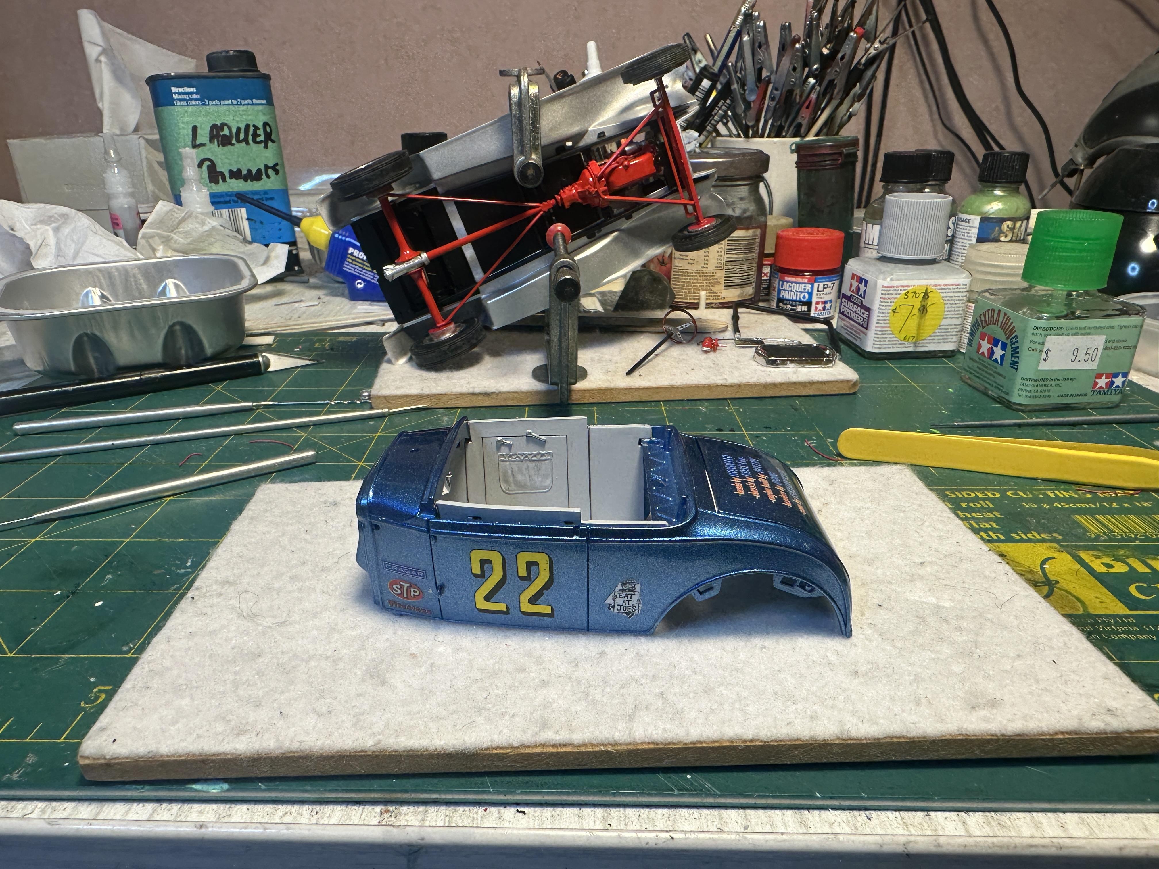

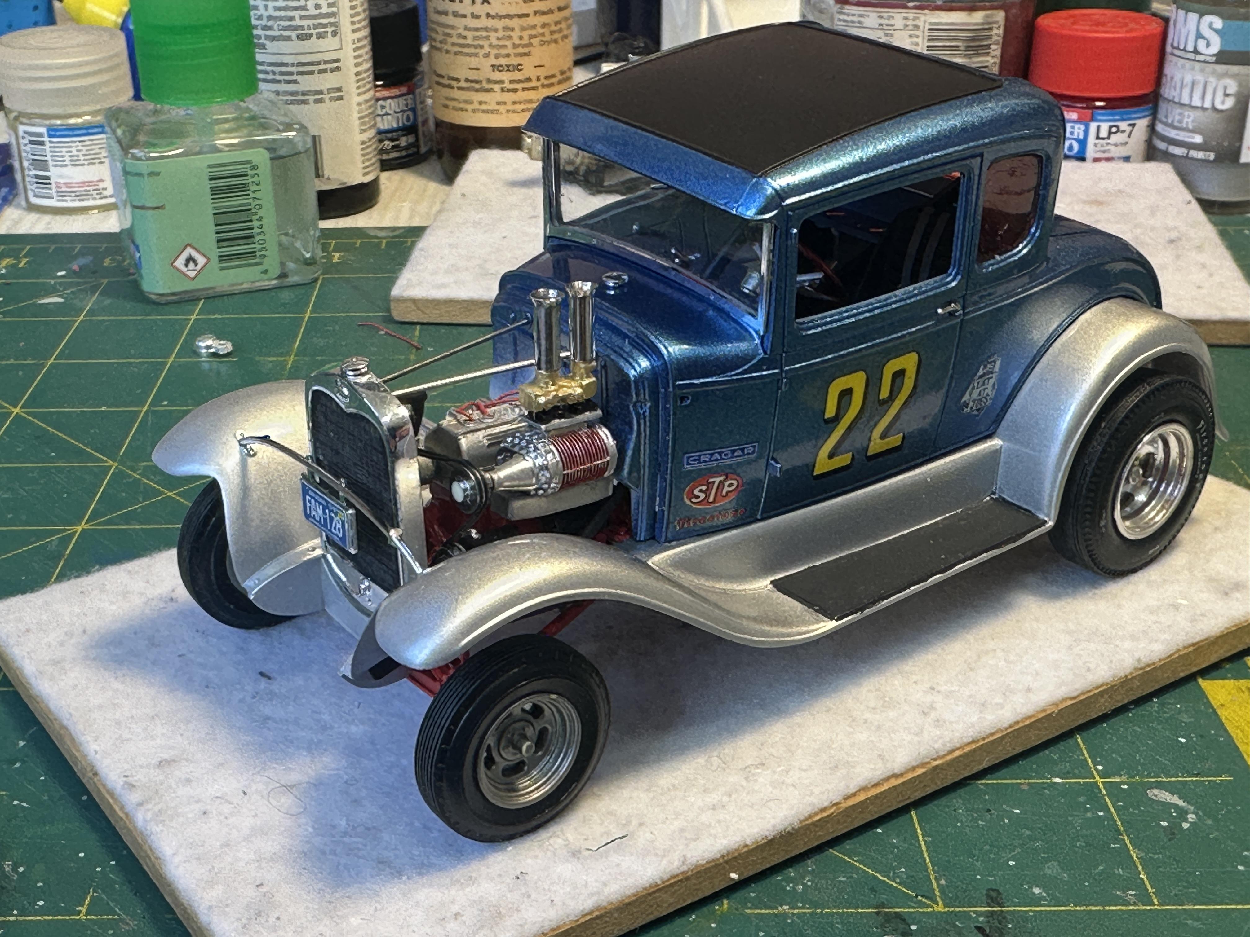

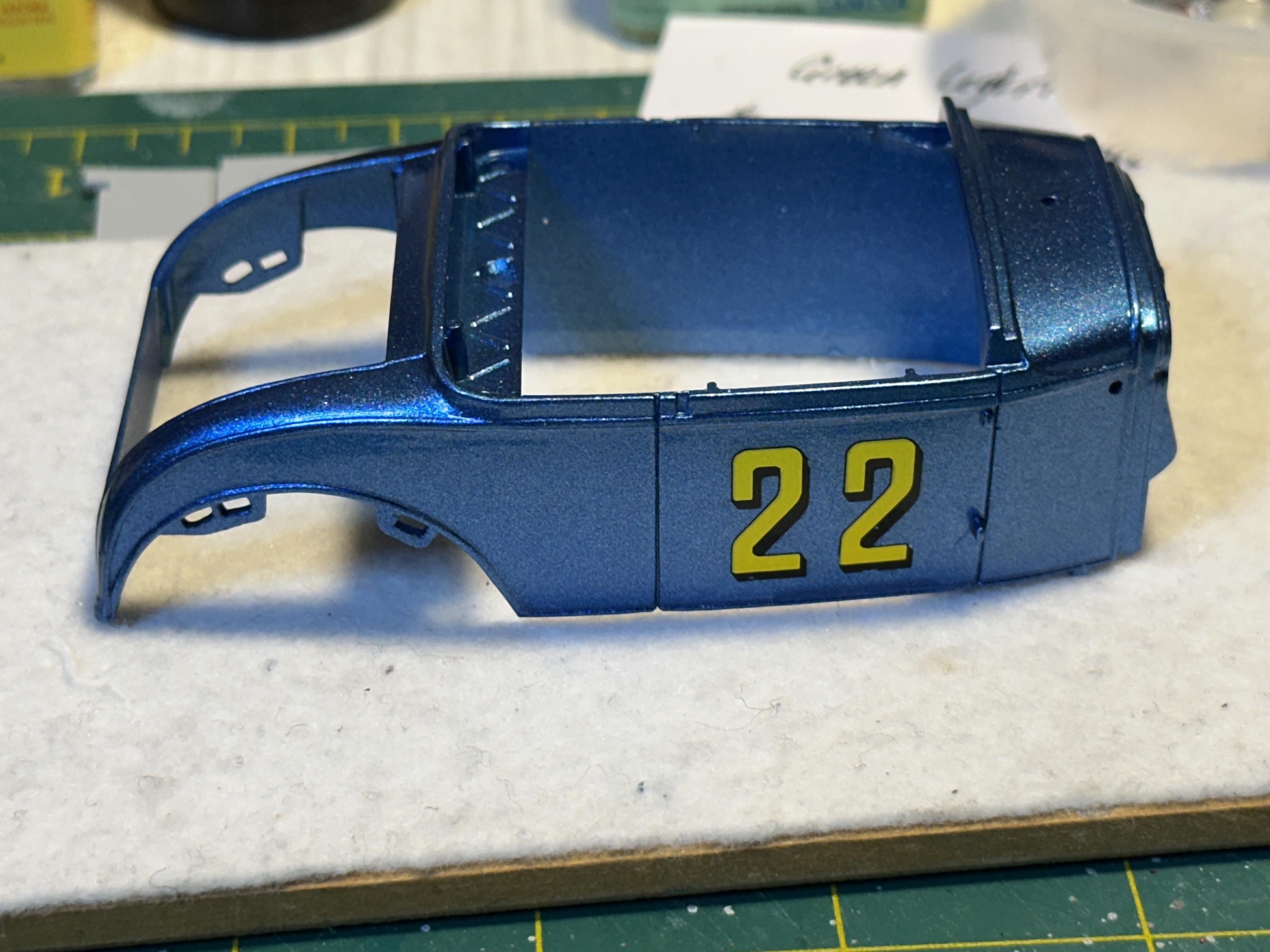

I have sanded to 3200g and squirted another coat of clear ready for decals.

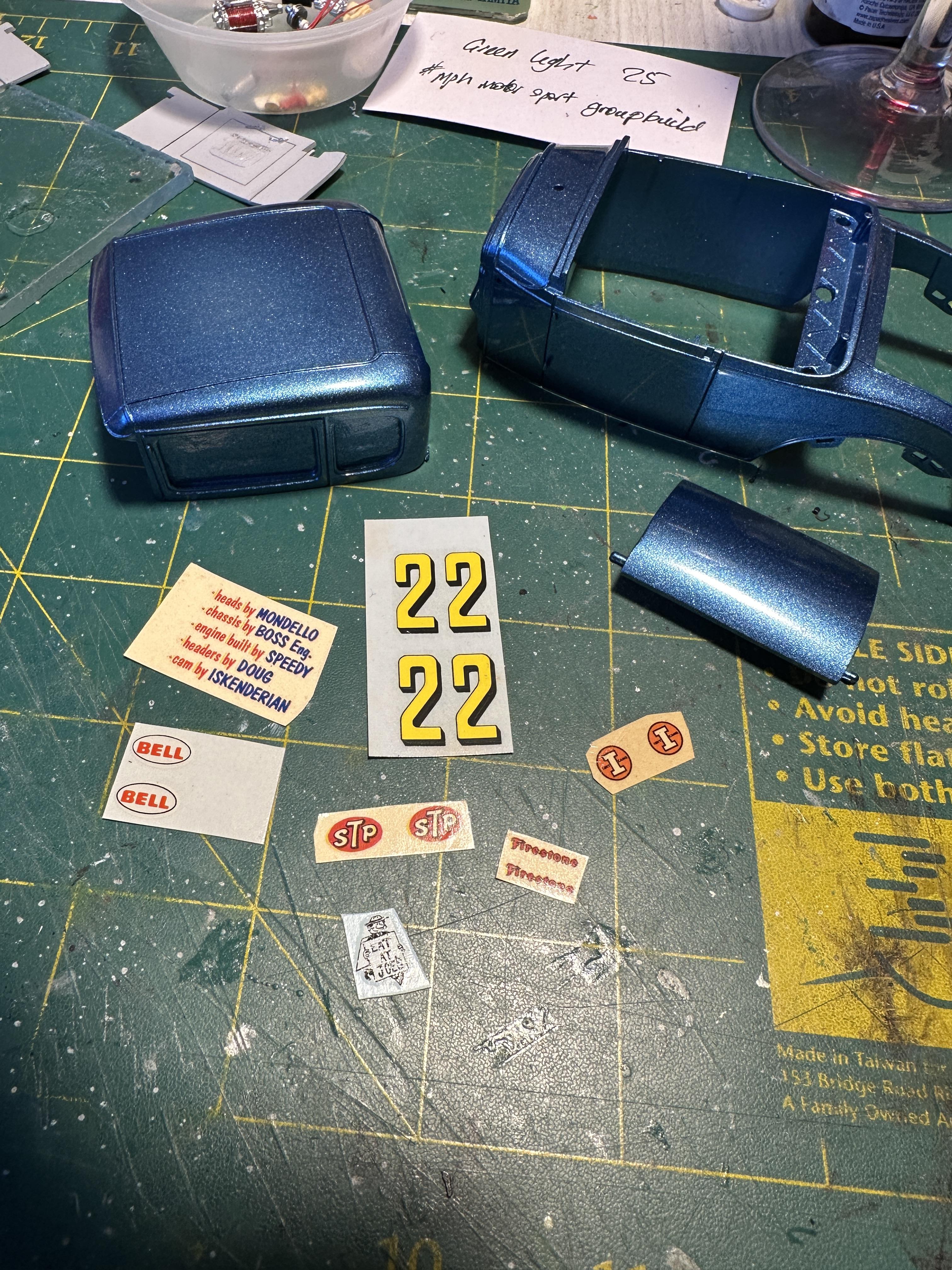

 Decals gathered together. I raided my decal stash - hard to find as I don't have or build many competition cars.
The sources are varied
22 numbers and Bell decals from Johan 69 RR
Sponsor decals from vintage AMT Double drag team and 37 Chev.
Eat at Joes from Revell 29 Roadster - only modern decals usedimage.jpeg.35ce1c8f6d188f2bd52d2ec388663502.jpeg

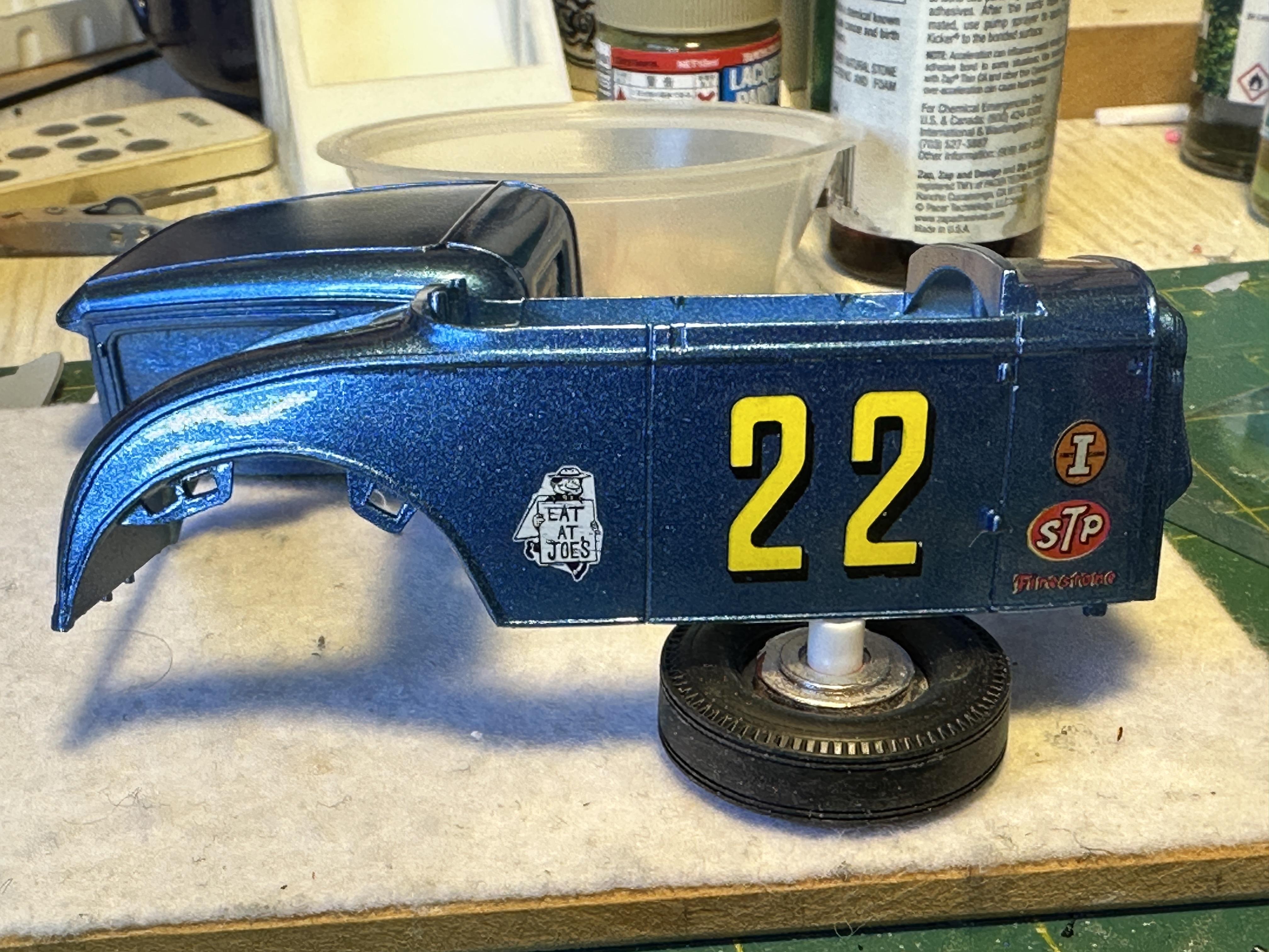

And getting them on. One of the 22 numbers on the drivers side broke apart and needed some tlc to get it all back together. Used a lot of decal setting solution to help. The carrier film on the old decals id continuous and needs close trimming. Also quite heavy too but that may because they were made here in New Zealand way back when (69-70)
  • Like 4
Thanks Rusty

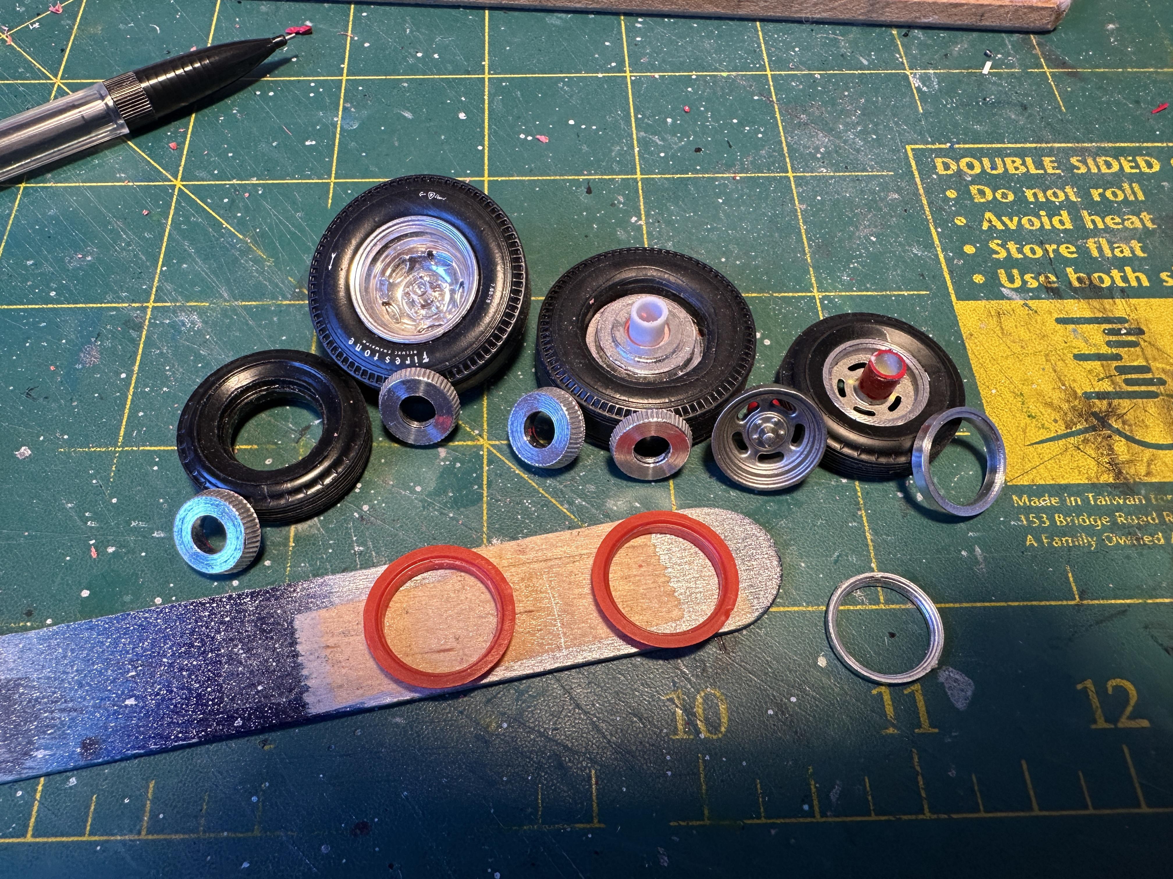

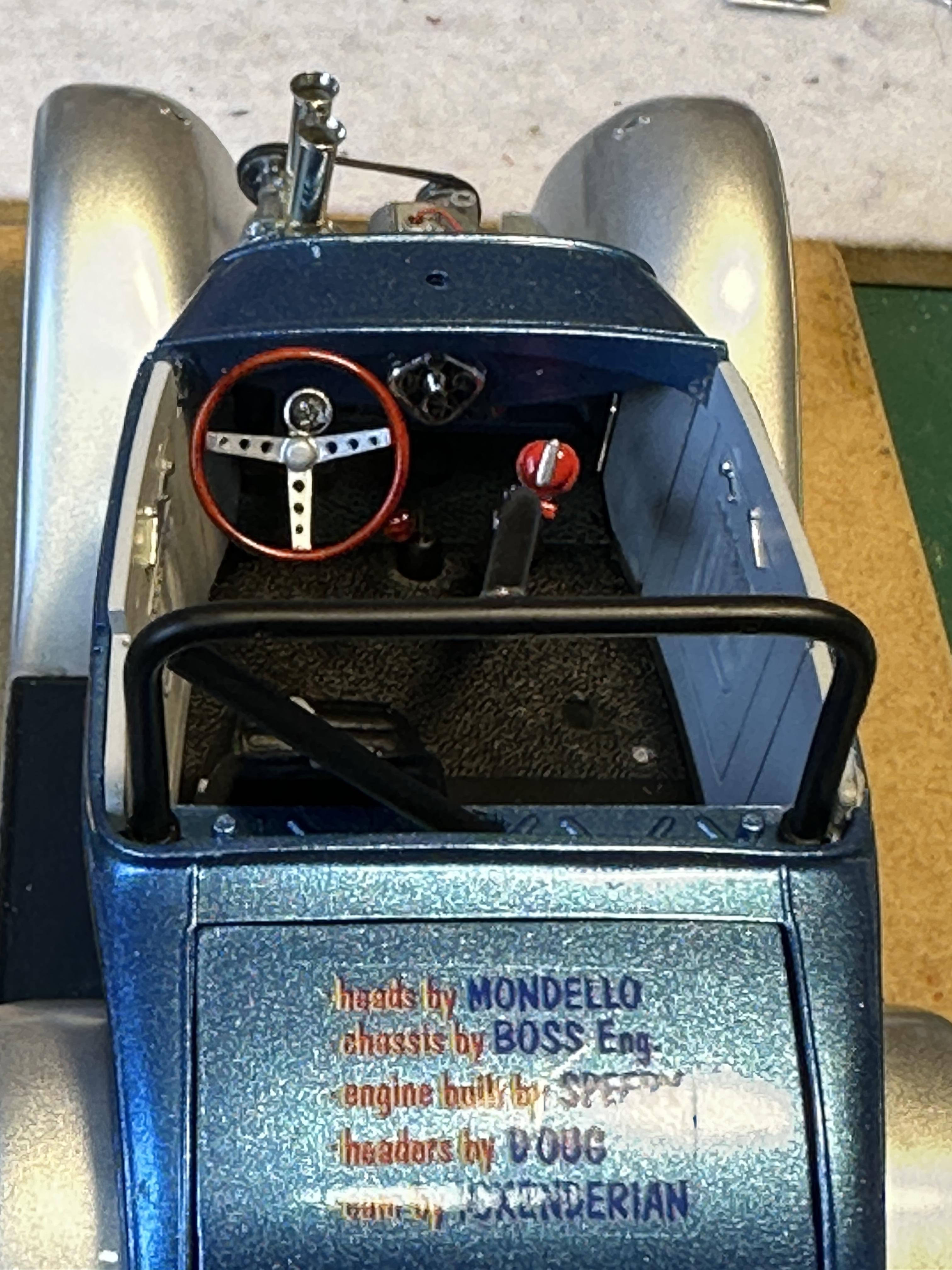

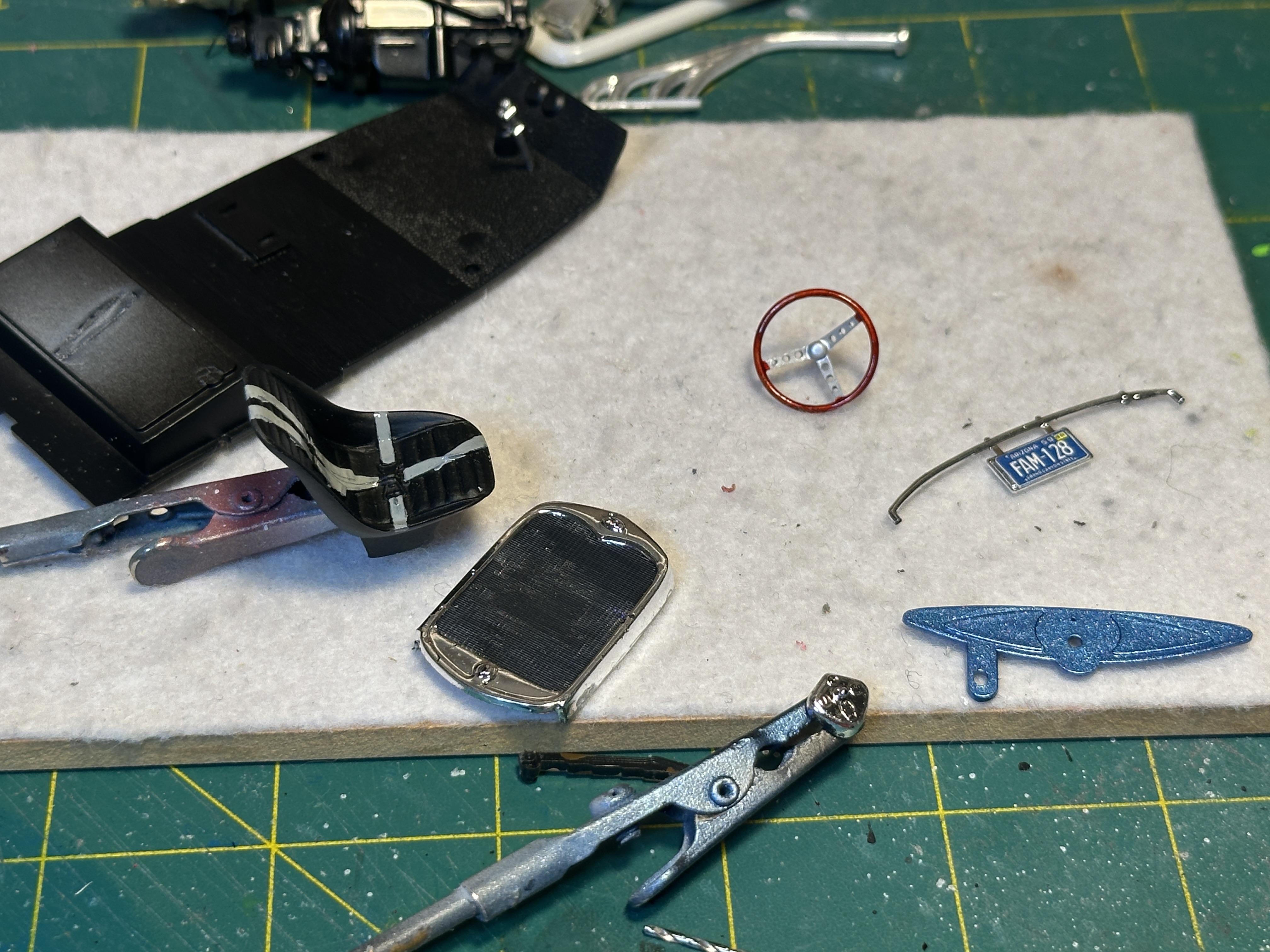

On with decals. Got some of the sponsor decals on - some were just too old and fell apart when transferring from the backing paper. Oh well that' what we get whenmessing around with old shite. Just enough to get by IMO. There is one I put on the boot lid but no pix yetimage.jpeg.258347a390b837804b9c7309e7e2b938.jpeg Mean time moving on with the wheels. I stripped the chrome from the fronts and painted magnesium. The rears I will leave in chrome - typical old timey mismatched wheels. I machined some rear wheel spacers - altered kit parts for the rear and ally for the fronts. Some more paint then onto assembly.

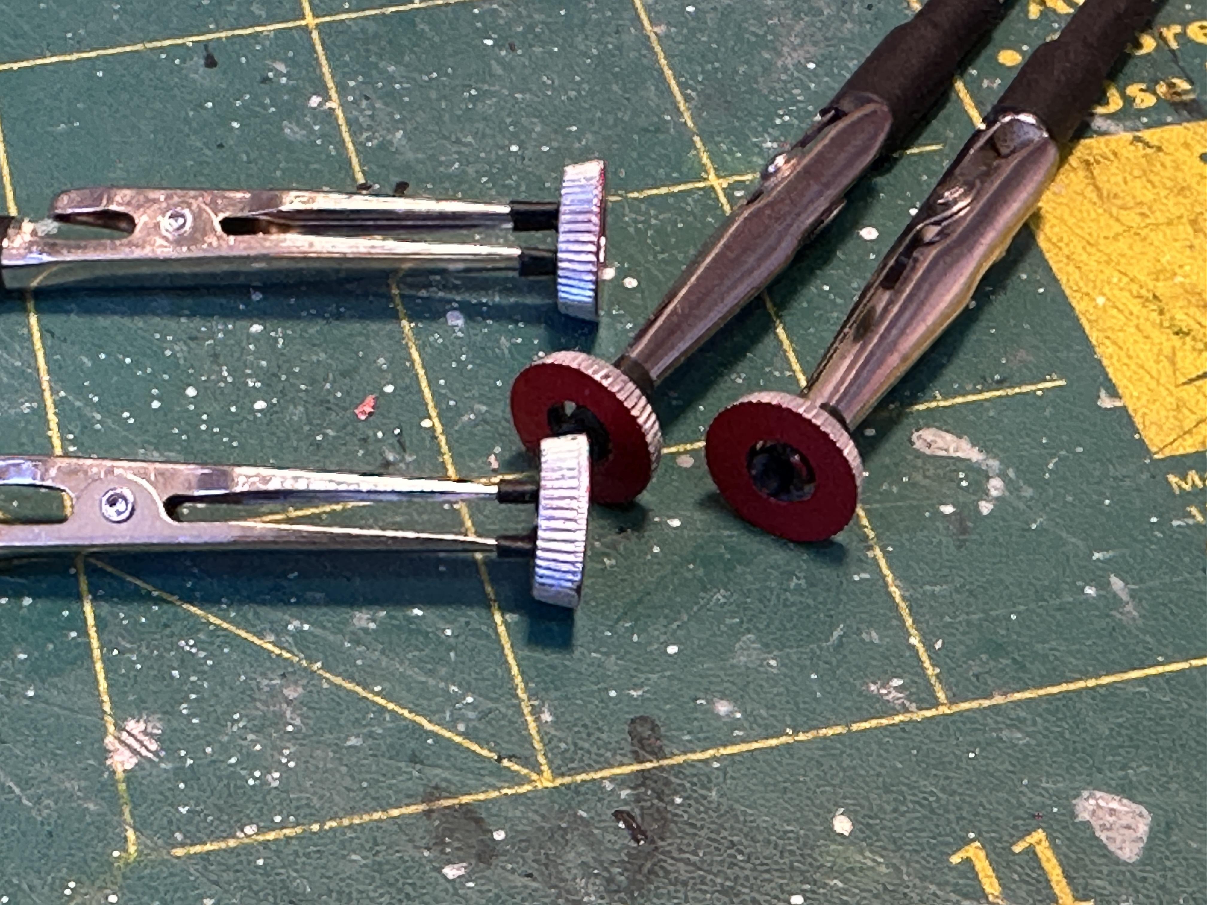

Shown in the above are some finned brakes - I machined on my "big" lathe from ally and straight knurned them. Skinny for the rear and wider for the fronts. The backing plates are painted the red accent colour I am using

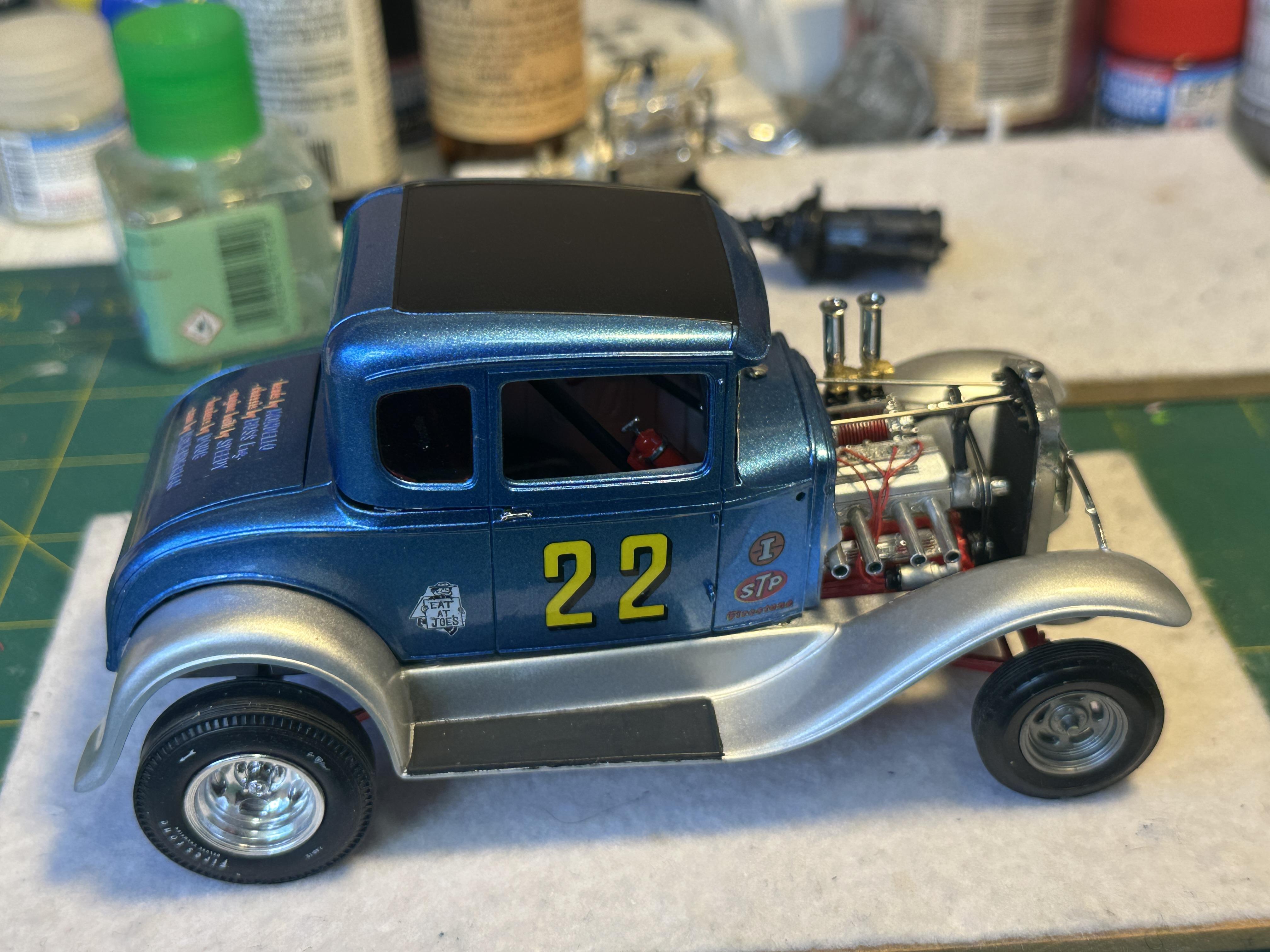

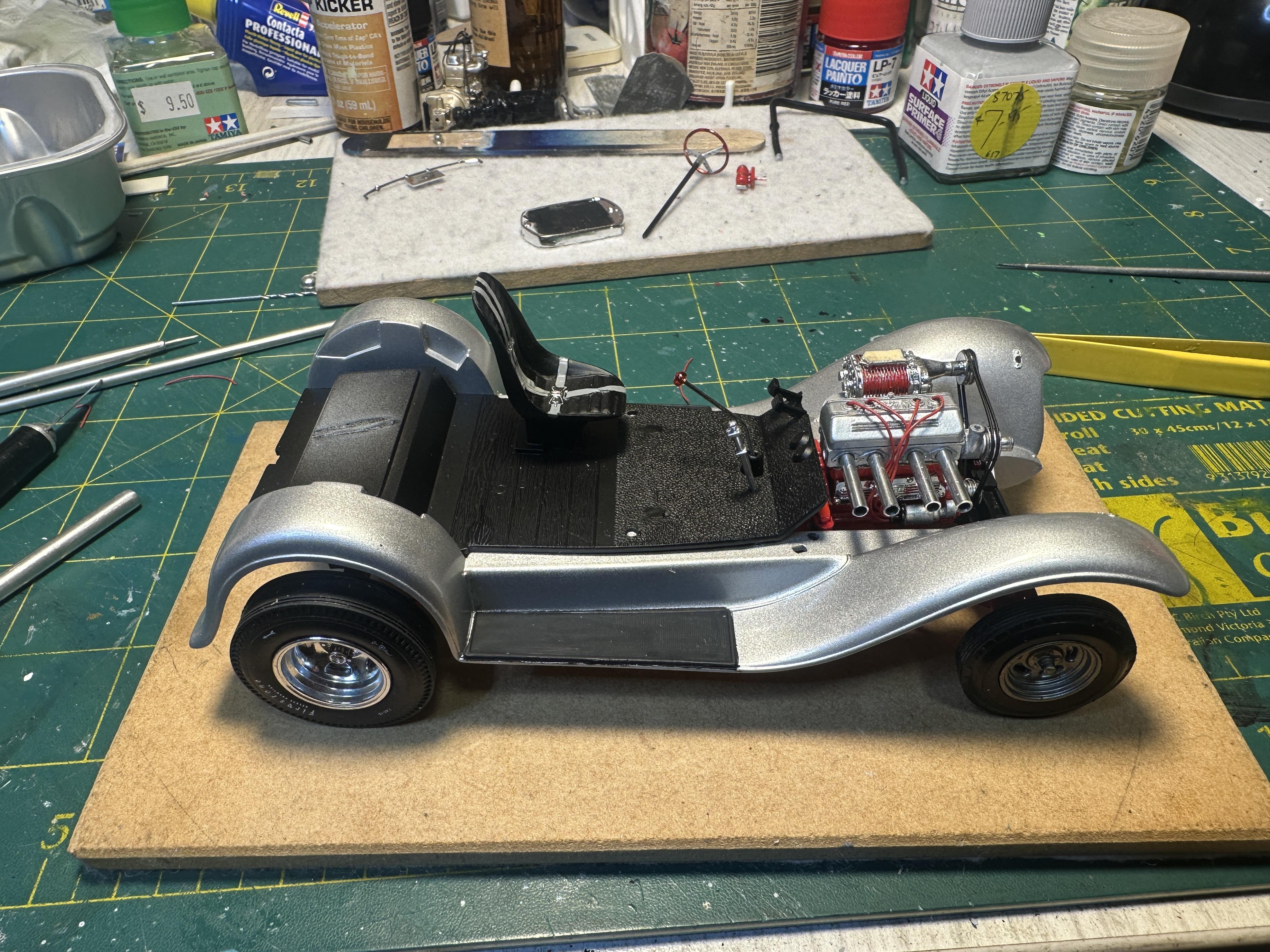

Paint detailed the brake drum fins with some watered-down red flowed into the grooves then cleaned up when dry to make the drums stand out a bit. I also remade a wider set for the rears as I was not happy with the original skinnies I had made up. I also tinted the rear and quarter windows with some Tamiya clear red - no pix yet

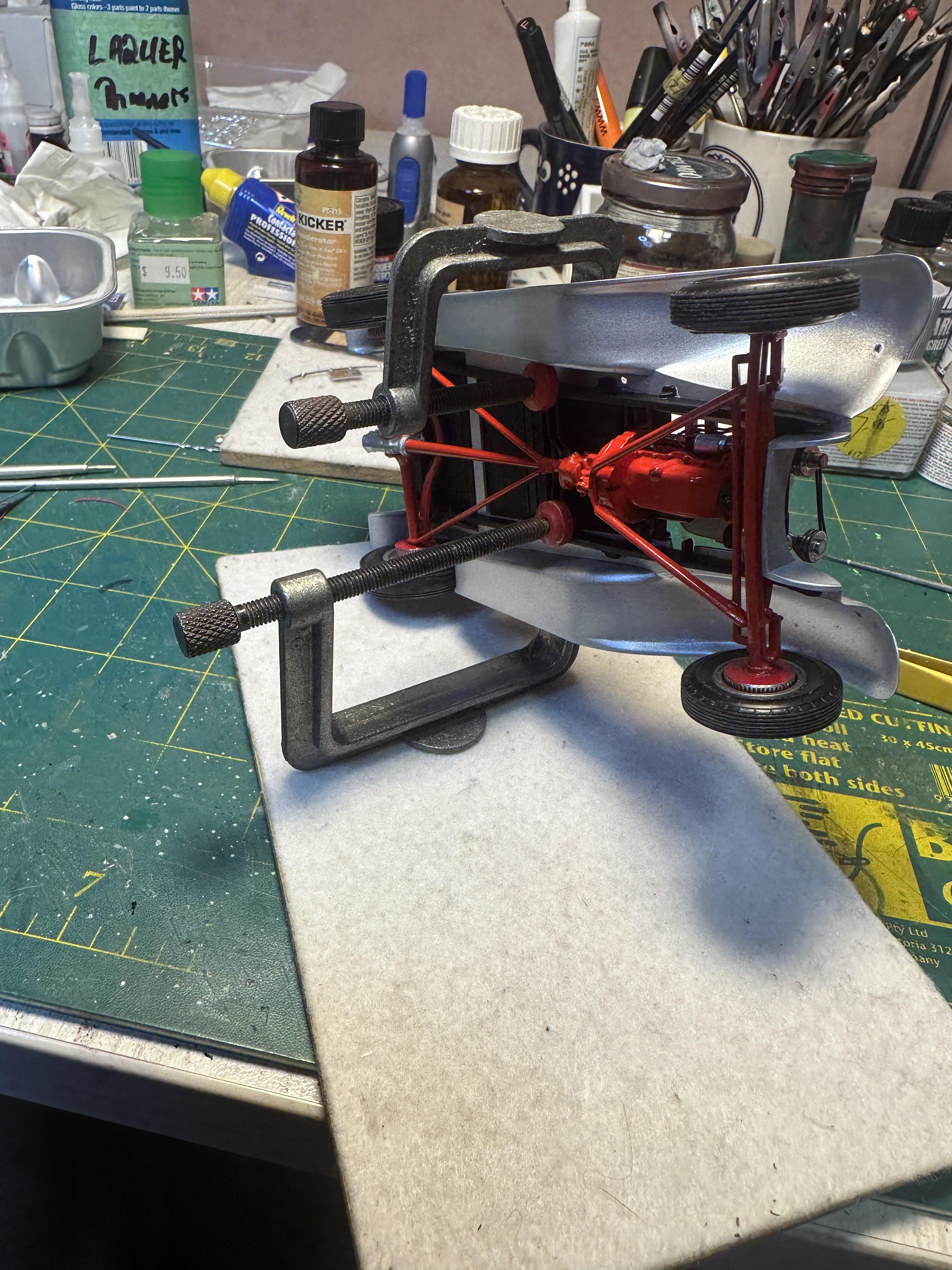

Time for a mock up to see how the stance is going.
There is a very slight rake going on here so I may look at lowering the back a little to get a flatter look and to get the wheels filling the fenders a bit better. I am happy with the front end though.

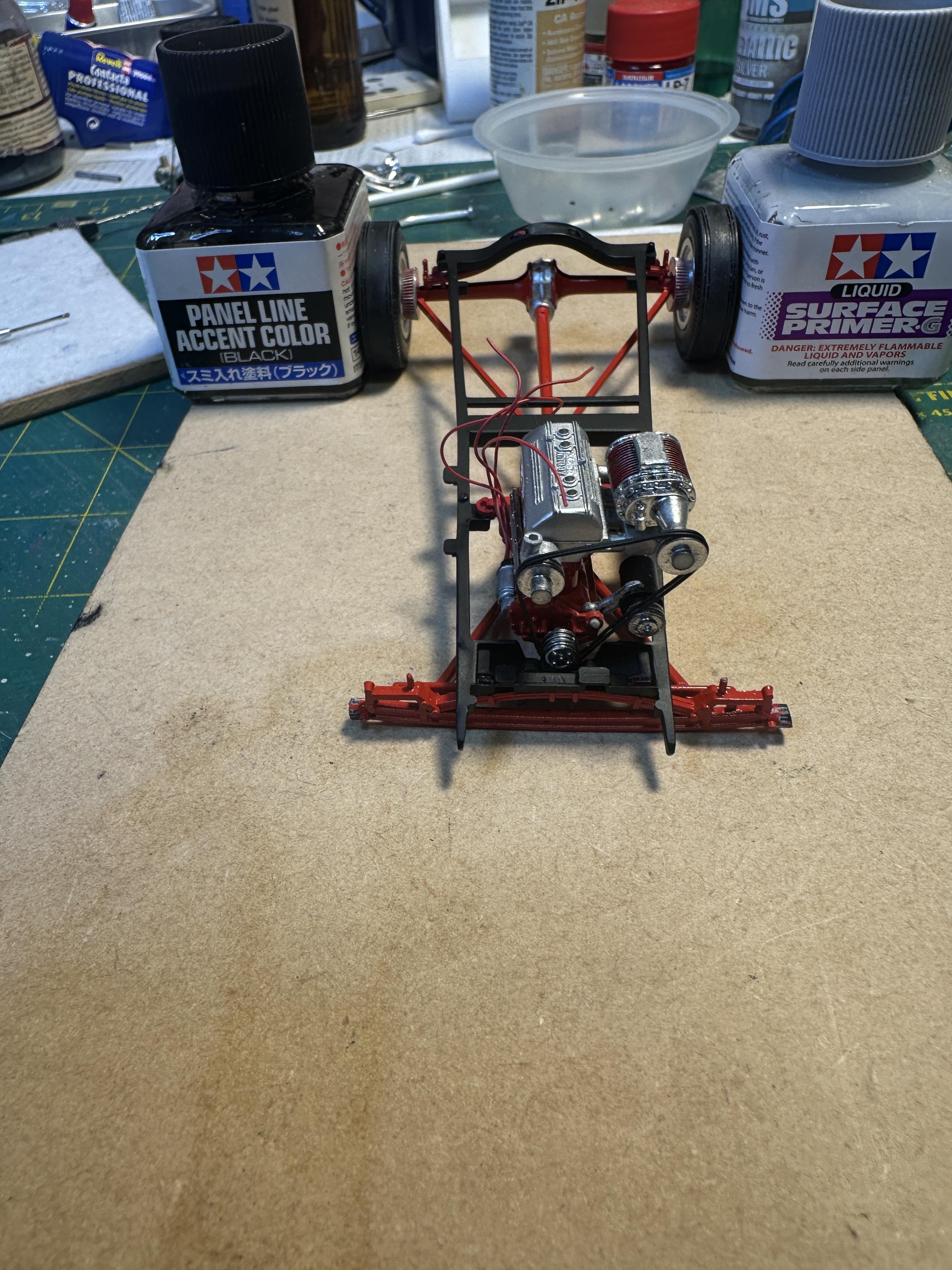

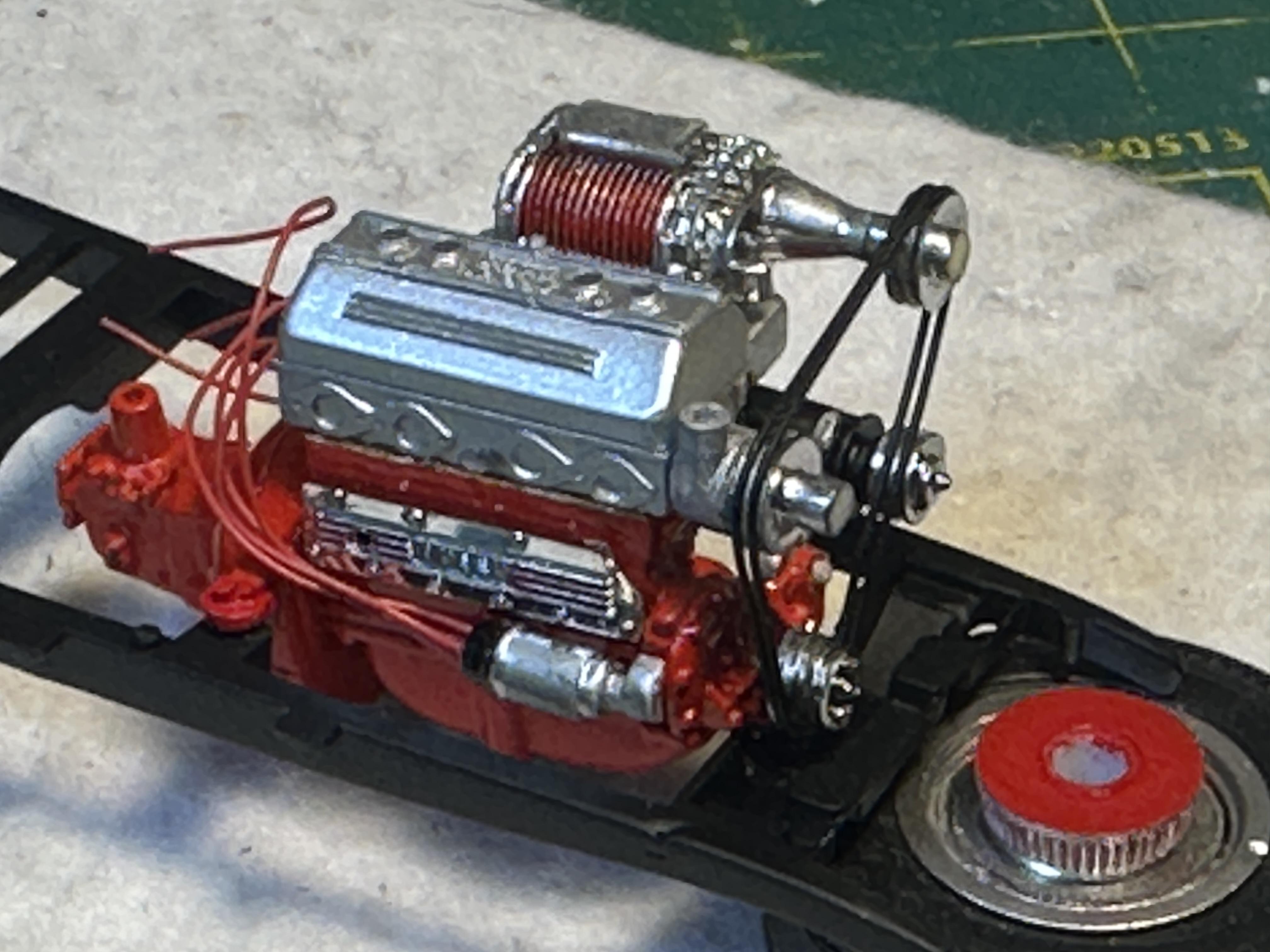

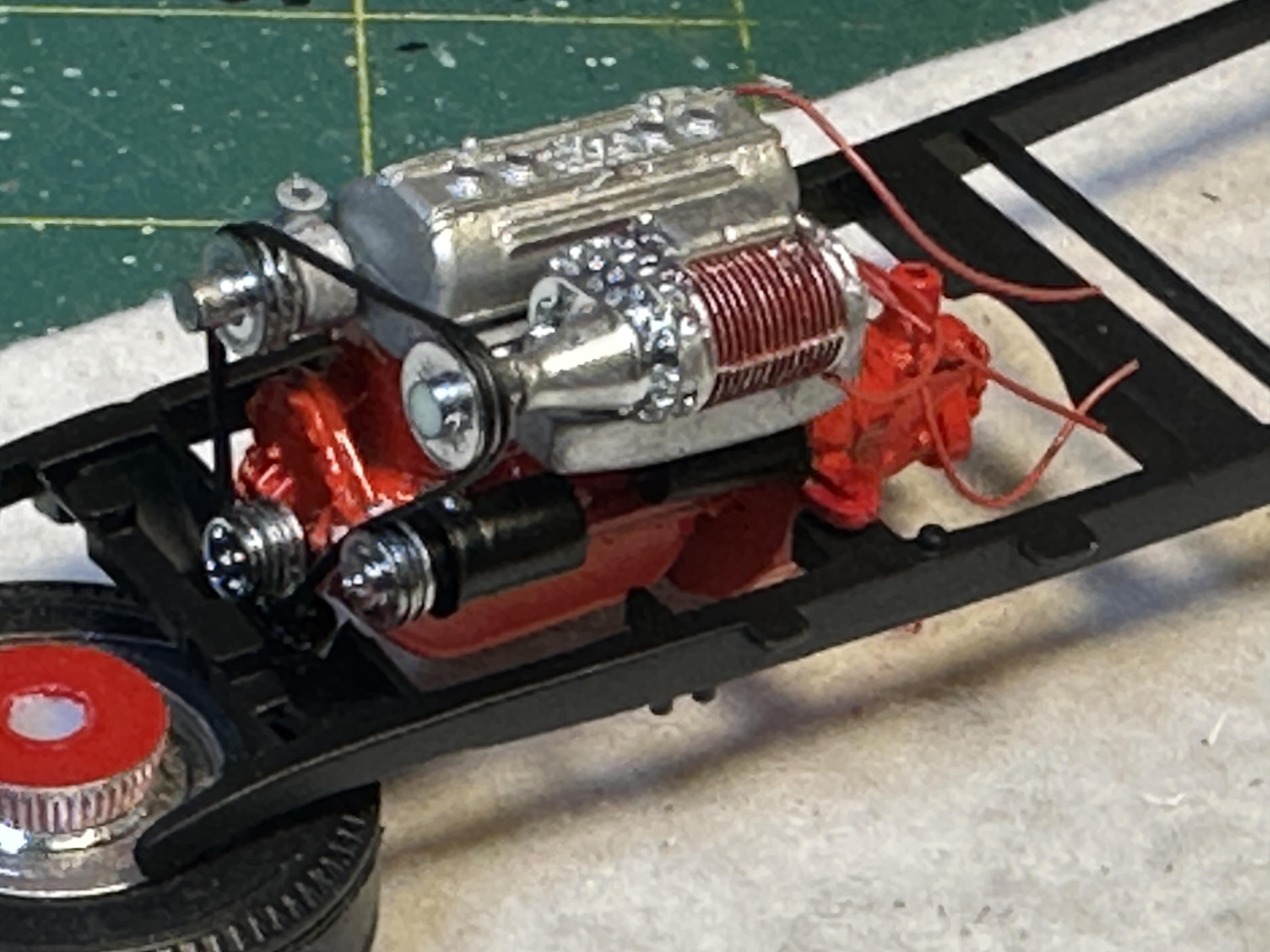

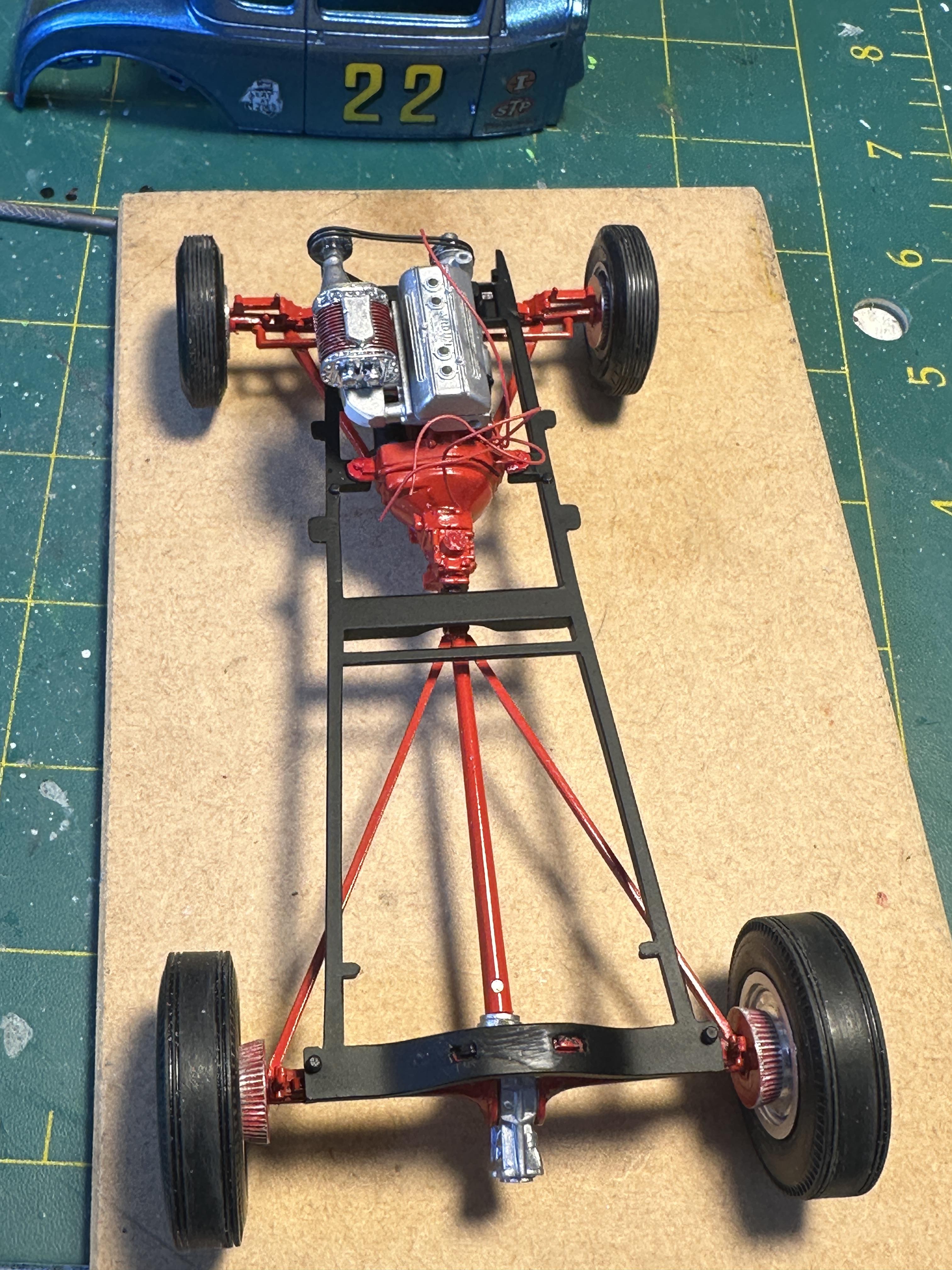

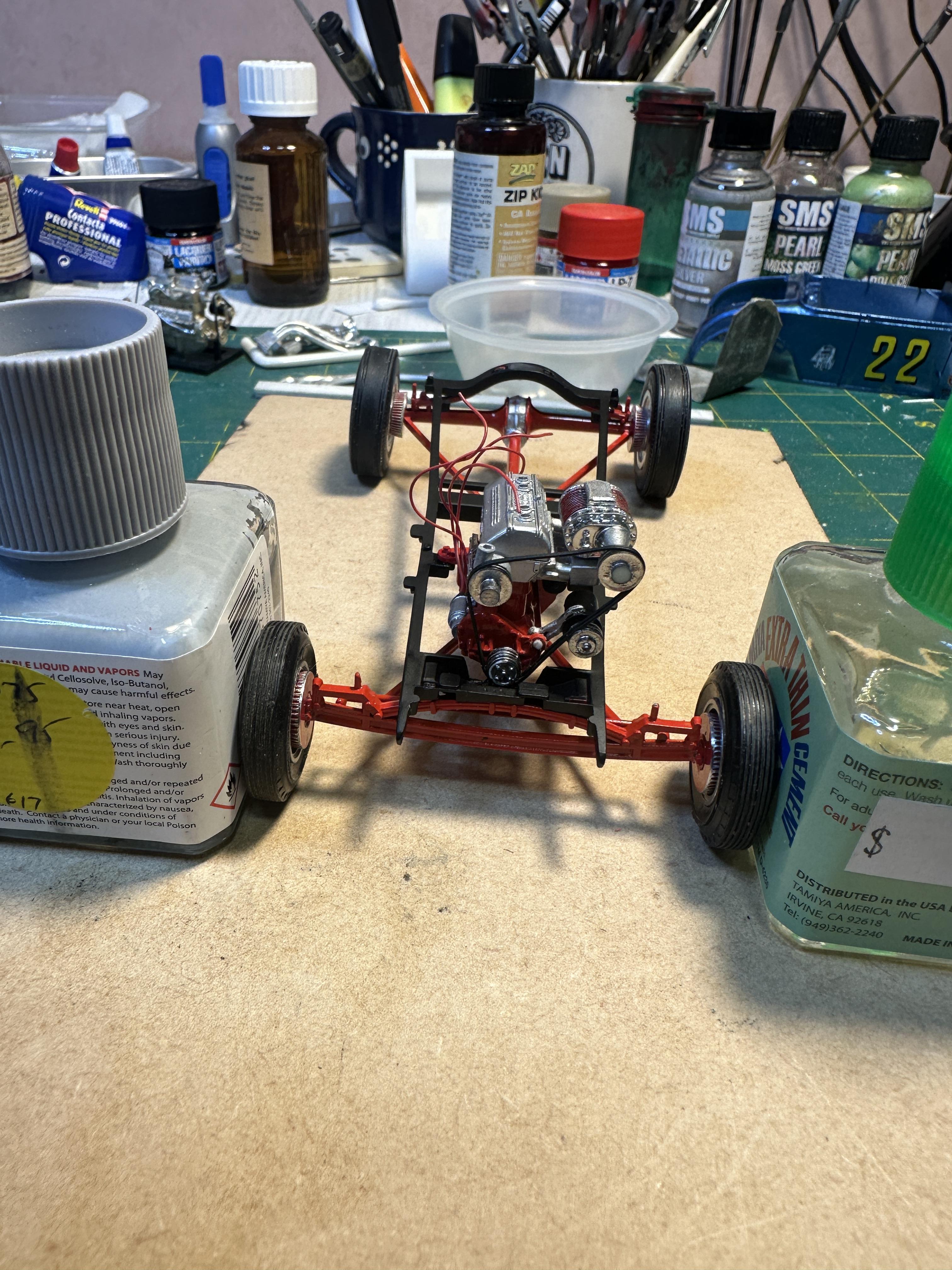

I have been slowly beavering away at this model - the deadline is closing in fast, so it is time to start getting it all together. I have fitted new rear motor mounts to take up the difference between the Monogram chassis and the Revell motor. And made a new one for the front too.
And fitted the pulleys and made some fan belts from some 0.5mm black wire - like plug wire but slightly larger.

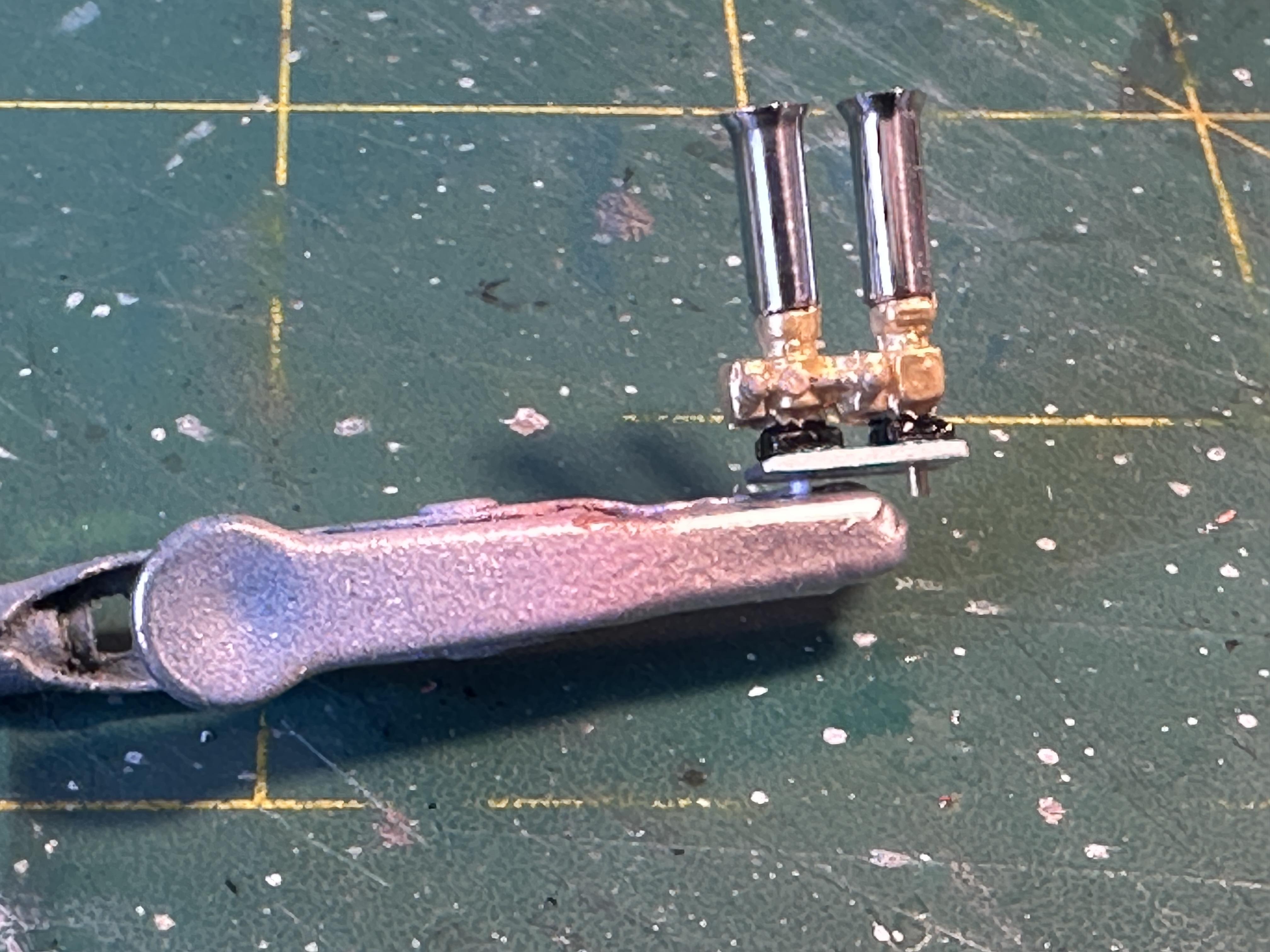

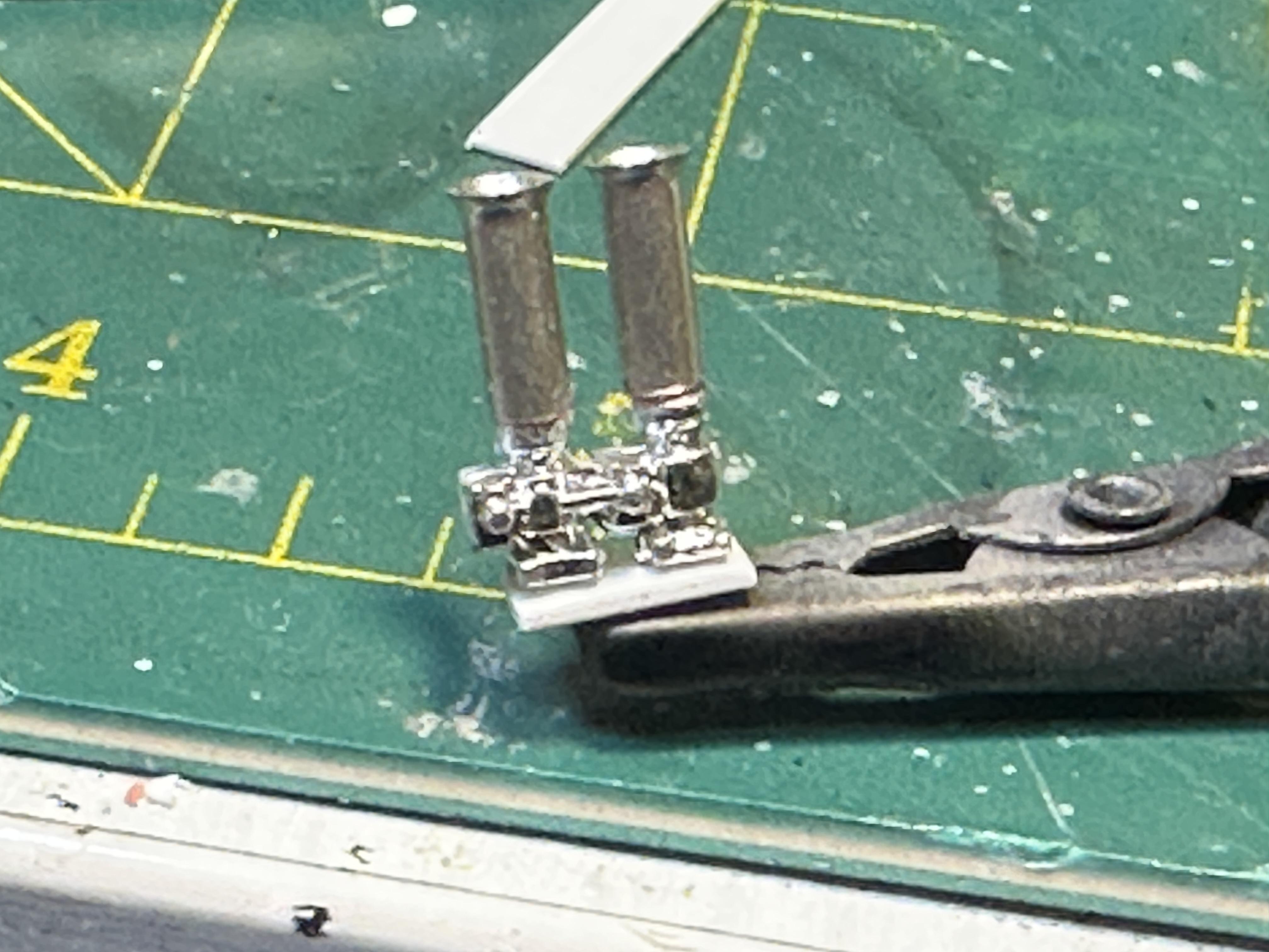

Cleaned up some carbs and have adapted some electrical wire ferrules for the carb stacks
I have painted the carbs gold with the bases sg black - waiting for that to dry. Also polished up the stacks so nearly ready to put the motor to bed

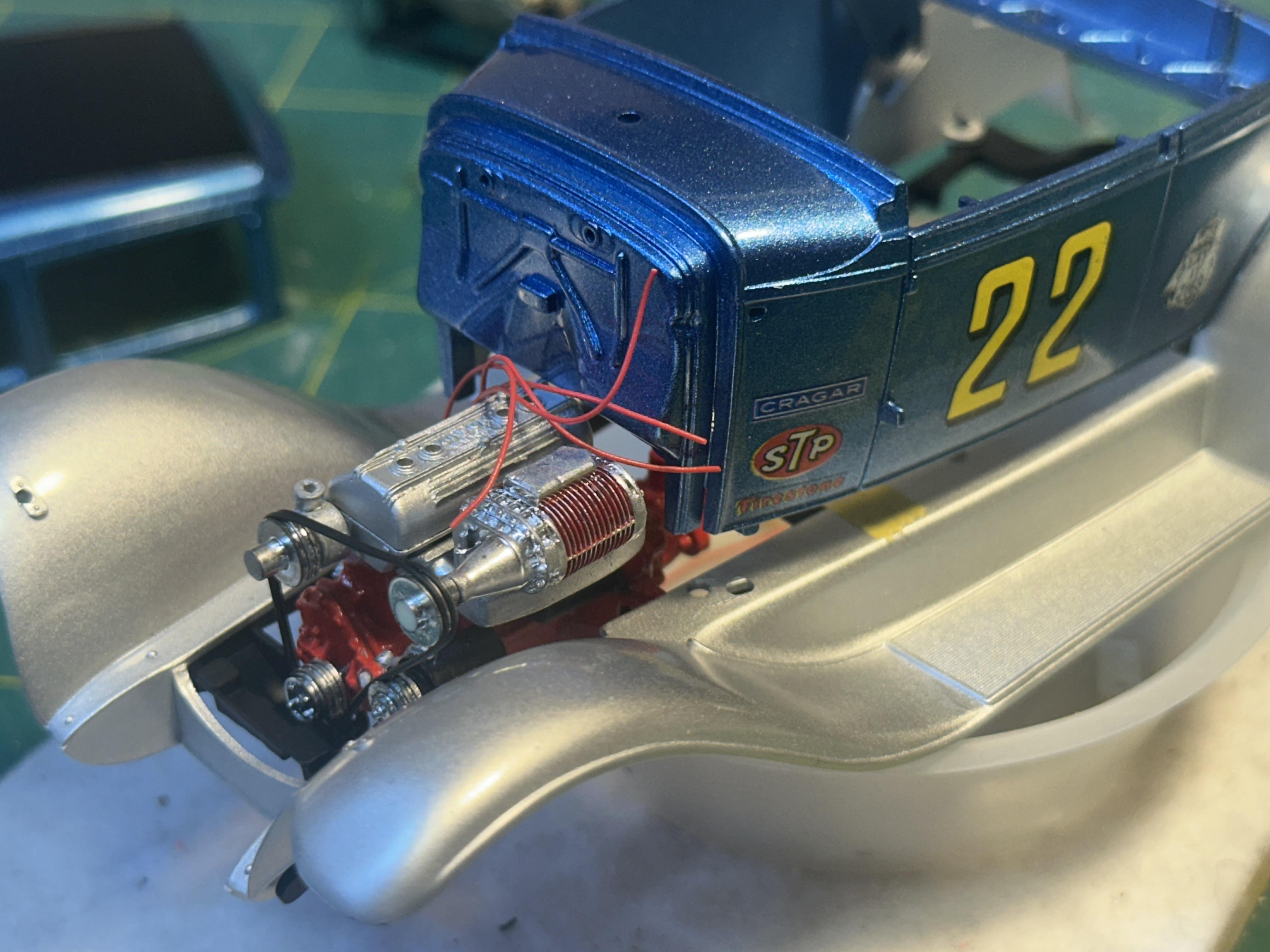

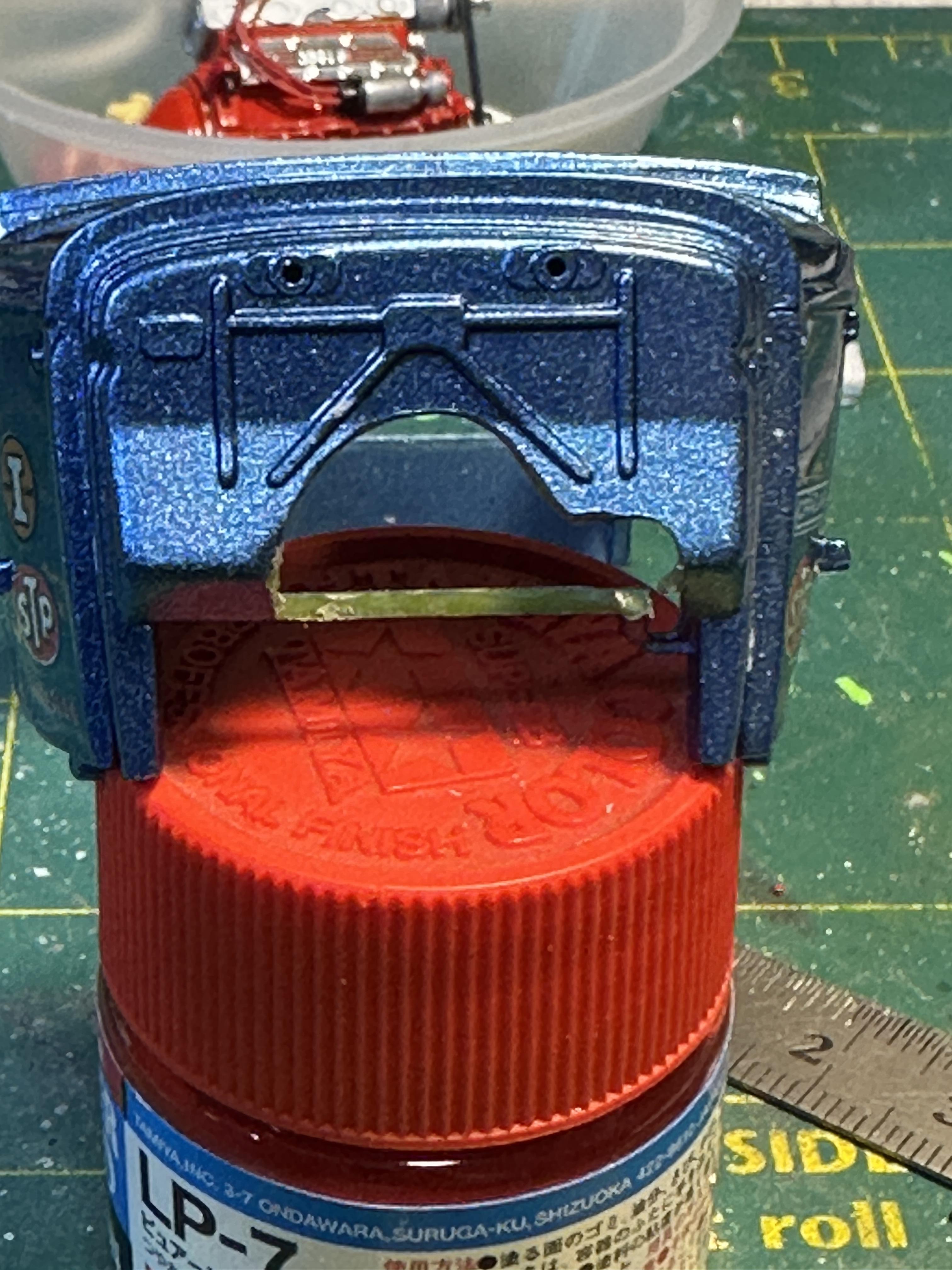

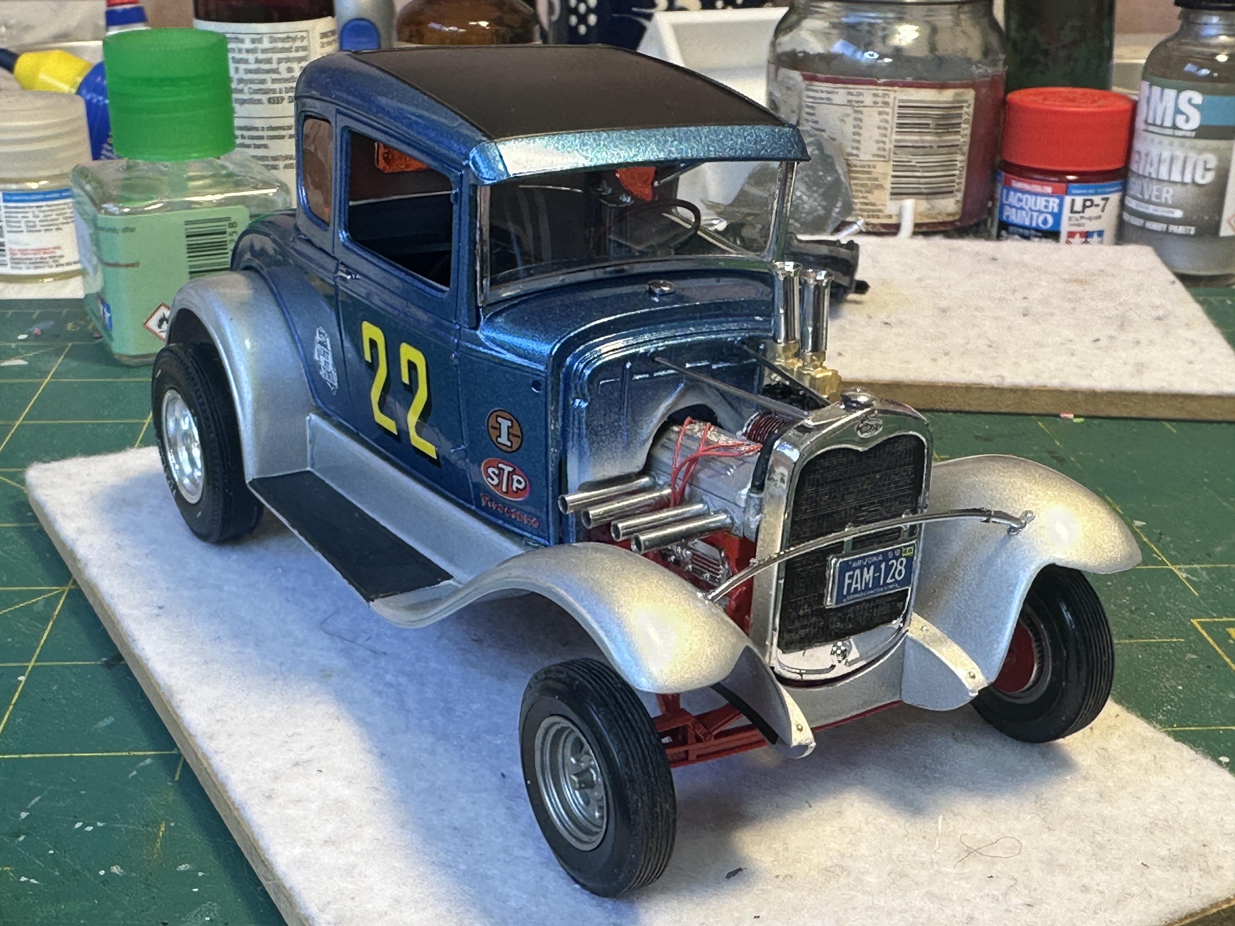

Tonight's effort was to check fit the body and frame with motor. I expected a tight fit but not this tight - I will need to ring the butcher
Well the butcher has been and gone and this is what is he left.
I will spray some primer around the hole to represent a newly butchered body to fit the new race motor. This motor is huge - well compared to a stock banger it is
