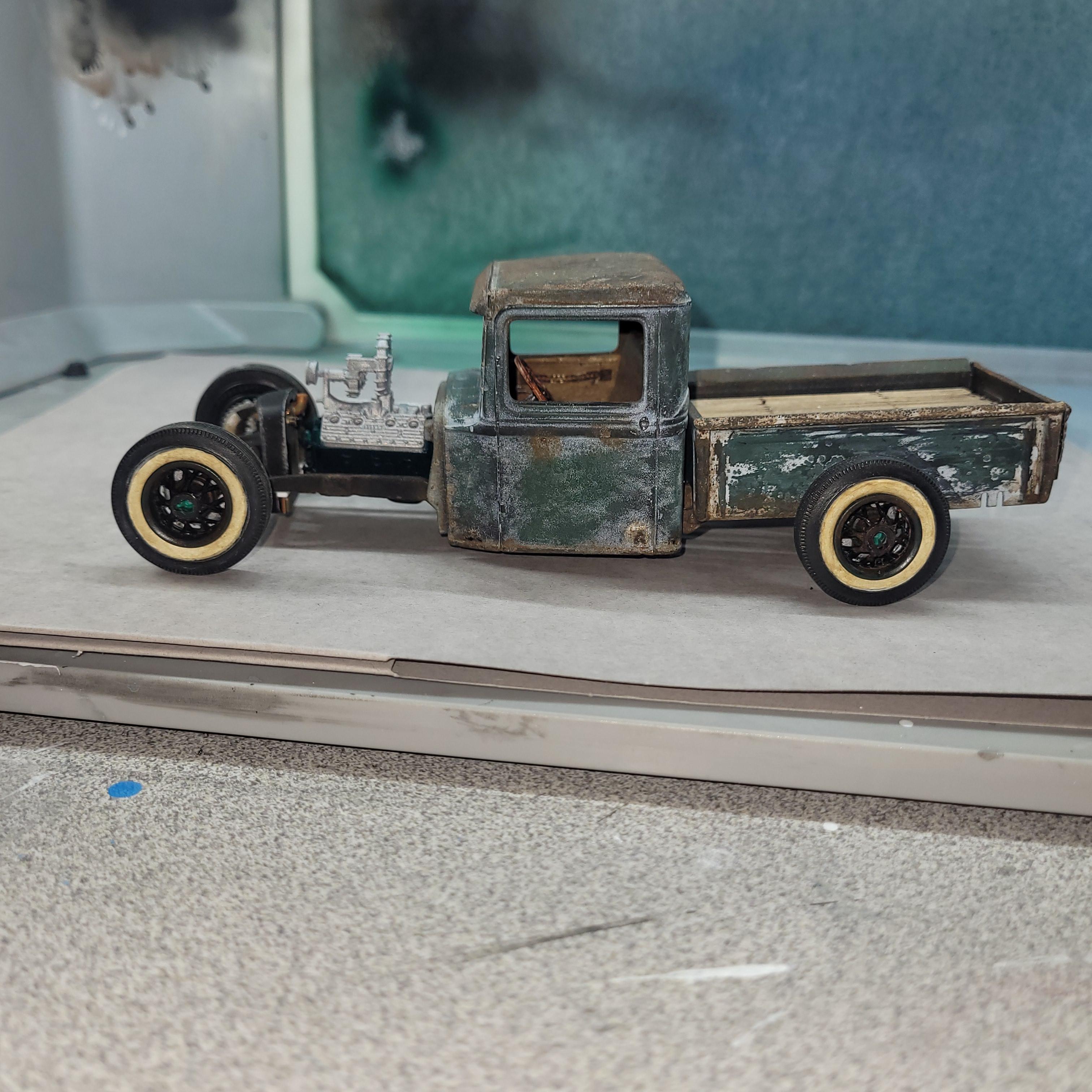

johnyrotten Posted yesterday at 02:03 PM Posted yesterday at 02:03 PM This example is the extreme side, I basically reproduced what happens in nature. Multiple colors, coats, very light airbrush to simulate a spray bomb job. Very little sanding on this. A stiff brush over almost dry paint for the blending. There's laquer, enamel and craft/water based paint on this thing. Sealed with testors dullcoat. It even feels crispy.
