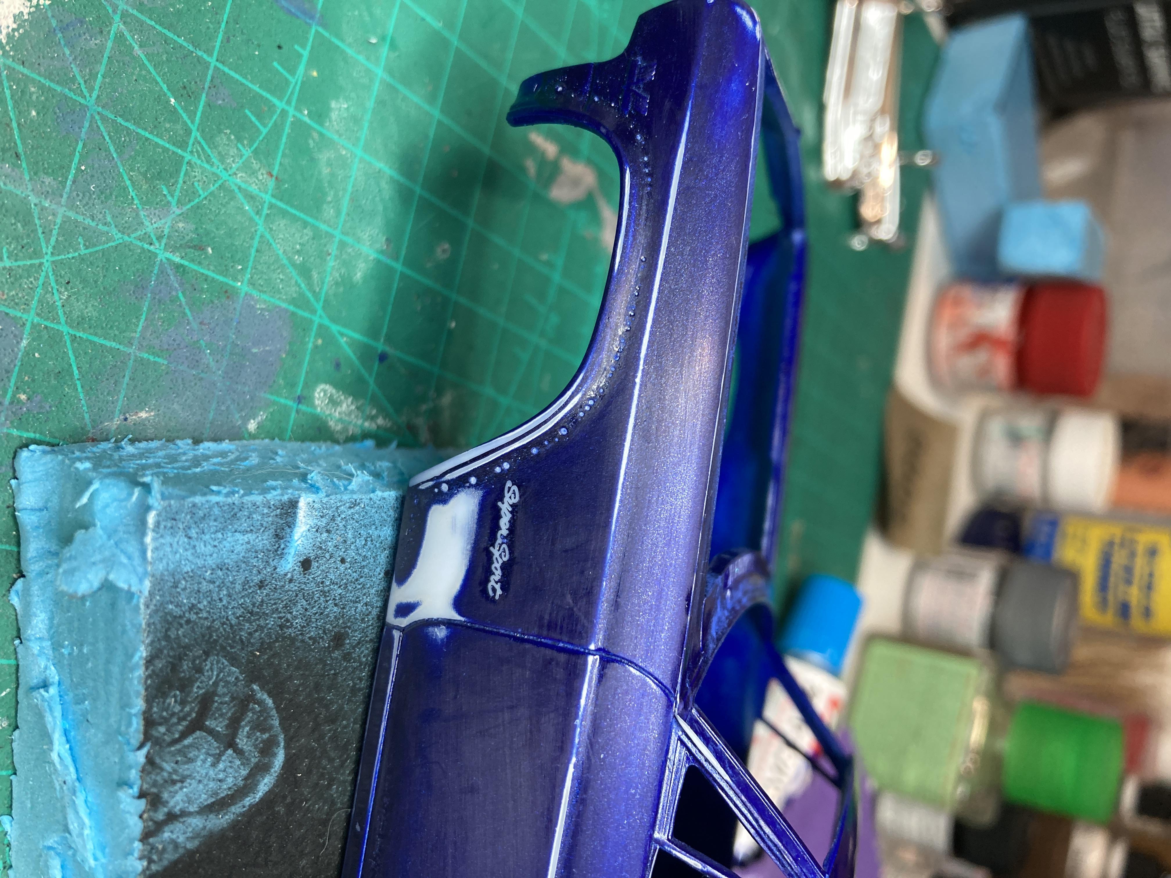

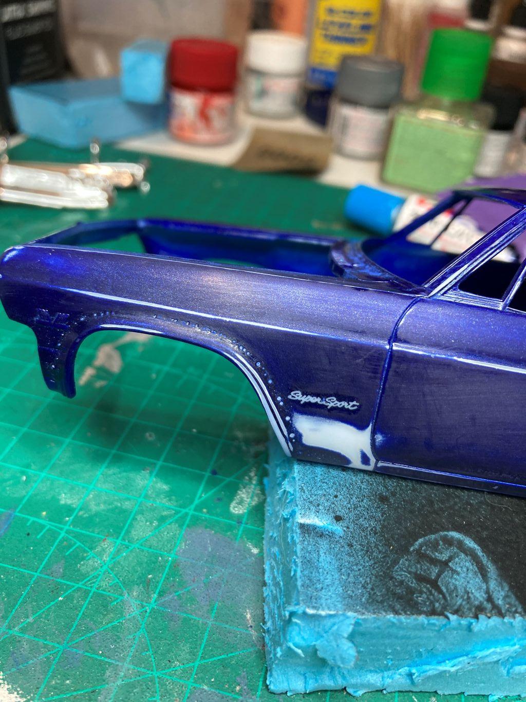

Donny Posted October 21 Posted October 21 (edited) Run into a problem guys. I've got these terrible pin BLAH_BLAH_BLAH_BLAH spots around the wheel arch and along one of the body trims. So, is this too much paint? I've started to rub the paint back as you can see and in places I'm down to the primer. My question is, rub it back more and then add primer, add rub the whole body back and reprime. Opinions please. What I have been doing is for color, two light coats and then a heavy/wet coat, is this correct? Thanks Don Edited October 21 by Donny
STU111 Posted October 21 Posted October 21 Hey Don. I can’t say for certain what caused the spots, but I’d start over, if it’s Tamiya lacquer, submerge the whole body in isopropyl alcohol, it will strip off the paint. I had to do this with one of my previous builds, takes a couple of days, but comes off mostly, the more stubborn parts you can scrub with an old toothbrush. 1
johnyrotten Posted October 21 Posted October 21 Probably solvent pop. Basically the next coat traps the solvent of the previous and it tries to work its way out causing this. Like Stuart said, strip it and start over is a good idea. Too heavy with paint, too soon with the next coat can cause this. The type and brand of paint can be very helpful for others to identify the issue and give advice. If you sand, you might lose some detail, like the emblem or the wheel arch trim. 2

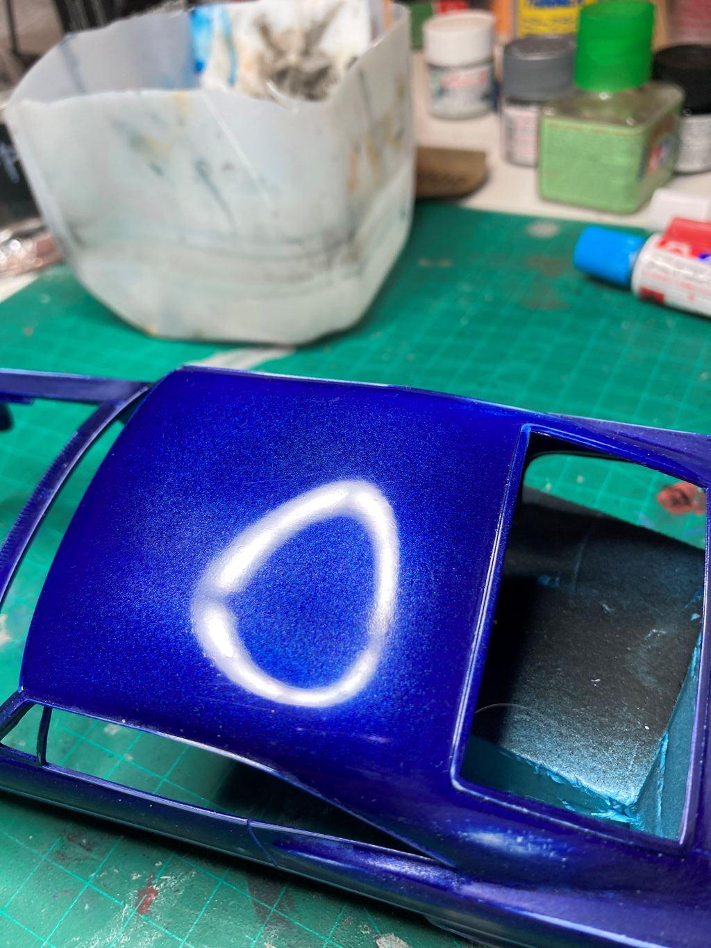

Donny Posted October 26 Author Posted October 26 SO, I guess when it goes wrong, it really goes wrong. Managed to get the Impala repainted but not without an error, the paint on the roof (this time), LHR was not good, being polite here. so I took to it with the W&D and you guessed it, yep through to the primer, I'm being polite calling myself DH. Please check the pic and tell me it's repairable. Thanks. The good news is I polished the Mercury and it's looking okay. Don

STU111 Posted October 26 Posted October 26 Hmmm. It’s a tough one. You probably don’t want to strip it again, so I’d give the affected area a quick shot of blue to mitigate the lighter primer colour, let it dry then give the whole body a couple of coats. Hopefully, the bare primer area will be unnoticeable after this. What paint are you using Don?
Donny Posted October 26 Author Posted October 26 1 minute ago, STU111 said: Hmmm. It’s a tough one. You probably don’t want to strip it again, so I’d give the affected area a quick shot of blue to mitigate the lighter primer colour, let it dry then give the whole body a couple of coats. Hopefully, the bare primer area will be unnoticeable after this. What paint are you using Don? Thanks Stu, I really have messed this one up. Tamiya TS51 Racing blue
Donny Posted October 26 Author Posted October 26 I thought I might be able to as you have advised, lay a coat over the bad patch, and try to polish it in. Does that make sense? Don
STU111 Posted October 26 Posted October 26 2 minutes ago, Donny said: I thought I might be able to as you have advised, lay a coat over the bad patch, and try to polish it in. Does that make sense? Don You can try it but it’s a dark colour and may need a couple of layers to hide the bare primer patch. Do you plan to put clear coat over it?
Donny Posted October 26 Author Posted October 26 5 minutes ago, STU111 said: You can try it but it’s a dark colour and may need a couple of layers to hide the bare primer patch. Do you plan to put clear coat over it? At the moment, not sure, the rest of the car looks okay quite a good finish. I was going to polish it and see how it looked, then decide on the clear coat. I'm close to the point where I think I should drop this, I'm getting negative about it.
Donny Posted October 27 Author Posted October 27 The paint is a sort of iridescent (spelling?), I thought it was a solid colour when I did the spoon test, that's what it looked like, probably because of my poor eyesight. I think I might be better off to sand it back and try another colour - repaint it completely. Not strip it, sand it back and maybe should I give it another light coat of primer and then colour.
