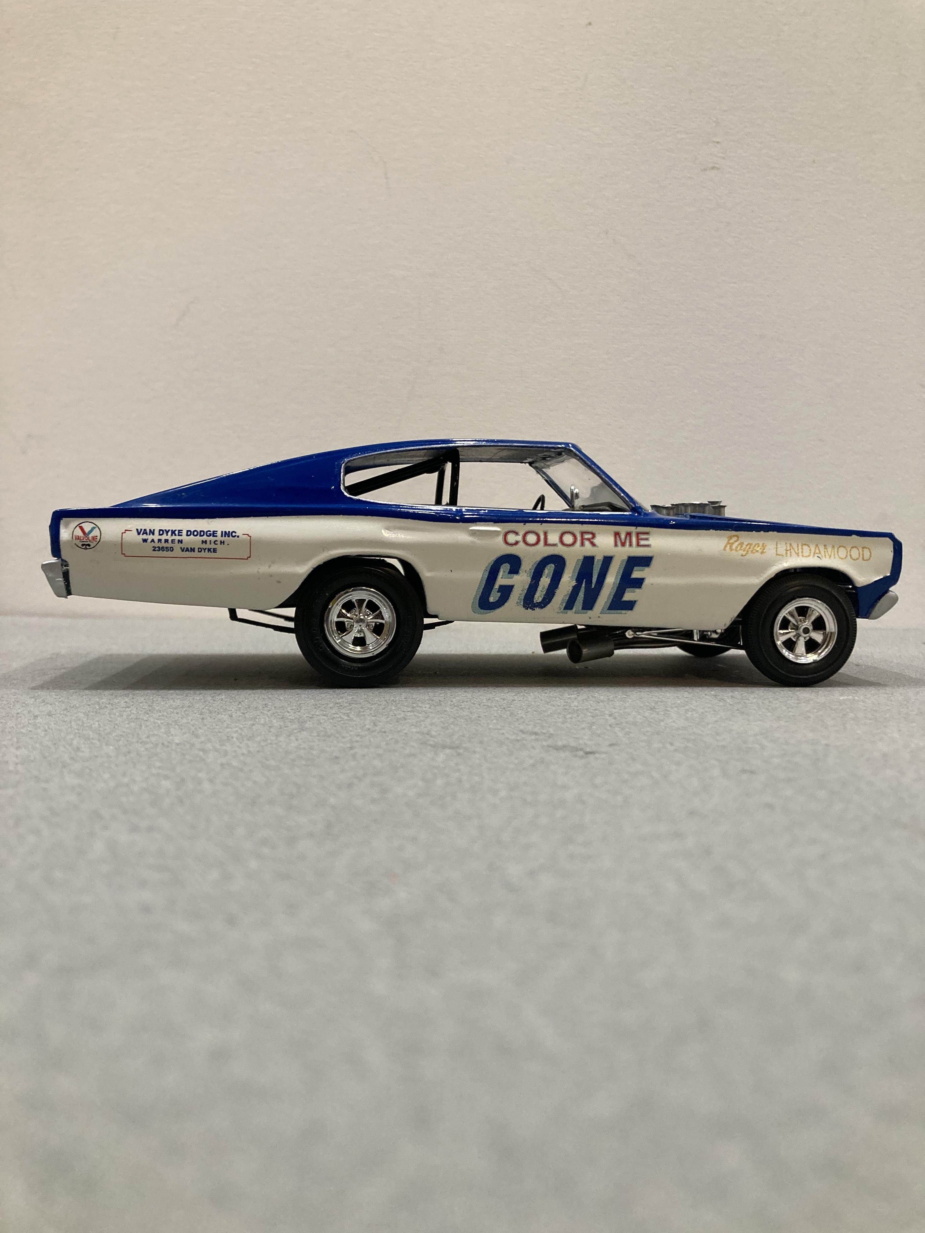

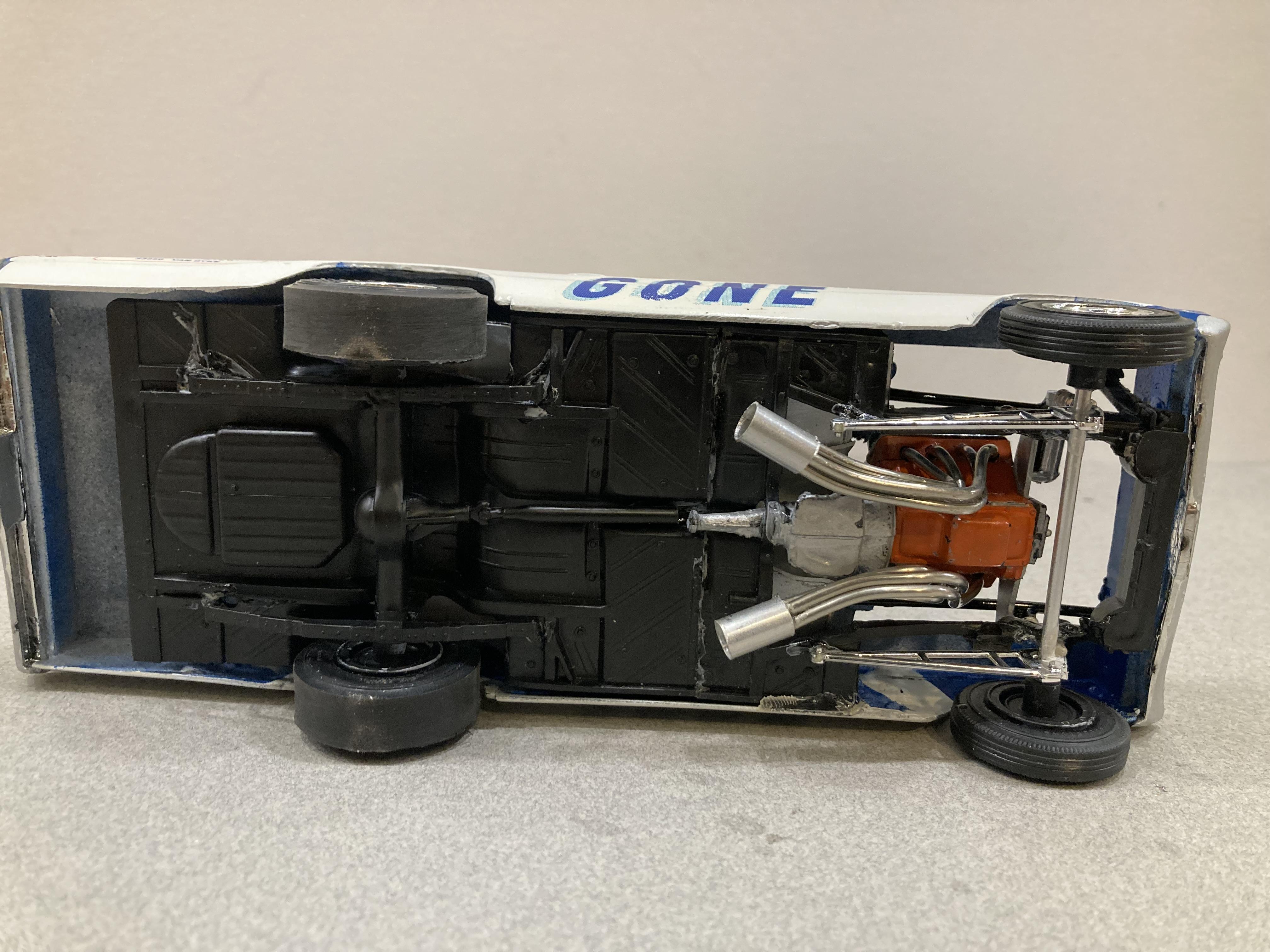

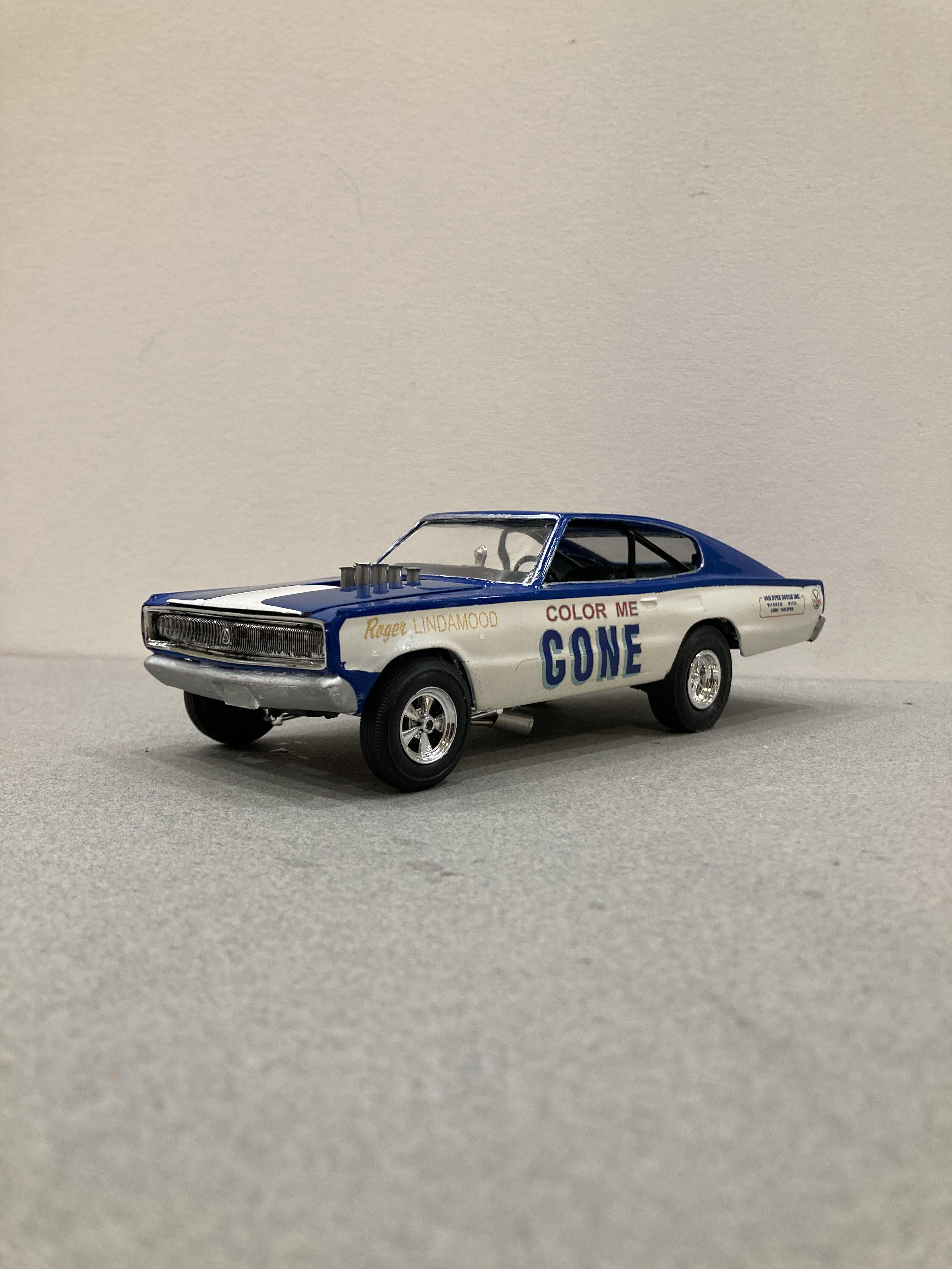

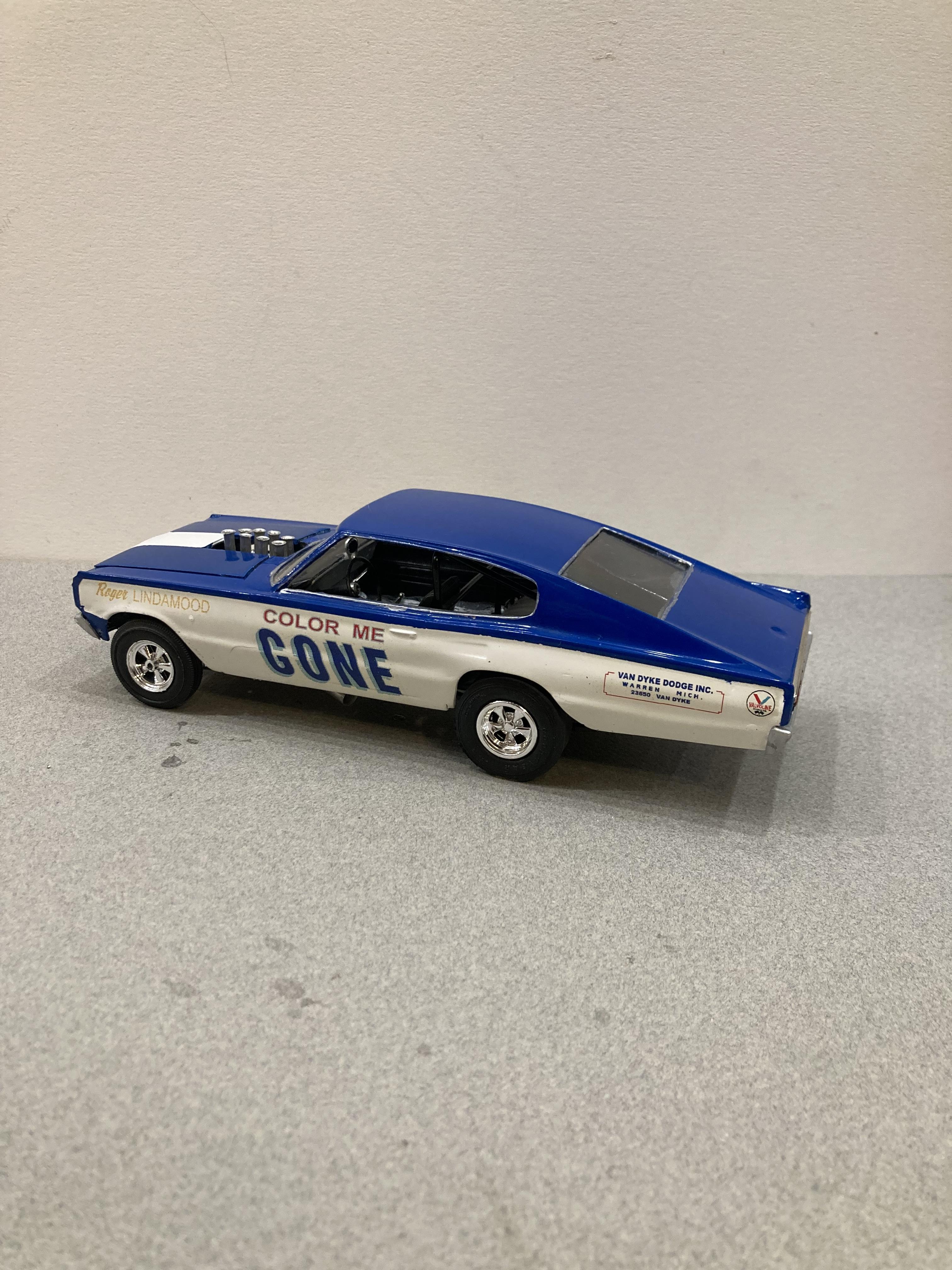

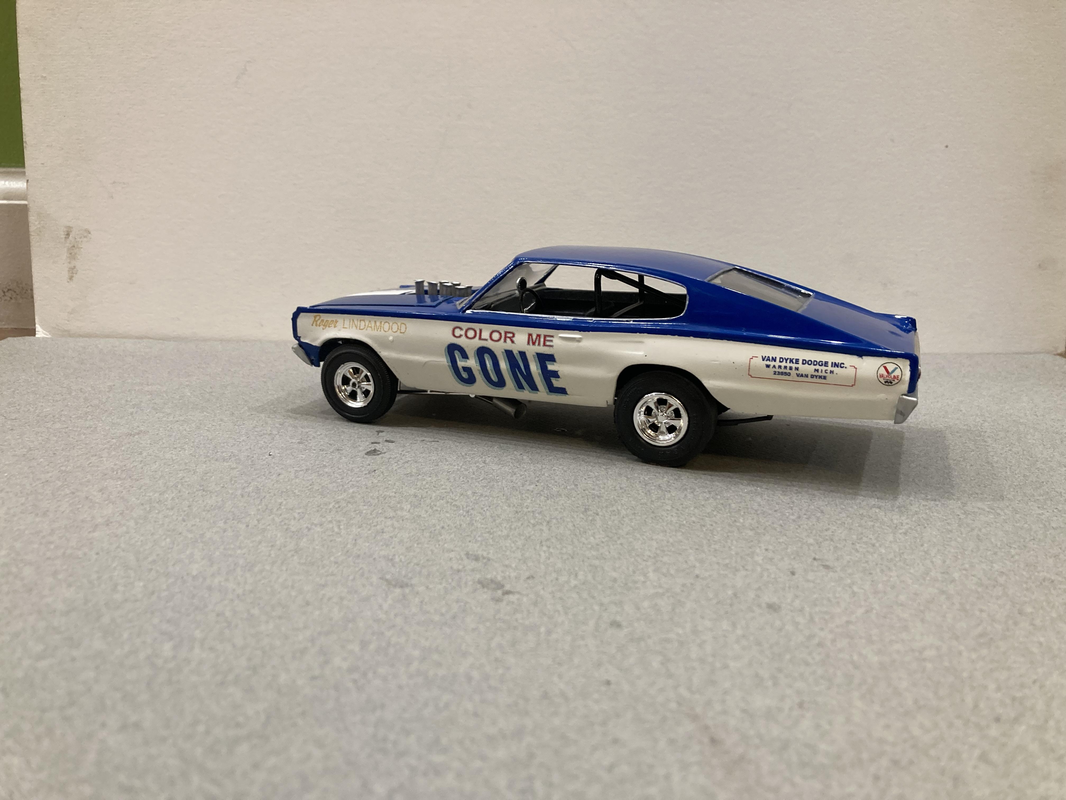

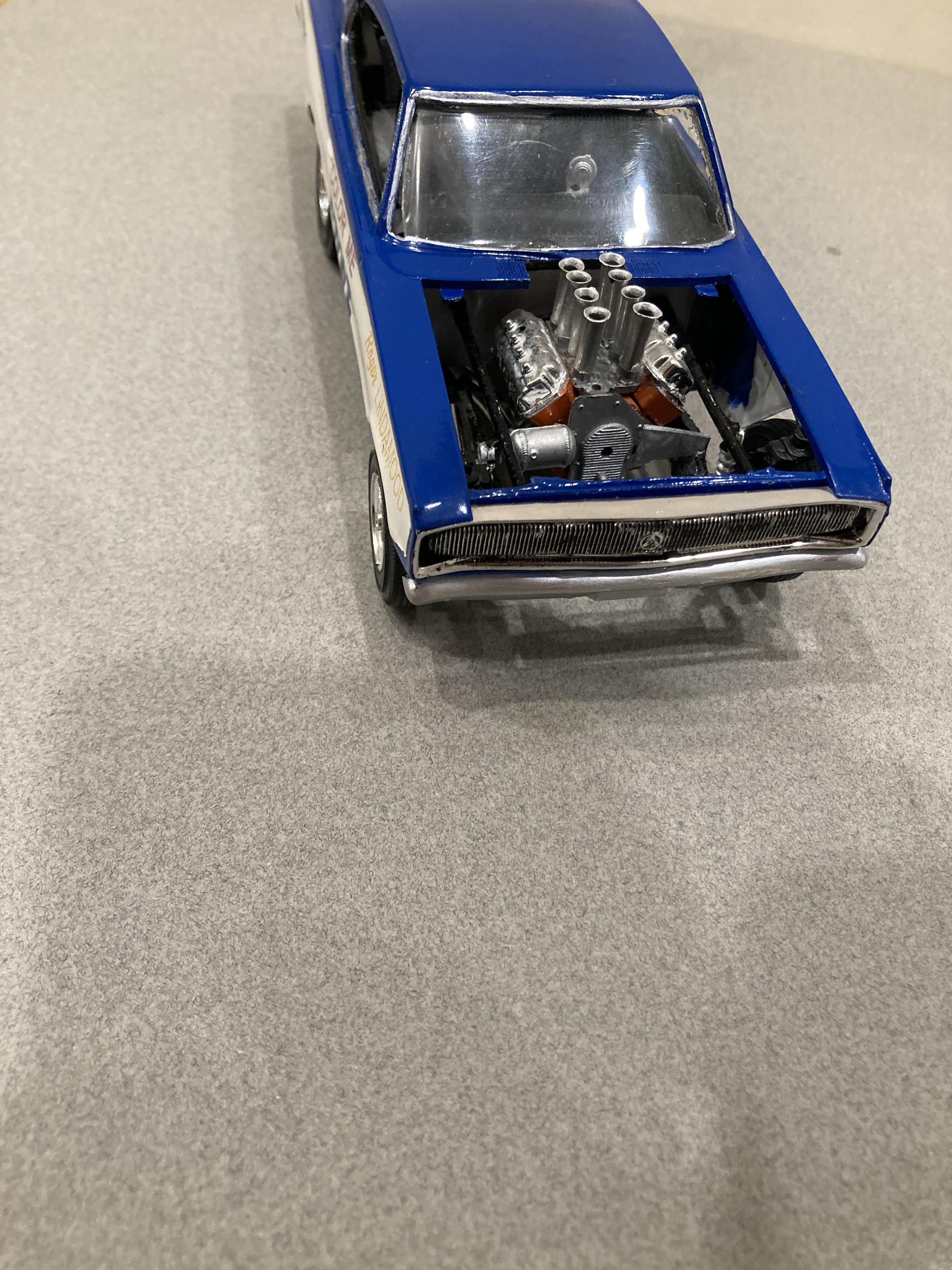

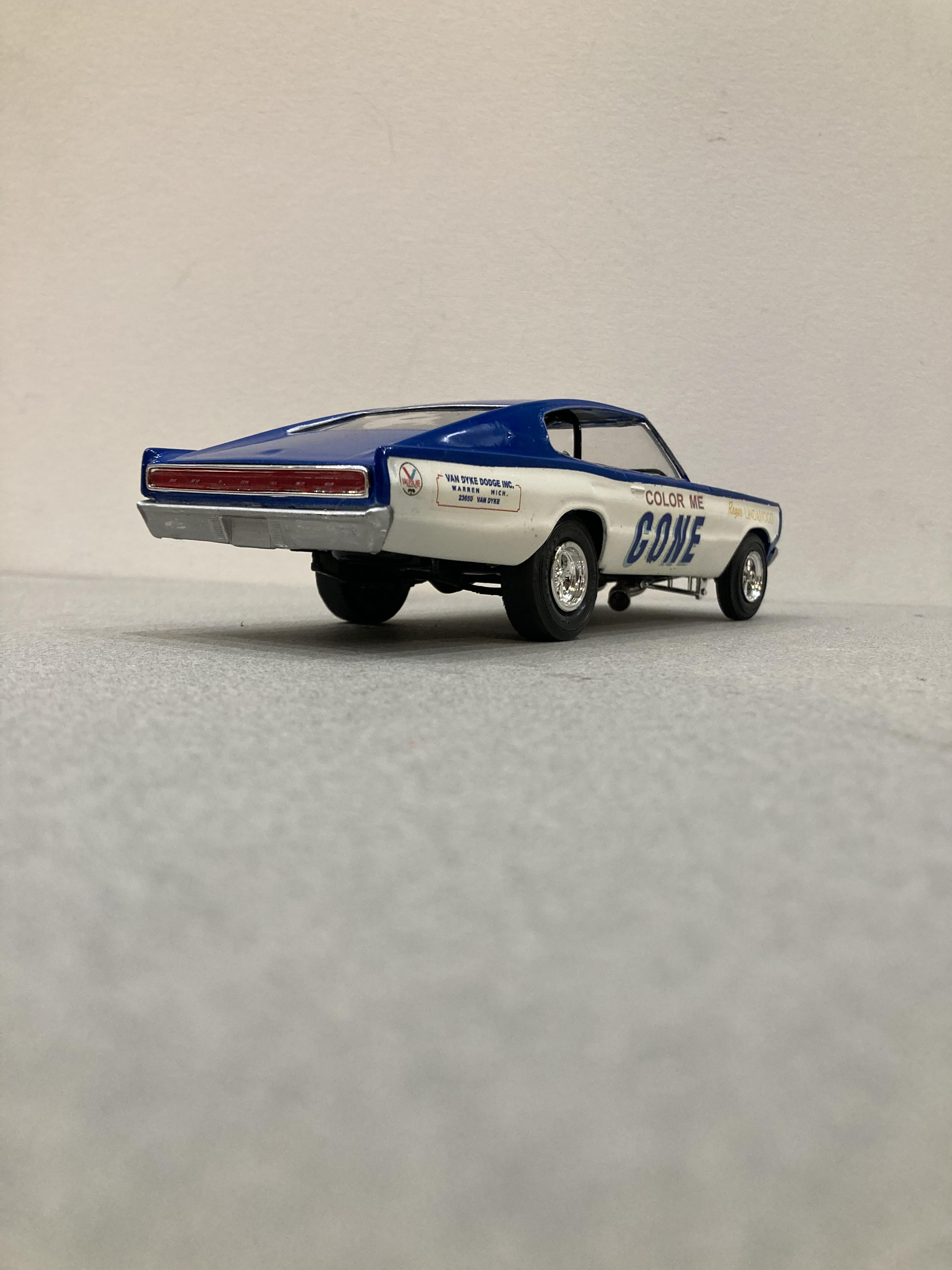

With the good word that the kit I used to create this is coming back out soon . It’s a great kit to make some AWB match race funny cars out of . I’ve built 3 so far from it , and I hope this build will inspire others, and sell some kits . As for this build I moved the front and rear wheels forward, built a front straight axle assembly, pieced together a injected hemi with a combo of kit parts a manifold from the spare parts box , and some homemade injector stacks , and custom headers . As for the crager wheels the rears are AMT the fronts are polar lights.I covered it with testors enamel. The interior took a lot of slicing and dicing I basically cut out  the rear seat and whole floor pan and made a new one from sheet styrene. Styrene rod was used for the roll bar .Unfortunately the decals are from an unknown source however I think Slixx made a set that will get you close enough if you can find a set .I’m really pleased with how this one came out .  Until next time thanks for looking , MikeIMG_4788.jpeg.02dd27d9d92378c14a947c5f6abac165.jpegIMG_4783.jpeg.52904c8bc30f723e2d746ae14384f259.jpegIMG_4785.jpeg.bc7578c7999061b6b809512de31ca91d.jpegIMG_4789.jpeg.1555ad8c48ac250ba1ab6b880b165bb4.jpegIMG_4790.jpeg.a93110b0782ca3dbc8983ec85ed43dbd.jpegIMG_4787.jpeg.97bb76407c954287079576378d2f9936.jpegIMG_4786.jpeg.6b40b512ca2375dddcfc2f791473a1a9.jpeg
