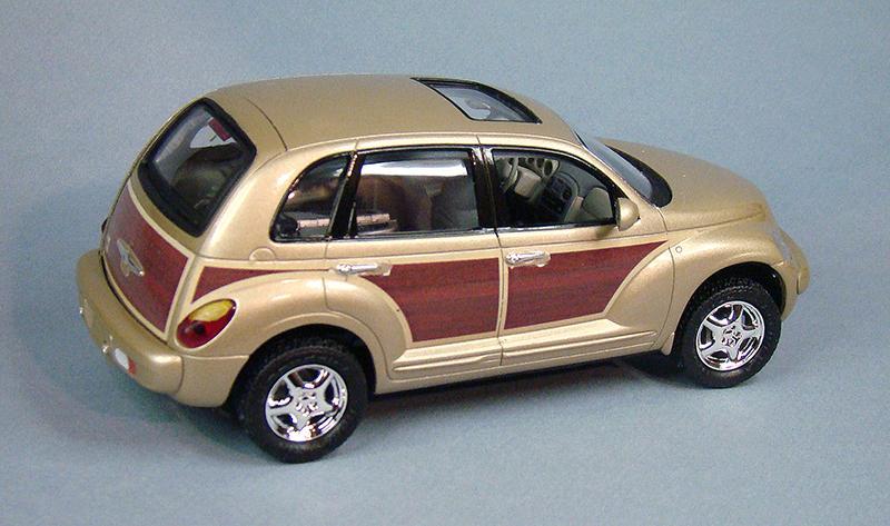

Many parts of snap kits don't really "snap" to a tidy fit. Many parts are just friction held, meaning you press the parts firmly and they sort of stay there. I don't think many kids being introduced to snappers have such high expectations that they are turned away from the hobby if they don't experience perfection.
I don't recall much angst when building mine. I'm sure there were imperfections but nothing I recall being deal breakers. Of course, this one didn't sit on the kit chassis either, it's rolling on Revell Audi R8 running gear with its V-10 in the back as an ultimate sleeper.
LeftRearUp_.jpg.598d4ce77c4bb554399d67fa99a04769.jpg.ec6aba305a6d649074c32528e32d91c6.jpg
