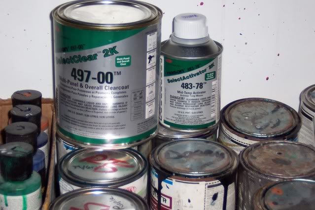

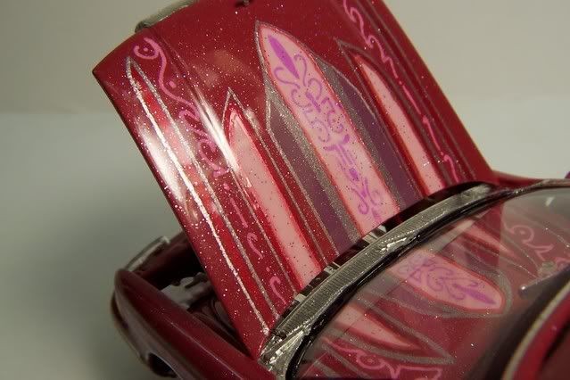

David@MinidreamsInc. Posted March 11, 2011 Author Posted March 11, 2011 On 3/4/2011 at 5:51 AM, my80malibu said: That was just Crazy cool. Are you using HOK paint? or what brand is it? my whole problem with automotive paint is trying to find one that is easy to use. I use all automotive colors like PPG , Duppont, Matrix, and American Finishes as well as the real Val Spar HOK. Plus all i use is real 3 part clears from Nason as it works great for scale models and is WAY CHEAPER then PPG . I spary with a jamming gun or MINI cut in gun and air brushes so on my colors i mix 1:1 with thinner instead of reducer so it doesn't dry as thick and flashes faster ! By doing it this way it will not leave the build up on the car as some have spoke about having problems with. I also only use auto body 3m masking tape. Its a bit pricey fellas but it cuts great and as you can see that if its applied correctly it has no bleeding. Now on the clear i use i use Nason Its a 4:1 but i mix mine 4:2:1 4 parts clear 2 parts med temp active 1 parts urathane reducer fast If you use Thinner in place of the reducer if will dull the clear down and you'll have to spend a ton of time cutting it and polishing to relive the luster of the clear ! Plus by doing it this way i can wet sand and polish if it needs it or start building my kit with in 6-8 after appling clear ! And like stated above if you still feel that you edges are being felt you can wet sand it with 1500 and then reapply clear as needed but when using a mixed clear you get great build up and they also sell a style called HI SOILDS but its a tad costly but 2 coats vs 4 and your done ! I hope any of this post helps any one and thanks for your comments ! I leave you with another build !
