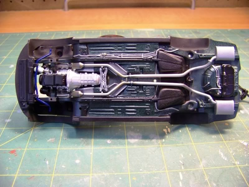

Albert Moore Posted June 7, 2009 Posted June 7, 2009 Hey All, This will be my second go around with the Revell series of 2005-2008 Mustang kits, this time using the 'Bullitt' edition; The motor has been finished in various shades of Testors Metalizer and non Metalizer shades (plus semi-gloss black for the oil pan and pulleys). And now the start of the chassis. The chassis was painted primer gray first, and the body color misted from the sides to simulate the over-spray from the painting process; The engine, radiator, and exhaust system has been added to the chassis pan and the detail painting completed. All painting was done with Model Master enamels (except for the exhaust heat effects, those were done with Tamiya clears);
Albert Moore Posted June 7, 2009 Author Posted June 7, 2009 One item I am deviating from in regards to a stock build is the addition of the quarter window louvers. The real '08 Bullitt doesn't have them, though the 1968 Mustang used in the movie did. The louvers came from a 1966 Mustang kit and required some modification in order to fit the '08 body (mainly shortened via sanding stick, and then styrene strip added to shim any gaps), And here's where we are at this point, modification of the suspension to lower her to a more acceptable stance. Here's how the mods were done. First the rear suspension. A simple operation compared to the front suspension modifications; Not pictured are the rear shocks. They need to be shortened a bit as well. Now the front end mods. As you can see it is a bit more involved. The chassis pan and inner fender mods; The front axle mods next; And how she sits now. BTW, these are not the wheels that are going on this build, I'm just using these for mock-up purposes. Thanks for looking! Cheers, Albert

Albert Moore Posted June 17, 2009 Author Posted June 17, 2009 Dave, Thanks on the info in regards to the fuel tank. I took some under side photos of an '10 Mustang at the local dealer (one of the salesmen looked rather befuddled as to what I was doing) and the tank was black on that one (or at least the shield/cover was ) . Ford did do a good job in making the new Bullitt nondescript that's for sure. Some updated photos of the interior. I wasn't happy with just a black painted floor so out came the Ken's Fuzzi Fur black and gray flocking. This is the second time I've used it and just love the look of it; The completed dashboard; And the completed interior/undercarriage assembly (er, still have to add the upper radiator hose and master cylinder); Cheers, Alby

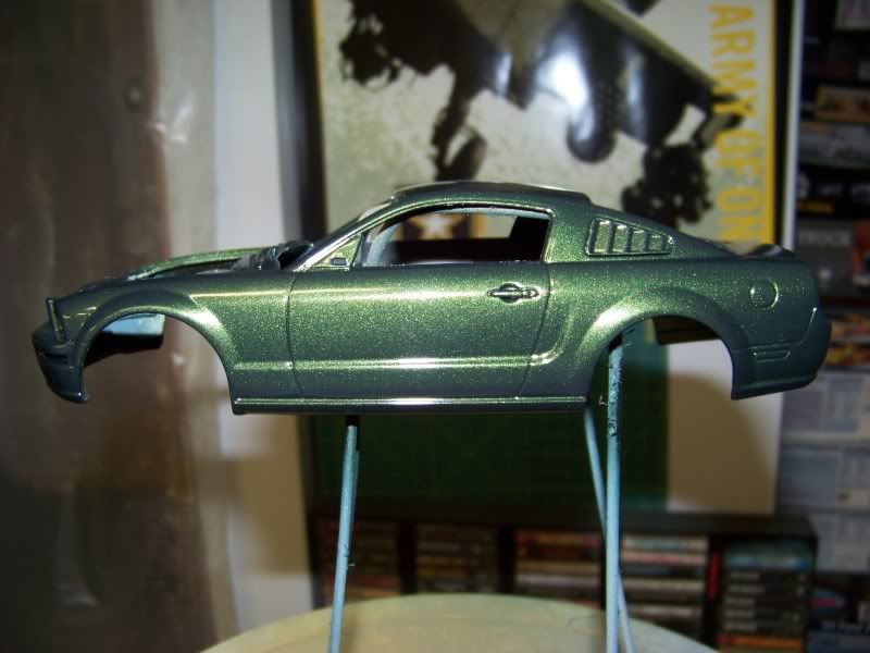

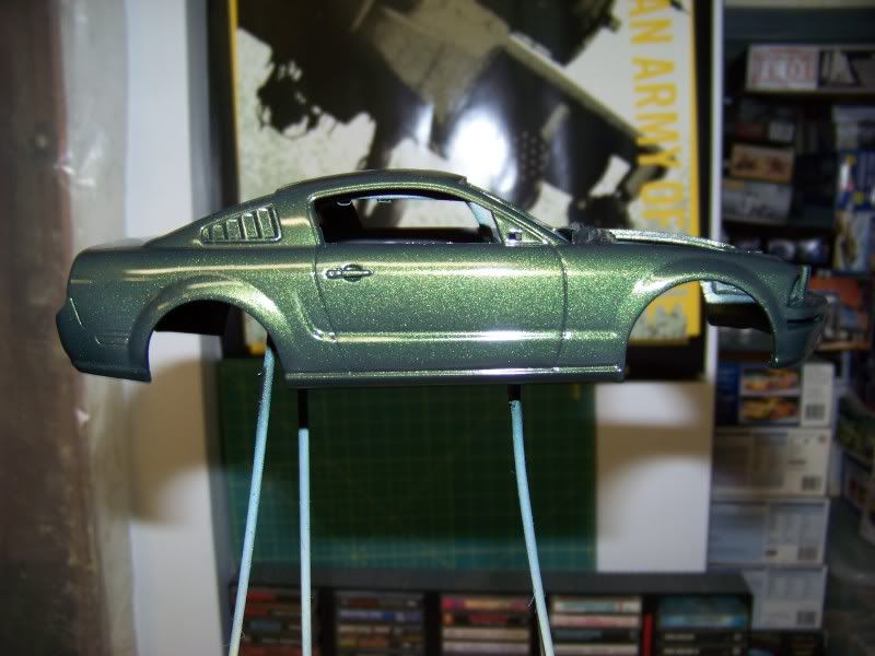

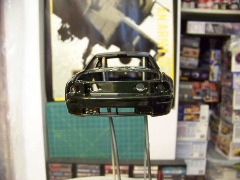

Albert Moore Posted July 30, 2009 Author Posted July 30, 2009 (edited) Finally! I have a painted body. Actually this is the second time I've painted this body. The first go around didn't go so great and the color was fifty shades too dark. So into the CSC tank it went. After the paint was stripped, I redid the trunk bodywork (redrilled the holes out and filled them in with styrene rod) and applied several coats of Dupli-Color primer/sealer. The body was wet sanded to smooth the primer, rinsed, and set aside to dry. Next came nine coats of Model Master British Green Metallic. I know this isn't quite correct but it's what I had on hand so it'll have to do. A couple of pics with the flash on; Now she'll sit for 10 days to let the paint cure completely. After that I'll buff out the paint and add a few clear coat to make the paint really sparkle. Thanks as always for looking. Cheers, Alby Edited July 30, 2009 by Albert Moore
