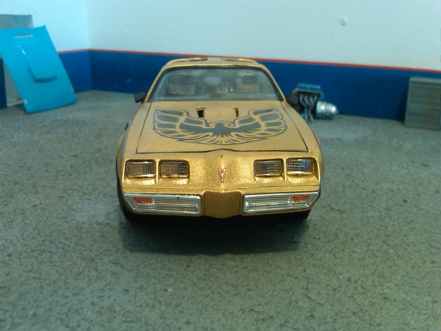

Here's my '73 T/A I built. I need to do a photo shoot as I do not have finished pics of this one.
I built mine with a phantom Canadian SD 455 motor (big block Chevy with Pontiac rocker covers).
Not factory stock, but hopefully will provide more inspiration and incentive to continue with that unbuildable kit.

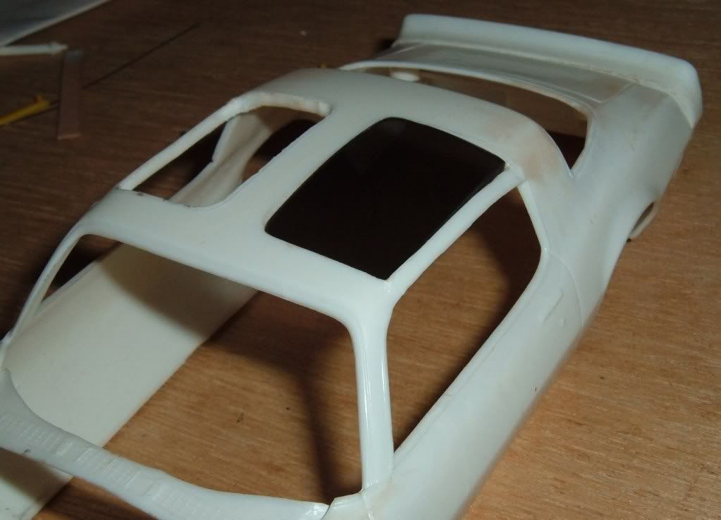

Was trying something different with the T-tops- found an old pair of cheap sunglasses lying around and cut out a panel where the curvature seemed similar- not 100% fitted but may end up working. Might also pick up another pair with mirrored lenses at the dollar store for experimentation
