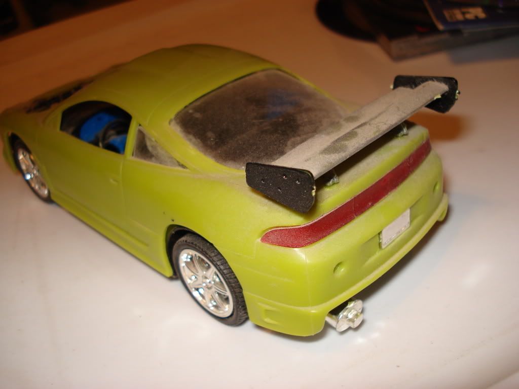

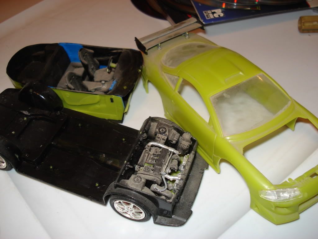

Railfreak78 Posted February 8, 2010 Posted February 8, 2010 (edited) If you are still accepting I'd like to get in with something. A mid 90's Eclipse. Of course its a glue bomb so It's gotta go in the purple pond. Let me know Edited February 8, 2010 by Railfreak78

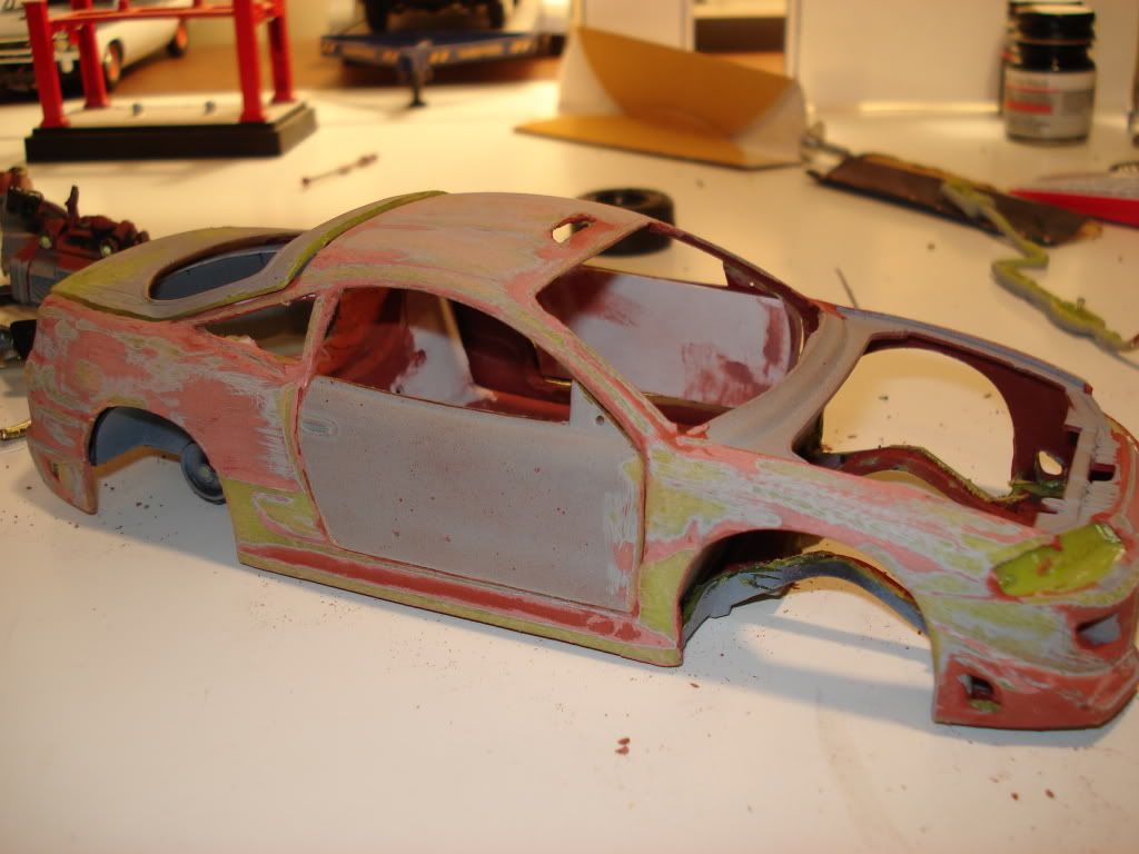

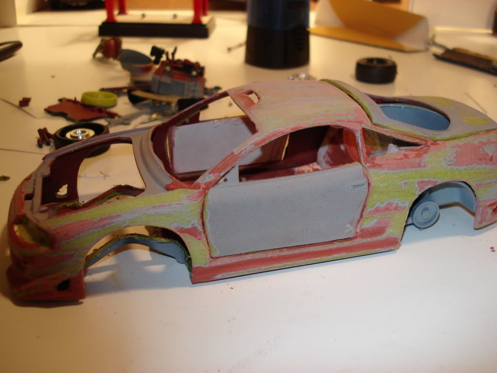

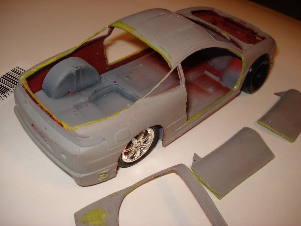

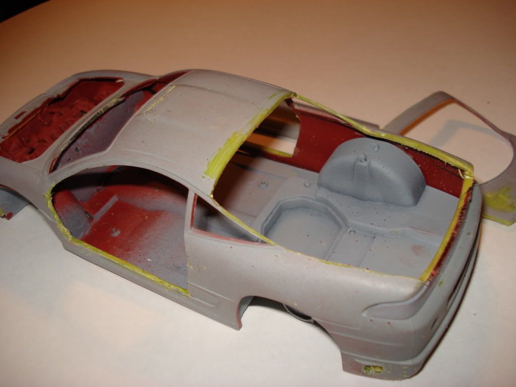

Railfreak78 Posted February 13, 2010 Posted February 13, 2010 Ok guys so after a swim in the purple pond that did it no good due to the amount of glue on this car ( I got it free though). I have primered and started the body work. This is the first time I have "opened" a model kit. I have never done doors let alone that hatch. I also opened the wheel wells a bit and started the roof scoop. Thanks for looking.

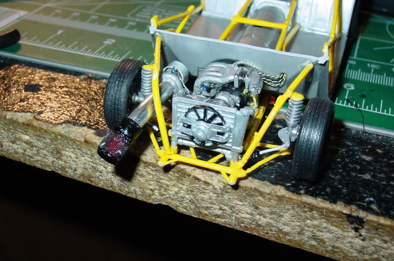

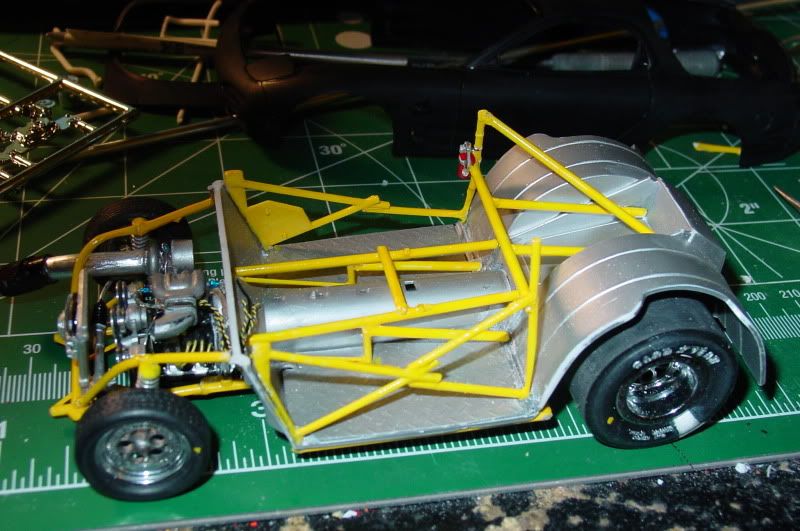

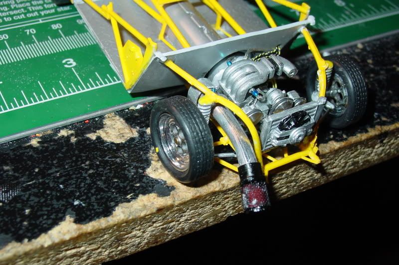

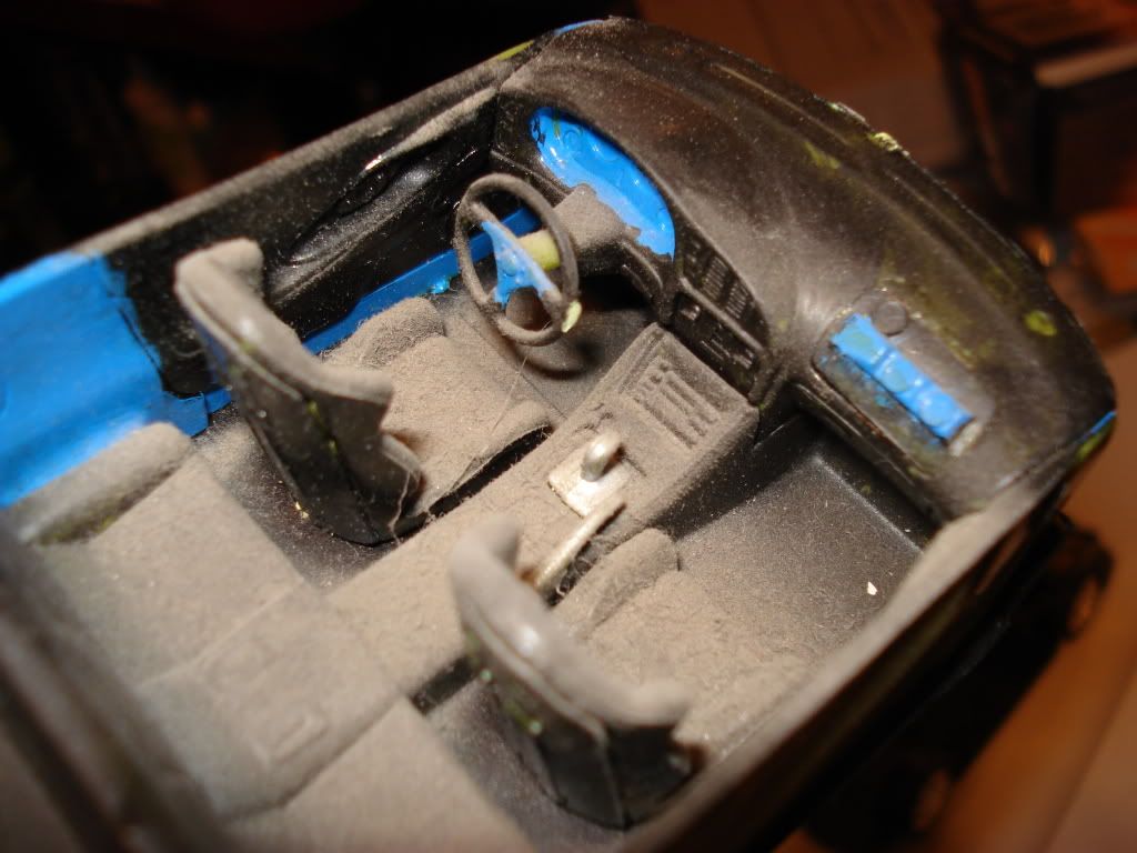

wgflatliner Posted February 15, 2010 Posted February 15, 2010 (edited) here's my update. interior mock-up here's what i've done: i used K&S aluminum tube and rod to bend the intake tube at the correct angle so it would be under the hood but near two of the air inlets from the front bumper. To make the filter, i grabbed a spare inner wheel piece, trimmed the "wheel" away and kept the center part that you'd put the axle in. I then hollowed out the inner part of the center part so it would slide over the end of the aluminum tube. i also found that one of the parts trees had a large knob thing on it that's simply used for ejecting the mold. I trimmed that down, then used my #11 blade and scored in some lines around the outer part of the filter to simulate the ridges of a K&N cone filter. I then painted it red and glued on some black mesh from a Tamiya kit to simulate the screen for the filter. The end result of the filter is it looks like a cone filter that simply slides over the intake tube. As far as the intake tube, in most cases performance builders use aluminum pipe for weight savings as opposed to steel. it was starting to look a little dull, and i thought that it was in need of polishing, so i used the back edge of the #11 blade and lightly scratched it along the length of the tube and got it evenly. it gives a nice shine! I did have to alter the front frame assembly a little to get everything to fit without clearance issues. Although the build is going slowly, it is getting done. does anybody have any detailed pictures on a complete nitrous setup? edit: i just cleaned up the glue on the filter screen - used tamiya smoke and a toothpick, then followed up with a quick dusting of dullcoat to give it the "used" look Edited February 15, 2010 by wgflatliner

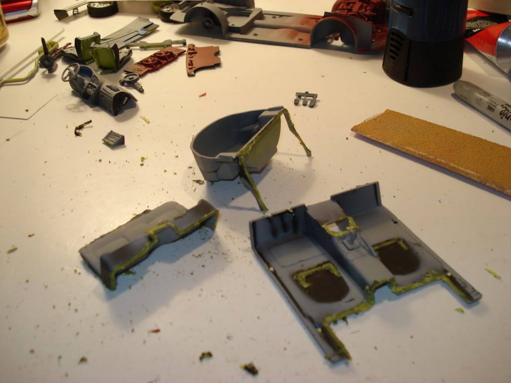

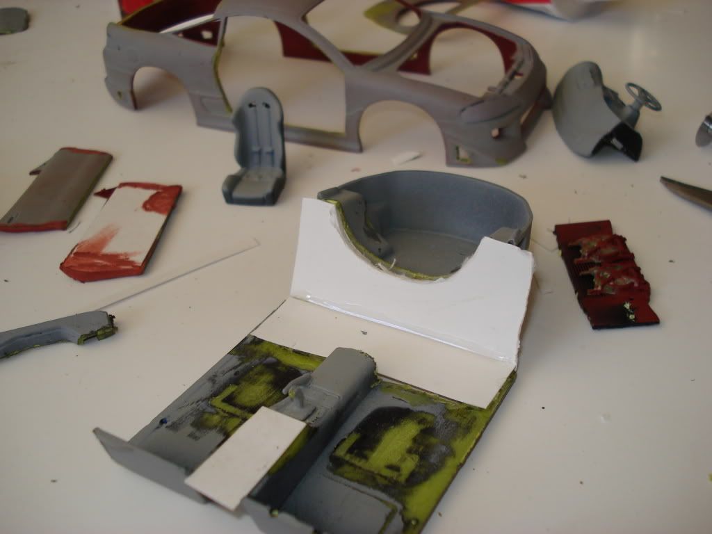

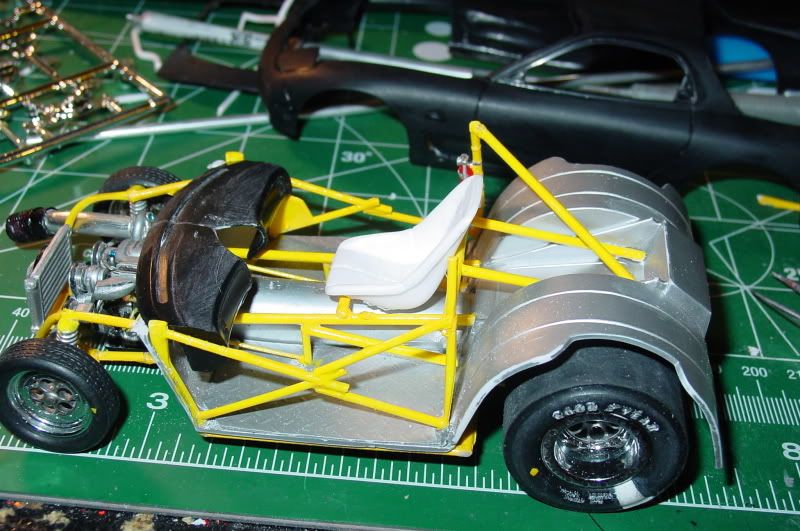

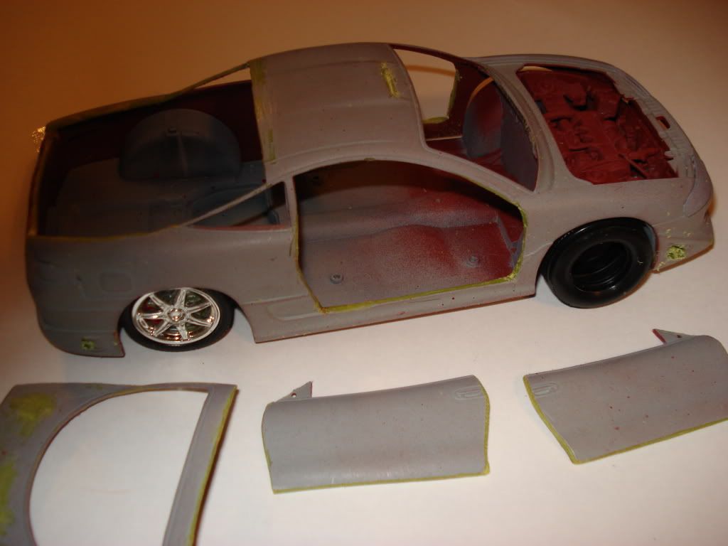

Railfreak78 Posted February 16, 2010 Posted February 16, 2010 Here is an update from me. I am still tearing this apart. I took out the rear seat which affected the way this goes together. I am making the car lighter, I got rid of the stereo and anything I can think of. I also killed off the normal stock fuel tank as I will re-locate a fuel cell. I still have a long way to go. Thanks for looking. Oh and guys there is some killer builds going on here Enjoy and Happy Hobby'n!

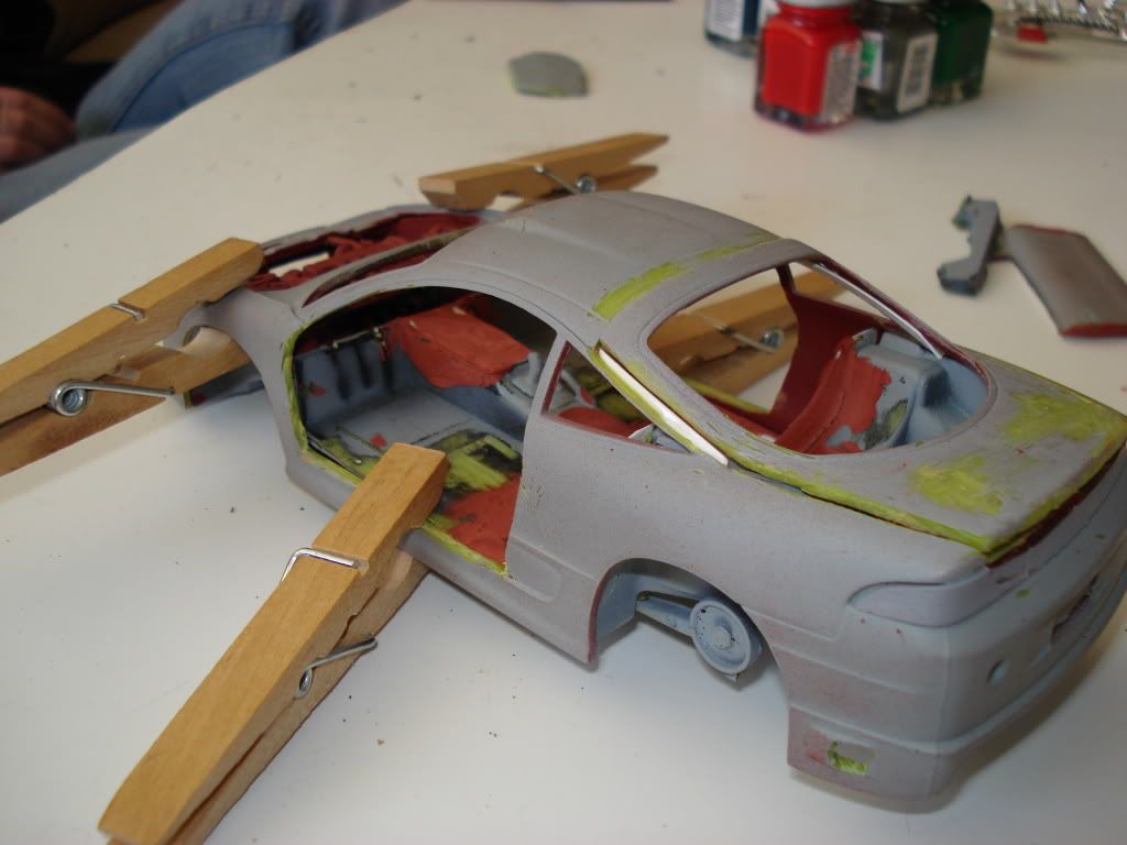

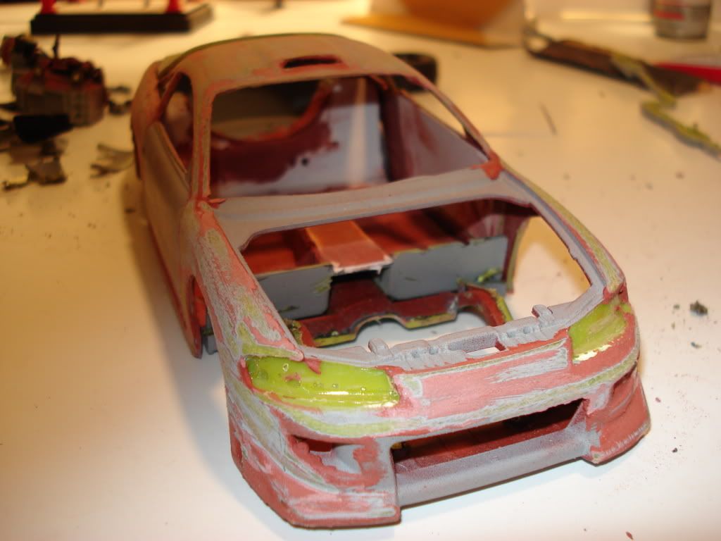

Railfreak78 Posted February 17, 2010 Posted February 17, 2010 Ok I was looking for some progress pics and realized I'm the last post person but oh well lol here is some pics after heavy body work and I am still not done But it is slowly getting there. I have to say that this is fun as (1) I have never opened a car before and (2) this is my 1st build in this nature. I hope everyone else is pluggin away and having fun as well.

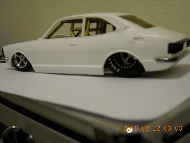

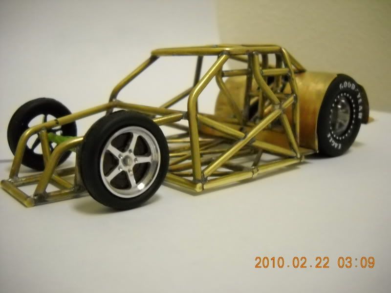

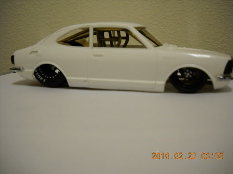

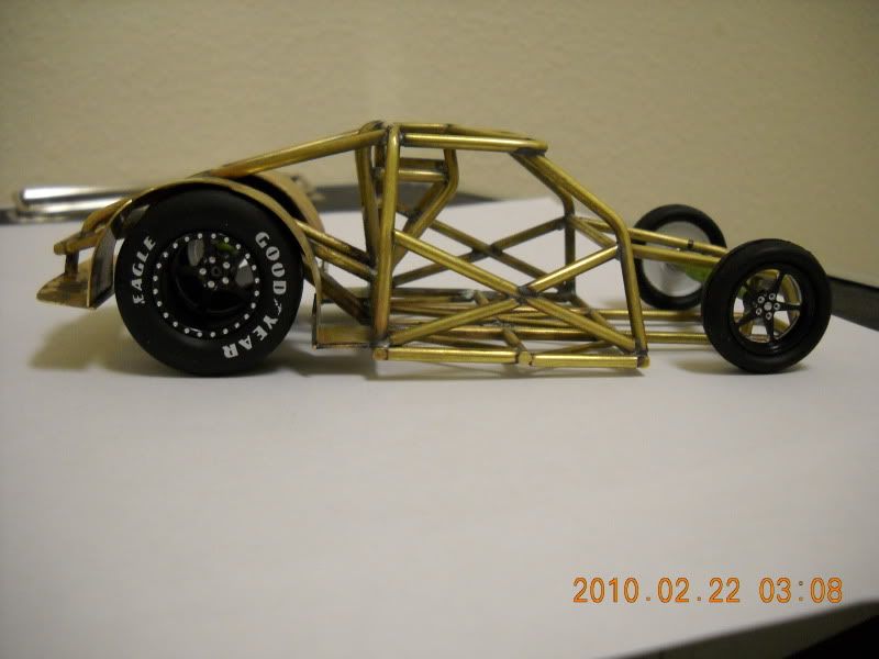

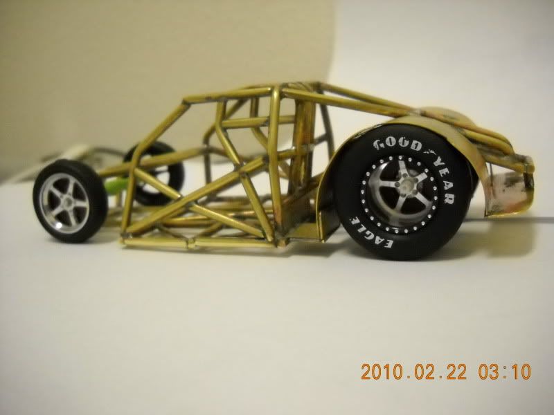

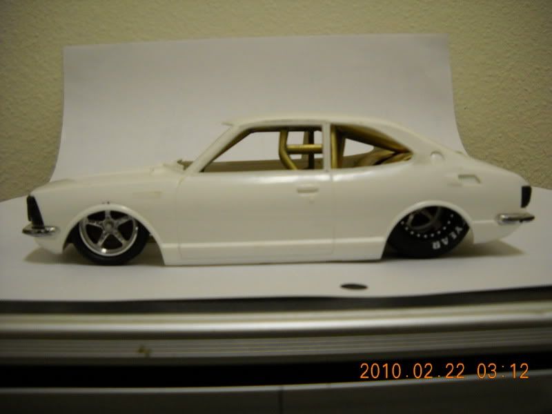

BKIN10SECS Posted February 22, 2010 Posted February 22, 2010 (edited) Hello everyone, just wanted to post some pics of my latest project since my green 510 (built it about 10 years ago) that was posted earlier in this topic. It is a 1970 Toyota Corolla, it is my first attempt of a full scratchbuilt brass tube chassis...not perfect by any means just my first attempt. Thanks ...let me know what you guys think Edited February 25, 2010 by BKIN10SECS

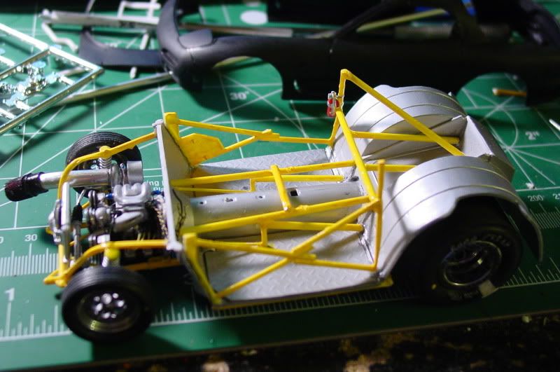

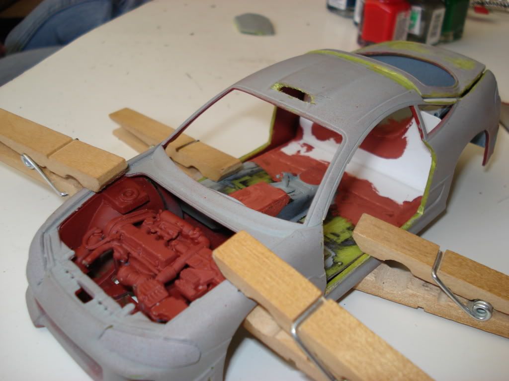

Railfreak78 Posted February 23, 2010 Posted February 23, 2010 That frame is crazy cool! Just an update from me I am working on this but find rollbars kinda frustrating with this roofline ugh. The work here is mind blowing guys

Mooneyzs Posted February 23, 2010 Posted February 23, 2010 On 2/22/2010 at 1:45 PM, BKIN10SECS said: Hello everyone, just wanted to post some pics of my latest project since my green 510 (built it about 10 years ago) that was posted earlier in this topic. It is a 1970 Toyota Corolla, it is my first attempt of a full scratchbuilt brass tube chassis...not perfect by any means just my first attempt. Thanks ...let me know what you guys think Looking good so far. Very nice work. Can't wait to see more of this build
BKIN10SECS Posted February 23, 2010 Posted February 23, 2010 Thanks for the comments, the chassis is still pretty rough, need to clean her up. I am currently machining the shocks. I am really sort of a curbside builder but this is going to be my first serious attempt at a super detailed (for me anyways) build. Still haven't decieded on an engine, it will be turbo of course either Skyline or 13b. After seeing Shuckys 13b I am swaying towards that motor, you did an awsome job on that motor bro!!! (and size wise will work better). The rims are slot car rims...Pro-Track, if you go to Ebay or if you have a slot car track in your area that carries accessories you will find them. They are the perfect size for the small imports. Thanks again

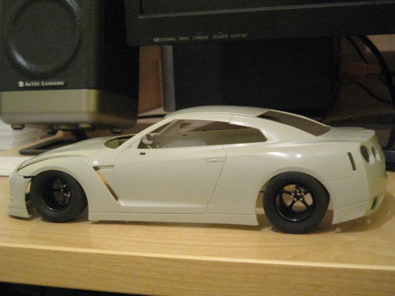

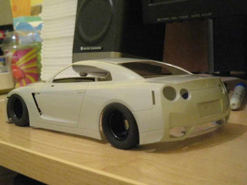

shucky Posted February 24, 2010 Posted February 24, 2010 Jay what front tires are you using with the Pro Track fronts? Everything looking great, keep up the good work! The only pics I have so far are just teasers of my GTR, more to come soon! Promise
BKIN10SECS Posted February 24, 2010 Posted February 24, 2010 Hey Mike....the front and rear tires were given to me by my good buddy Dirk Joseph. The rears ....I'm not sure, the fronts I belive are Pegasus. Now it looks like you too have found the benefit of Pro Track rims . The black front rims I show in the pics....came with O rings, the silver ones had a wider lip which I turned down on the lathe and had the Pro Track foam tires. I removed the foam tires and then just took a little off the outside surface with the lathe to remove the glue and residue left by the foam tires. I like the route it seems that you are taking.... AWD drag monster maybe
