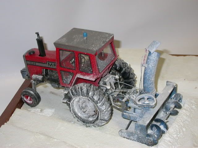

I made up a set of chains for my 1/25th scale Massey tractor. Tractor tires are a little easier to work with because of the added size. However the technique should be the same.
The chains are basicly layed out like a ladder. The trick is in the sizing. The rungs should be twist links, while the rails are straight links. I drew the patern out on a pine board then pinned the rail chains in place and attached the rung chains.
When the chains are installed the rail chain is about the center line of the side wall. Measure this radius, find the circumfrence and that is the length of the rail. the rung length is the distance from the rail chain up to the tread face + the tread face + the distance down to the other chain. All the chian links should be about 1.5 mm to be in scale.
I hope this explanation make sense to you folks
