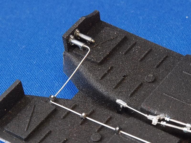

Before the new update, I have to give credit to my good friend Dave Morton who pointed me a misplace of the rear brake lines to the correct master cylinder. After had spent so much time looking the underside upside, I forgot what goes up and what goes down:tongue:
Here's the correct placement, thanks Dave!

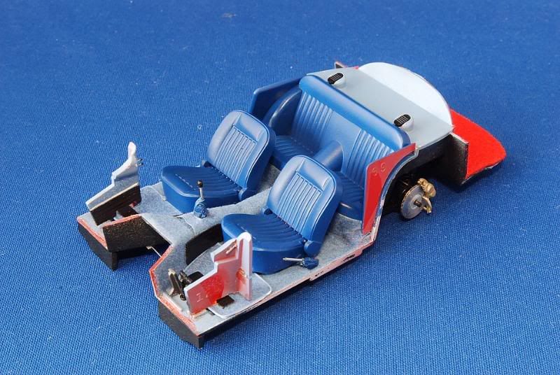

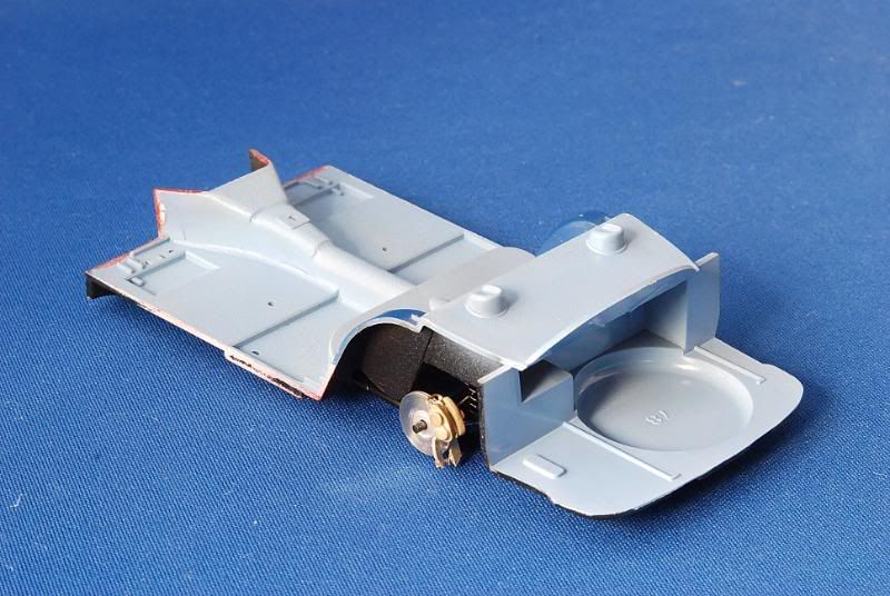

Ok, here I will go from the downside to the cockpit of the car. Like I said at the beginning, I won't follow the instructions order due to a modification I did to the body.

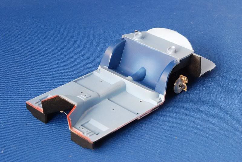

I started painting the two basic shades for the carpet and leather upholstery. Light blue for carpet, dark for the leather.

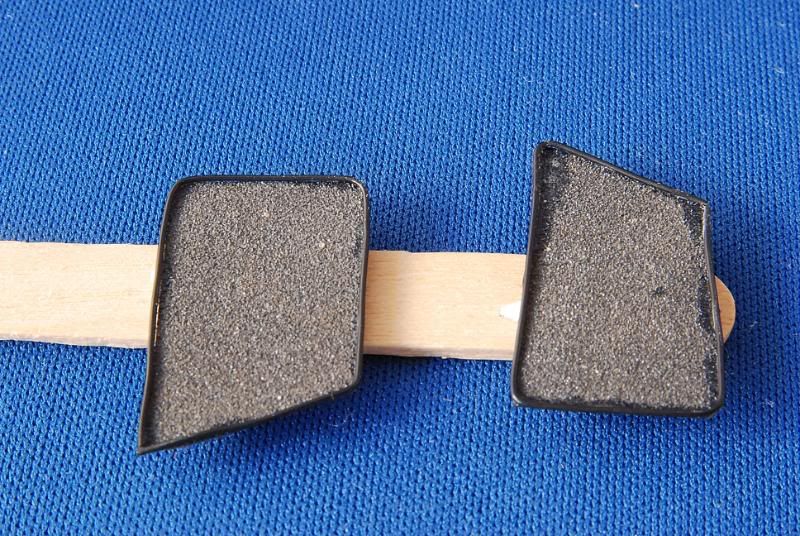

I did two simple floor carpets from sandpaper and wire to replicate the molding. Everything was treated with white primer in order to give a light shade of color for the base of the light blue that will be used as a base for the flocking.

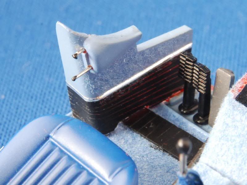

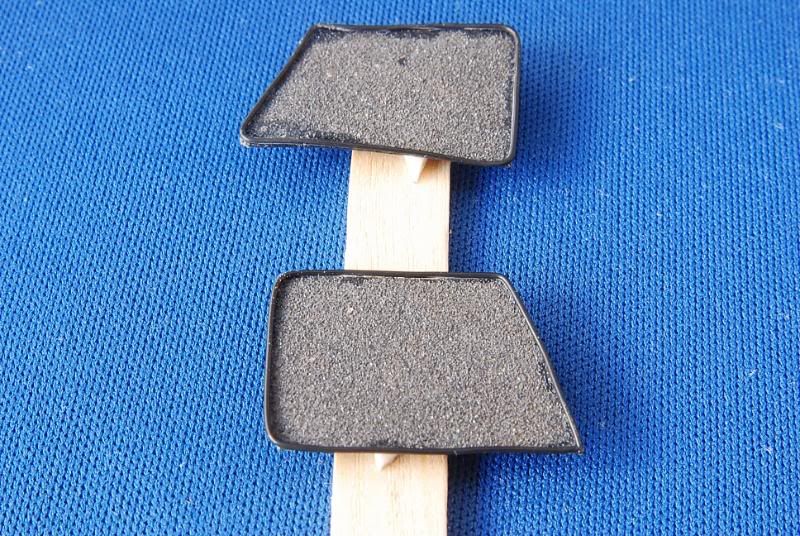

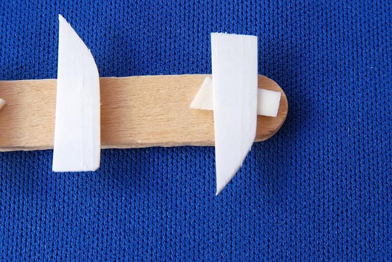

The protective carpet guard was made out of plastic sheet. I lightly scribed them in order to replicate the lined pattern on them
Same treatment for the carpet guards.

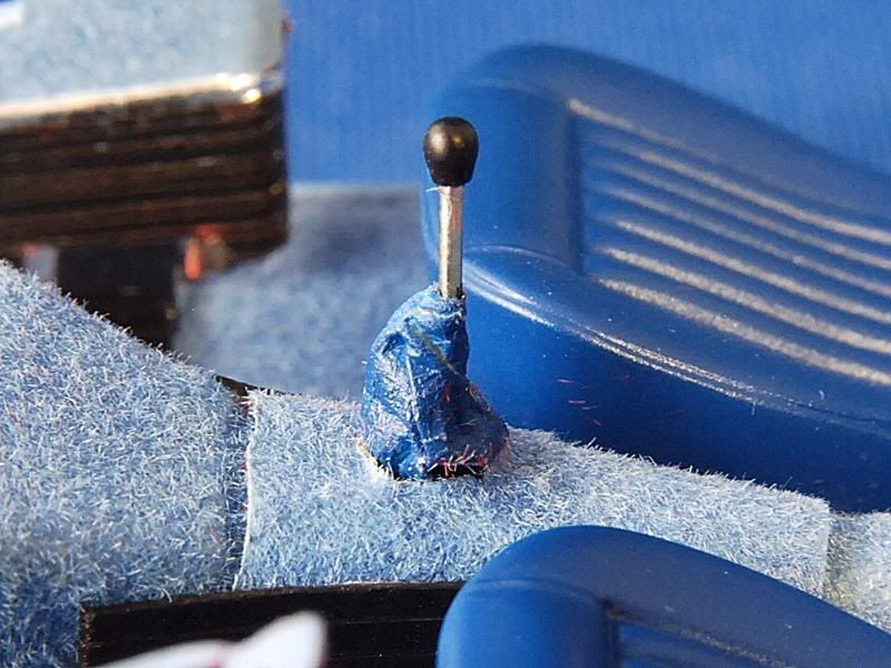

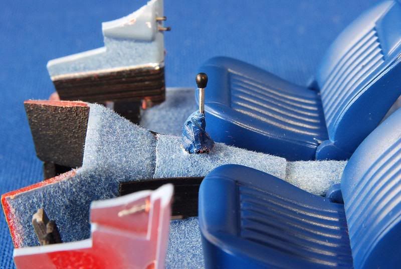

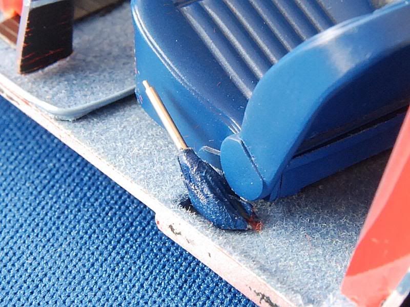

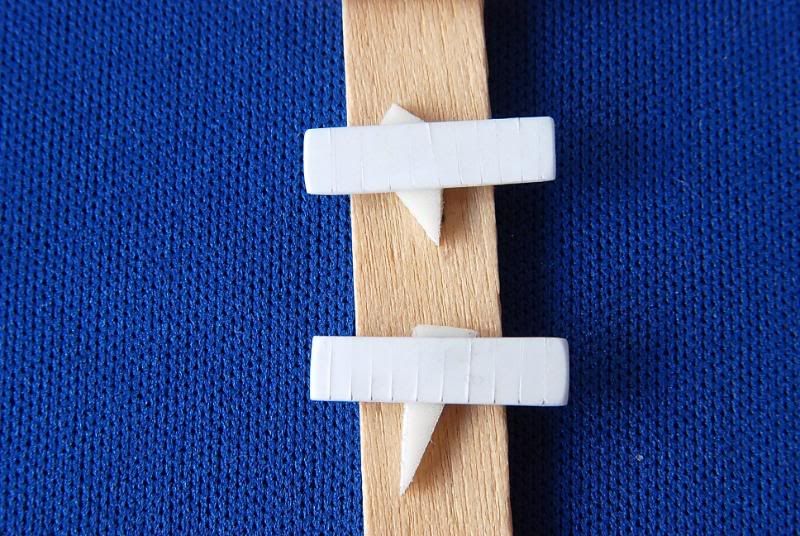

Masking tape was used to do the shift stick boot and the emergency brake level boots. The shift stick is a Sakatsu one that I altered its shape with my Dremel and the Emergency level with metal tubing.
The side floor panels also were treated with flocking and also were scribed in order to get the lined pattern. Vents controls were made out of thin wire and the knobs are white glue with semi gloss black paint.
General overview of the seats area.

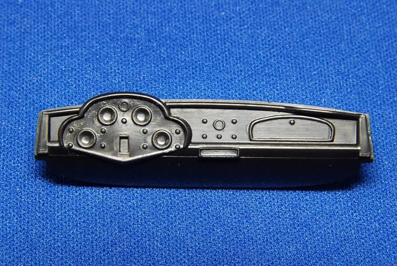

A last time view to the out of the box dash look.

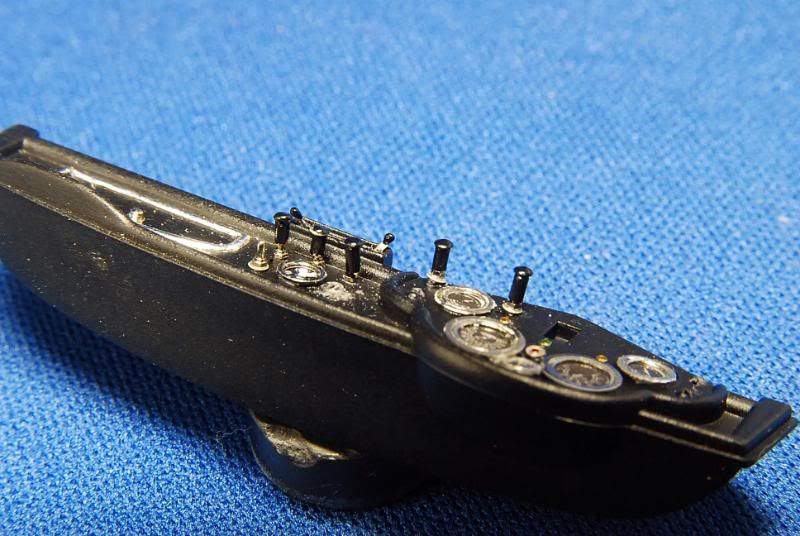

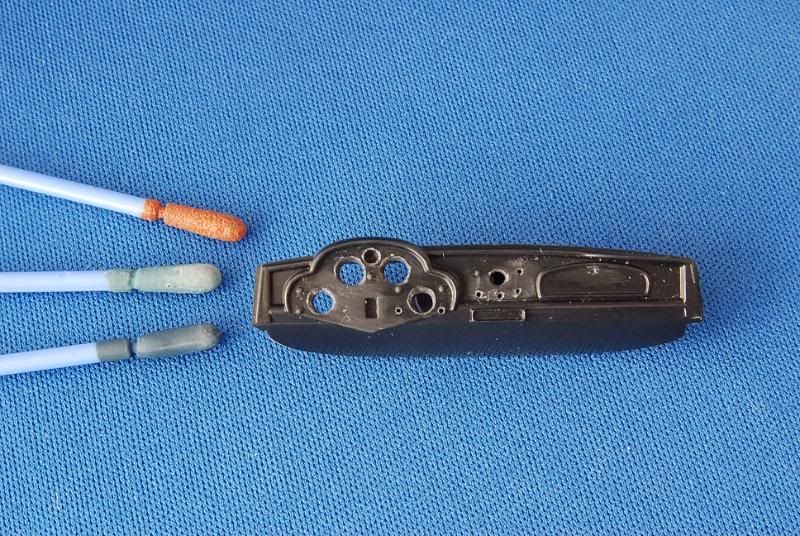

The Dremel and this tiny polishing swabs help me to open the enclosing for the gauges and toggle switches.
I chucked in my Dremel a Sakatsu toggle switch and re-shape it in order to make the glove box lock.

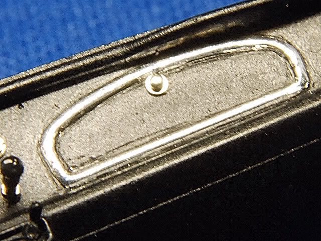

Some bare metal foil to the molding and this is how it looks now.

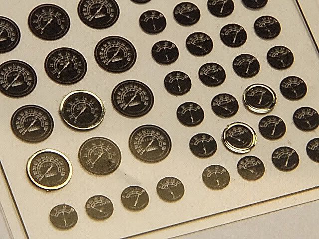

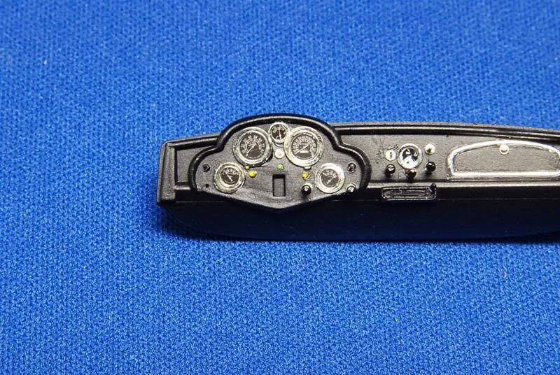

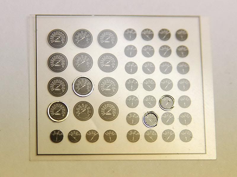

Model Car Garage black gauges faces and its bezels made the perfect combo for what I had in mind. In order to get the deep look of the bezels, I stocked them one over the other and have what I wanted.
Edited by simonr

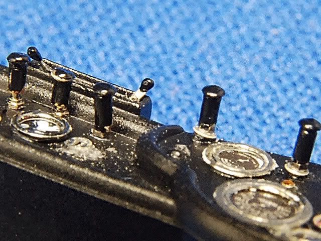

Toggle switches from Sakatsu, their knobs made out of metal tubing and photo etch washers and photo etch bolt heads made everything look real different. Here's how the final dash looks.

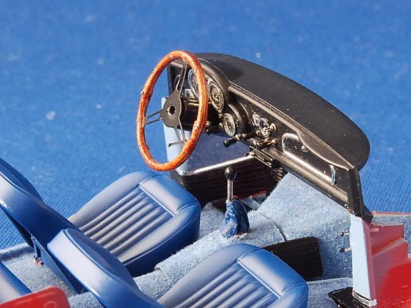

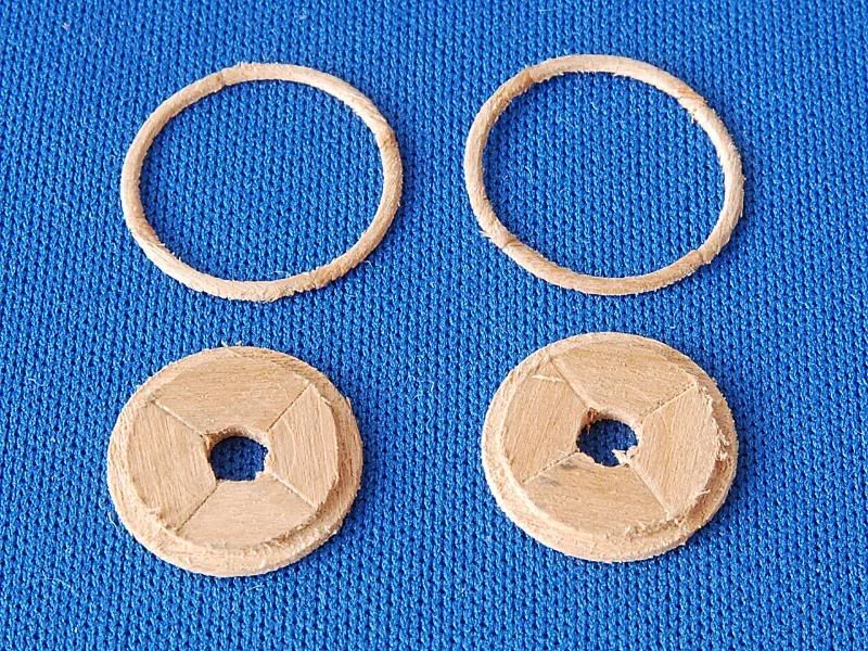

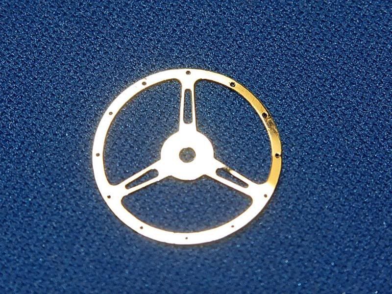

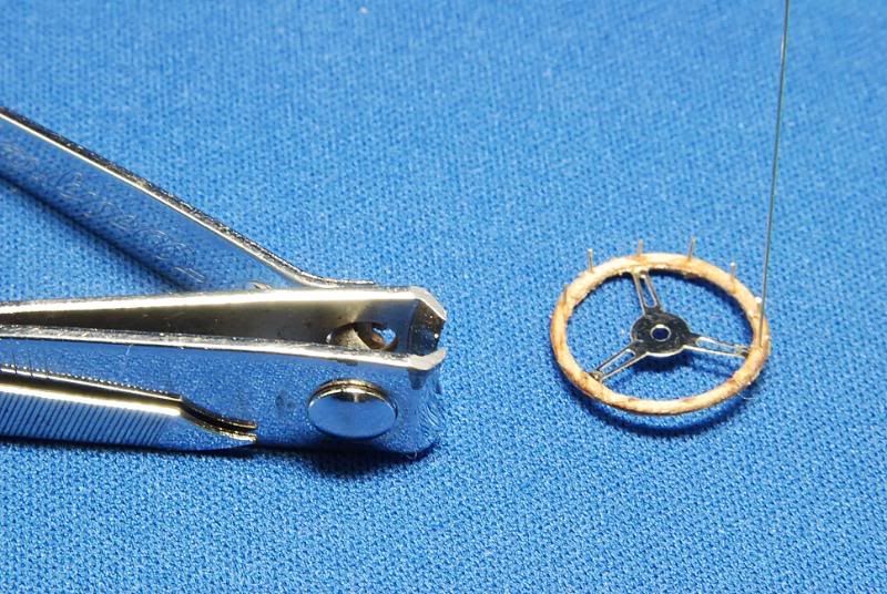

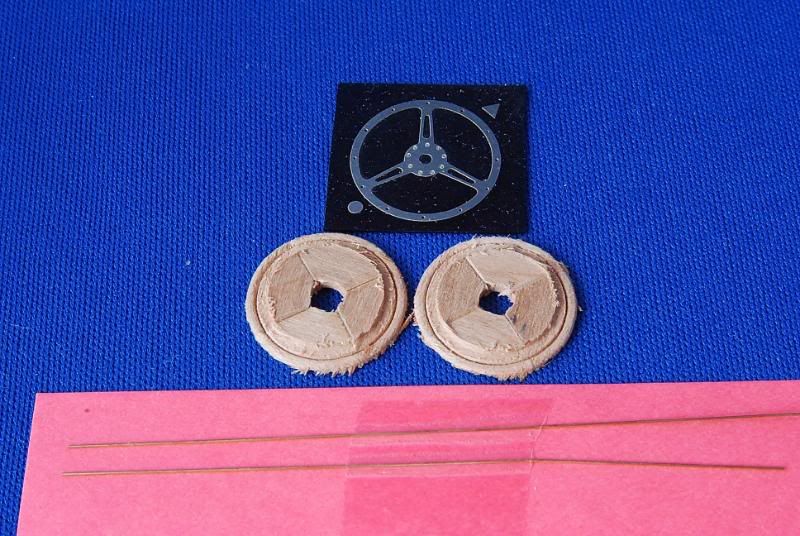

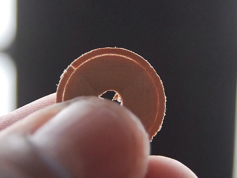

One of the main attractions of the cockpit is this correct great Derrington Steering wheel kit from Replica & Miniatures of Maryland. I thought to use a Renaissance Nardi one, but, it would be completely incorrect. It comes with the two real wood halves, the photo etch rim, and metal line to make the rivets.

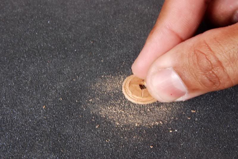

I started sanding it until I could see the light through the inner part of the wood halves.
Finally, the wooden parts for the steering wheel are off.
The rim was perfectly polished, but, I had to hold the temptation to leave as it is, because the correct factory stock look is covered by satin black paint.
After glue the halves, the metal lines are placed trough the rim and the wood. After that a nail cutter is used to give it a flush cut.
Uffff, after 4hours!!!...I finished the part. Next, masking and paint the center.

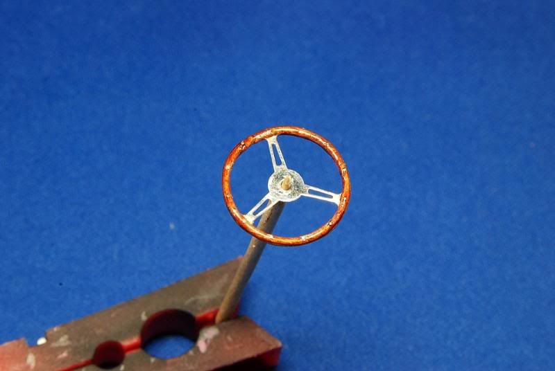

I take out some old cans of real wood paints and make some tries to see which color I would use. The upper right corner was the winner, after I painted it, I should use the upper center minwax one, but, it was already painted!:confused:
Final look:

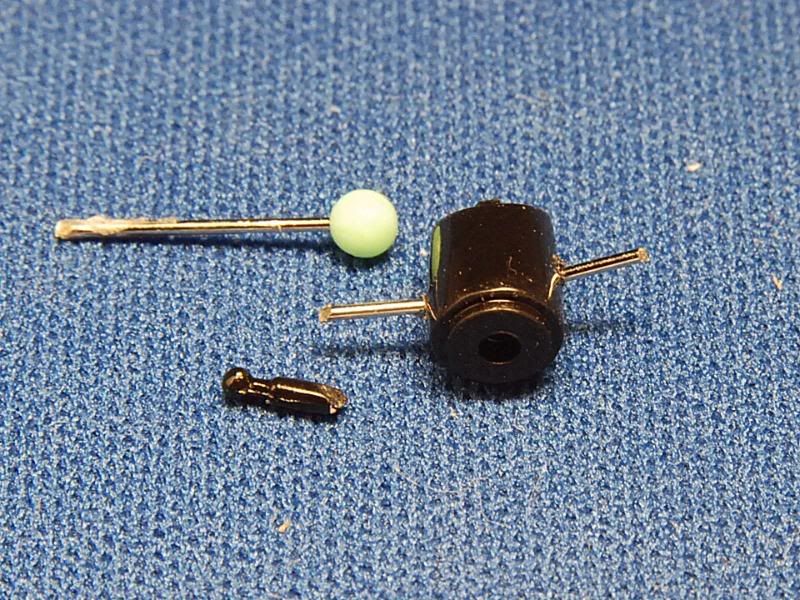

For a last alteration of the out of the box components, I cutted the turn signal switch and place instead a metal pin length. Again, with glue and satin black paint made the knob.

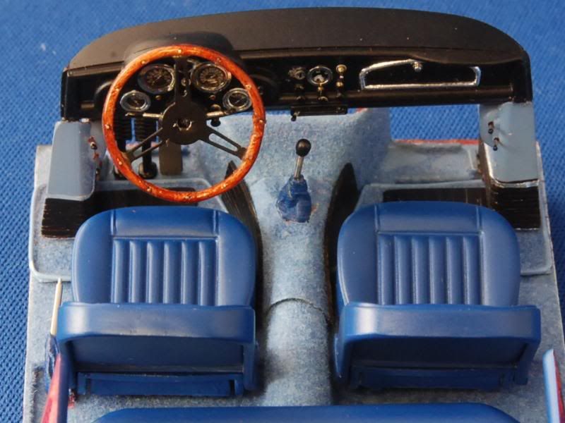

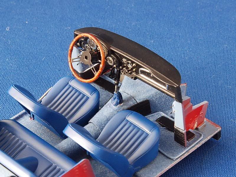

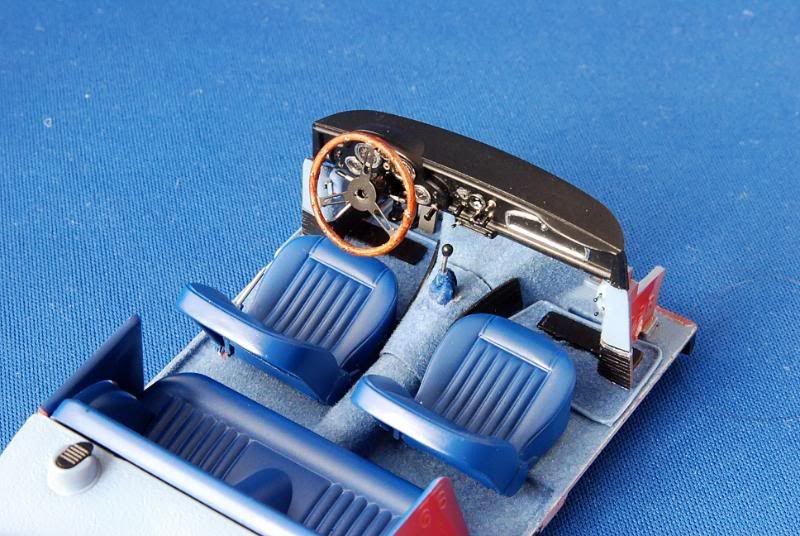

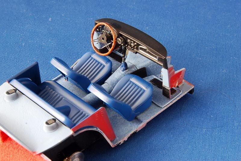

Finally, everything is together in place...
This is it....for now!
