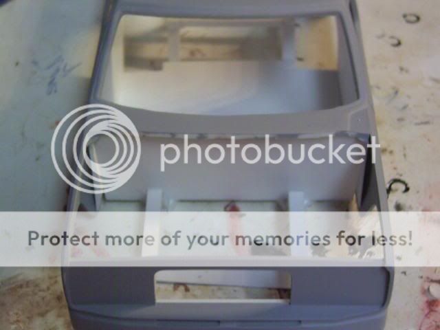

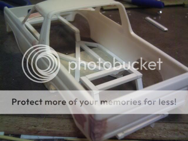

It's amt's 81 Bronco, I wanted the whole frame and suspension for a 4x4 mustang, and I have always wanted to do a truck like this.
Well I got the frame pretty much finished, but still have alot of work to do for the suspension. I desided to smooth the tail lights, door handles, gas cap, cowel, and the bumper mounts, but I still have to sand it. I also debadged it, and I am working on the airbags, more to come. :rolleyes:
still have alot of work, oh well!
oh and I still have to make a roll pan for the rear and the engine is going to be a mustang 5.0
I am going to work on scratch building the interior tommorrow
Thanks for looking.

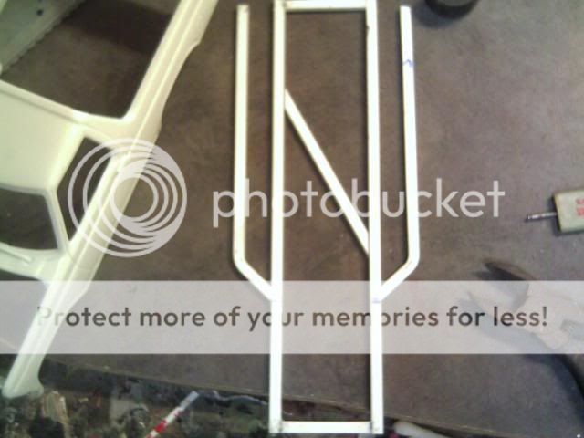

How did you do the bends?

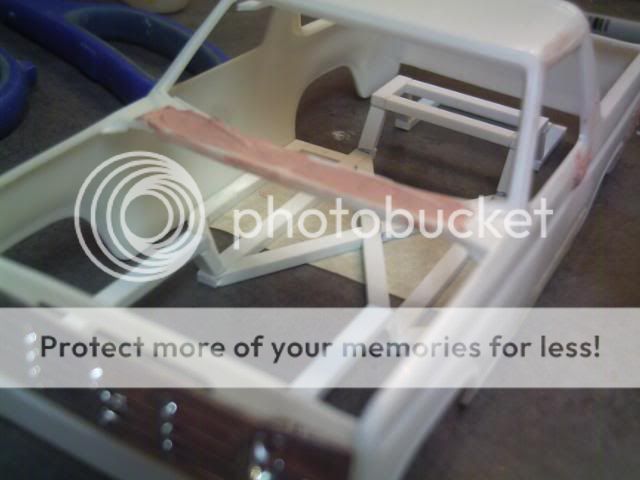

Well for the frame, there is no bends except for the two outer pieces that support the outer part of the floor are at like a 45 degree angle, I use a lighter or soder gun, heated it up just enough to bend em, got one perfect and then bent the second using the first as a template. As for the rest there all straight pieces just measured, cut, and glued together. I highly recommend this: if your making two pieces, one for each side, make 1, make it fit perfect, and use it as a template for the other side, should work fine.
If you have any other questions, let me know!
Edit: here is what the frame started as, 2 pieces of styrene that ran the length of the truck, two opisite pieces to hold it together, those 2 out floor braces that were cut down after, and the center brace was just started in that pic.

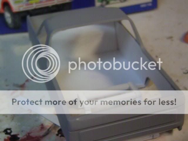

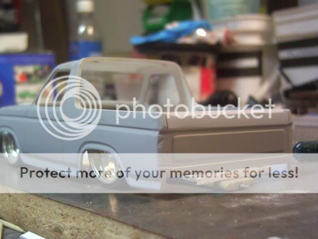

ok guys, got a update.
Not much really, but started the custom grill, cut down the front of the hood so it dosen't hang over the grill so much. I also got the first coat of primer on it, not bad but still needs work and I am going to shave the whole tailgate too, and got part of the floor cut out of styrene.

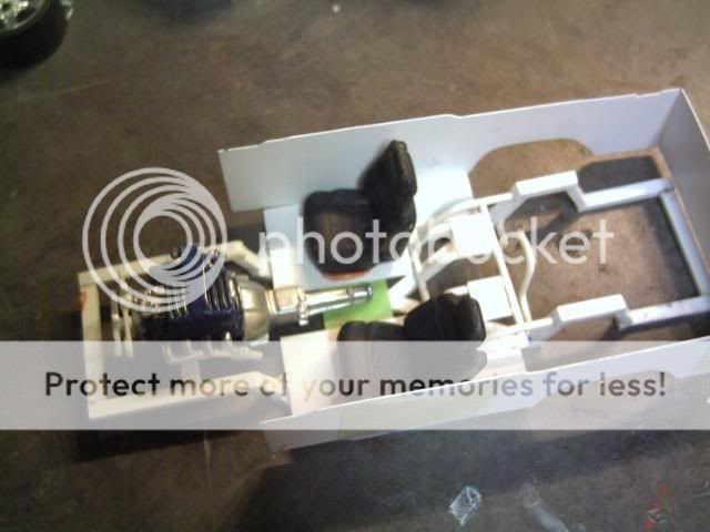

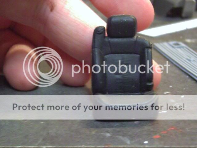

I got the interior base almost done, so now I have to start making door panels and things like that. I have to notch the fire wall for the transmission to fit. The whole thing is just taped together for now.
Here is the 5.0 so far, painted it krylon Regal Blue and cleared it with duplicolor clear effects, that is also what the truck is going to be painted in.
I am going to use 99 silverado seats and the hummer dash is still being worked on.
Thats it guys, thanks for lookin.

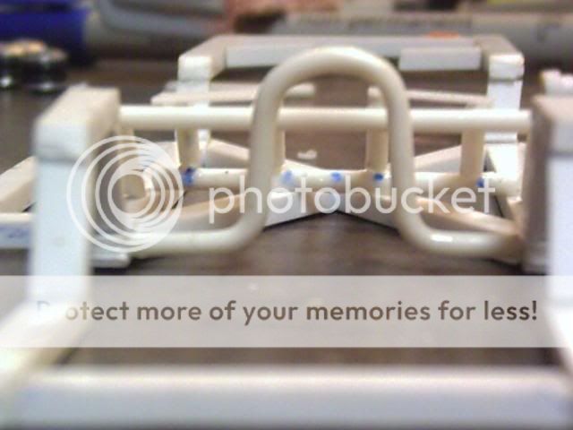

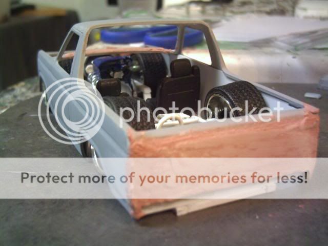

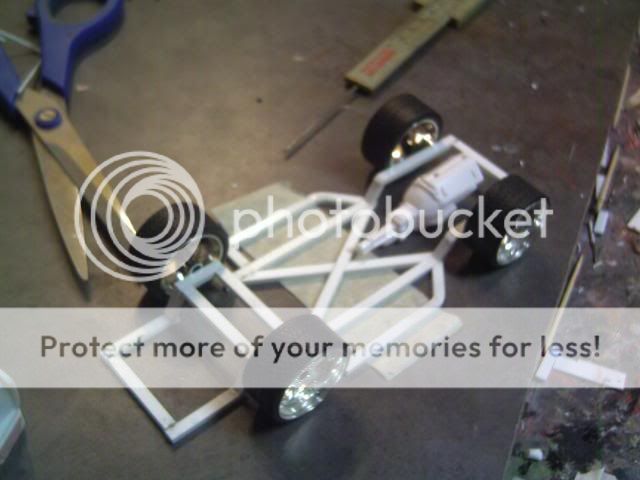

ok so I finally got an update on this!

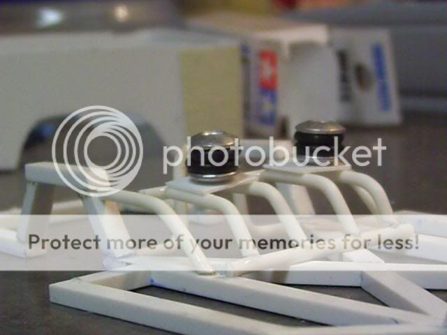

I continued to get some of the frame done, but I still gotta fins the rear axle I want to use. I also plan on 4-linking it. I seen a 1:1 s10 done like this on the net so thats what I'm basing the rest of the suspension off of.
Yes it might look weird right now but trust me, it'll work, and i'm also gonna do some of the frame over again because I'm not happy with the joints.
I also desided to shave the whole rear end, because it was a pain to get around all those curves, and I also still need to build a roll pan.
Now here's the pics guys:
here's the air bags I made:
The chassis:
Thanks for looking guys.
