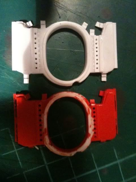

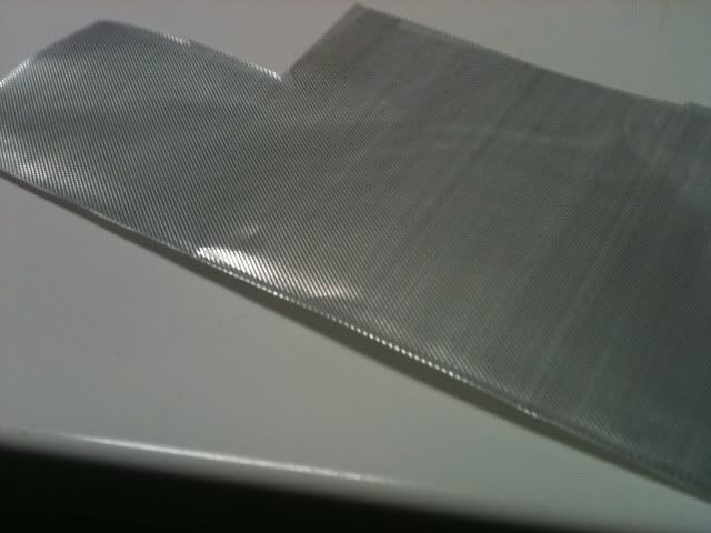

Guest Sickfish Posted April 26, 2010 Posted April 26, 2010 (edited) Brad that's exactly what I used, metal mesh ;-) I cut thin strips ( to fit ) & tacked it around the filter with superglue. On another note, I wasn't overly happy with the simulated rubber sealing ( it was too wrinkled ) or the space between the seal & the air-holes, so I've spent the day re-doing the whole air-grabber. I sanded off the molded-on air-holes & used strip styrene/rod to replicate/re-do it. The wrinkling problem has been solved by flattening/softening the heatshrink tubing by ironing it slowly & carefully under some old cloth. I'm also going to put it on a different way too. After the air-grabbers are re-painted I'll put the seal on & post some pics ;-) Edited April 26, 2010 by Sickfish
whale392 Posted April 26, 2010 Posted April 26, 2010 That's what I thought Cliff.......it looked like the same stuff I have here at the house. Thanks for confirming that sneaky suspision for me!
