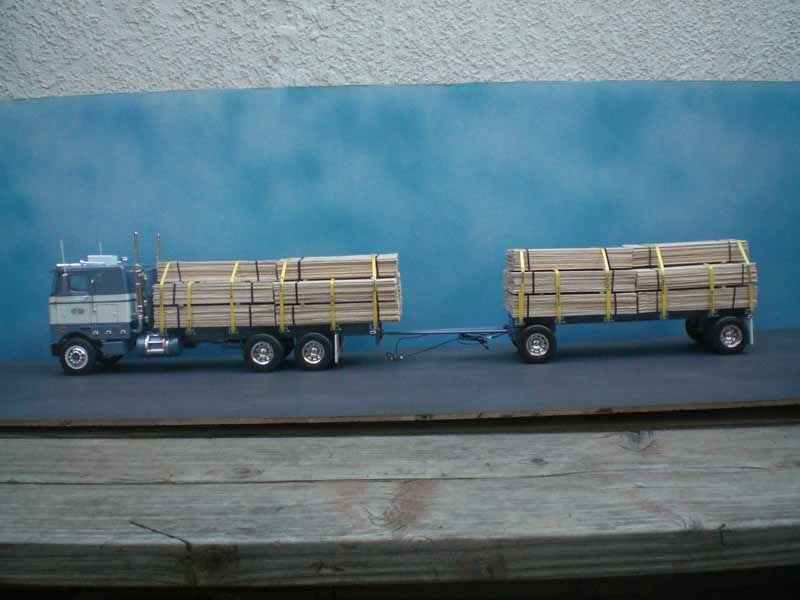

Been slowly working on the load. Here are three units of lumber made with coffee stir sticks. Each unit has 198 sticks, and I'm planning on using 20 units. The units are cut down to 10 scale ft. and banded with black BMF.
  • 2 weeks later...

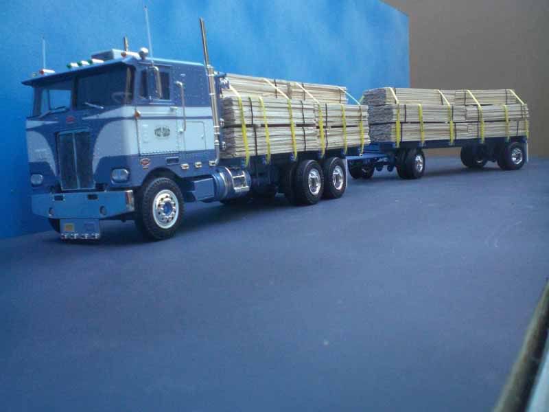

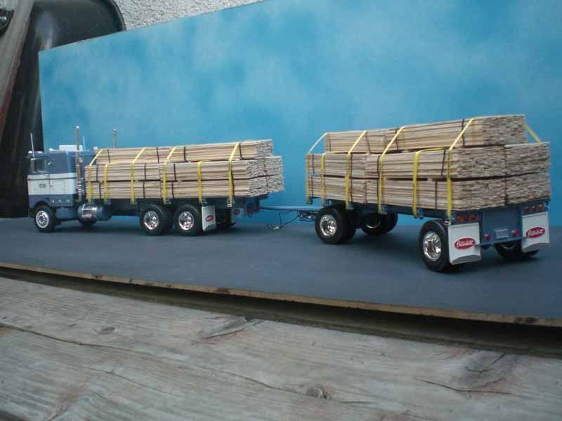

Finished the Pete last week and picked up a load. The winches were made by Leo. I strapped the lumber down with ribbon from the fabric store. I added rings for the hook end of the strap using wire. I added "Kinedyne" label to the straps using my daughter's eye liner , (Doesn't run on the ribbon like a pen).

As a guy who spent many years in a saw mill. I'll give you a tip. The bands usually cut into the corners of the load a little. I would take a file about the same width as the bands you are using, and file a little notch in each of the four boards that go on the corners of the loads, so the bands look like they have cut in a little. The coffee stir sticks are a great idea, I might steal that.
oops, just saw the last pic, didnt realize you had finished the load. Too late. Looks really good.
