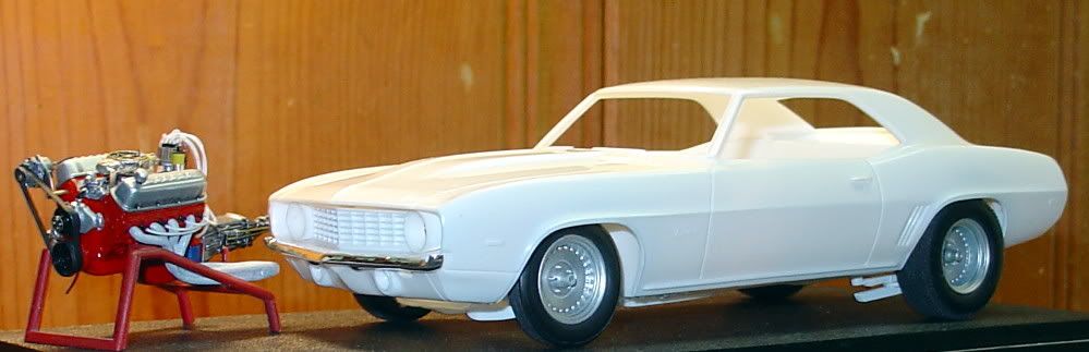

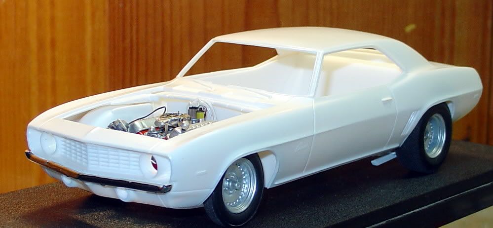

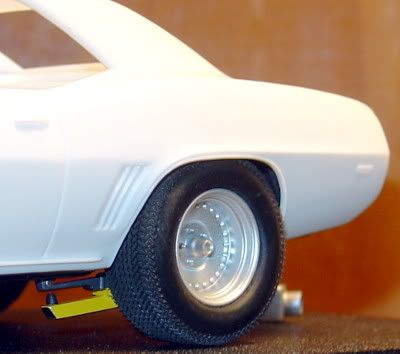

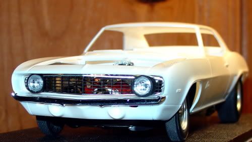

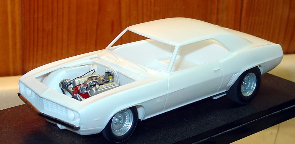

Jeff Sauber Posted April 18, 2010 Posted April 18, 2010 (edited) I haven't gotten much workbench time in these days since I've been dealing with a few medical issues, but I've been fiddling around on this camaro project on my good days. It's based on my 1:1 car that I built back in the mid-80's. I no longer own the real one, so I though it was finally time to get started on the "mini-me" version. Lot's of work still ahead on the motor and rest of the car, but here's where I have things as of now...I had to re-engineer the rear suspension in order to accomodate the L-60-15 tires. The shock mounts have also been re-located. No tubbing was neccessary once everything was repositioned. My 1:1 wasn't tubbed and the L-60 fit just fine although on hard launches the sidewall rubbed a tad bit on the fender lip..... Edited May 25, 2010 by J. Sauber
Jeff Sauber Posted April 18, 2010 Author Posted April 18, 2010 I haven't gotten much workbench time in these days since I've been dealing with a few medical issues, but I've been fiddling around on this camaro project on my good days. It's based on my 1:1 car that I built back in the mid-80's. I no longer own the real one, so I though it was finally time to get started on the "mini-me" version. Lot's of work still ahead on the motor and rest of the car, but here's where I have things as of now...I had to re-engineer the rear suspension in order to accomodate the L-60-15 tires. The shock mounts have also been re-located. No tubbing was neccessary once everything was repositioned. My 1:1 wasn't tubbed and the L-60 fit just fine although on hard launches the sidewall rubbed a tad bit on the fender lip.....

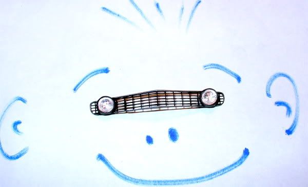

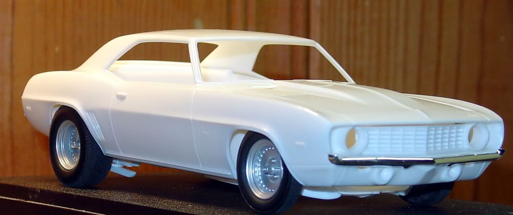

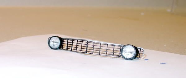

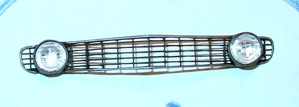

Jeff Sauber Posted April 19, 2010 Author Posted April 19, 2010 Thanks for all the comments guys.......Here's the grill opened up. It was a real pest to do with the dremel. The part started to get real brittle as I kept shaving off plastic from the backside. I broke out a few teeth, but went and replaced them with some small strip styrene. It took about 2 hours or so and lots of trimming and sanding to get it all cleaned up and ready for primer/paint. I think it was worth the extra effort......the unopened grill looked a bit heavy and thick. More to come, Thanks for looking.

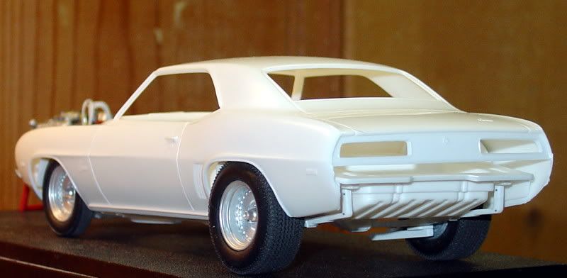

Abell82 Posted April 19, 2010 Posted April 19, 2010 Just a small suggestion, ditch the stock taillights and get some from the 1/24th scale Monogram kit. They look a 100X better then the Revell units. The border is not as thick, and they are not as deep. I am not sure if they fixed them for the snap kits, or not but the ones in the glue kit are just terrible looking, in my opinion. The one flaw of an otherwise great kit.
Jeff Sauber Posted April 19, 2010 Author Posted April 19, 2010 Just a small suggestion, ditch the stock taillights and get some from the 1/24th scale Monogram kit. They look a 100X better then the Revell units. The border is not as thick, and they are not as deep. I am not sure if they fixed them for the snap kits, or not but the ones in the glue kit are just terrible looking, in my opinion. The one flaw of an otherwise great kit. Thanks for the tip......Yeah, I was looking at the tailights earlier today and thought that they looked a little heavy and thick compared to the 1:1 units. There are two styles that are included...[standard & RS]. Neither set fits too well in the body in my particular sample. Are the 1/24 version going to fit or will I have to hog out the openings a bit? I may try sanding down the edges of the set that came in the kit. Theres a good bit of material to remove in order to get them to fit properly into the body slots....That could help with the overall appearance since they look way too thick to begin with.... Jeff
Abell82 Posted April 19, 2010 Posted April 19, 2010 The 1/24th scale Monogram taillights, and 1/25th scale Revell are the same size, and same shape...
cruz Posted April 19, 2010 Posted April 19, 2010 Good to see you back at the bench Jeff, you know how much I have always admired your work. Hope you can work out your health issues, always important to make that a priority. I have that same kit and did the same thing in opening the grille, makes a big difference and even looks better than a photo-etch one. Good luck w/ this project, hope to see you in May at our Mid-Atlantic NNL!!!

AMT Pacemakers Posted April 20, 2010 Posted April 20, 2010 Just curious, what are the rear tires from? Thanks CCSS
Jeff Sauber Posted April 20, 2010 Author Posted April 20, 2010 Just curious, what are the rear tires from? Thanks CCSS Robert, the rear tires are from the AMT'70 Baldwin camaro. They are the mickey Thompson "indy" tires. They are pretty close in design to the old Pro trac tires I used run on my 1:1 Camaro.
Nick Winter Posted April 20, 2010 Posted April 20, 2010 That grill is a work of Art Jeff, I may have to continue opening up my grilles so far I have done 1.

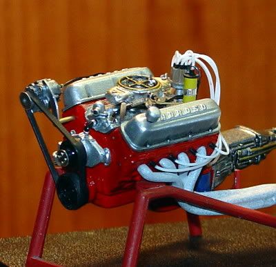

Alyn Posted April 22, 2010 Posted April 22, 2010 Looking forward to following your progress on this one, Jeff. Your detail work is second to none as shown by the nice, crisp details on the motor. Good luck in dealing with your health issues.
Tumbler75 Posted April 22, 2010 Posted April 22, 2010 Wow! You are doin' this Camaro justice! I like how you opened the grill. The stance is spot on! Keep up the great work and I can't wait to see more! That grill is a work of Art Jeff, I may have to continue opening up my grilles so far I have done 1. Once you get the hang of it and start doing it more it becomes addictive (bad habit if you will).

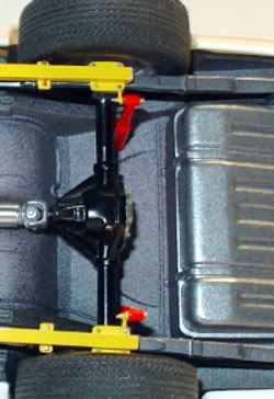

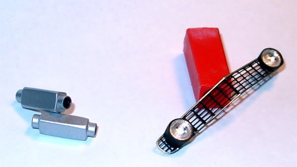

Jeff Sauber Posted April 24, 2010 Author Posted April 24, 2010 Small update....I finished up on the grill by adding on the chrome surround trim. [now I just need to add on the photoetched grill emblem]. I also scratchbuilt a pair of race style mufflers similar to the one's on my 1:1 version. I also reworked the rear suspension a bit more..Don't worry about the excessive front wheel camber...everything is loosely mocked up and is just laying in position. I'll have it all adjusted at final assembly time.
