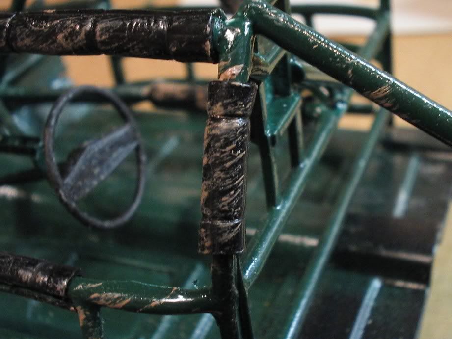

I also use Heat Shrink tubing for padding. But I first pit it on a piece of aluminum tube that is the same size as the roll bar I am going to put it on. I heat it un so that it forms to teh bar size and gat a little more of a thicker and poofy look to it. Then just before it totally cools down, I use the back side of a #11 blade and lightly press and roll a grove into the padding. That gives you the look of the zip ties. Then I slice down one side and mount it to the bar.
