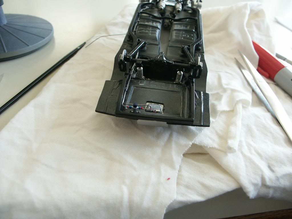

Ok were not done with the Chevelle just yet ! So today while sitting in my office i was able to get the fuel pump and lines hooked up to the tank and run to the front of the car cant complete the hook-up untill the body is on the frame. I also made a in-line pressure gauge and line splitter. enjoy.....

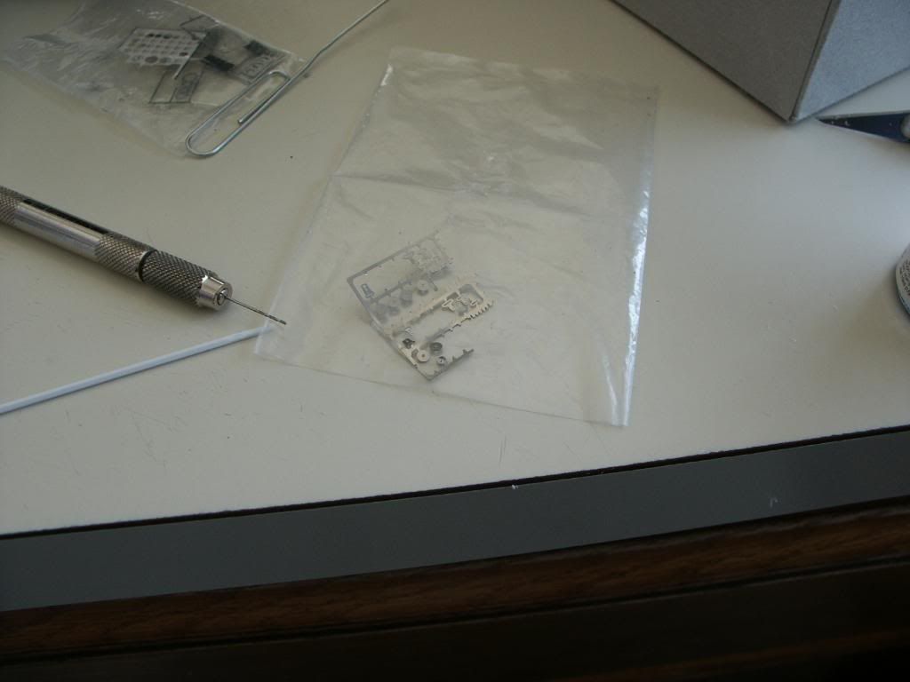

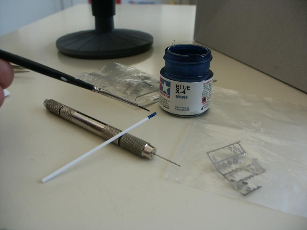

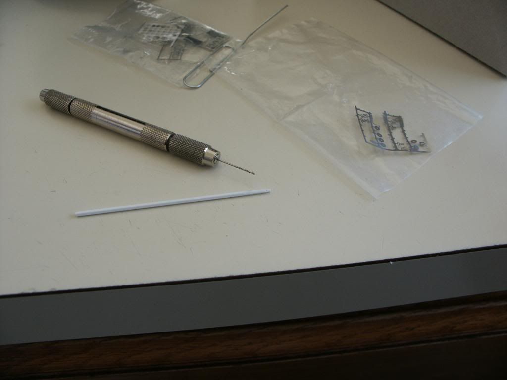

I started with a piece of hexagon styrene and flatened it to make a box and then drilled 3 small holes one in each end and one in the middle, this will be the splitter for the fuel lines between the carbs
If you look closely you might be able to see the very small pressure gauge i made. (look inside the bottom of photoetch sprue)
here I painted the splitter box Tamiya Blue x-4
Edited by Aftashox

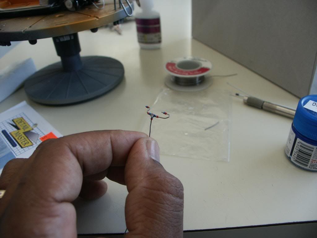

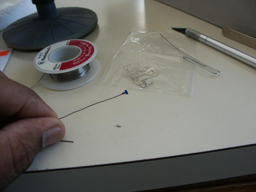

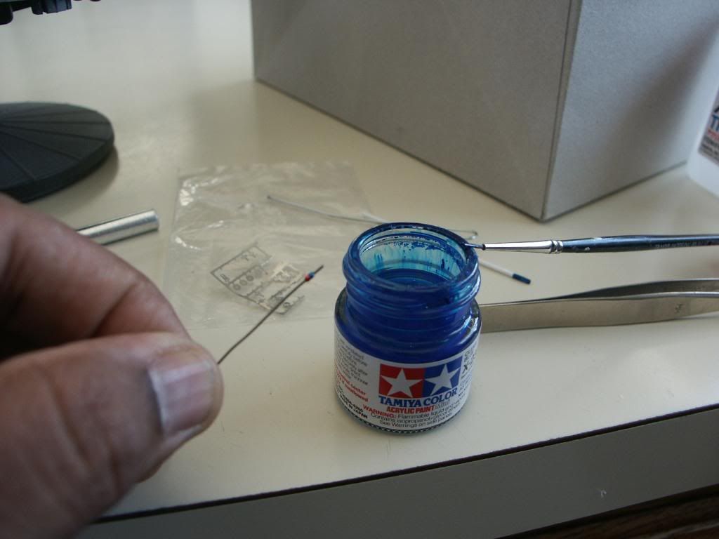

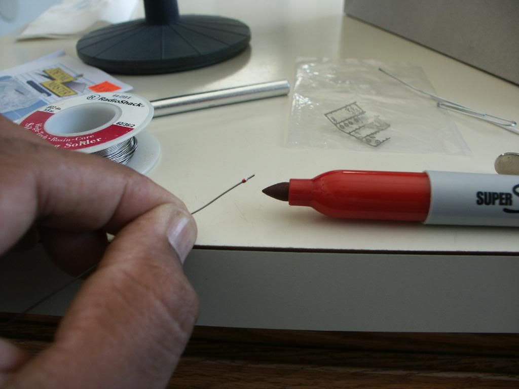

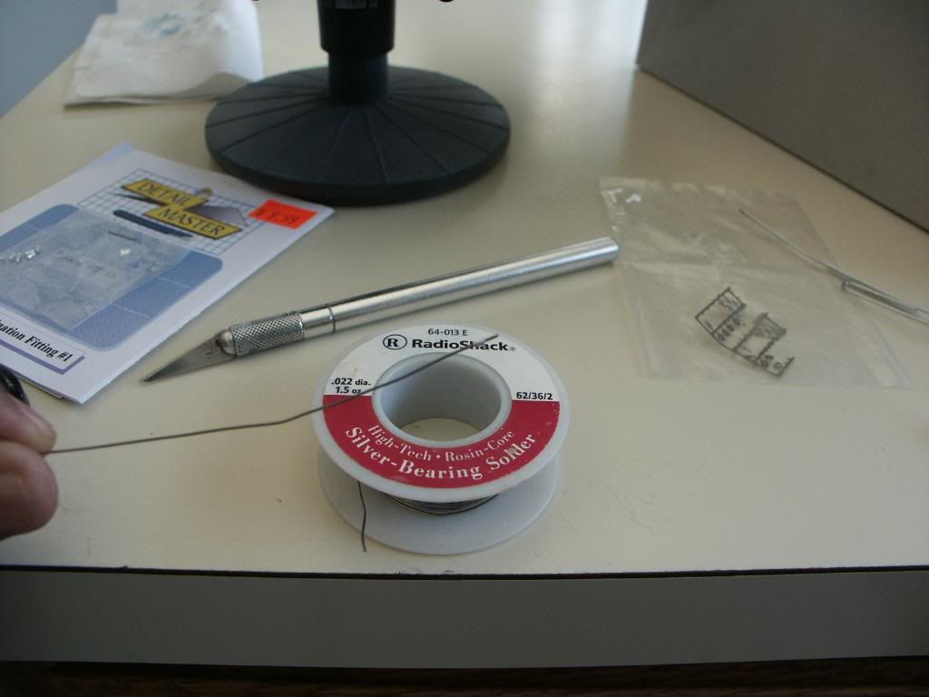

Ok for the line itself I used .022 Silver-bearing solder from RadioShack and #1 A-N fittings
I usually use sharpie markers to color the A-N fittings I couldnt find my blue one so I used Tamiya clear blue when it came time to color the blue A-N fittings.

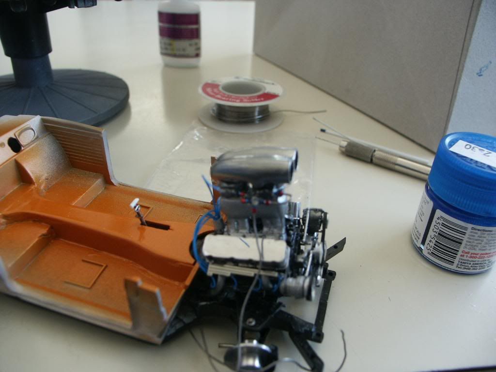

OK now I need to put it all together ......

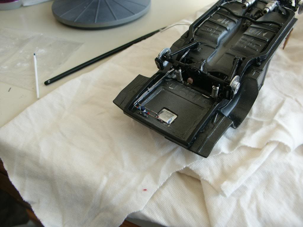

heres the splitter box gluded to the fuel line that will be comming from the fuel cell...
here the assembaly has been pretty much completed. all thats left to do is conect it to the carbs
cant really see it good (camera didnt want to focus on the lines) but here it is conected to the carbs.
Edited by Aftashox
Almost left out the pics of the completed lines from the fuel cell. the fuel line holds were made from the same solder the lines were made from I just pressed it flat by rolling my exacto blade handle over it. I couldnt find a fuel pump anywhere so I ended up making one. enjoy.....

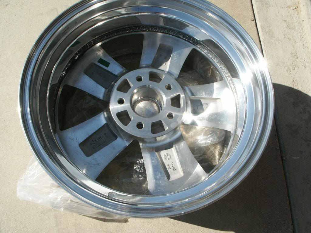

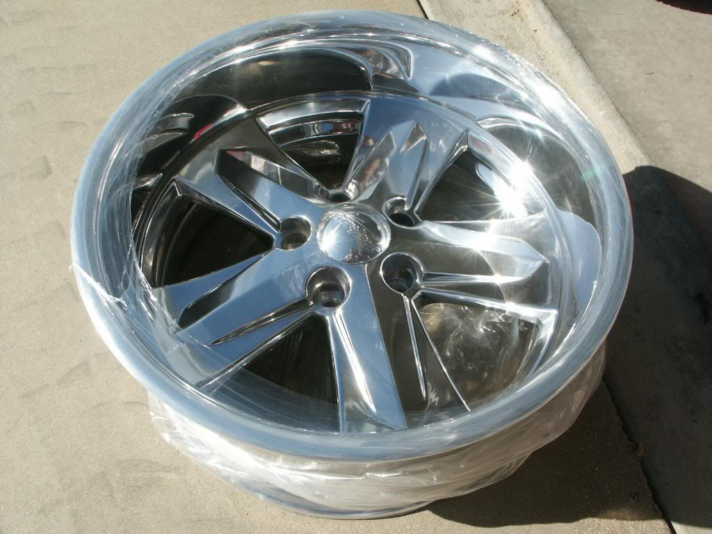

Ok, cool Romell...gives me something to work with. What I probably wasn't clear about is what the model wheel backs need to be like. That'll be an important part of the CAD drawing. The 1:1 wheel backs aren't worth duplicating, mainly for the $. We'll talk further on it, but with those pics, I could interpolate a pretty close dimensional drawing! I'll send you a sketch with dimensions I'll need.

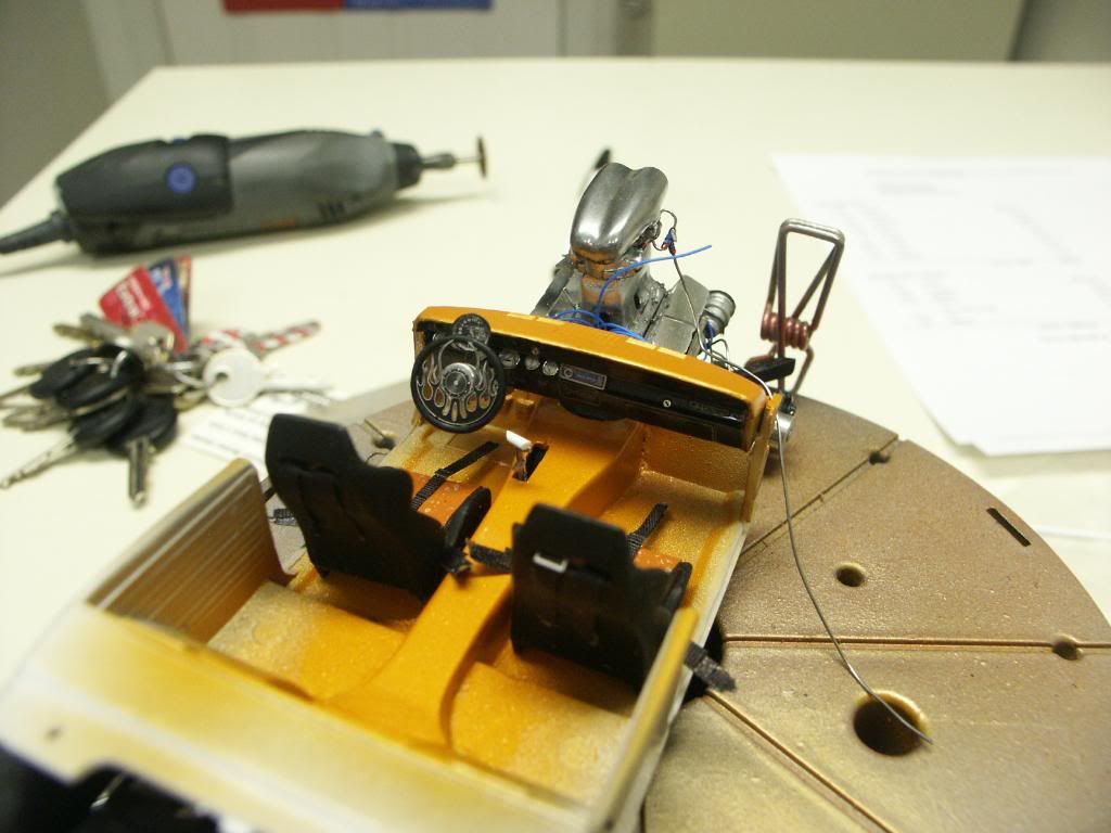

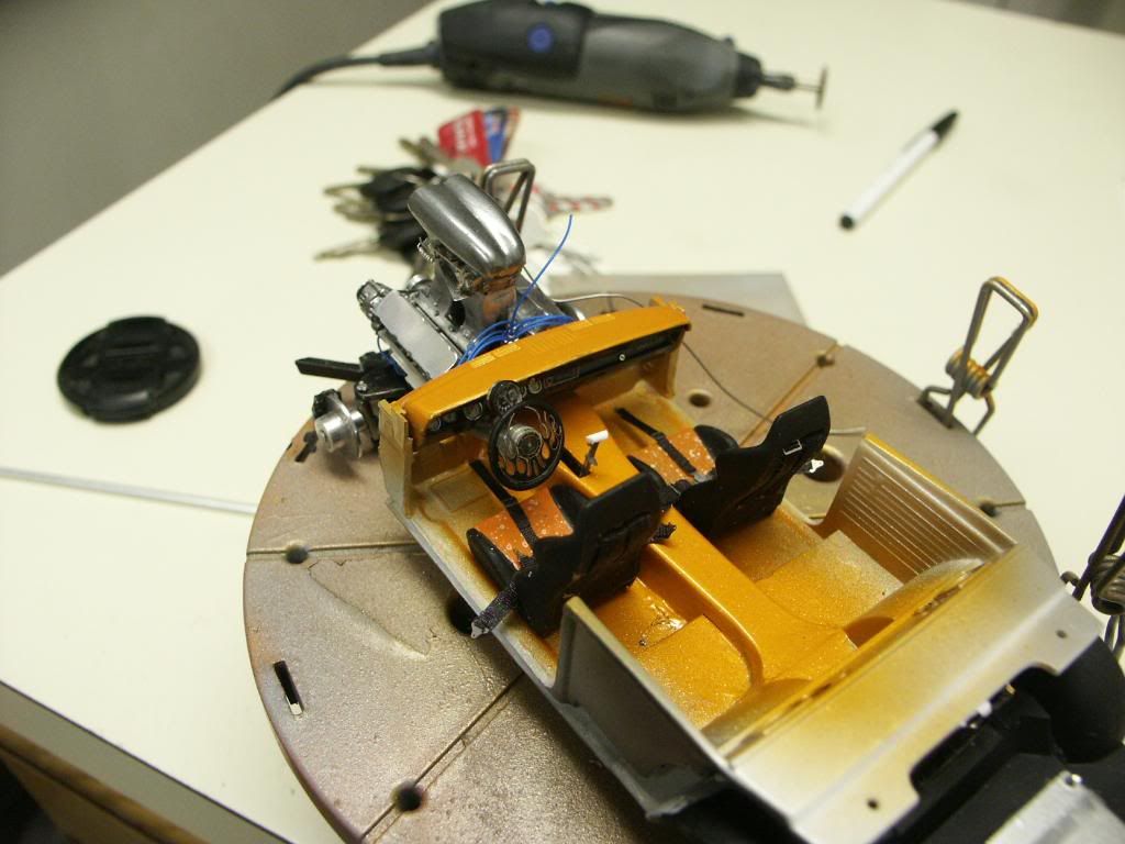

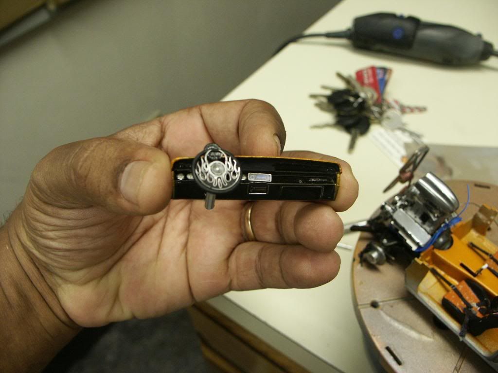

Just wanted to update you guys on the interior comming together heres some of the dash, Added steering wheel and stereo face. Nuf said, what do you think?
