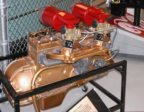

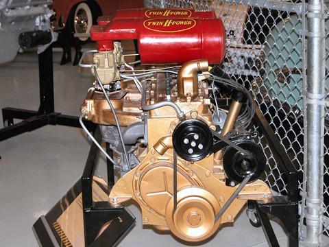

Jon Cole Posted February 22, 2012 Posted February 22, 2012 Still more detail questions, if you don't mind. What appears to be a metal water hose exits from the top of the front housing, and runs down the side of the head above the intake, where it terminates between the two carbs for a rubber hose to take it to the firewall. So the Q is, don't heater cores have a return hose to the block? Where is the one on the Hudson?
Guest Posted February 23, 2012 Posted February 23, 2012 Here are two pics, first one shows heater hose position on water pump, second one, you can see the plug on the side of the head by the second to last spark plug, hose goes there.
