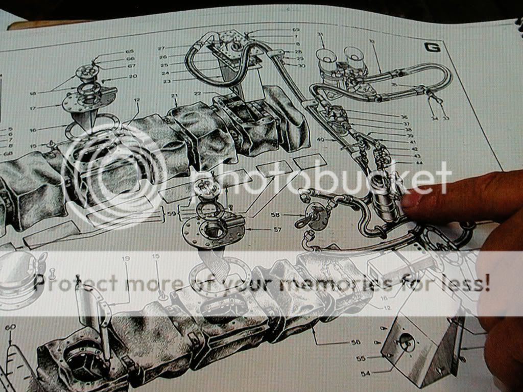

Pete J. Posted August 12, 2010 Posted August 12, 2010 Thanks-I knew about the rear carrier differences but never saw that term. I thought this was a MKII interior shot (note water pipes) but you're probably correct about f'glass seat buckets. This is an older pic, not a restoration shot: A documentation CD would be great to have. Yes, that is definely a Mk I photo. You can see the coolant lined on the side of the center hump. They went this way on the early Mk II's but were much larger. They were moved to the left side to reduce the heat on the driver. Here is a diagram of the Mk I fuel system. Lee was using it as a referance for the Mk II. The piece he is pointing to is not on the Mk II and neither is the fule changeover valve just to the left.
Cato Posted August 12, 2010 Posted August 12, 2010 Yes, that is definely a Mk I photo. You can see the coolant lined on the side of the center hump. They went this way on the early Mk II's but were much larger. They were moved to the left side to reduce the heat on the driver. Here is a diagram of the Mk I fuel system. Lee was using it as a referance for the Mk II. The piece he is pointing to is not on the Mk II and neither is the fule changeover valve just to the left. Pete, Thanks for a great reference shot. I'd kill to have that book it's in, looks like a Ford engineering reference. That plumbing goes to a Weber, not used on MKII's. I actually made time the last two days to work on my model and think at some point soon I will take more snaps and start my own wip thread. I came across more problem areas from earlier in the assembly sequence that you don't know about until you get to later assemblies which have to fit with them. Mock-ups only go so far. Even airbrushed the rocker panel stripes which I spent a lot of time trying to figure out. I've now got major subassemblies of chassis, cockpit and bodywork-but still a ton of minute details to sweat. My hope is that more guys will chime in with tips, criticism or advice. I'd like to see guys start building this project instead of just looking at it.
Pete J. Posted August 12, 2010 Posted August 12, 2010 Pete, Thanks for a great reference shot. I'd kill to have that book it's in, looks like a Ford engineering reference. That plumbing goes to a Weber, not used on MKII's. I actually made time the last two days to work on my model and think at some point soon I will take more snaps and start my own wip thread. I came across more problem areas from earlier in the assembly sequence that you don't know about until you get to later assemblies which have to fit with them. Mock-ups only go so far. Even airbrushed the rocker panel stripes which I spent a lot of time trying to figure out. I've now got major subassemblies of chassis, cockpit and bodywork-but still a ton of minute details to sweat. My hope is that more guys will chime in with tips, criticism or advice. I'd like to see guys start building this project instead of just looking at it. I am hoping that Matthew will be able to produce the CD. The book is actually a parts list for the MkI. The shot is a still I took off of the video that is Lee Holman explaining the differences between the MkI and the Mk IIs. It is very instructional and he goes through the entire book front to back, about 10 minutes worth of video.
Cato Posted August 12, 2010 Posted August 12, 2010 I am hoping that Matthew will be able to produce the CD. The book is actually a parts list for the MkI. The shot is a still I took off of the video that is Lee Holman explaining the differences between the MkI and the Mk IIs. It is very instructional and he goes through the entire book front to back, about 10 minutes worth of video. I hope he does too, I'd love to have that 10 minute vid. I have his 935 upgrade kit and CD-it's excellent.
