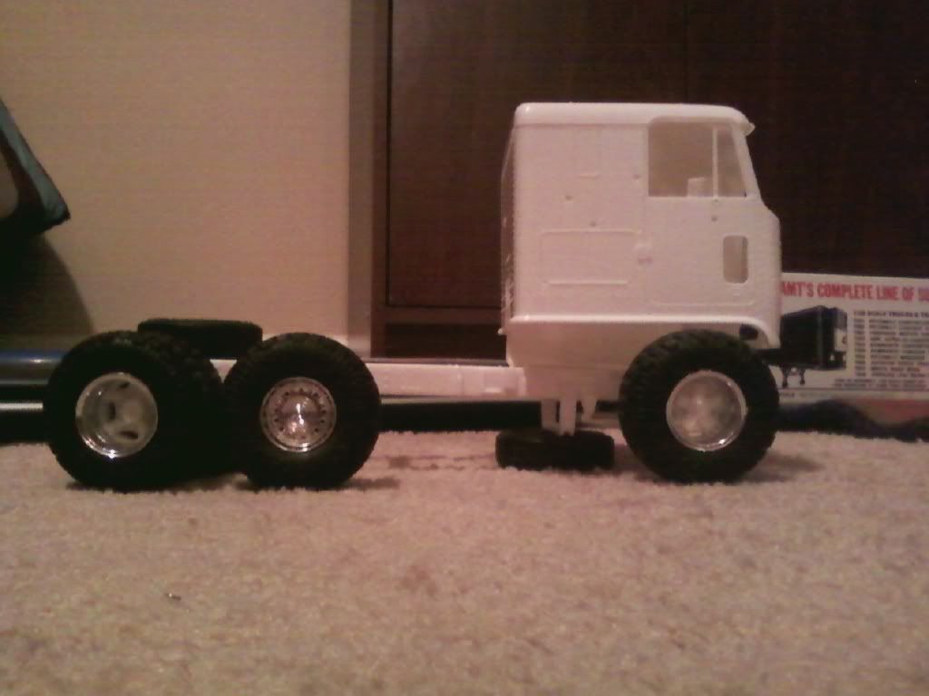

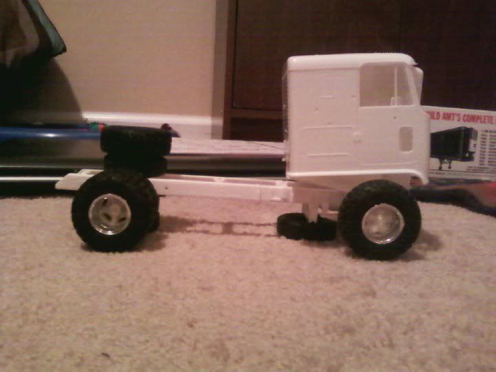

Gray Smith Posted July 28, 2010 Author Posted July 28, 2010 Thanks guys and Thanks Doug for all the help and comments, and Doug, i've got my eyes on at least 5 more truck kits so this won't be the last one you guys see from me. Here is a little teaser for you... tires are So-Real Truxus..which fit the kit wheels very well. When I bought the kit I was thinking of a 4wd/6wd set up, slightly showy truck...dunno what it would tow or be used for, but it looks tough to me. I've got my eye on the drive front axle set-up and the 8V71 turbo add-on from Sourkraut, and i've got parts for a single axle conversion in the back if I go that route. Anyway once I get some detailing work on the motor and chassis i'll start a full on build thread. Thanks Gray
