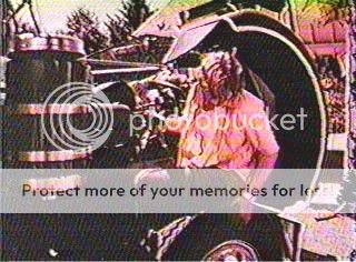

highway Posted September 30, 2010 Posted September 30, 2010 Here is some info and pics I found on the Internet Movie Cars Database: http://www.imcdb.org/ They used both a 1973 Kenworth W-925 and a 1974 Kenworth W-900 A for the show, according to the site, and from the pics, both bunks are correct. The 1973: The 1974: I also found this pic of under the hood, even though it is not the greatest, and it is labeled on the site as the Cummins VT903. A great idea if you would want to build both trucks, use the AMT kit for the short bunk 73 model and use Revell of Germany's Kenworth W-900 for the 60 inch bunk. I forget offhand who offers aftermarket decals, but I have seen a few different aftermarket decal makers offering better decals. The kit is AMT's 1968-1972 Kenworth W923 (or W925 if you're lucky enough to get the torsion bar suspension) with some "Movin' On" looking decals thrown in the box. Jim , I'm not sure if there are any differences kit wise, since the only AMT Kenworth I ever had was the Movin On kit, but I'm almost sure the kit was marked as a W-925 on the box. Without having any of the other issues, though, I don't know if the suspensions were correct for the W-925.

Jim B Posted October 1, 2010 Posted October 1, 2010 Here is my plan for a 'proper' Sonny Pruitt truck: Revell of Germany W900. AMT W900 hood. Cummins 903 from Ertl IH 4270. Modify what needs modifying for the shorter BBC and wheelbase. Stripes from JBOT. The AMT hood WILL mate up to the Revell cab, the hinges and cab mounts will need to be adjusted. I have all the parts on hand.. I just need to build it someday. Tim Tim, Was it a V903 or a VT903? Auslowe now has a VT903 available. Hey, Ben, get crackin'!!!

Jim B Posted October 1, 2010 Posted October 1, 2010 I haven't built the Revell of Germany kit yet, so I'm not exactly sure what's involved it removing the 8-bag suspension. Don't see why you couldn't though. The VT930 will probably fit better as that frame is "fitted" for the 3408.
