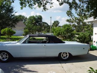

You are absolutely correct Gary. The 1966 Mercury did not come with a 427. I didn't want to get into all that but, since you did, I will elaborate. The names Marauder(410) and Super Marauder(428) where given only to the engines. There was no model named as such. Instead, the name S55 was used as a model along with Monteray, Montclair and Parklane. It is correct that the brochure shows the engines as black, but most people paint them Ford engine blue.
Below is my engine bay.
This is a side view. Note the S55 emblem on the rear quarter panel.
