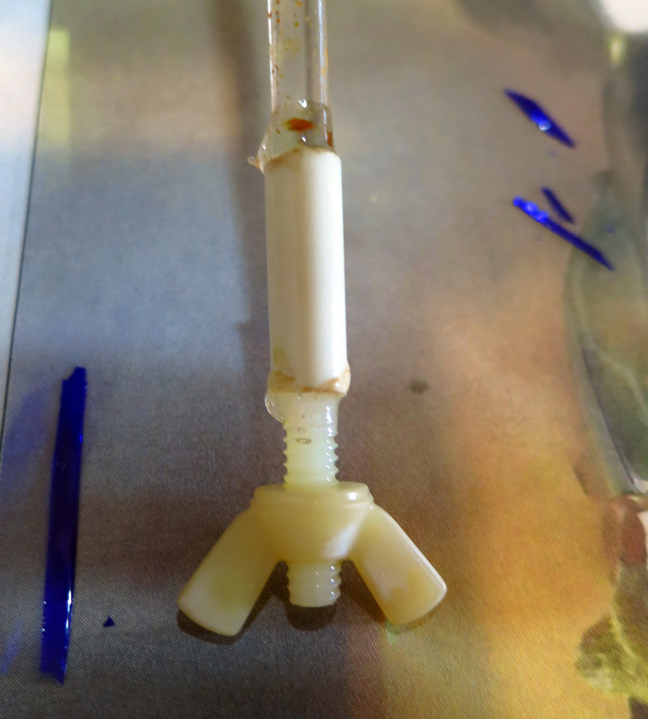

RancheroSteve Posted June 28, 2016 Posted June 28, 2016 Thought I'd share a little something I did that might be helpful for any of you guys using the Micro Mark kit. I found that after some use, the clamp that holds the piece in the tank started to lose its tension and wouldn't hold very reliably any more. So I bought a 8/32 x 1" nylon bolt and wing nut from the hardware store, cut the old clamp off the rod and the head off the bolt, then epoxied the bolt onto the rod (with a plastic sleeve for additional strength). Then it's simply a matter of punching or drilling a hole in the workpiece and putting the wing nut on to hold it. No more worries about losing the part in the tank!
