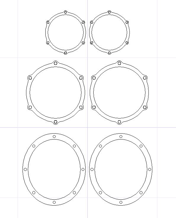

It's time for an update and I also have a question for you all. I've received an order of Dzus plates in various styles and scales and they look very nice. I'm just about to finish up my .004 stainless steel drawing, which includes the corresponding Dzus self-ejecting buttons, and which also leads me to my question. What size ID should I be drawing the fender/exhaust exit bezels, i.e., what OD best represents the collector/dumps that you're building? I've done two styles of fender bezels, a picture of which is attached showing them and the window bezel. The fender bezels are currently drawn with what represents a six-inch ID in 1:1. Is that too large? Let me know!

Nice to see you moving along on this, If i did the calculations correct for a 6" (1:1) that would be 3/8" in 1/16 which would be to big in my opinion, I would rather see something like 1/4" ID. Also not sure if it was mentioned or not, maybe do some Chute and door levers.
Thanks Joe. Your math is correct. Quarter inch would equate to a 4" collector, but that is extremely small in real world 1:1. Even 30 years ago on pro stockers, 4-1/2" was common. If they're too small, the bezels won't do anybody any good, so, if anything, I need to err on the side of being larger than necessary rather than smaller. I hope and trust that this makes sense to you.

Scott, Sorry about that. I was doing the window bezel, I misread your post. Right now im running 9/32" tube for my exhaust exit That equals a 4-1/2" pipe in 1:1. I checked the 9/32 tubing in my plastic ruler thing that has all the circle sizes that you can stick tubing through and the styrene tube that is 9/32" actually fits loose in it. So i think you would be able to go right at 9/32" and it would work, Worst case they could be filled down some. I personally can't use the exhaust bezels on this build because of the way i did the exit on my car. That's the best info i can come up with right now, I'm sure Dave will chime in on this also.
Thanks Joe. I edited my previous e-mail while you were adding yours. I'm glad we've had a meeting of the minds, so to speak. Since there needs to be at least some clearance, both in real world as well as whatever scale we're talking, I believe it could stand to be somewhat larger than 9/32 ID. How much more, I don't know... Thanks for speaking up! :D

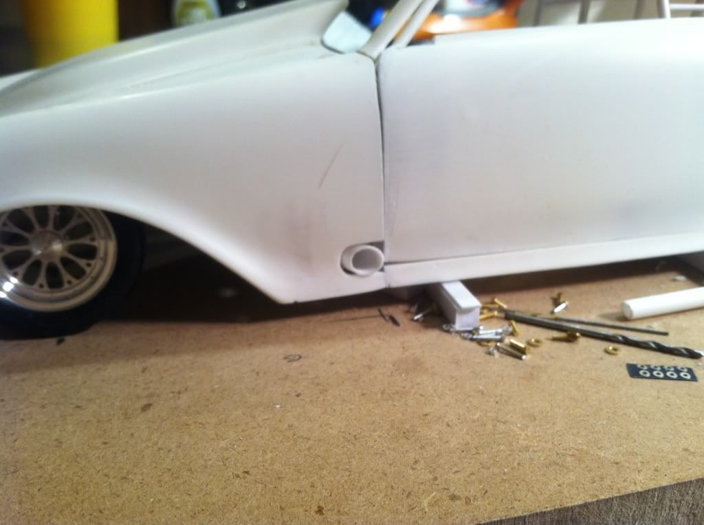

Here is a picture of mine, Keep in mind this is when it was the 1/4" tubing. The 9/32" tubing is that much bigger, I don't have a current picture of mine now with the 9/32" tubing in place. I know alot of guys try to build to scale off 1:1 dimensions, which is fine and i have done that with anything that i could on my car. If i went with the 5" (5/16") collector it looks out of scale compared to the scale of my body and some other aftermarket parts, Maybe you could offer 3 different sizes on the tree to cover 4" (1/4"),4-1/2" (9/32") and 5" (5/16") ? I don't think in 1/16th scale you would use anything smaller than 4". Hard to say what to do, unless you totally scratch build everything like Dave can and does it's hard to keep everything to scale.
This is what a 4" exit pipe looks like.
