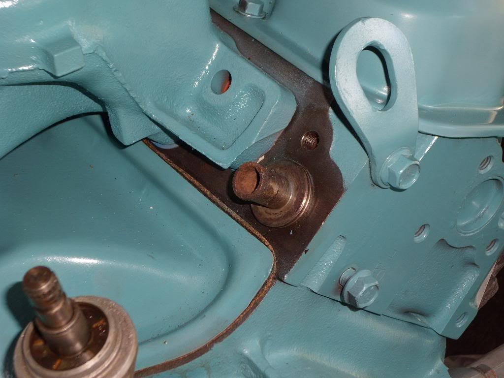

Qwit Pushin Posted March 4, 2012 Posted March 4, 2012 Found this reference shot which indicates it's actually routed to the inside rear of the right cylinder head:
rv1963 Posted March 4, 2012 Posted March 4, 2012 Perfect picture the hose rather short maybe about a foot long.
rhs856 Posted March 4, 2012 Author Posted March 4, 2012 Thanks, guys! I stopped back here today after I found a photo of a (what looked like) badly burned engine that showed the same thing. The photo posted above is exactly what I needed.
