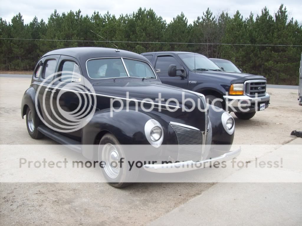

von Zipper Posted March 20, 2012 Posted March 20, 2012 This is my buddys '40 Mercury 4dr. sedan-at first glance most people think it's a '40 Ford It might not be to hard to turn a Revell '40 Ford coupe into a Mercury-easier if it was a chopped custom.

62rebel Posted March 21, 2012 Posted March 21, 2012 um, NO... there are so many differences between the Merc and the Ford as to render swapping parts between them nearly impossible. the Merc is wider through the body and slightly lower than the same year Ford. look at the running boards on the Merc above... barely six inches wide at their widest, where the Ford's are significantly wider. the fenders, front and rear, have more bulge in them, more contour than the Ford. very few body parts interchanged between Ford and Mercury for MANY years... a few models, like the 49-51 wagons, were basically the same shell, but that's about it. in other words, you need a Flintstone resin body to build a 39-40 Merc, stock or otherwise.
