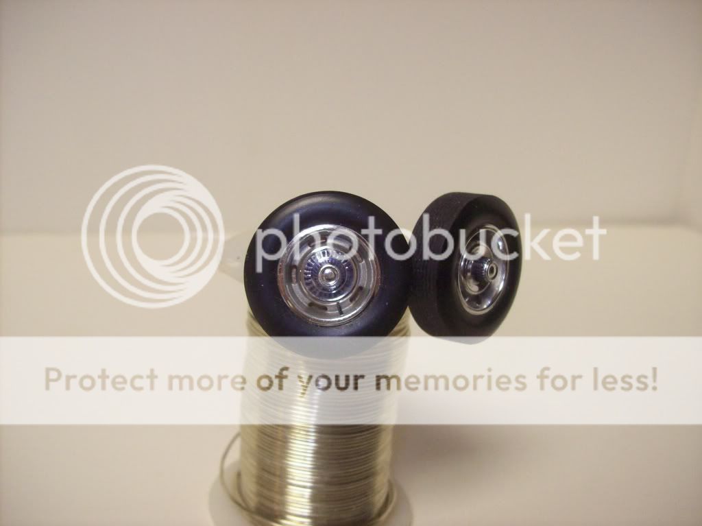

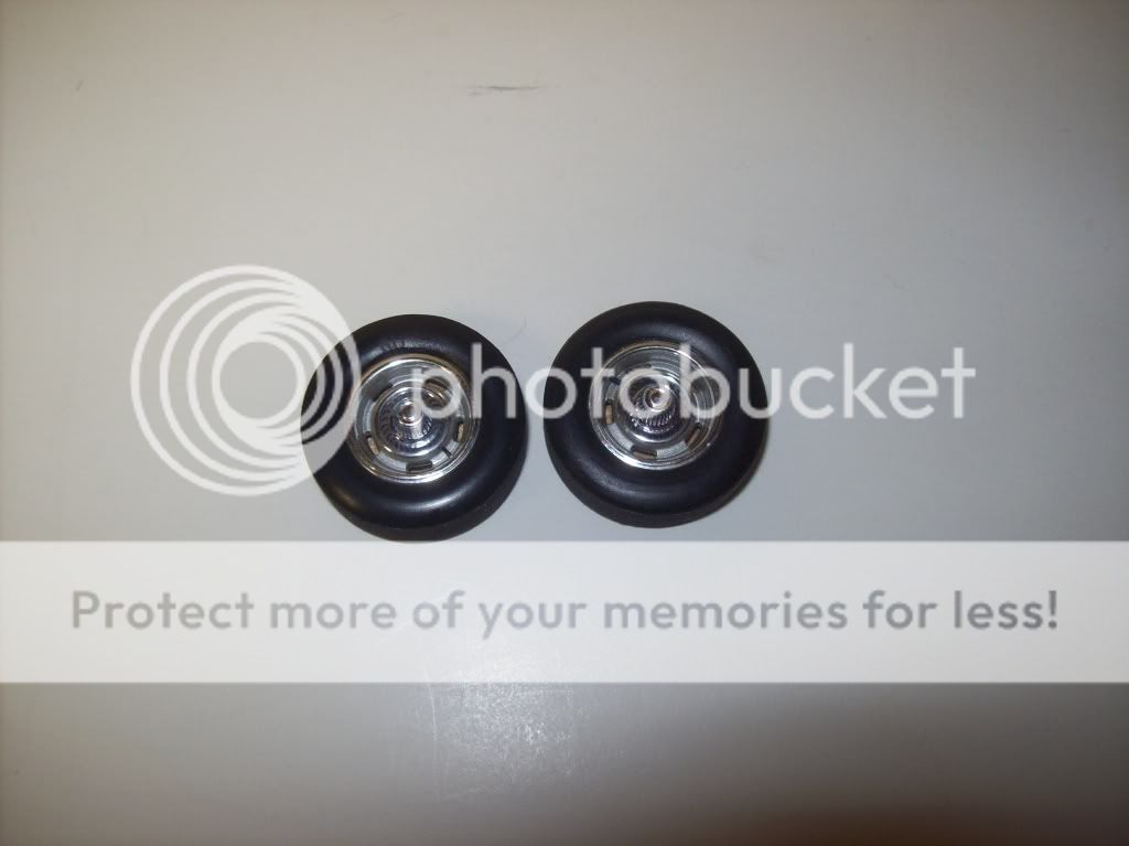

59 Impala Posted April 20, 2012 Posted April 20, 2012 You could do like Chris (Zipper) told me once. You can dip the wheel in the silver paint starting from the back side and when you cover the steel part of the wheel and stop when you reach the hubcap. The back of the wheels are open and you can dip them. That way you have a chrome ring and silver wheel. I've done it and they turn out great. Dan
SuperStockAndy Posted April 20, 2012 Author Posted April 20, 2012 So if I understood that correctly, I need to open the holes on the wheels?
59 Impala Posted April 21, 2012 Posted April 21, 2012 Yep, ifin they're not already open. This method works great. You can see by the pics that Chris posted that the wheels look great and you don't even have to mask anything. Just make sure that you dip them level. Just dip and let dry. Dan
