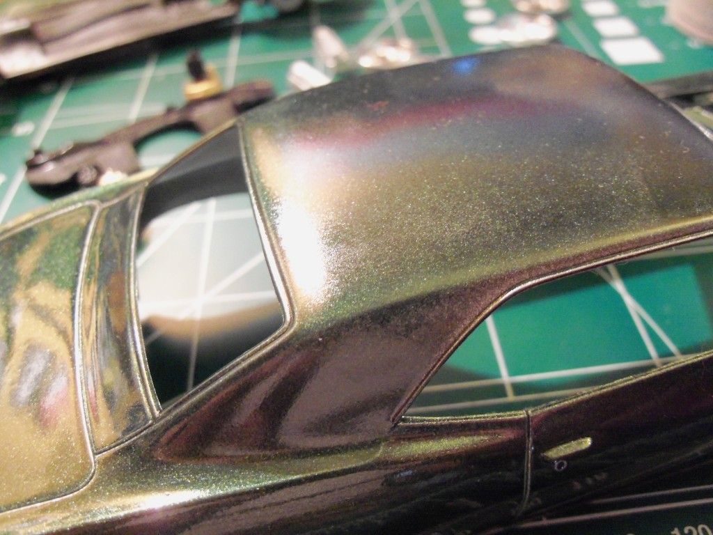

Get rid of clear coat fogging?
Kind of hard to see in the picture:
I used enamel clear coat. I sanded it with 12,000 grit for a few minutes but that didn't really do much.
Thanks B)

You need to start with the coarsest grit polishing cloth which removes the orange peel first. You need to get the paint surface even first, then use progressively finer grit polishing cloths to make finer and finer scratches, until the naked eye can no longer see the scratches. Even with 12,000 grit, there are still scratches.
The only problem is though...I don't have anything between 2000 and 12000 grit :(
Then you should buy a polishing kit. ;)

The cheapest I found was a $16 Micro Mark set...that was only a quick search. I don't really have much access to a hardware or hobby shop by the way.
Andy, I wouldn't worry about a Polishing Kit for that paint in the pictures.
It looks like you have had any number of things go wrong here and I don't think polishing will correct them.
High humidity will fog Enamel Clears (you don't say what brand, manufacturer or even Aerosol or AirBrush) in a heartbeat.
You can see how rough your Clear is from the tiny air bubbles bursting and leaving little bitty craters.

How long did you wait in between color coat and Clear?
Was the model clean and dry when you Cleared it?
Lots and lots of possibilities but you would need to give a detailed accounting of your procedure.
Honestly, I would strip it. Give it a better try.

Not high humidity, around 60 degrees F here. It's cheap Dollar General clear, straight from the can. The rest of the body turned out great, except that bit of fogging on the roof. The car was painted with lacquer, and had well over a month to cure. So that's definitely not the problem. The model was indeed clean and dry.
I'm not stripping it, I finally got a somewhat decent paint job! :lol: :lol:
Humidity is not the same as temperature. It's a measure of the amount of water vapor in the air- basically how "wet" the air is.
Pat is right on the money- fogging with oil-based enamel paints is often caused by high humidity. You might want to try a clear lacquer instead.
