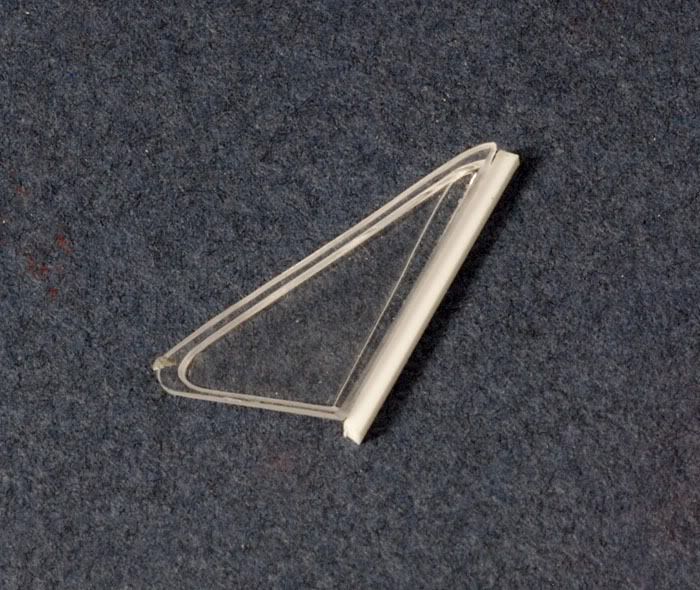

I have to glue a .04" x .04" styrene square to the side of a vent window as the post. It will be sanded flush at the ends and BMF applied. I'm afraid of my usual glass measures since it will be handled a lot. I usually use some watch crystal cement when gluing glass but do have some Testors Clear Parts Cement, which I haven't used yet. I'm tempted to use the Testers but not sure how good it sticks. I'd definitely like to use CA but have heard too much about it will craze glass (plastic).
Any thoughts would be appreciated.

You can dip/ apply Future to the clear part and that would protect it from CA. You can also use clear epoxy. You could also use a clear acrylic,like Future, to bond it. It all depends on how strong the bond needs to be.
Ah, Mike .. thanks for the response . .where's my head at? Of course, epoxy is the answer! It will take all the abuse, filing and sanding I can throw at it. It must be my dislike of epoxy that it didn't come to mind ... anything two-part is a pain and wasteful, but it IS the right one for this job. :)
Use the 30-minute,as the 5 minute stuff just yellows too much. I also found quite by accident that epoxy really is much easier too work with when warmed a bit.
