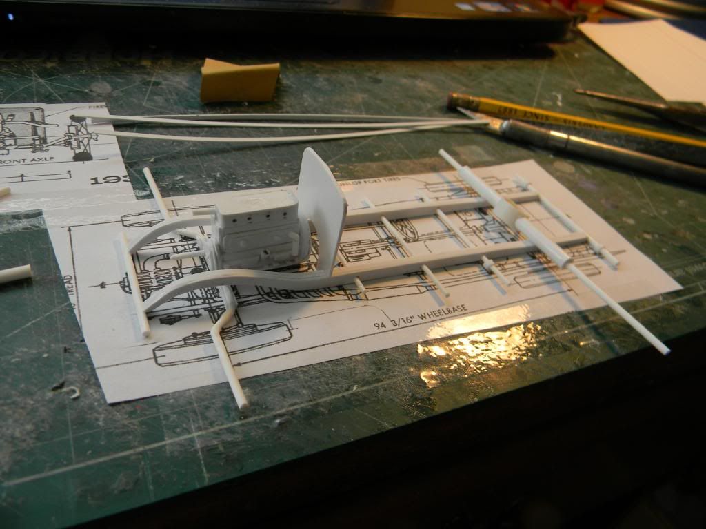

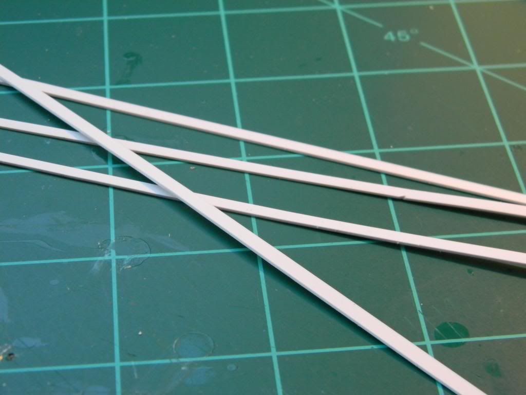

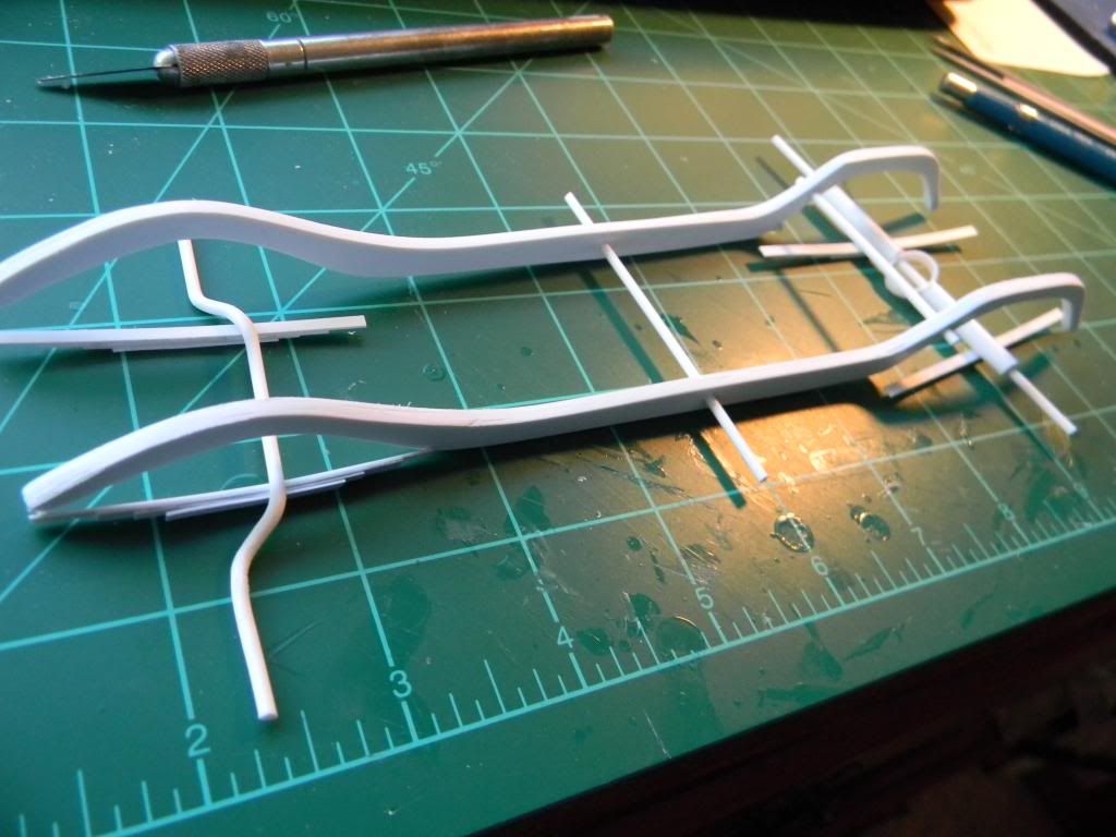

kennb Posted March 31, 2013 Author Posted March 31, 2013 Section 4 Start with some .40 plastic and layout the paper copy of the chassis on one edge. Carefully cut out one rail piece. Using this as a guide glue it to the plastic and cut around it, 2 times, until you have 3 pieces glued together. l piece. Using this as a guide glue it to the plastic and cut around it, 2 times, until you have 3 pieces glued together. Then spot glue to the plastic and do anoother 3 pieces glued together. Now you have a stack of 6 frame rails in groups of 3. File them smooth on the cut edges so that they are smooth and finished. Drill 3 holes (.80) through all 6 pieces. and seperate into 2 rails 3 pieces thick. Using cut .80 rod you can now assemble the rough frame. At each end file with round file for .80 rod at the front and back.let all the rods run wild at this time as they will be cut to length later. The cleaner you do this section the better since it will save time later,,One trick is to let everthing overnight set up prior to filing smooth. This section should take a total of 45 minutes actual work time. If you have any questions on this or previous section please let me know so I can clearify any problems at this time. Next time we will do the front and rear axels and rough cut the firewall.... I have a nice jig for the front axel that will make it square and even. Kenn

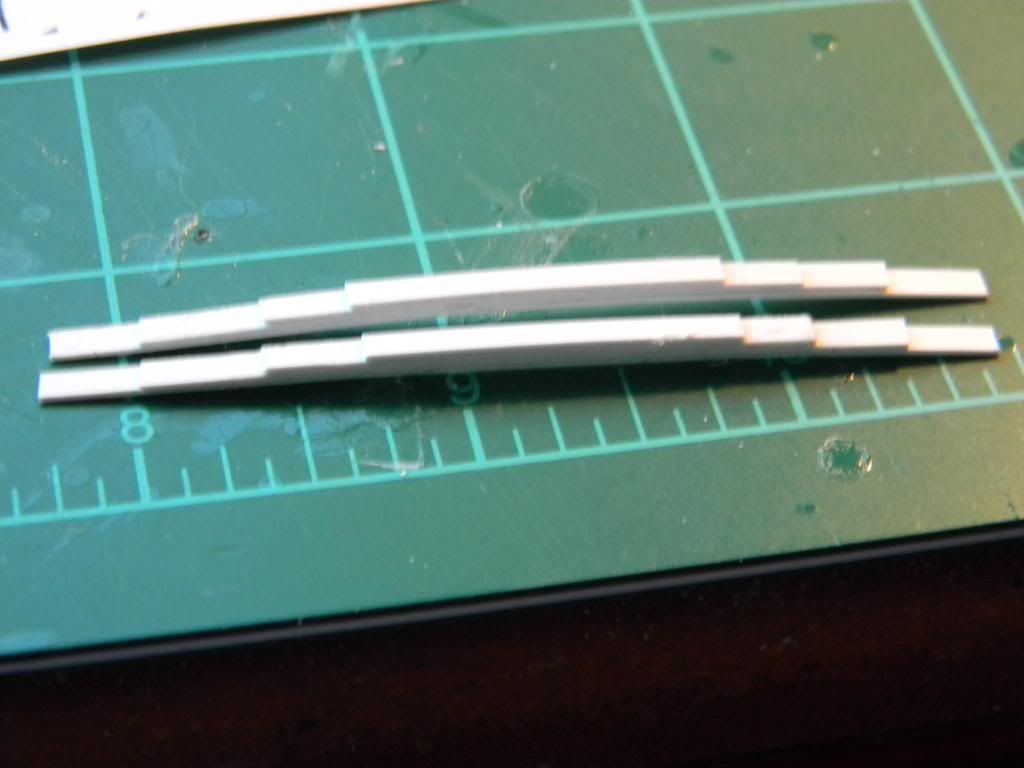

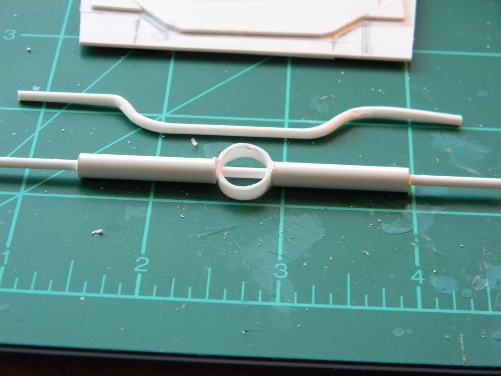

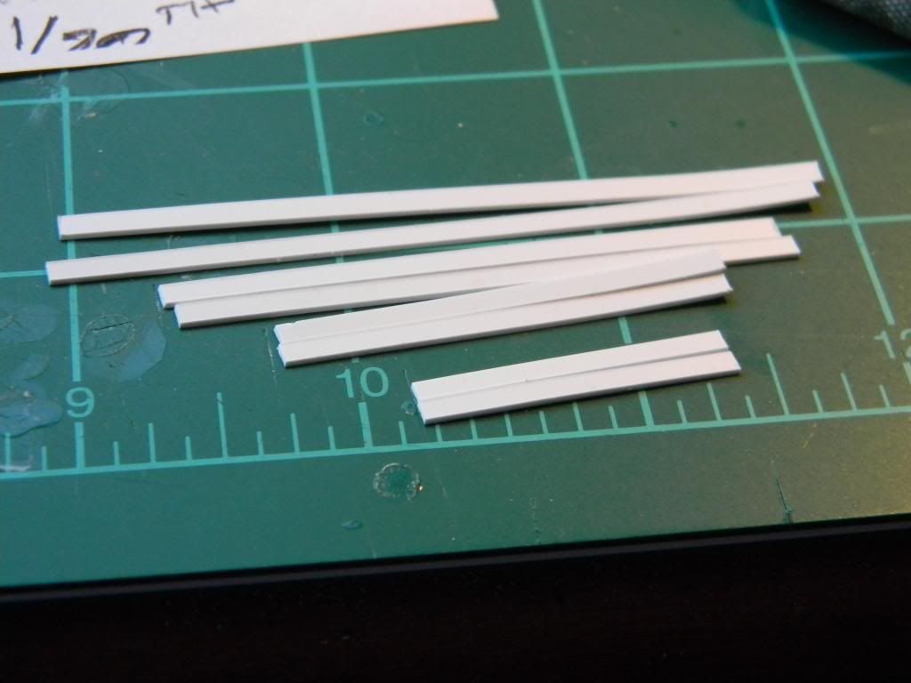

kennb Posted April 14, 2013 Author Posted April 14, 2013 (edited) Section 5 Front axel and springs. The front axel can be made in a jig like above. The .80 is heated at one end and formed to one end and then repeated for the other, it is a little tricky and may take a few trys. The other way is to bend the .80 with a pair of needle nose pliars to get the shaoe, either way will get the accommplihed effect. The rear axel is just 2 pieces of a 5/16 tube and a short piece of 716 tube. you can use what you have on hand. The leaf springs are no more than a series of short pieces .20 cut to size derived from the drawings and glued together and bent a little to get the curve. The last picture shows them in place on the Bentley. Next we will assemble the chassis and wheels. If you have any questions let me know so I can clearify any point. Kenn Edited April 14, 2013 by kennb

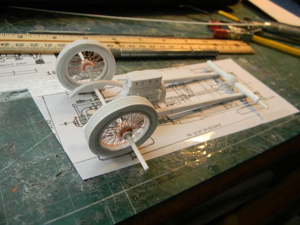

kennb Posted April 14, 2013 Author Posted April 14, 2013 Section 6 Frame assmebly Will post more later Kenn

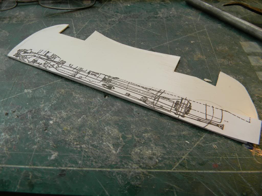

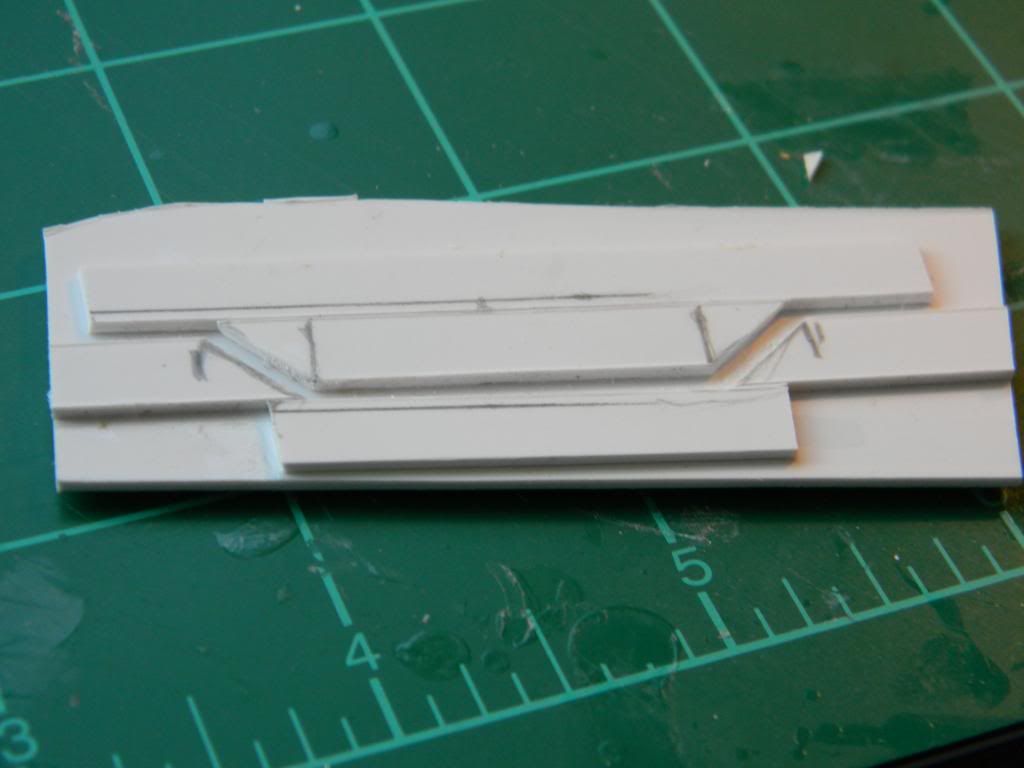

kennb Posted April 22, 2013 Author Posted April 22, 2013 Section 7 Time to start the body work for the K3........Tape or glue lightly the pattern to plastic and cout out one side,,,,,,tack glue and cut the second side, sand them so they are the same and seperate. cut the rear panel and firewall per the pattern. and glue together... I used some small corner blocks to hold the back in place and square. Will get to the cowel next section. take your time and let this set up overnight at least before progessing.. Thanks for joining in and following the challenge.

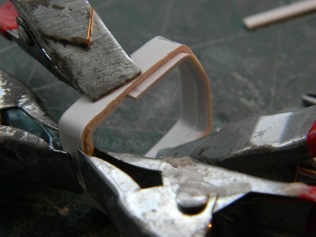

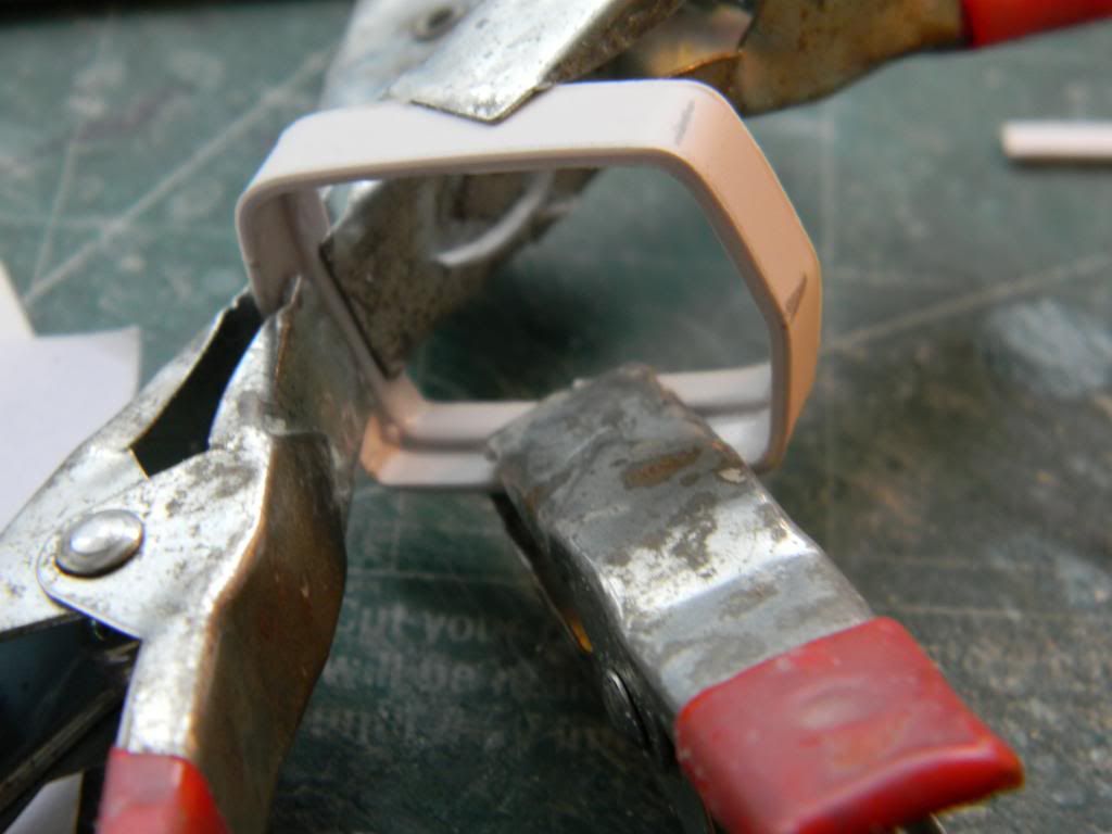

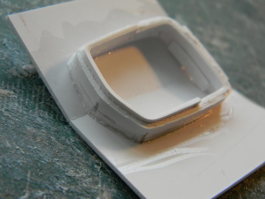

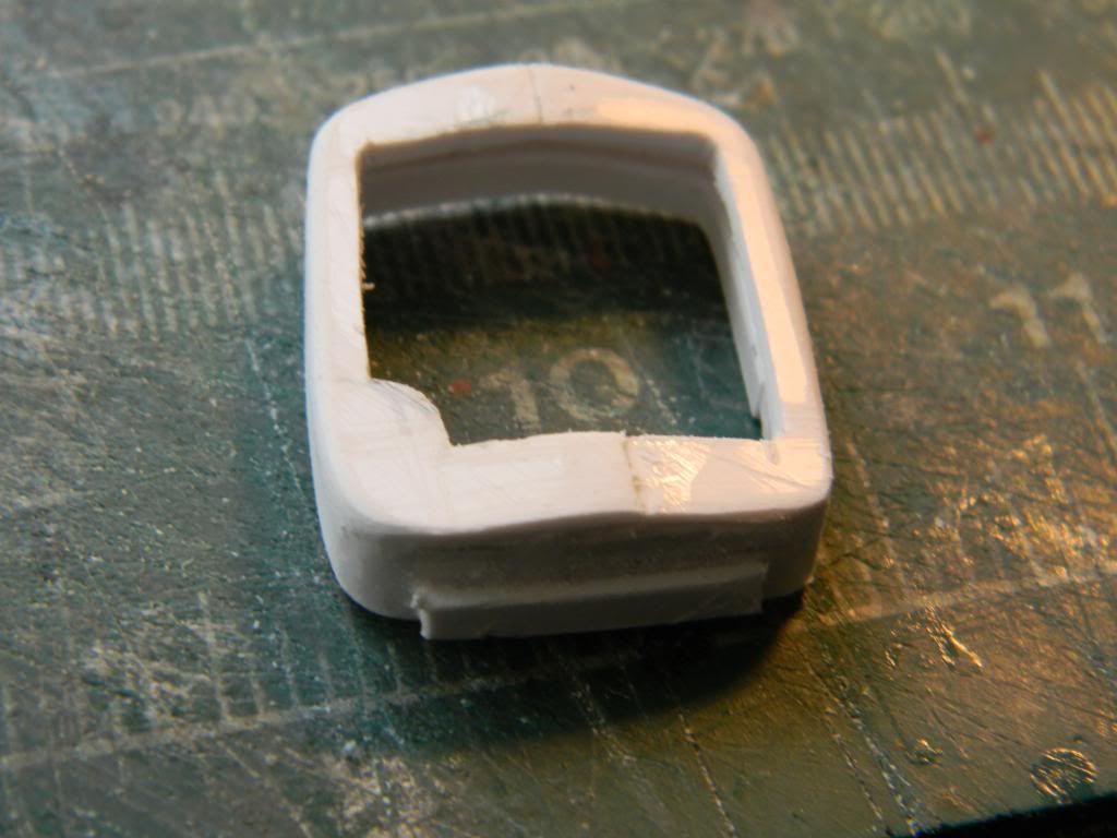

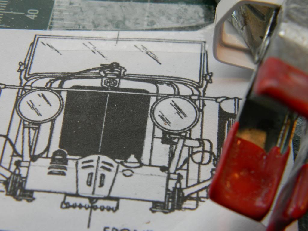

kennb Posted May 2, 2013 Author Posted May 2, 2013 Section 9 Radiator shell using the drawings ofr size and shape cit the .40 plastic glue up,clamp and let dry cut flange for the inside ...sand to shape comparing to the drawings regularly cut oversize piece of .40 for the face. cut out opening. If you have questions or suggestions be sure to post comment......I can post additional information at any time.
