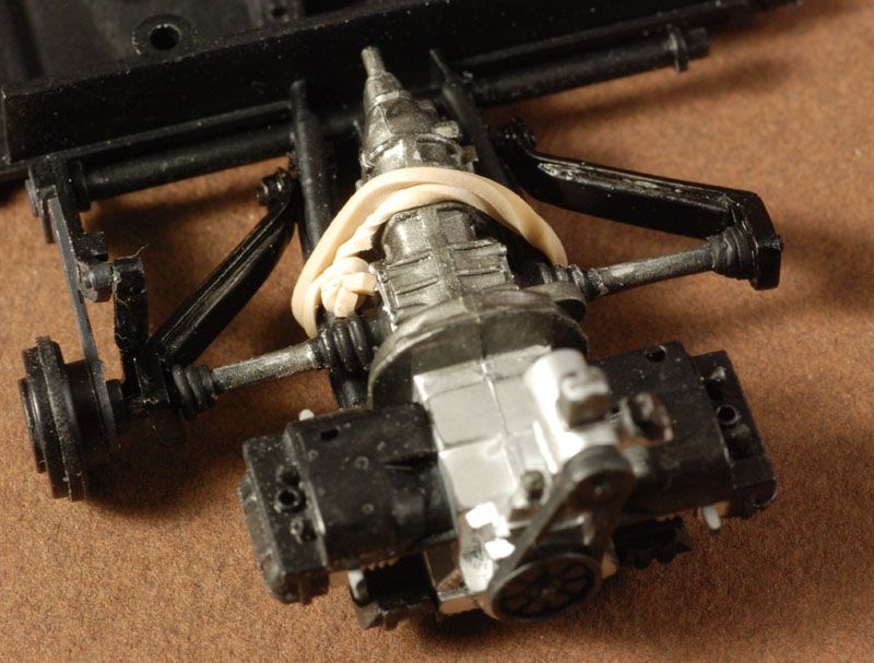

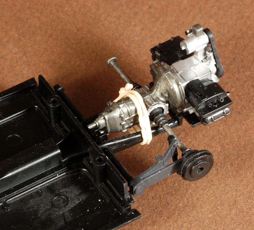

I need to build the diagonal arms for the rear IRS suspension for a '69 Beetle I'm working on. I think a buildup of styrene strips can do the arms with some tubes at the ends. I'd like to model the ribbed boot covers at the axle end similar to the ones already on the kit. Here's a photo of the kit mocked up .. irsDSC_1166_zpsba1fa7ba.jpg And, here's some photos of the Beetle IRS added in 1969. The diagonal are is the only piece I really have to add to make it look right. The diagonal are is at the upper right of this composite photo. 69VWIRS_zps81887c94.jpg I'd appreciate any comments and ideas about how to make this part you may have. There's always more than one way to turn a wheel ;)

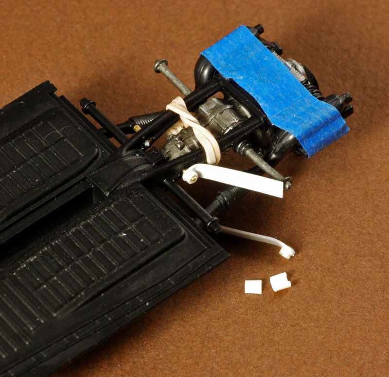

I've taken all the suggestions to heart and have been working on the arms. I have been determined to not change any geometry and left the stops at the ends of the axle. I was going to do the hubs in two halves but this may just be making it more difficult. So I'm going to file the axle smooth so the diagonal (and the boots when I do them) will just slip over the end. I'm going to get the ends done before I add material to the diagonal arms to shape and thicken them. The shocks are mounted to the diagonal arms but I'm gonna just leave them as in the kit and take some artistic liberty.
  • 2 weeks later...
The arms are done so here's a shot. I put 3 strips together and a tube on a pin on the inside with a square at the outside. The boots are just three punched out circles.
