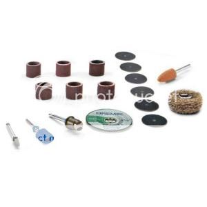

The kind of Dremel can effect this kind of work. I did something like this with a corded Dremel 4000 using the Flex Extension and a foot pedal like for sewing machines to control the rpm better, but it was still tricky. I used a sanding tube thing. Don't know what they really call it. Now I have a cordless Dremel Stylus and anything like this is much easier. The 4000 will cut metal like butter. To finish by hand, wrap sandpaper around something round and keep reducing the grit until you finish with 400 or 600.
