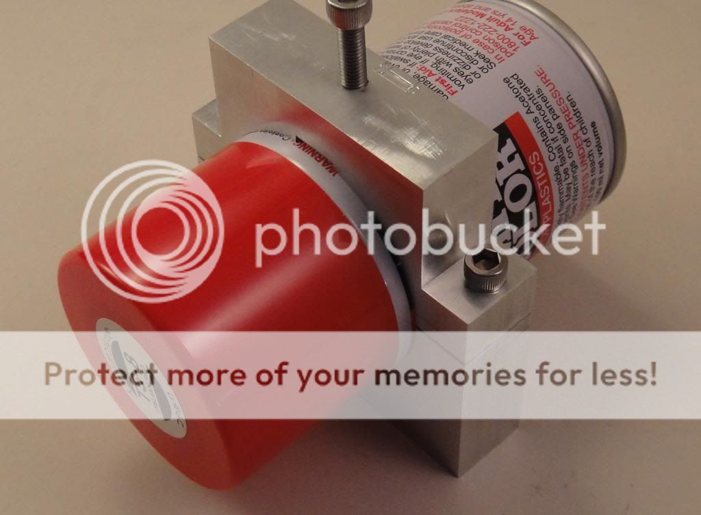

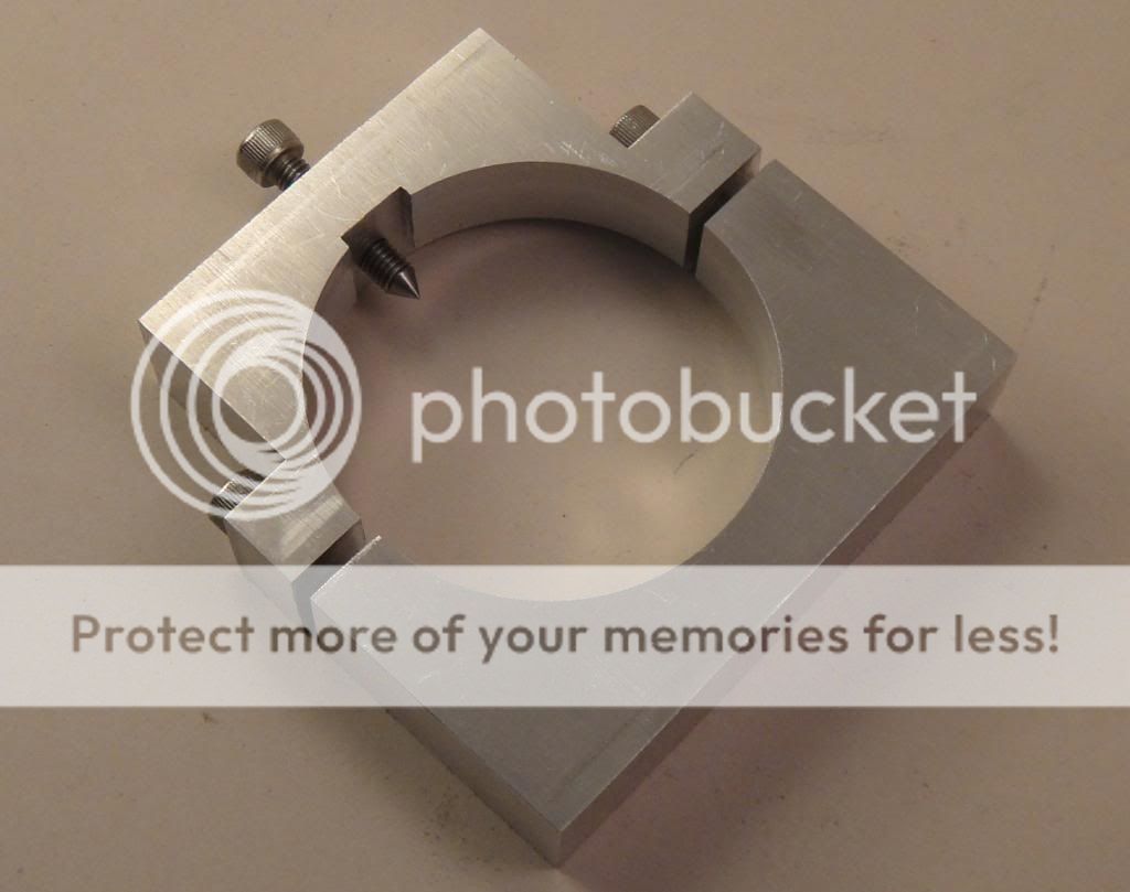

Pete J. Posted August 12, 2013 Posted August 12, 2013 I punch holes in rattle cans all the time. In fact I do it so often I built a tool for it. Definitely safer and much more controlled. No, I won't build one for anyone else. Not willing to assume the liability for someone doing something stupid, like trying it on a can of bug spray.
clovis Posted August 12, 2013 Author Posted August 12, 2013 Mike-I knew that I'd seen or heard of paint stores that offered to shake rattle cans. I was beginning to believe that I had dreamed that up. Thank you for your reply!!! Pete- That contraption is brilliant!!!! Thank you for sharing!!!
Skydime Posted August 15, 2013 Posted August 15, 2013 Don't quote me (or do anything stupid based upon my analysis) but, it looks like Pete's contraption is similar a lobbed off piston rod end with a screw thread tapped into it. Pretty neat!
Pete J. Posted August 15, 2013 Posted August 15, 2013 (edited) On 8/15/2013 at 5:33 AM, Skydime said: Don't quote me (or do anything stupid based upon my analysis) but, it looks like Pete's contraption is similar a lobbed off piston rod end with a screw thread tapped into it. Pretty neat! Well, I've seen my fair share of connecting rod ends, so it not to surprising that I would borrow some of the content. It is really a very common shape. I've seen a lot of bearings and other parts of machinery that are similar. I would bet there were probably 50 similar looking parts on a John Deere combine. In fact a lot of them had the treaded hole for a grease zerk. Main difference here is that I cut what looks like a keyway to let the pressure of the can escape. Edited August 15, 2013 by Pete J.
