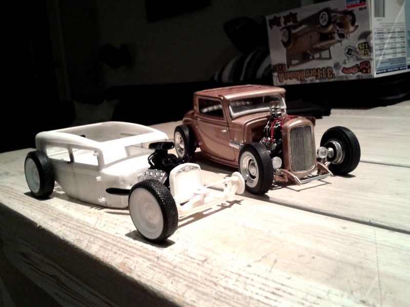

hight difference with my copper deuce .. the tudor is sitting on the table on the pics not ride hight but that wont be a lot higher :)
next to one of my early builds the 3-window coupe deuce , about the same hight (roofline)
